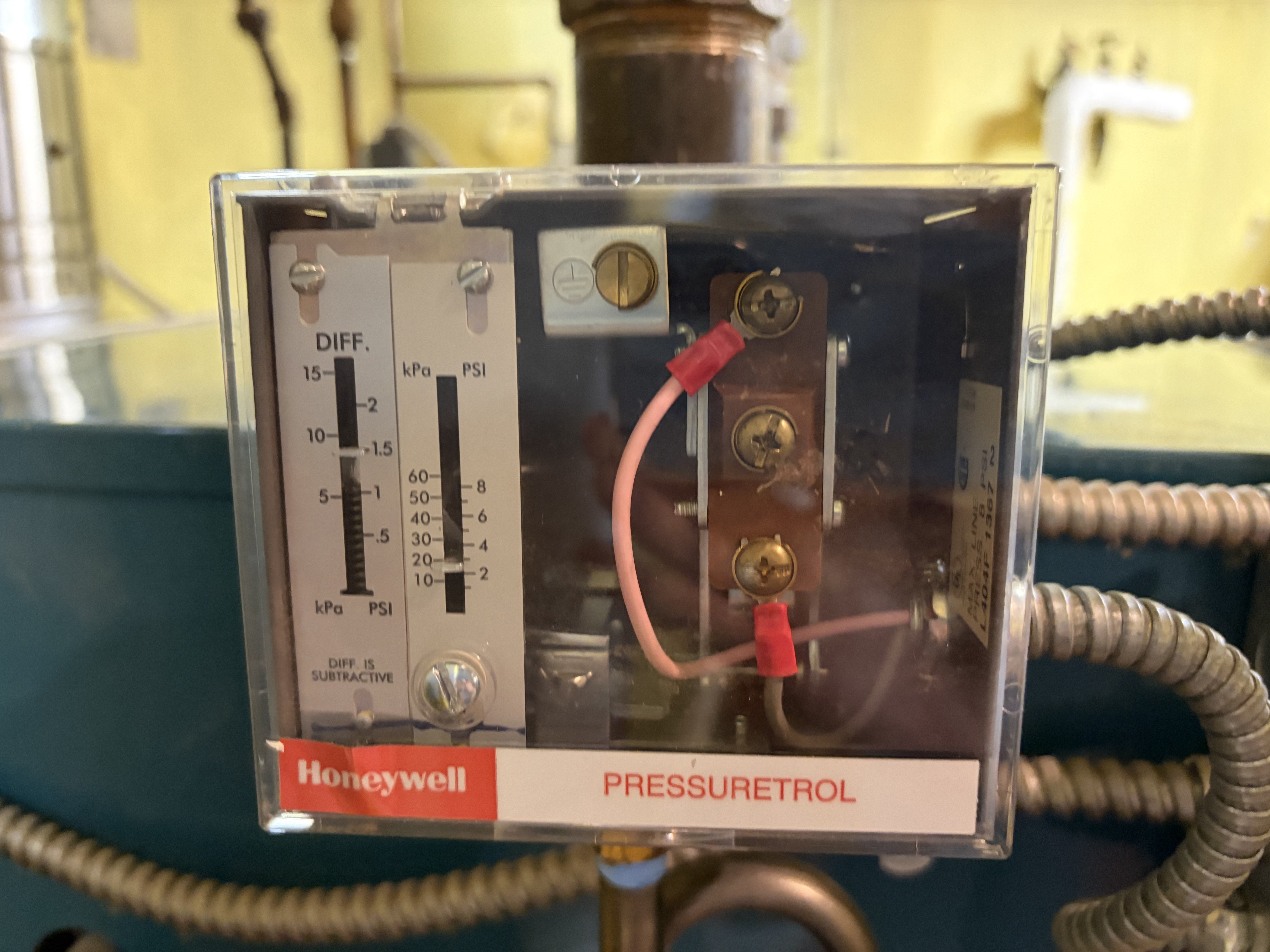

    Wow! We've never known this was a vapor system, even after having two contractors who are supposed to be steam system experts. We are in Ferndale, Michigan, just north of Detroit. I found this in Holohan's book and it looks just like what we have on many radiators, although it doesn't seem consistent around the house. And apparently if we have a vapor system, we shouldn't have a pressuretrol (which we do) and should have a different, more sensitive control for the lower pressure?

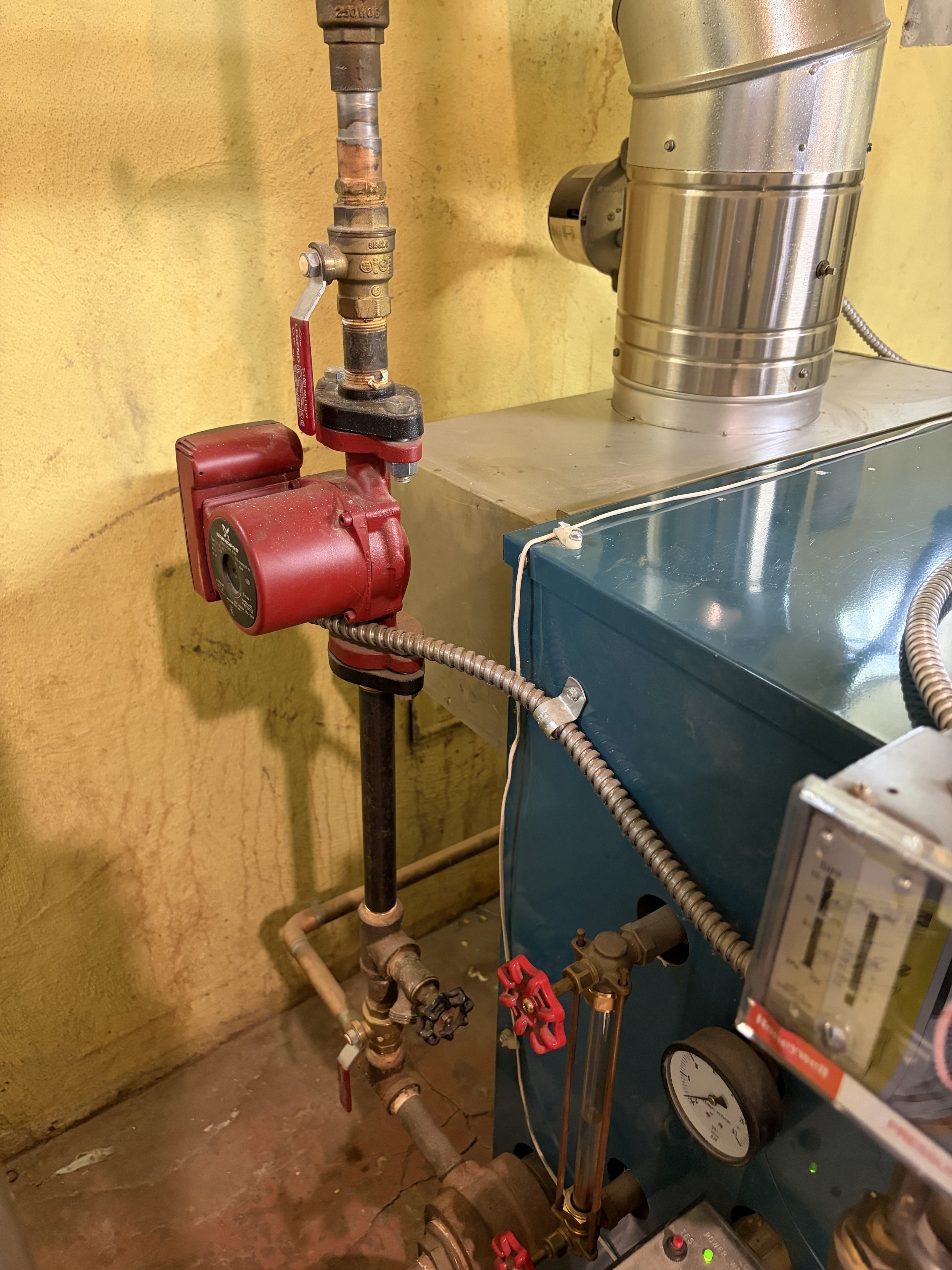

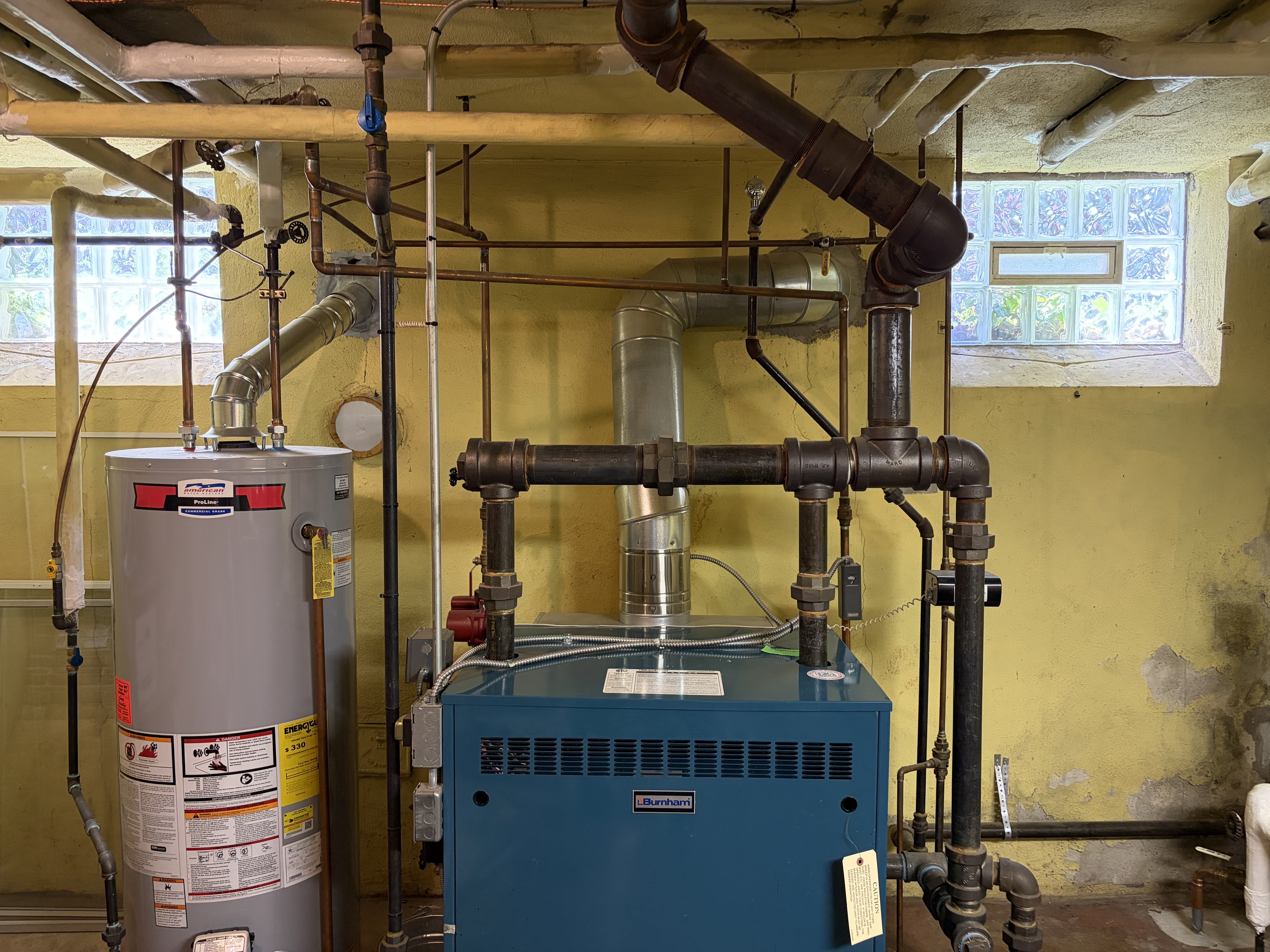

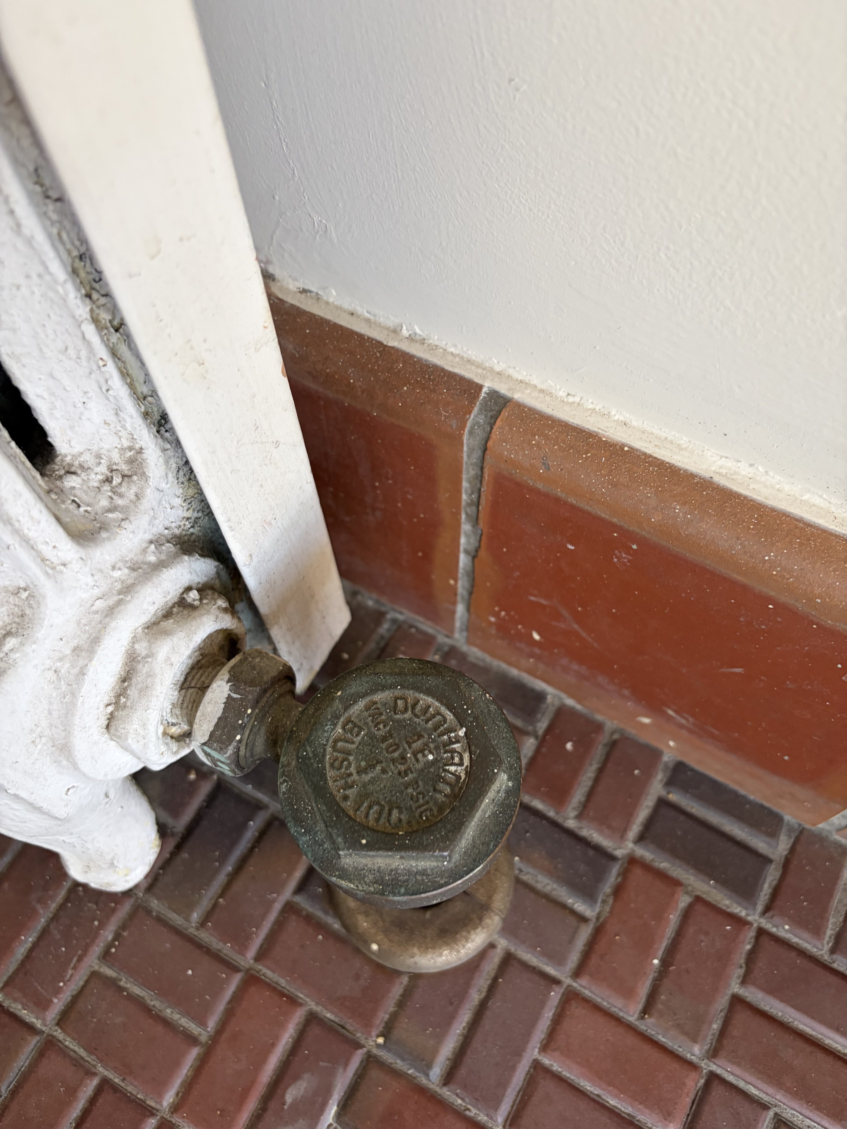

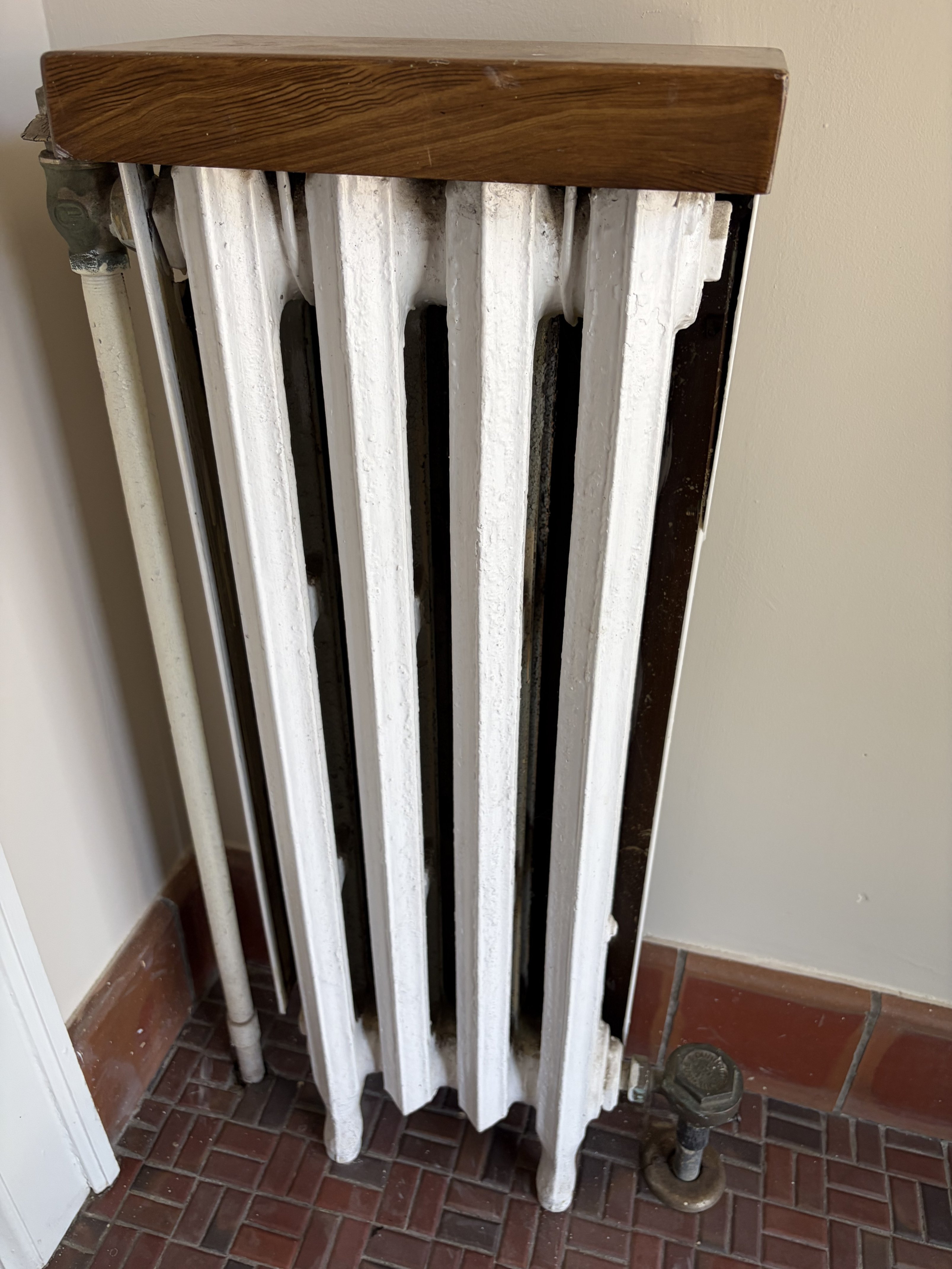

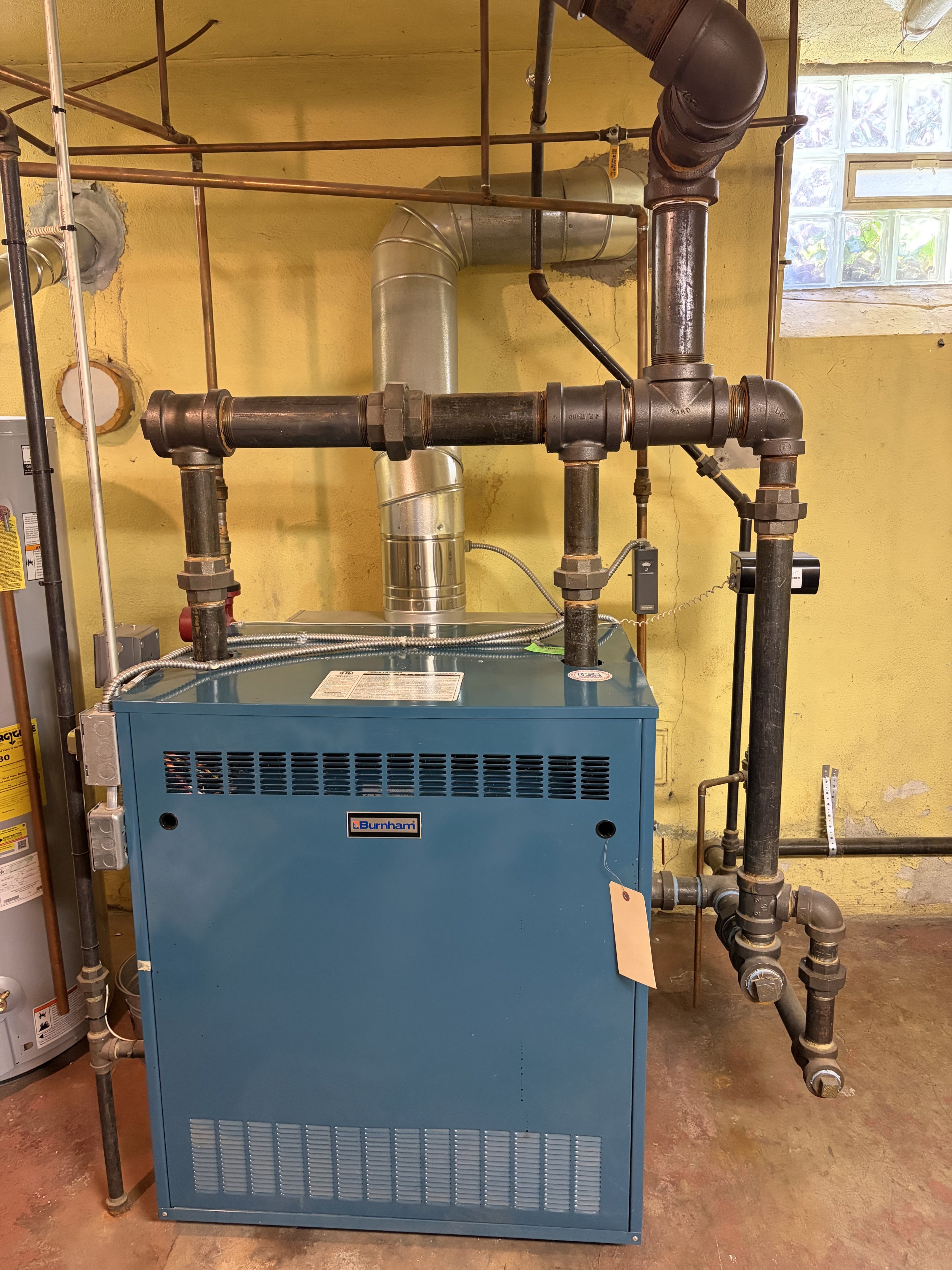

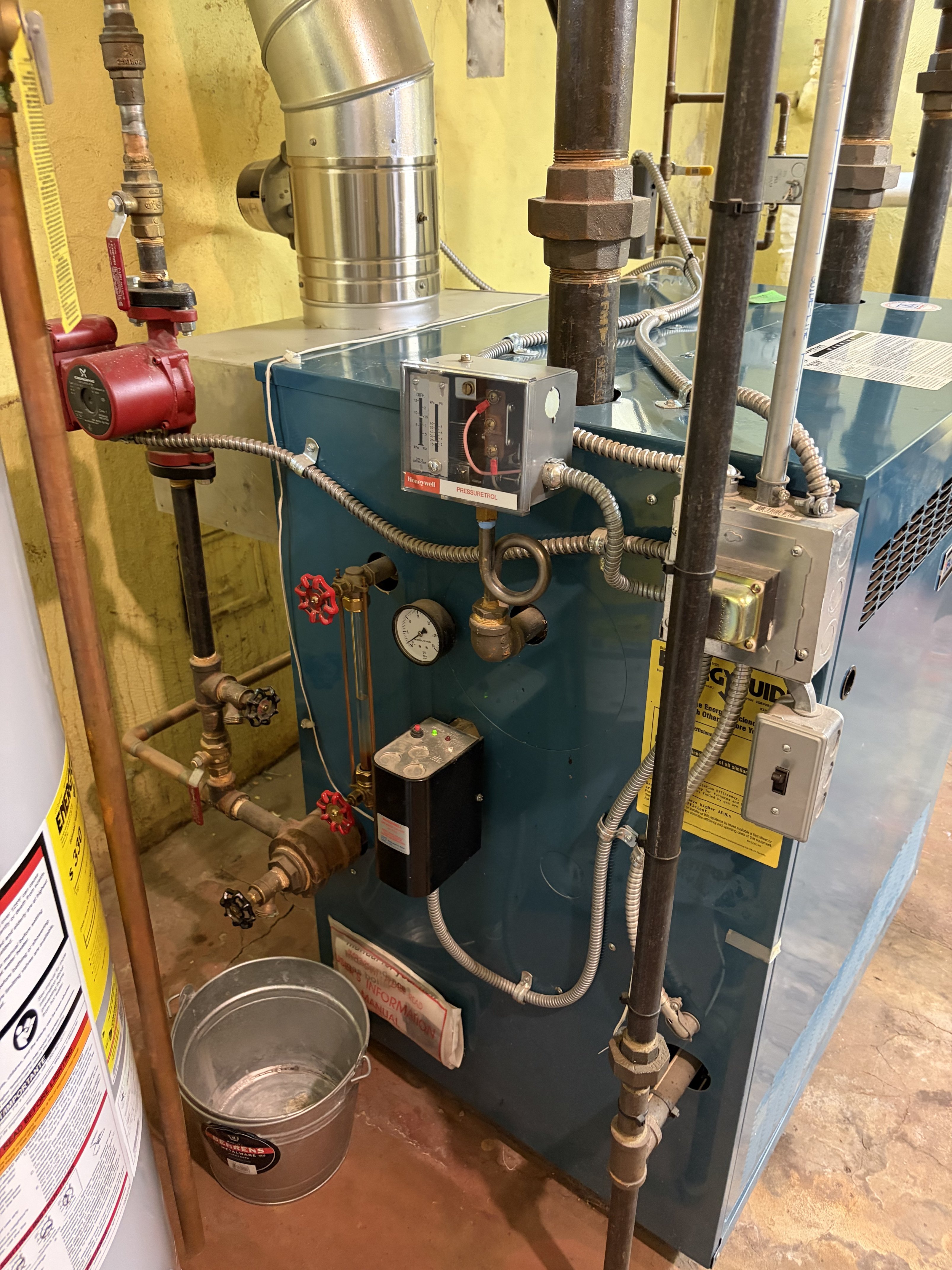

    Thanks, @Steamhead! We do have both books. We got the layman's version because the big book was a little intimidating. But we're looking at Chapter 15 now. Here are some more photos. You'll notice that there's also a hot water pump coming off the boiler which is a whole other topic of conversation. We've had the house just over a year and are making lots of discoveries! Thanks to everyone who is chiming in to help - much appreciated.
    First, here's another radiator with a different-looking trap. FWIW, this one has never gotten hot since we've been here. Followed by photos of the boiler.
    IMG_0136.jpeg IMG_0138.jpeg IMG_0139.jpeg IMG_0140.jpeg IMG_0141.jpeg IMG_0142.jpeg IMG_0143.jpeg IMG_0144.jpeg
    mattmia2 Member Posts: 17,317
    that is a big boiler, i bet it is very much oversized. the circulator i think is for a hot water loop somewhere, that is pretty common and fine if done correctly.
    2.5psig is way too much for a vapor system.
    does the radiator that won't heat that has the trap still have the vapor valve?
    with the insanely high pressure it is very likely you have steam in the returns and that steam is closing the trap from the return side before the radiator can vent and heat. also possible the steam in the return itself is keeping the radiator form being able to vent.
    feel the returns, they should not be steam hot. they may be hot but they shouldn't be as hot as the returns.

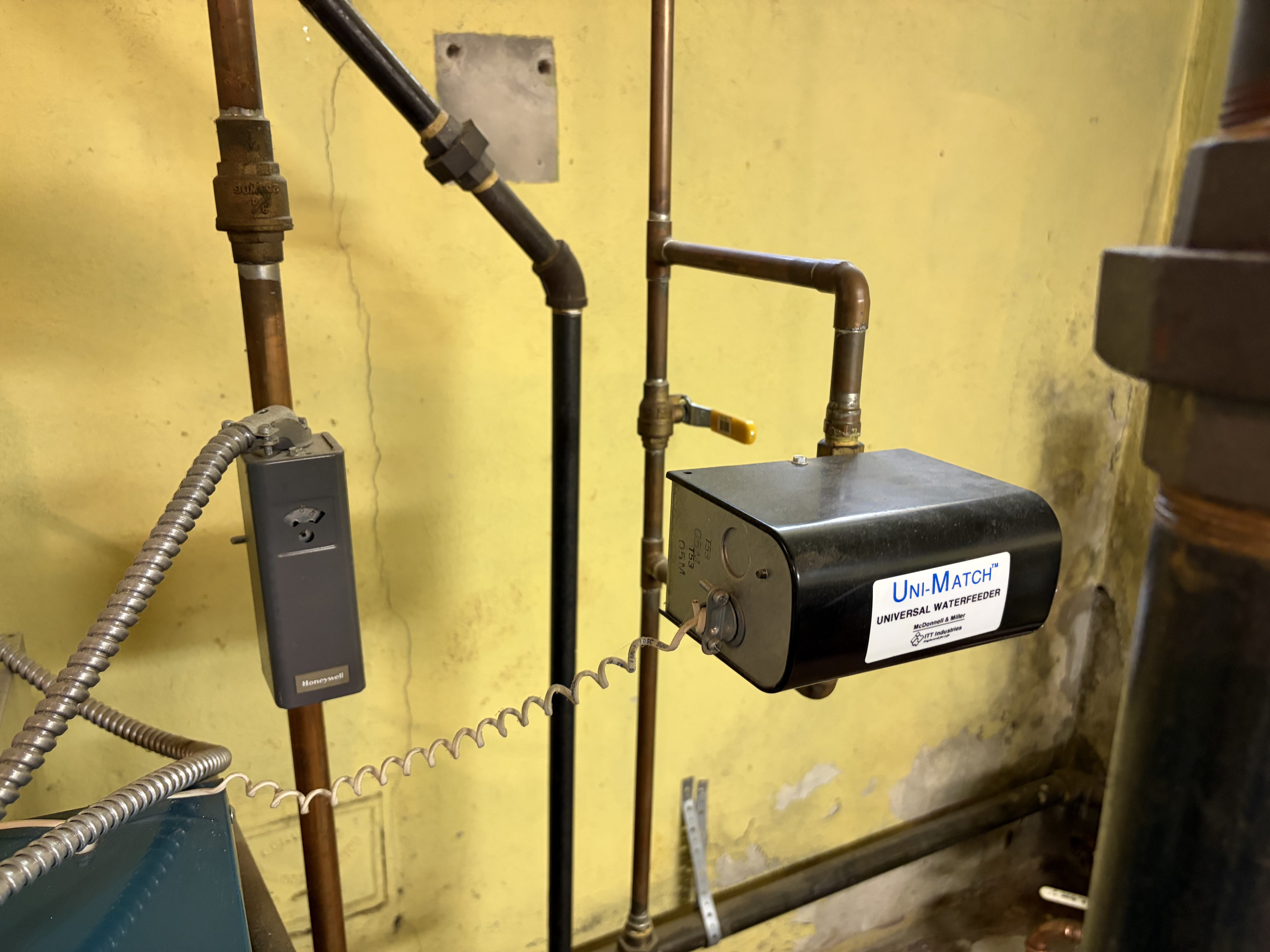

    pecmsg Member Posts: 7,240
    the control on the left what does it control? Where do the wires go?
    Jamie Hall Member Posts: 27,555
    Yes, you do need a vaporstat for that system. The 0 to 16OUNCE per square inch variety, and set it to cutout at 7 ounces with a 4 ounce differential. That radiator that doesn't heat — it may be just fine, but that high pressure is blowing through the other radiators into the returns and will shut it off. The trap on it is a perfectly normal radiator trap. If it's not working, it can be repaired quite easily — but there's no point in seeing whether it's working or not until you get the pressure under control.
    The control on the left is an aquastat —but where the wires go or what it's doing is quite impossible to say from the picture.
    the aquastat is for the hot water loop, it is to fire the boiler up to say 180f when there is a hot water call but not a steam call so the boiler doesn't start steaming on a hot water call only.
