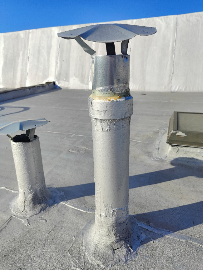

My roof has three such vent pipes. The o.d. measures between 4.6 and 4.8 inch. What size of rain cap should I order?

those look like 4" cast iron stack vents with several roofs built up on the outside of them. since they connect to the sewer they generally don't need a cap.
From the looks of that pipe, I believe you have plumbing vents to the sewage system. These are not the type of vent pipes that are used for venting gas fired appliances. The plumbing code covers this type of vent, not the Fuel Gas Code. The vent cap you show in your link is a vent for a gas furnace or gas boiler vent pipe. I believe your looking for information for a sewer pipe line not a "Chimney" vent pipe

This is an example of a plumbing vent that is connected to the toilet and other drain lines in your home
The yellow parts of the pipes in the above illustration are what your picture illustrates. The green pipes are the same system but contain the wet waste water to the sewer lines. These are sometimes PVC plastic however in older homes that are often Cast Iron Pipe like in your photo. These do not require a rain cap.

No need for a rain cap- the little bit that makes it in goes out with the Drain, Waste, and down the Vent. If you have a problem with suicidal critters you could screen it but that temps critters to build a nest on it, thereby blocking the vent.'Stuff' would cease to drain. That mushroom cap would work but they look like, well…

You don't add vent caps to plumbing vents. Plumbing stacks will carry warm moist out into the atmosphere, like when you take a shower. If you put something on the stack and the temperature drops below freezing you can increase the chance of plugging up the stack with a block of ice. We already have codes that restrict the distance (18"-24") of vent thru the roof to prevent moisture from freezing inside the pipe when it tries to escape out the stack. The exposed part of the stack is going to be the temperature of the ambient or close to it.

Most of these vent stacks are just open to the sky and that's totally fine and normal. Sometimes you'll see where a super has put wire mesh over top to keep critters out, but if you go that route make sure you go with a large hole mesh and check every once in a while and make sure they're not plugged up with anything caught in it.

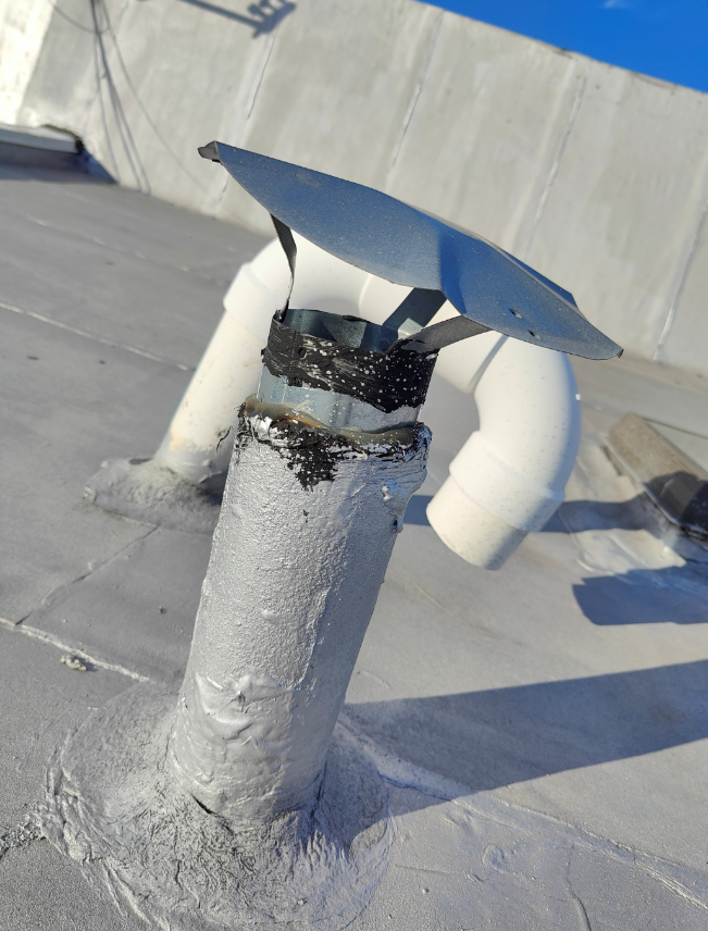

this is the rain cap on the neighbor's roof. the cap has 4" base fitted into the stack vent then sealed with asphalt or silicone
@EdTheHeaterMan is this cap actually meant for a furnace vent?
if i were to fabricate something like that I would probably clamp it on the outside with a hose clamp instead of sticking it inside, when it is inside it reduces the id of the pipe and makes it more prone to icing.
I have never seen a sewer vent on a roof with any cap.
My house had a 90 deg elbow someone stuck on the 4" pipe for some bizarre reason but it's long gone.
There's no reason to have a cover on it, it literally goes to the sewer, rain isn't going to be a concern.

Yes, that is a gas furnace vent cap. it is designed to keep rain from falling into the exhaust vent of a gas fired heating system of sorts.
