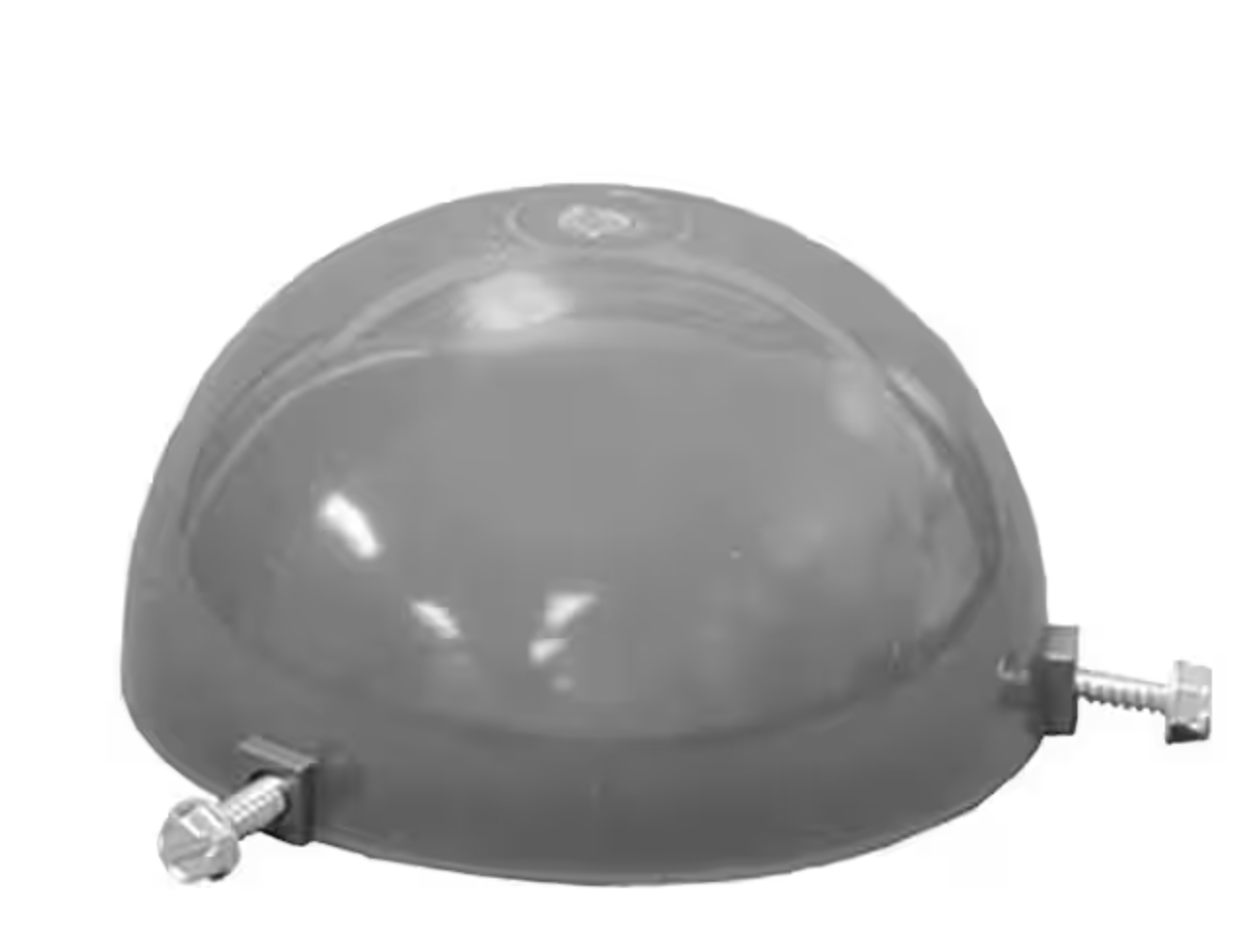

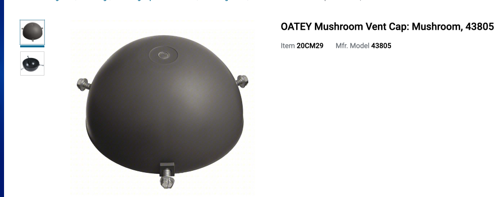

this mushroom vent cap should be the right cap for DWV pipe
https://www.amazon.com/Oatey-43805-Mushroom-Vent-Cap/dp/B000BO6PKO
those caps were commonly used on yard trap vents in your lawn. Mainly to keep stuff from dropping down into the trap.
Putting one on you house vent on the roof could lead to frost closing off the vent and the entire system not being vented.
No harm in trying, observe in winter for a frost ball forming around the cap.

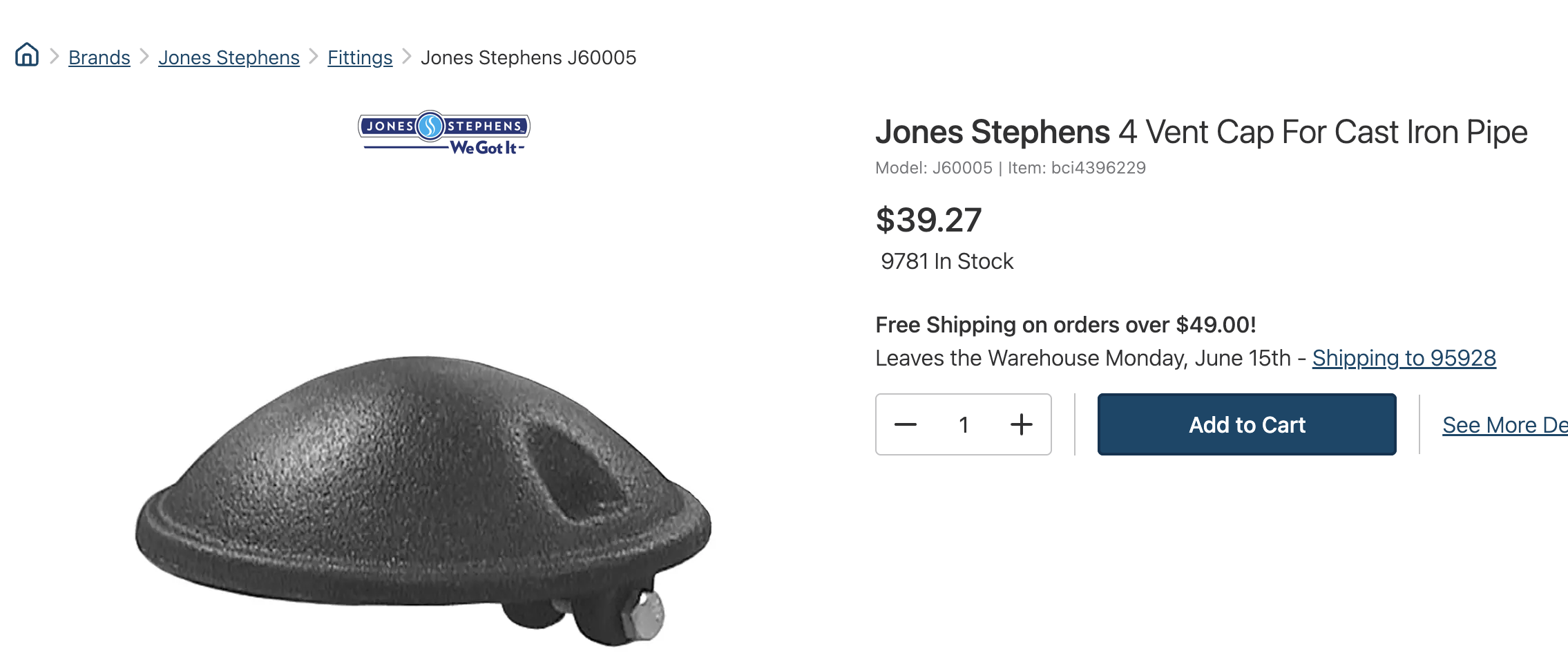

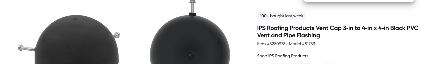

Jones, IPS, Oatey, and other make sewer caps, must be someone installing them.
The ones I remember were those cast iron type with a single pinch screw.

Aren't those for vents down by the ground, like for building / house traps?
those are to prevent the kids from filling up the ground level house trap with rocks.
I've seen caps like that on oil tank vents.
Does it mater if it is on the vent of a house trap in the lawn or on them roof? in either case is sees the sewer gas and is intended to keep debris out.
If it is installed on the VTR and it frosts over, remove it, simple enough?
