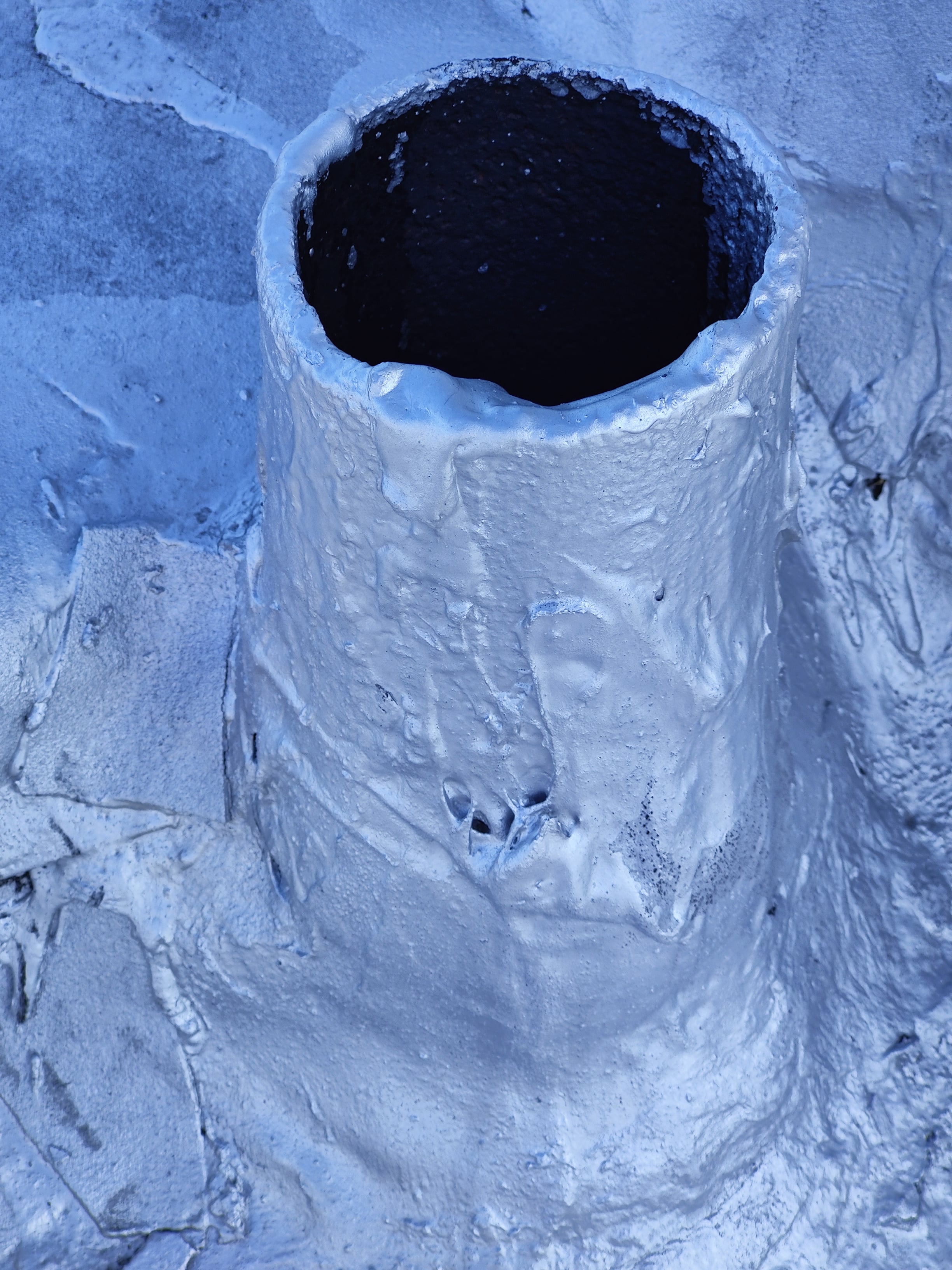

My roof has three such vent pipes. The o.d. measures between 4.6 and 4.8 inch. What size of rain cap should I order?
https://www.amazon.com/ventsgalvanized-rainproof-galvanized-Adjustable-customizable/dp/B0CRJVNF1X
    mattmia2 Member Posts: 17,282
    those look like 4" cast iron stack vents with several roofs built up on the outside of them. since they connect to the sewer they generally don't need a cap.

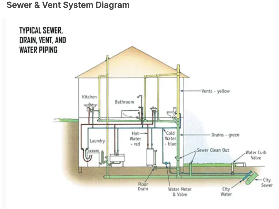

    EdTheHeaterMan Member Posts: 12,468

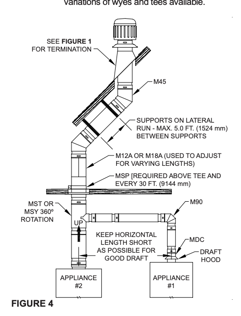

    From the looks of that pipe, I believe you have plumbing vents to the sewage system. These are not the type of vent pipes that are used for venting gas fired appliances. The plumbing code covers this type of vent, not the Fuel Gas Code. The vent cap you show in your link is a vent for a gas furnace or gas boiler vent pipe. I believe your looking for information for a sewer pipe line not a "Chimney" vent pipe
    Furnace vent where exhaust from a gas flame exits the roof.
    This type of vent pipe is rarely cast iron and it is recommended that you have a rain cover to keep rain water and critters from entering your heating system.
    This is an example of a plumbing vent that is connected to the toilet and other drain lines in your home
    The yellow parts of the pipes in the above illustration are what your picture illustrates. The green pipes are the same system but contain the wet waste water to the sewer lines. These are sometimes PVC plastic however in older homes that are often Cast Iron Pipe like in your photo. These do not require a rain cap.

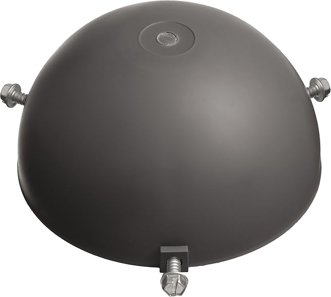

    this mushroom vent cap should be the right cap for DWV pipe
    https://www.amazon.com/Oatey-43805-Mushroom-Vent-Cap/dp/B000BO6PKO
    hot_rod Member Posts: 27,759
    those caps were commonly used on yard trap vents in your lawn. Mainly to keep stuff from dropping down into the trap.
    Putting one on you house vent on the roof could lead to frost closing off the vent and the entire system not being vented.
    No harm in trying, observe in winter for a frost ball forming around the cap.

    No need for a rain cap- the little bit that makes it in goes out with the Drain, Waste, and down the Vent. If you have a problem with suicidal critters you could screen it but that temps critters to build a nest on it, thereby blocking the vent.'Stuff' would cease to drain. That mushroom cap would work but they look like, well…

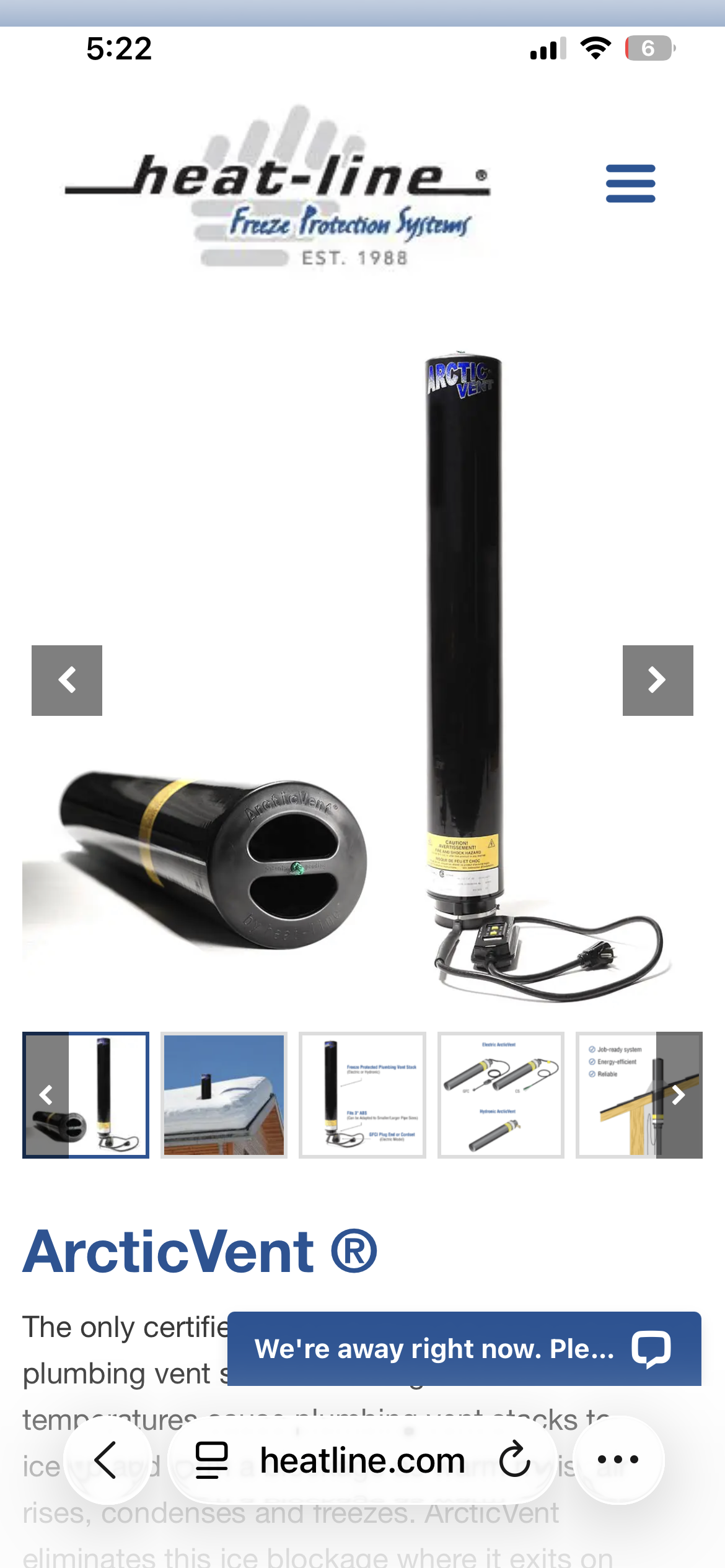

    there is actually a company that makes an electric or hydronicaly heated double wall vent termination piece. Invented by a Canadian electrician😉
