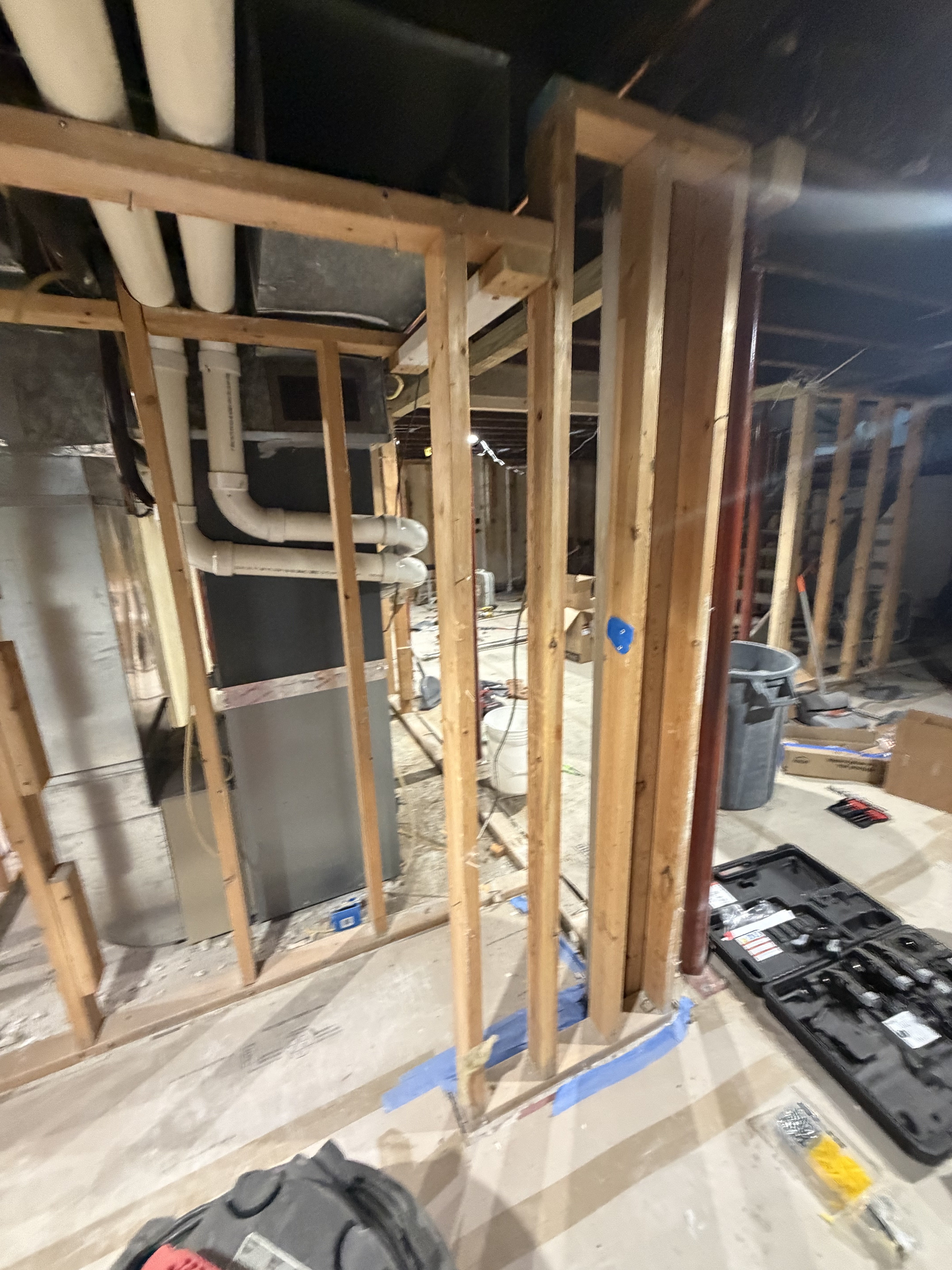

  • Furnace is located roughly in the center of the basement
  • Current furnace: Rheem RGRK-10EZAJS, around 20 years old, still working
  • Furnace is a 90+ condensing gas furnace, approx. 105k BTU input / 92% AFUE, two-stage

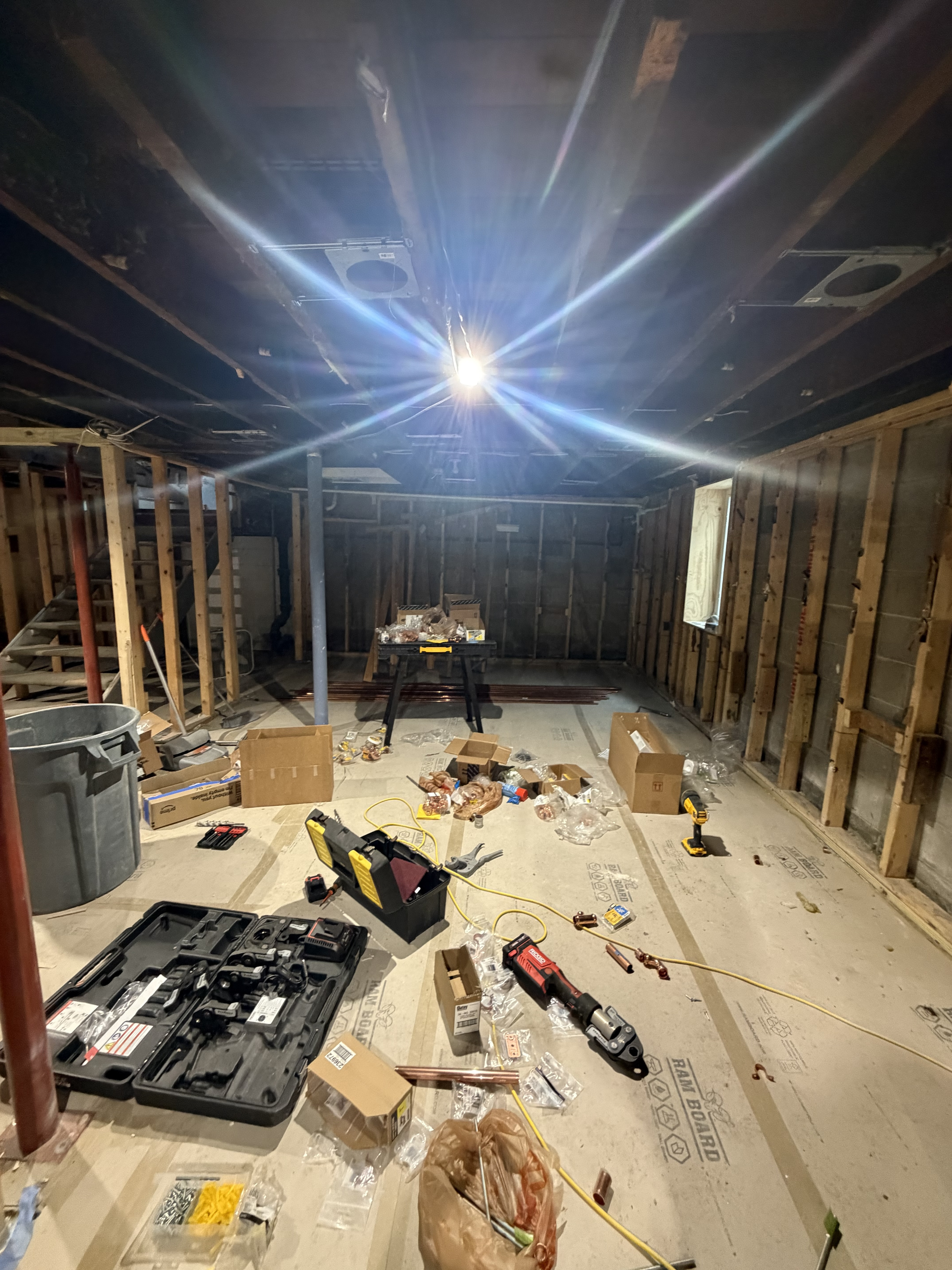

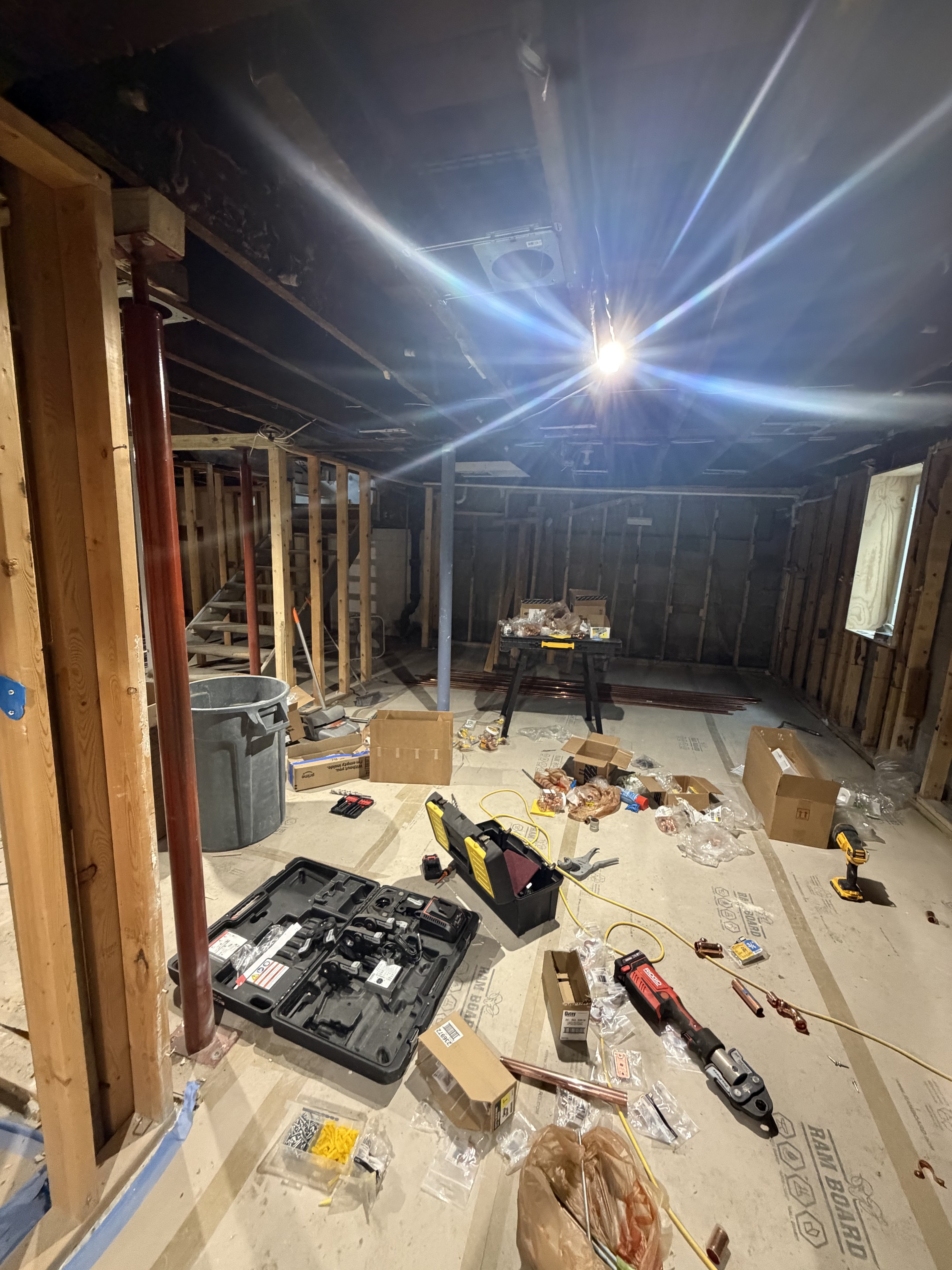

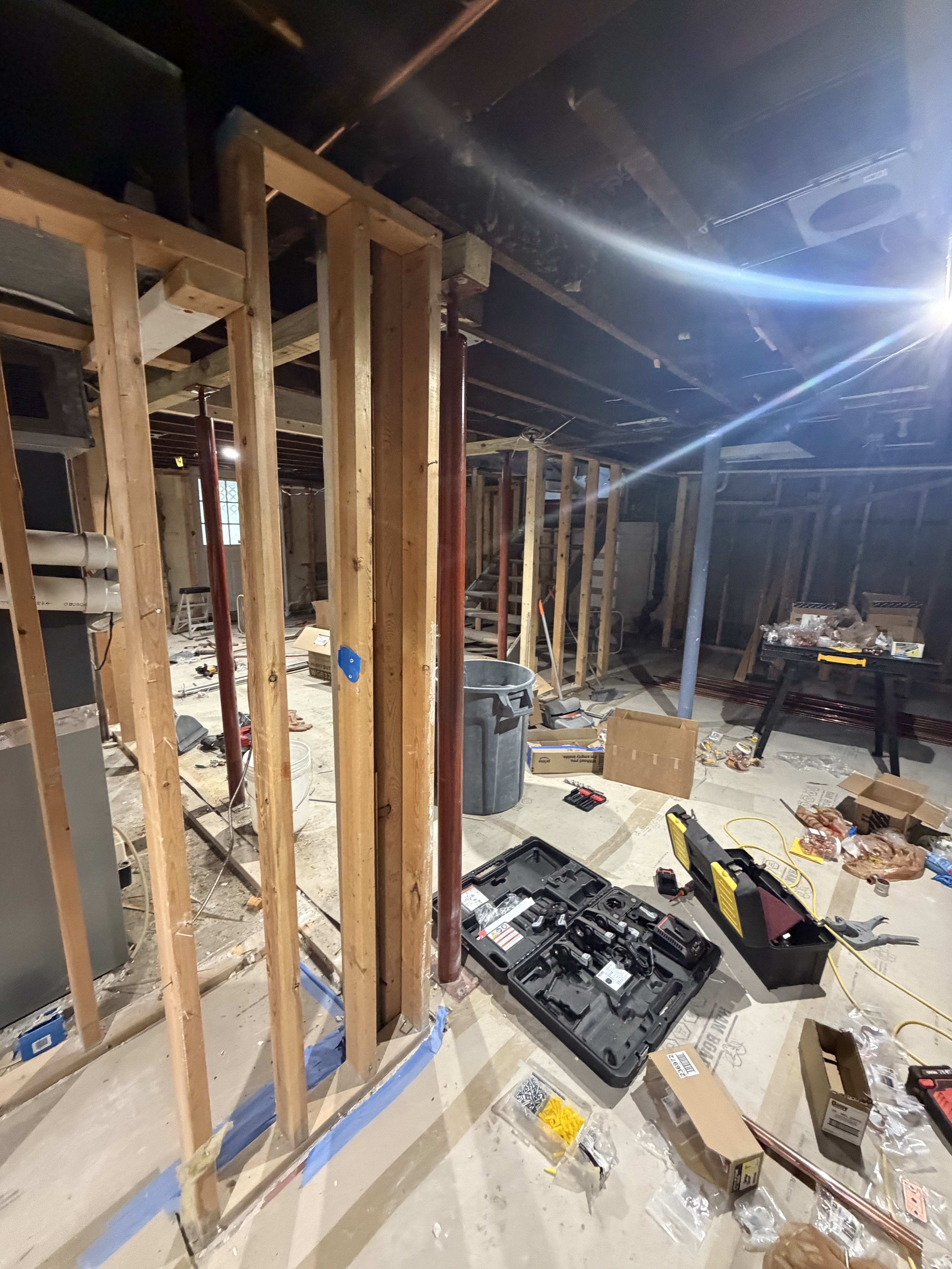

The basement framing makes duct routing tricky.
The joists run north to south, but because it is a very old home, the joists are notched and tied into three large beamsspaced evenly across the basement.
Because of those beams, it seems like ductwork may not be able to stay neatly inside the joist cavities. To cross the beams, ductwork may need to drop down and go around them, outside of the joist cavity, which could be an issue because the basement ceiling height is already low.
I’m trying to understand the best way to design ductwork around these beams without creating a bad system with high static pressure, poor airflow, or a low basement ceiling full of duct drops.

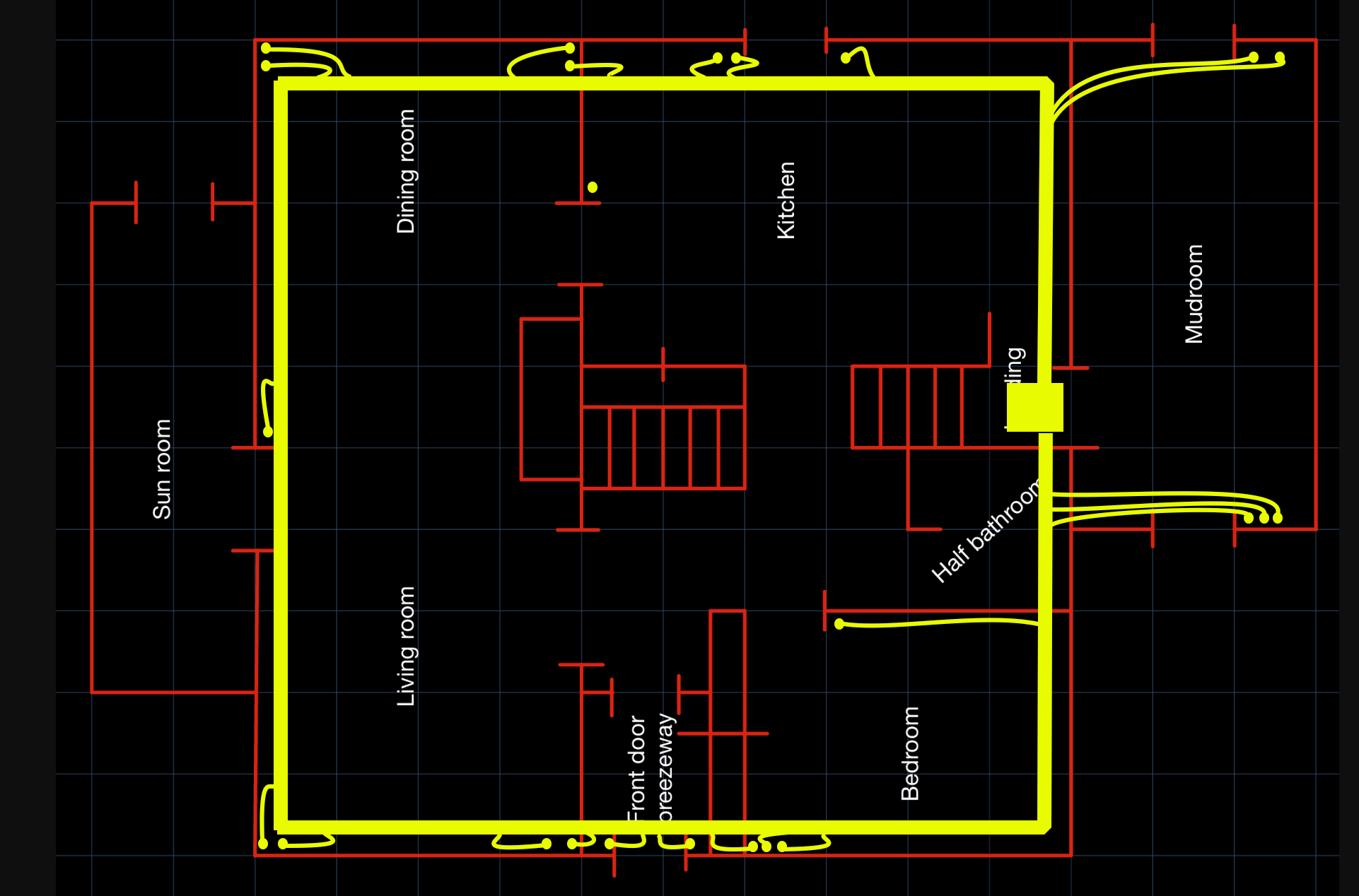

    This is the main floor layout

    I'm not going to comment on the ductwork — not my field at all — except to say that you are going to have a dickens of a time getting comfortable heating… A/C maybe yes, but heating? Were it mine, I'd go with hot water heat and baseboards or panel radiators, or maybe even radiant floors. But that's me
    What I will comment on is a structural issue. Whatever you do, do NOT notch, drill through, or cut into those "three large beams" The technical term for them is summer beams (no, I don't know why) and they are critical pieces of the whole structure. Worse, though old wood is much stronger than new, summer beams of that sort are actually very highly stressed, and can almost be guaranteed to break if they are notched, drilled through, or otherwise messed with — and they won't do it right away.
    Old timber joists can be drilled through, but only in the middle third of their vertical and the hole most not be more than one sixth of the depth of the joist, nor may holes be spaced closer than twice the depth of the joist. Never cut or notch either the top of bottom.

    The way I have avoided head bangers in low basements is by running the trunk along the outside wall. You can even run the trunk on edge so it takes up less space and frame it into the basement walls. In your case with pocketed beams, I would put the air handler in one of the corners and run a trunk on either side of the basement. From there you can do short takeoffs to registers.

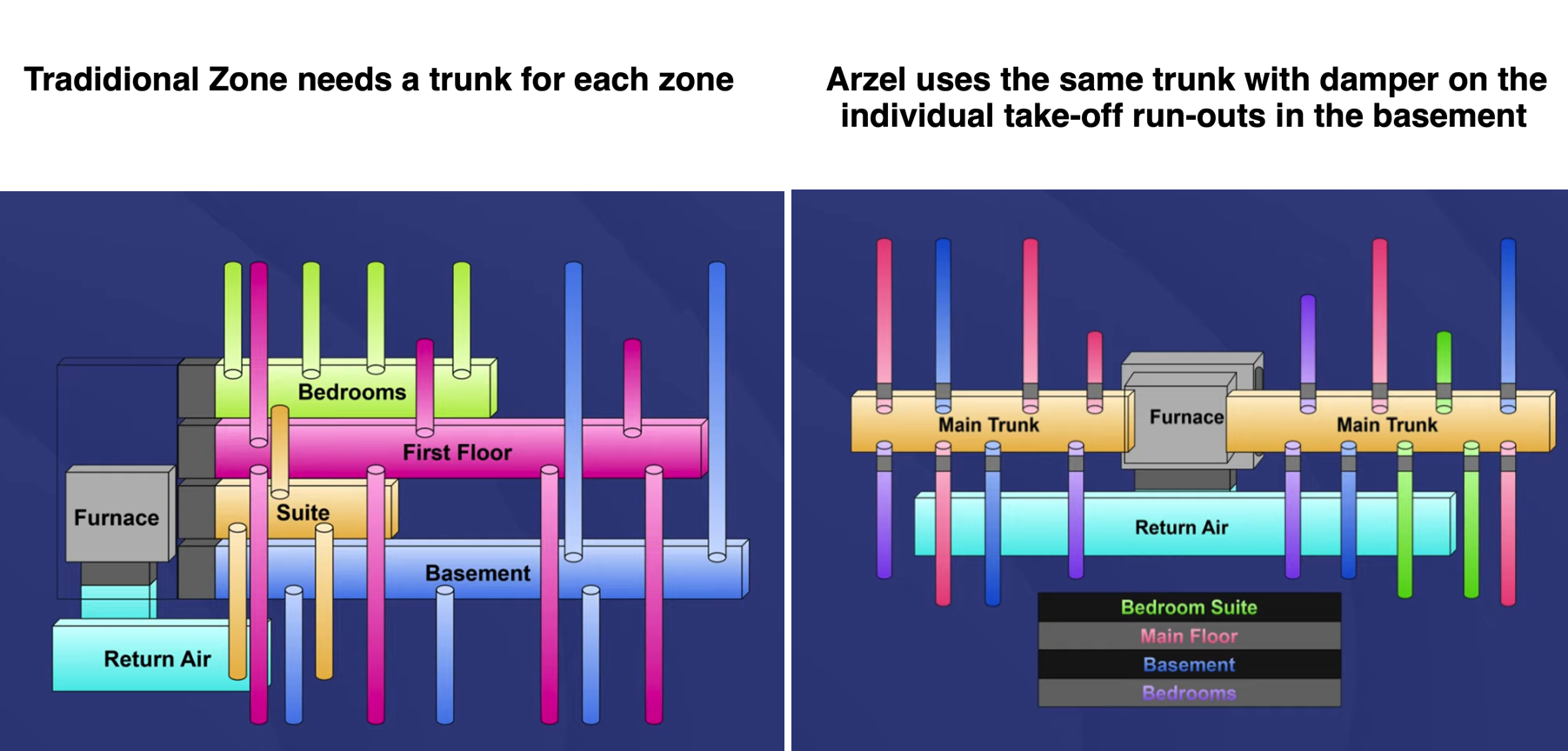

    My grandmother’s home was built in the 1930s and was heated with hot water radiators. There were beautiful radiator covers over them in most rooms. In the 1950s, air conditioning was added, and that was completed with high-velocity 2" ductwork. I know this because of this story:
    In your situation, I would take a serious look at using a high-velocity system for your ductwork. I also like @Jamie Hall's suggestion of considering a boiler for heating . You have so many possibilities: fan coils for the high-velocity system, radiant floor heat for the bathrooms or even for the entire home, panel radiators, or even selecting some beautiful cast iron radiators sourced from places like eBay or Craigslist for that special period look in your home (if that is what you are going for). You could even melt the snow from your entry walkway with a boiler.
    Here is a 2-ton high-velocity system duct design where the main trunk is 8" in diameter with 1" insulation (10" outside diameter) and 20 or so 2" outlets in all the first-floor rooms. A load calculation may find that you only need 1.5 tons for the first floor. This solves the problem of those 3 main beams by using the perimeter Trunk Duct idea that @Kaos referred to.
    I would separate the sunroom, with all that glass, with a mini-split system for cooling and heating. If needed, on cloudy days near design temperature, a hydronic radiator of some sort might be appropriate and can be added later if you find that the mini-split HP is insufficient. Just rough in some 3/4" oxy barrior tubing inside the wall where you might like to set that (those) radiator(s)
    For the second floor, I would use 1½" insulation on the trunk duct and place all the outlets in the ceiling. The turbulent airflow from high-velocity systems will cause the room air to mix from top to bottom, eliminating stratification in the heated space even though the heat is entering from the ceiling. That is one of the benefits of high-velocity systems.
    Just be sure your installing contractor uses sound-attenuating ductwork for the last 4 to 5 feet of the supply runs. here is why: a new customer with big bucks has a noise problem in Cape May NJ. He didn't know he had the problem until i did a test:

    I completely agree, in no way will we notch or do anything to those "summer beams." I had no plans to do anything to alter them, but thank you for confirming that.

    He also strongly recommended using Arzel zoning dampers instead of traditional motorized dampers. He said this would avoid needing twice as much ductwork or four separate trunks, and instead we could have two main trunks with the Arzel dampers controlling the zones. He said it would be quicker and easier to install.
    I’m trying to understand whether this is a good design approach or just a simpler install for the contractor.

    • Is the claim that Arzel would avoid needing “four trunks” and allow two trunks instead actually a good design reason, or is that oversimplifying things?

    After looking at the Arzel system information, I really like the concept. It is almost as if they were reading my mind back in the 1980s and 1990s and actually built the system I had envisioned. If I were still installing systems, I would definitely try this equipment in my own home first just to see how easy it is to install and set up.
    The videos seem to support the concept of a single supply trunk and a single return trunk. One system can serve two zones—or more—simply by closing off the first-floor branch runs when the second floor needs cooling, or closing off the second-floor branch runs when all you need is heat on the first floor.
    I have installed systems with as many as four zones on a single furnace or air handler and used a duct temperature sensor along with a barometric bypass damper with some success. However, I believe that the combination of today's inverter-driven systems, variable-capacity compressors, and ECM blower motors that can ramp up and down based on inputs from the Arzel panel is truly a game changer.
    I wish something like this had been available years ago at what appears to be such an affordable price and with the ease of installation that Arzel seems to offer.I would still look at the price of the two-system high-velocity option and compare it to the price of a variable-speed (or at least two-stage) system with zoning. In other words, compare the cost of two smaller, more expensive systems to one larger system that is capable of staging and equipped with multiple zone dampers. You may find that both approaches cost about the same.
    Rest assured that either approach will solve your temperature stratification problems.
    Just don't go cheap while the house is in this condition. If you can get basement ducts to the second floor while the walls are open like this, you can have an excellent system with only one set of equipment.
    On the other hand, if you decide on the high-velocity system with all the ductwork buried in the attic insulation and an insulated mechanical room in the attic for the air handler, that is also a very good option. Pairing it with a modulating-condensing boiler opens up additional possibilities. The boiler can provide space heating, domestic hot water, snow melting for the walkway, and perhaps even radiant floor heating for the bathroom.

    I have a question about your basement.
    Have you ever been in that basement in the middle of the summer when the first and second floors were unbearably hot on a 95°+ day? I'm sure you have. Now think about the temperature in that basement without central air conditioning. Was it ever so hot down there that you needed to leave? I'll bet you remember that the basement was the coolest part of the house on those dog days of summer, even without central AC.
    Now think about adding four supply ducts to the basement and making that basement drop to 60° when you set the first-floor thermostat to 72°. You have now paid for four additional supply runs that eventually need to be closed off. The dampers on supply registers never achieve a 100% seal, so now you have a whistling noise coming from those closed-off registers, with perhaps 10% of the air still leaking into the basement. That additional noisy conditioned air will cause the basement to remain at about 65°, even with the registers "closed."
    Next, you decide to remove those openings, seal the cutouts, and mastic everything so there is no leakage. Then you reinstall the duct insulation. Now you have paid to have those four supply registers removed. After spending all that extra money, your basement is now 68° or 69°.
    And to think, you could have had that same result if you had never installed those four supply runs in the basement in the first place.
    Ask me how I know this!
    EDIT
    follow up: if the basement is too hot after you have central airconditioning installed in the first floor, you can always add a duct or two. But I guarantee you that 4 is way too many. Start out with zero and see what happens. You will be pleasantly surprised.
    You need to decide if the head room is more important in the basement or the lower price single zone standard basement duct system is better. If you use the High Velocity in the basement You can save head room.

    Based on the dimensions on your drawings, the stairways do not line up and the chimney location for the furnace does not line up from the first floor to the basement. But this is the best I can come up with (above). In the next illustration for 8" insulated round plenum for high velocity cooling and heating you can see one area where the headroom in the basement is reduced to accommodate the 8" plenum from the utility area near the center of the basement. If you place the AHU on the north wall in what appears to be a closet in the basement, then you eliminate the head knocker but you are restricted on the return duct location fro the first floor to the AHU. In this illustration with only 4 typical supply runs shown you loose head room all around the edge of the basement, leaving the center of the room open without head knockers.
    Of course it you decide that having less head room to accommodate the additional duct needed for zoning or two systems, then you can use the lower cost system.

    There is no easy solution here. With that low ceiling height you don't want any trunks across the basement.
    Here is the rough stab at one option.
    Because of the dropped beam, you would loop the supply trunk around the outside of the basement. These can be either on the ceiling but will block the windows slightly or you can run them on flat bellow the windows and then build it into the walls. The return can run under the basement stairs and go up inside the walls of the main floor powder room to the 2nd floor.
    From there takeoffs and floor register at the windows and feeds to the mud room and sun room.
    On the main floor, the two supply trunks come up in the corners of the kitchen cabinets which are useless space anyways and run mostly across the top of the cabinets.
    Top takeoffs from these two trunks through the 2nd floor joist bays to floor registers as needed in the 2nd floor.
