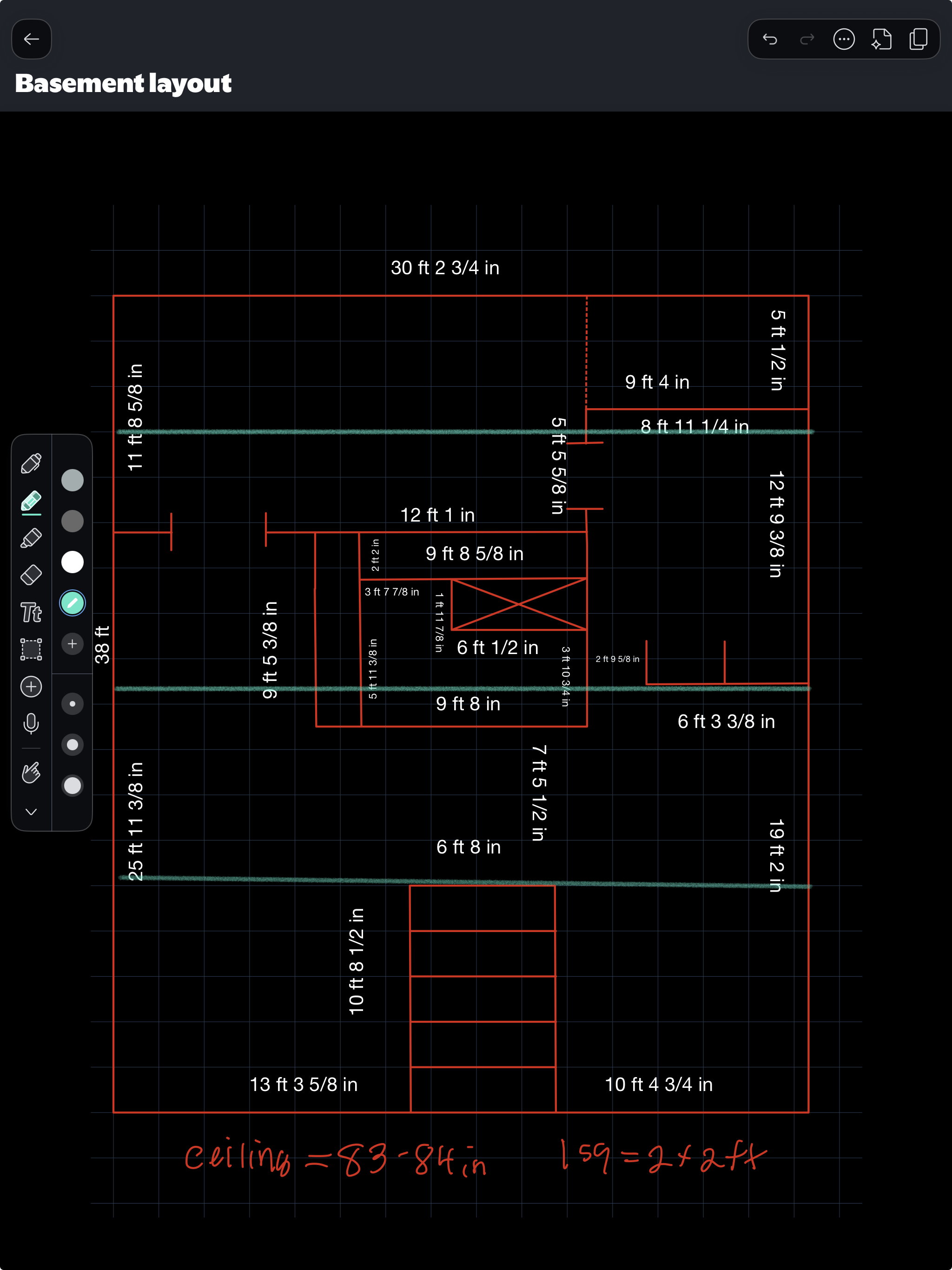

The joists run north to south, but because it is a very old home, the joists are notched and tied into three large beamsspaced evenly across the basement.
Because of those beams, it seems like ductwork may not be able to stay neatly inside the joist cavities. To cross the beams, ductwork may need to drop down and go around them, outside of the joist cavity, which could be an issue because the basement ceiling height is already low.
I’m trying to understand the best way to design ductwork around these beams without creating a bad system with high static pressure, poor airflow, or a low basement ceiling full of duct drops.

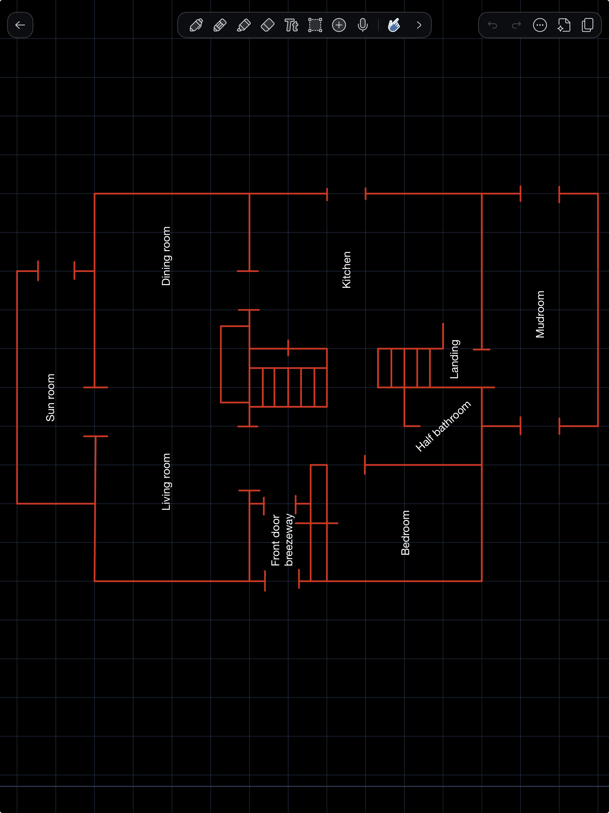

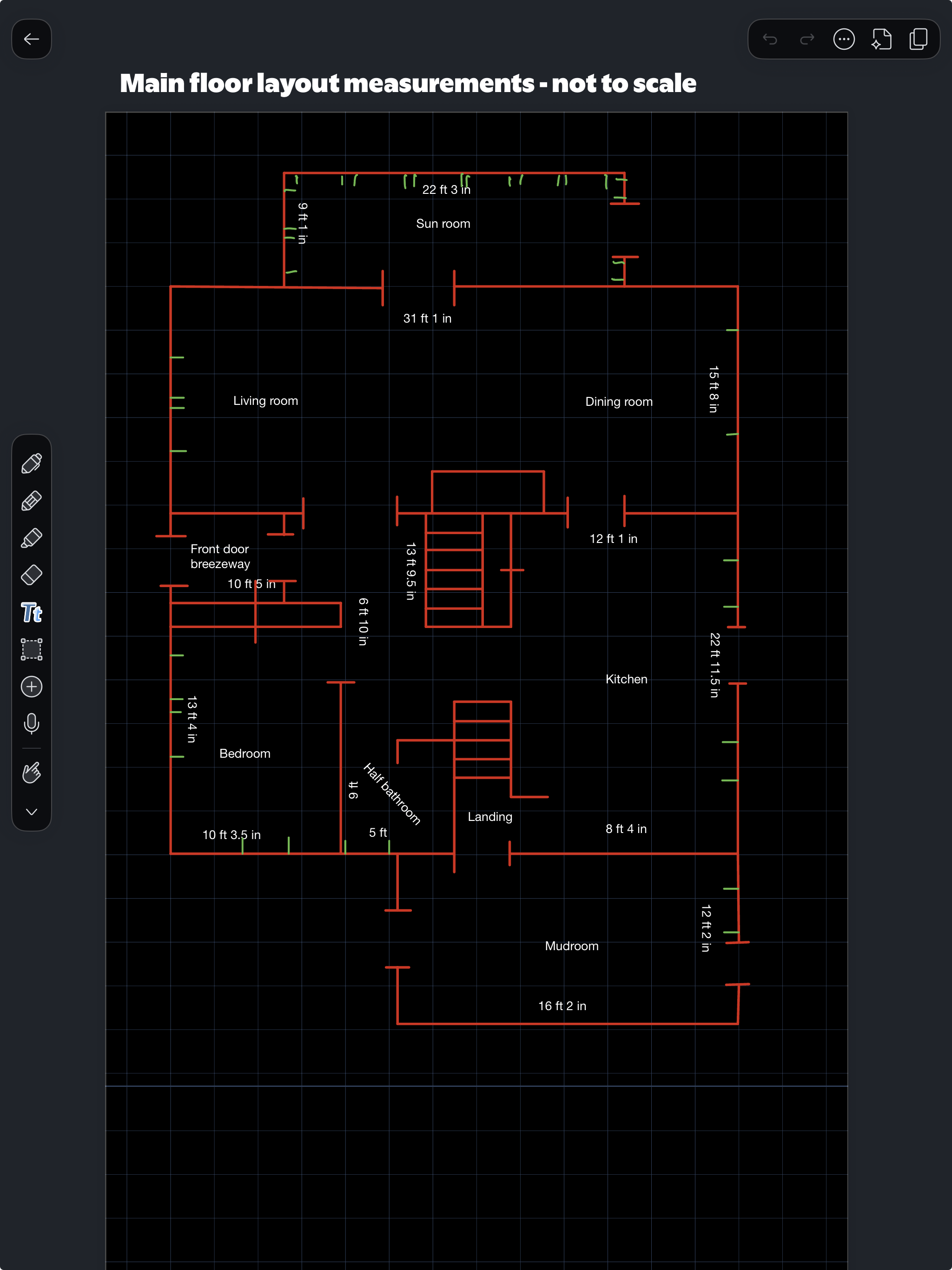

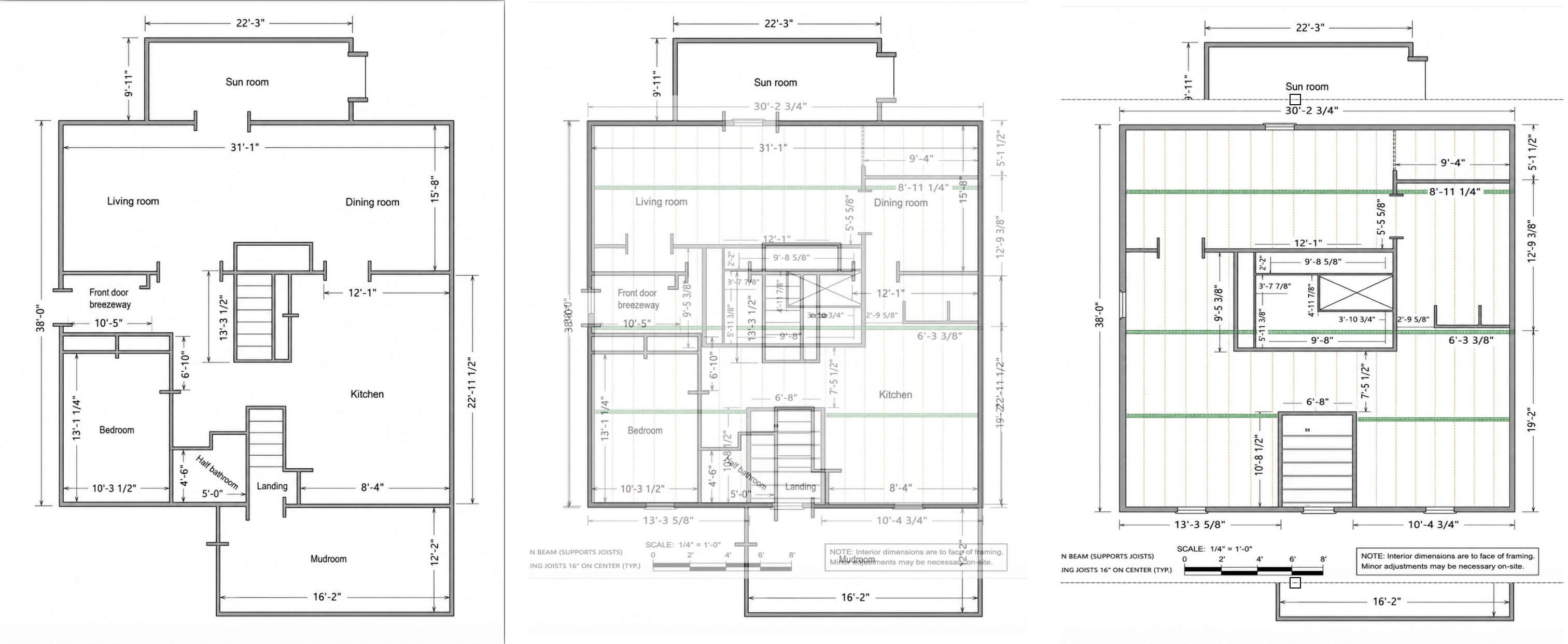

    This is the main floor layout
    It's pretty impossible to see any duct layout issues without being on site. Unfortunately, most installers will undersize the duct. High static won't be an issue if they size the duct right. You want all the ductwork sealed and either insulated or lined.
    Running the 2d floor supplies to the attic and coming down will work for AC not great for heat and in your location, I would not do that.
    If they quote flex duct it is ok but is restrictive. If it is sized with the restriction in mind it should still be limited in length.

    The way I have avoided head bangers in low basements is by running the trunk along the outside wall. You can even run the trunk on edge so it takes up less space and frame it into the basement walls. In your case with pocketed beams, I would put the air handler in one of the corners and run a trunk on either side of the basement. From there you can do short takeoffs to registers.

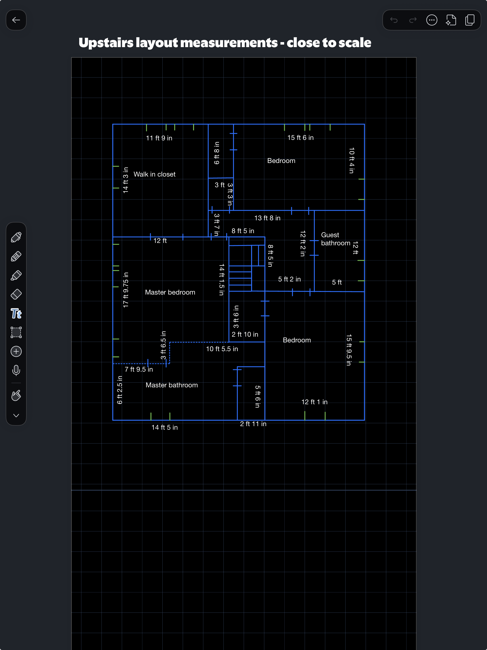

    Do a man J and a rough draft of the duct layout and post it. We can help you dial it in from there.

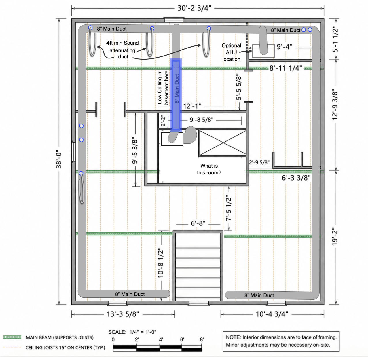

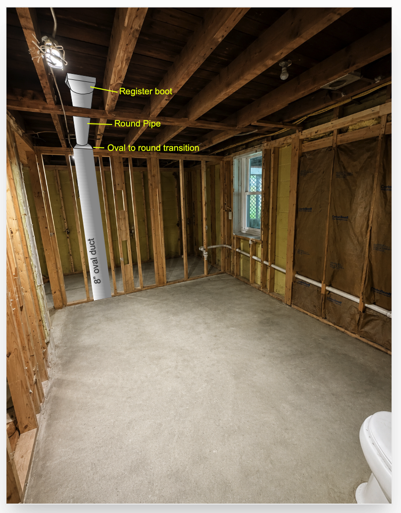

    My grandmother’s home was built in the 1930s and was heated with hot water radiators. There were beautiful radiator covers over them in most rooms. In the 1950s, air conditioning was added, and that was completed with high-velocity 2" ductwork. I know this because of this story:
    In your situation, I would take a serious look at using a high-velocity system for your ductwork. I also like @Jamie Hall's suggestion of considering a boiler for heating . You have so many possibilities: fan coils for the high-velocity system, radiant floor heat for the bathrooms or even for the entire home, panel radiators, or even selecting some beautiful cast iron radiators sourced from places like eBay or Craigslist for that special period look in your home (if that is what you are going for). You could even melt the snow from your entry walkway with a boiler.
    Here is a 2-ton high-velocity system duct design where the main trunk is 8" in diameter with 1" insulation (10" outside diameter) and 20 or so 2" outlets in all the first-floor rooms. A load calculation may find that you only need 1.5 tons for the first floor. This solves the problem of those 3 main beams by using the perimeter Trunk Duct idea that @Kaos referred to.
    I would separate the sunroom, with all that glass, with a mini-split system for cooling and heating. If needed, on cloudy days near design temperature, a hydronic radiator of some sort might be appropriate and can be added later if you find that the mini-split HP is insufficient. Just rough in some 3/4" oxy barrior tubing inside the wall where you might like to set that (those) radiator(s)
    For the second floor, I would use 1½" insulation on the trunk duct and place all the outlets in the ceiling. The turbulent airflow from high-velocity systems will cause the room air to mix from top to bottom, eliminating stratification in the heated space even though the heat is entering from the ceiling. That is one of the benefits of high-velocity systems.
    Just be sure your installing contractor uses sound-attenuating ductwork for the last 4 to 5 feet of the supply runs. here is why: a new customer with big bucks has a noise problem in Cape May NJ. He didn't know he had the problem until i did a test:

    EdTheHeaterMan Posts: 12,946
    @Kaos mentioned that an attic is never a great place to put an air handler and ductwork . I agree. I even had the opportunity to change a customer's mind about doing just that.
    It was a one-story home that had been flooded during Hurricane Sandy and was ultimately raised above the new FEMA flood-level standards. This created a 12-foot-high "crawl space" beneath the home, since the area below the flood level could not be counted as a basement. As a result, there was approximately 3 feet of usable space below the floor joists that remained above the flood level.
    Relocating the air handler and ductwork from the attic to this space changed the cooling load calculation from 3½ tons to 3 tons. Simply moving the equipment and ductwork out of the attic reduced the required cooling capacity by 6,000 BTUs.
    On a two story home, he challenge is often finding a suitable location for the equipment and determining whether the customer is willing to make the necessary sacrifices to have a better-performing system. Too often, the competition advocates for an attic installation because it avoids the need for soffits or a mechanical room and preserves valuable living space. After all, there is a perfectly good attic available to hide all that equipment. With high-velocity systems, that hot attic is less of a factor in equipment sizing. One reason is that the air does not remain in the ductwork as long as it does in a conventional duct system. It is moving much faster and therefore loses less energy to the hot attic.
    Another benefit is that if the attic is insulated with R-50 blown-in cellulose, most, if not all, of the ductwork will be buried within the insulation. This further reduces heat gain from the attic.
    Perhaps a small closet could be used to house the air handler so that service can be performed without having to enter the attic. I believe this is a better idea, even with the additional equipment and installation costs for this type of home.
    However, with a renovation that is so comprehensive, I believe two zones and separate duct systems are easier to install and allow for larger trunk ducts and other options. Since the basement's low headroom was mentioned, I believe the basement headroom has to be included in the design, with perimeter trunk ducts used to keep the headroom from becoming a factor. I like the idea if an insulated room in the attic for the AHU by @Jon_blaney

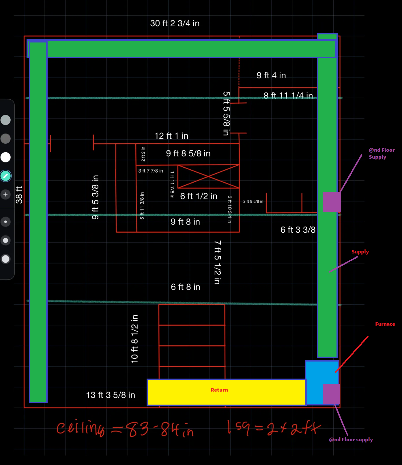

    @Jamie Hall thanks for the advice. I have considered adding in radiant heating but I thought if we need to run all the ductwork for AC then we might as well use it for heating and cooling.
    I completely agree, in no way will we notch or do anything to those "summer beams." I had no plans to do anything to alter them, but thank you for confirming that.

    @Steamhead @EdTheHeaterMan @Kaos @Jamie Hall @pecmsg @Jon_blaney
    Thank you from the bottom of my heart to everyone who commented! I immensely appreciate everyone’s input and help more than I can say. I'm just trying to make sure everything is right the first time.
    A little more info on the project: I'm in the southern half of Michigan. We bought the house from someone we know for a really great price, and it is completely gutted. We've removed all the old knob-and-tube wiring. I've rewired almost the entire house myself so far, and I will be doing all the copper/PEX plumbing layouts too. I just haven't done much ductwork. We are working on a fairly tight budget, but I understand that this is a massive project and it must be done correctly.
    Because it's down to the studs, we are doing the insulation the right way to get it decently airtight. Our plan is a hybrid flash-and-batt system (spray foam paired with cellulose) in our true 2x6 exterior walls, plus thick blown-in cellulose in the attic floor.

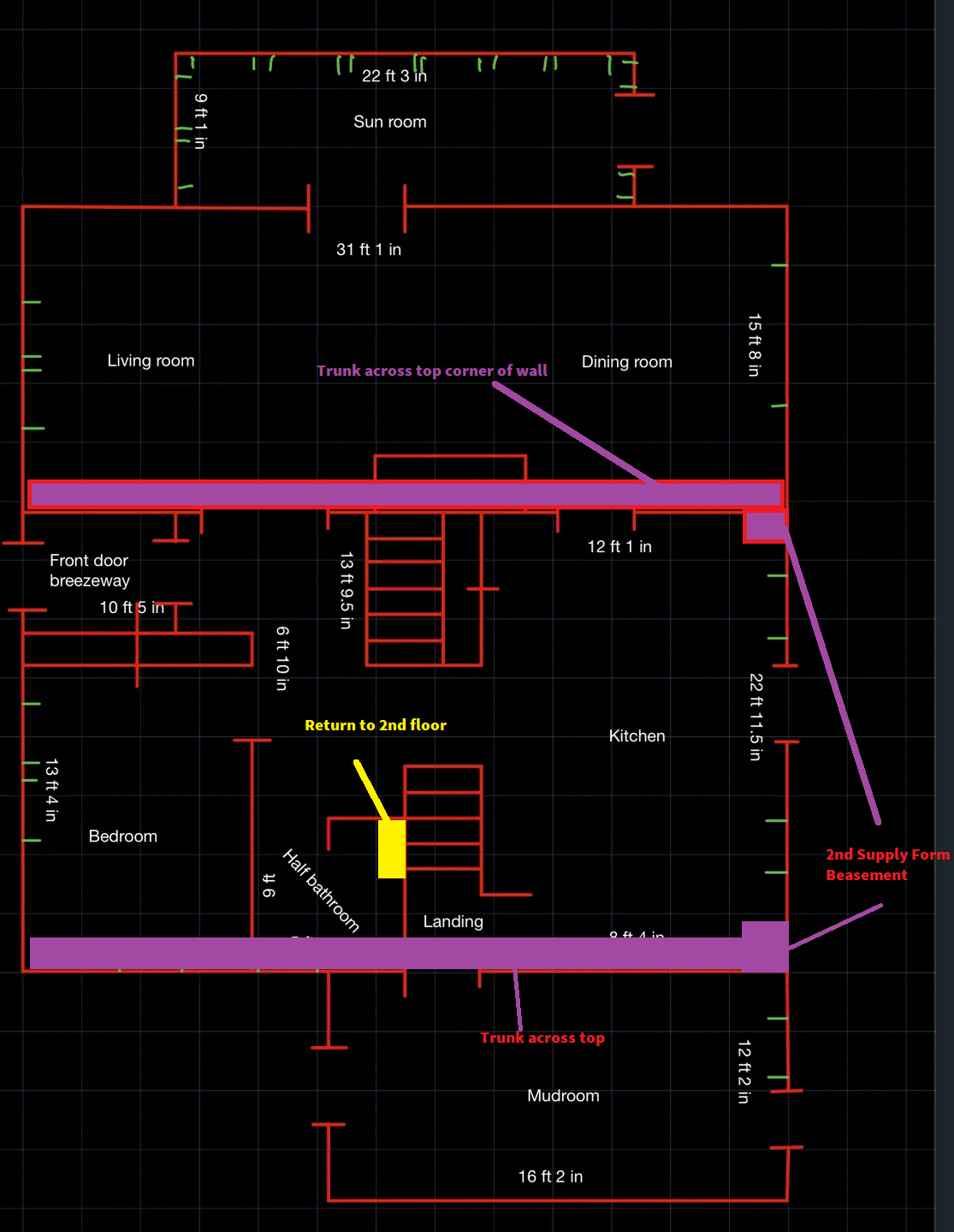

    I’ve now had three local contractors out to look at everything. Two of them told me a Manual J isn't needed because "they just know how to size it."
    Here is what the two contractors proposed:
    • Contractor 1: Didn't mention an ERV/HRV at all. He suggested reusing my existing basement furnace, running one massive main trunk all the way up from the basement into the unconditioned attic, and branching off from there to feed the second floor.
    • Contractor 2 (Recommended by a local builder): He seemed much more knowledgeable and suggested a true two-system approach. A furnace in the basement for the main floor, and a separate, smaller furnace upstairs. He wants to frame a small, sealed, insulated mechanical room in the attic for the upstairs unit. He also suggested spray-foaming the entire attic roof deck to bring the attic into the conditioned space, but that's a can of worms I really don't want to open right now. He was very friendly and actually open to showing me a few things.
    Contractor 3 (large local union company):
    This contractor came out today and thought it may be possible to avoid the attic altogether. He thought ductwork could be run from the basement up through the main floor and into joist bays/chases using round or oval duct. He did not think two separate systems were necessary. His recommendation was one basement system with two zones: one for the main floor and one for the upstairs.

    Post floor plans showing windows, joist direction and where there are pocketed beams in the way.
    Rough hand sketch is good enough.
    The smallest common fuel burner you can get is 60kBTU which is already oversized for your overall heat load based on my rough guess. Now add in two units, and it is WAY oversized.
    Contractor 3 is the closest to what you actually need. I'm in the land of 2.5 story houses with basements, most have a single air handler for the whole place.
    First step is get a man J. Not that hard to do yourself, make sure to select tight for air leakage.
    This is a pretty accurate tool that is free:
    https://betterbuiltnw.com/hvac-sizing-tool
    I was helping someone a while back that was doing similar gut job, two story with basement. Got silly quotes for duct work and zero design (basically what the useless contractor said, we just know). Had them run Man J and did a rough layout. He never did any ducting before, showed him how to put pieces together and he ducted the rest of his house. Took a couple of days and was about 1/10 the quoted price. New setup works WAY better than the original oversized furnace with sketchy ducting. Takes up less space, way quiter and even temps.
    Zone dampers work well but you need to oversize the ducting so when the upstairs zones are closed, the reset of the house can handle the flow. Lot of times you also don't need to fully close zone dampers, something that modulates say 25% to 100% flow rate will get you local control without effecting the overall system too much.

    These are the floor layouts for the upstairs, main floor, and basement. Each layout has the top facing the North. The green markings on the outside walls are where windows and doors are placed. The long green marks on basement layout are the beams holding up the floor. The furnace is currently located in the center of the basement near the red X.
    The joists are all running North to South, so top to bottom of all the layouts.

    I have a question about your basement.
    Have you ever been in that basement in the middle of the summer when the first and second floors were unbearably hot on a 95°+ day? I'm sure you have. Now think about the temperature in that basement without central air conditioning. Was it ever so hot down there that you needed to leave? I'll bet you remember that the basement was the coolest part of the house on those dog days of summer, even without central AC.
    Now think about adding four supply ducts to the basement and making that basement drop to 60° when you set the first-floor thermostat to 72°. You have now paid for four additional supply runs that eventually need to be closed off. The dampers on supply registers never achieve a 100% seal, so now you have a whistling noise coming from those closed-off registers, with perhaps 10% of the air still leaking into the basement. That additional noisy conditioned air will cause the basement to remain at about 65°, even with the registers "closed."
    Next, you decide to remove those openings, seal the cutouts, and mastic everything so there is no leakage. Then you reinstall the duct insulation. Now you have paid to have those four supply registers removed. After spending all that extra money, your basement is now 68° or 69°.
    And to think, you could have had that same result if you had never installed those four supply runs in the basement in the first place.
    Ask me how I know this!
    EDIT
    follow up: if the basement is too hot after you have central airconditioning installed in the first floor, you can always add a duct or two. But I guarantee you that 4 is way too many. Start out with zero and see what happens. You will be pleasantly surprised.
    You need to decide if the head room is more important in the basement or the lower price single zone standard basement duct system is better. If you use the High Velocity in the basement You can save head room.
    Based on the dimensions on your drawings, the stairways do not line up and the chimney location for the furnace does not line up from the first floor to the basement. But this is the best I can come up with (above). In the next illustration for 8" insulated round plenum for high velocity cooling and heating you can see one area where the headroom in the basement is reduced to accommodate the 8" plenum from the utility area near the center of the basement. If you place the AHU on the north wall in what appears to be a closet in the basement, then you eliminate the head knocker but you are restricted on the return duct location fro the first floor to the AHU. In this illustration with only 4 typical supply runs shown you loose head room all around the edge of the basement, leaving the center of the room open without head knockers.
    Of course it you decide that having less head room to accommodate the additional duct needed for zoning or two systems, then you can use the lower cost system.
    Have you priced a High Velocity system for the first floor and a standard system for the second floor from anyone yet?

    My current plan I'm leaning towards is two fully separate systems. A furnace and AC for the mainfloor/basement. And a heat pump/air handler installed in a closet upstairs. Running a 12x14 insulated trunk in the middle of the attic and flex lines off of that. These are the supply sizes i'm thinking to use.
    I believe a 2 ton heat pump will be enough for this, as i'm more worried about cooling. I think with the heat rising from the main floor furnace, it will still be comfortable in the winter. But gas in my area is a good deal cheaper than electric.
    2 in the master bedroom (6 inches)
    2 in the southeast bedroom (6 inches)
    2 in the northeast bedroom (6 inches)
    1 in the guest bathroom (4 or 5 inch)
    2 in the walk in closet (5 inches)
    1 in the master bathroom (one 7 inch supply )

    There is no easy solution here. With that low ceiling height you don't want any trunks across the basement.
    Here is the rough stab at one option.
    Because of the dropped beam, you would loop the supply trunk around the outside of the basement. These can be either on the ceiling but will block the windows slightly or you can run them on flat bellow the windows and then build it into the walls. The return can run under the basement stairs and go up inside the walls of the main floor powder room to the 2nd floor.
    From there takeoffs and floor register at the windows and feeds to the mud room and sun room.
    On the main floor, the two supply trunks come up in the corners of the kitchen cabinets which are useless space anyways and run mostly across the top of the cabinets.
    Top takeoffs from these two trunks through the 2nd floor joist bays to floor registers as needed in the 2nd floor.
    @EdTheHeaterMan The 8" high velocity trunk is 10" OD so it takes up more space than a regular 8" rectangular hard pipe. HV also about doubles the BOM cost and the blower uses about 2x the power of a regular blower.
    @MichaelT As for duct sizing, start from ManJ. Once you have the heat load for each room you can look at the BTU/CFM your air handler delivers and size from there.
    BTU/sqft is a terrible measure, but assuming you do a decent job with air sealing, the newly insulated structure will be somewhere about 10-15 BTU/sqft. Assuming 2500sqft above grade plus a 1000 bellow, I would guess your place should come in somewhere around 40k to 50k heat load. The cooling load somewhere around 2.5 tons. The guy saying the existing 100k furnace is undersized is out to lunch. Again, run a Man J to check.
    One option is to keep the existing equipment if in decent shape, running it till it dies tends to be the cheapest option. You will then have a couple of heating seasons of data and you can then install the right sized equipment. The one issue is the big furnace will need bigger ducts, so it will be harder to run.

    There is one way to run ductwork from the basement to the second floor that is in common use around these parts; however, the math does not actually work out.
    You take an 8" round duct and transition in the basement to 8" oval duct so it will fit inside a 4" wall cavity. Then, when you reach the second floor, you transition back to round duct in order to run a lateral, horizontal duct between the floor/ceiling joists to the register boot location.
    It might look something like this:
    8" round duct in the basement
    to 8" oval duct inside the wall cavity
    back to round duct above the ceiling
    then over to the second-floor register boot
    The math does not work out because the cross-section of an 8" oval duct actually measures about 4" x 10.25", with a cross-sectional area of about 37.7 sq. in., while a 7" round duct has a similar cross-sectional area of 38.5 sq. in.
    But no one has a 7" round-to-8" oval transition fitting. So we see a lot of 6" round duct to 6" oval duct and 7" round duct to 7" oval duct installed in walls that are too small by design.
    For some reason, the people who specify oval duct somehow believe that 6" round and 6" oval move the same amount of airflow, and that is not the case.
    Don’t fall into that trap when it comes to switching from round to oval duct.
