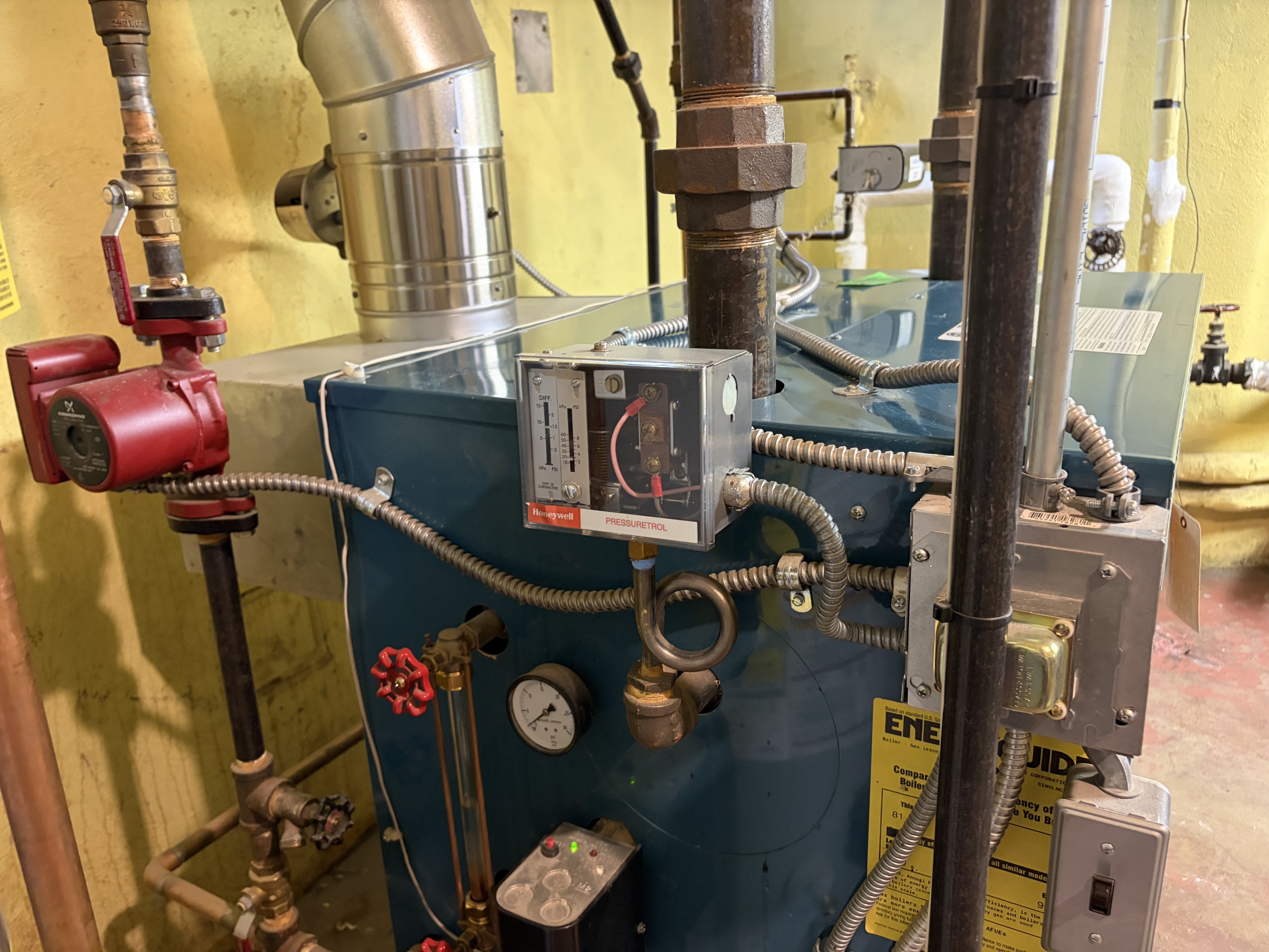

    Thanks, @Steamhead! We do have both books. We got the layman's version because the big book was a little intimidating. But we're looking at Chapter 15 now. Here are some more photos. You'll notice that there's also a hot water pump coming off the boiler which is a whole other topic of conversation. We've had the house just over a year and are making lots of discoveries! Thanks to everyone who is chiming in to help - much appreciated.
    First, here's another radiator with a different-looking trap. FWIW, this one has never gotten hot since we've been here. Followed by photos of the boiler.
    IMG_0136.jpeg IMG_0138.jpeg IMG_0139.jpeg IMG_0140.jpeg IMG_0141.jpeg IMG_0142.jpeg IMG_0143.jpeg IMG_0144.jpeg
    mattmia2 Member Posts: 17,330
    that is a big boiler, i bet it is very much oversized. the circulator i think is for a hot water loop somewhere, that is pretty common and fine if done correctly.
    2.5psig is way too much for a vapor system.
    does the radiator that won't heat that has the trap still have the vapor valve?
    with the insanely high pressure it is very likely you have steam in the returns and that steam is closing the trap from the return side before the radiator can vent and heat. also possible the steam in the return itself is keeping the radiator form being able to vent.
    feel the returns, they should not be steam hot. they may be hot but they shouldn't be as hot as the returns.
    pecmsg Member Posts: 7,242
    the control on the left what does it control? Where do the wires go?
    Jamie Hall Member Posts: 27,559
    Yes, you do need a vaporstat for that system. The 0 to 16OUNCE per square inch variety, and set it to cutout at 7 ounces with a 4 ounce differential. That radiator that doesn't heat — it may be just fine, but that high pressure is blowing through the other radiators into the returns and will shut it off. The trap on it is a perfectly normal radiator trap. If it's not working, it can be repaired quite easily — but there's no point in seeing whether it's working or not until you get the pressure under control.
    The control on the left is an aquastat —but where the wires go or what it's doing is quite impossible to say from the picture.
    the aquastat is for the hot water loop, it is to fire the boiler up to say 180f when there is a hot water call but not a steam call so the boiler doesn't start steaming on a hot water call only.

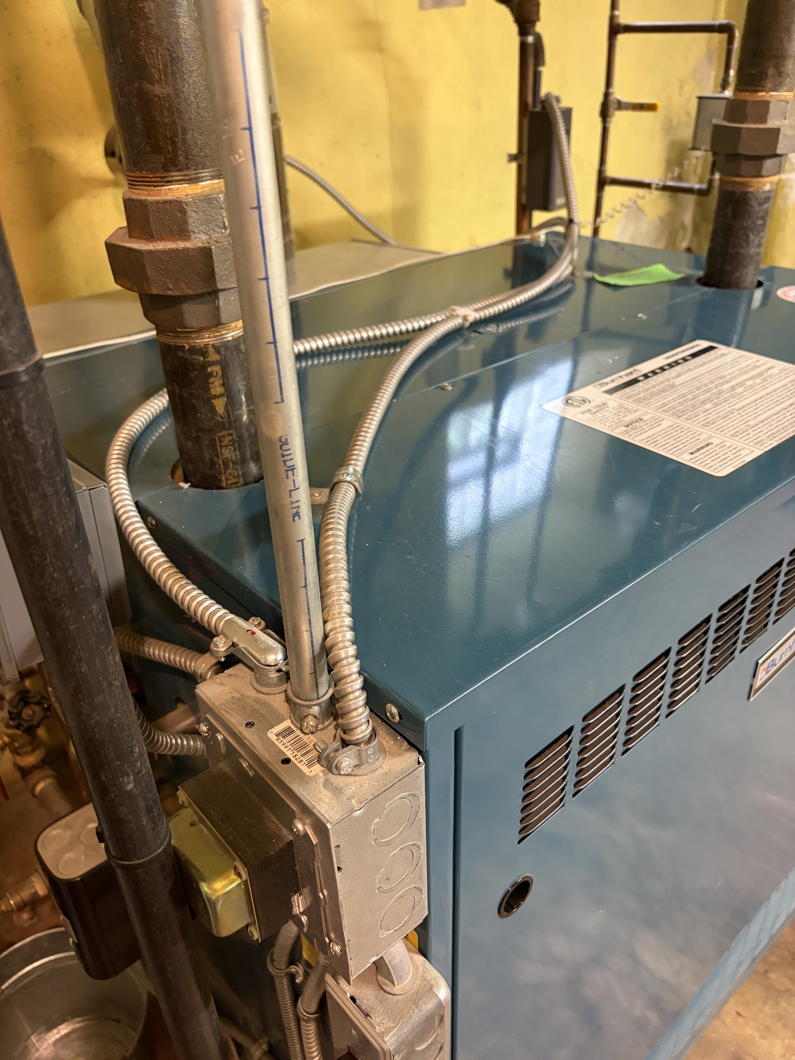

    @mattmia2 you are right - there is a hot water loop. We've traced the lines and it seems to be going to one radiator in the enclosed porch. Here are the photos tracing the wires from the aquastat, over to the water pump.

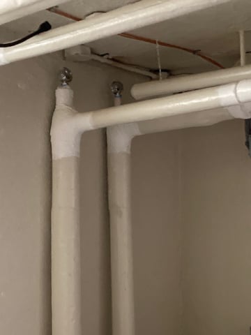

    On the O-E system, there would have been a vent at the end of each dry (overhead) return. @Jamiedle , can you take pics of these?
    It would also be a great idea to vent the main steam lines. Are there vents at the ends of the mains?

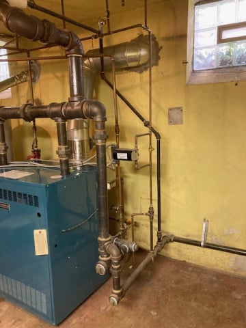

    Off topic, the header ?
    clammy
    Steamhead Member Posts: 18,663
    Functional illiteracy on the part of the installers?
    All Steamed Up, Inc.
    Oil & Gas Burner Service
    Consulting
    edited June 9
    the risers should come in to the op or side of the header rather than the bottom, it might drop some condensate or carryover in to the second riser but unless there is some specific symptom of it causing a problem i wouldn't worry about it. i am more concerned that I don't see a skim port.
    it also has no swing joints so it could cause the boiler to pull itself apart.
    @mattmia2 said "it also has no swing joints so it could cause the boiler to pull itself apart."
    @Jamiedle , that's the problem. Steel and cast-iron expand at different rates.

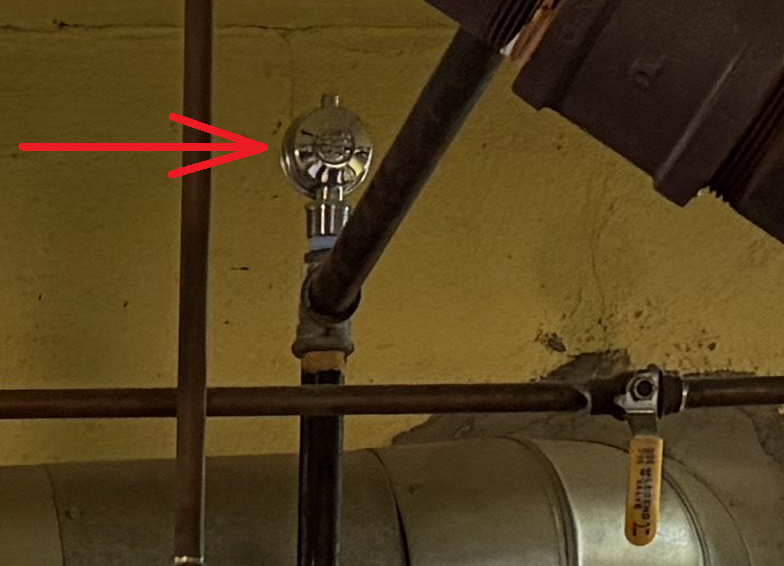

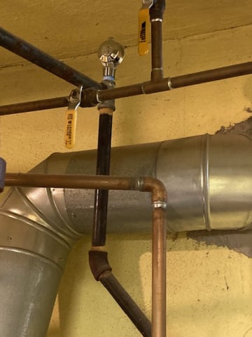

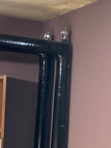

    There is one vent above the boiler, and four vents (replaced this last fall) at the ends of the mains. See pictures below.
    They look like Maid-o-Mist #1 vents (or one of their clones). I'd first measure the length and diameter of the steam mains, so we know how much air is involved.

    EBEBRATT-Ed Member Posts: 20,442
    With all the unions on the header you could cut the risers from the boiler and turn the header 180 degrees with the tees pointing up.
    Come out of the boiler with a nipple then 2 45s and 2 90s and make it a half A—-d drop header .
