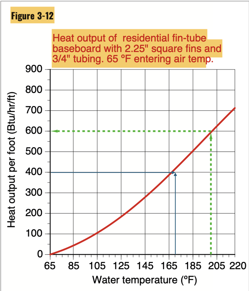

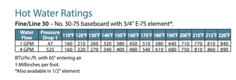

    Show him your measurement of the entire fin tubed sections and this generic output chart.
    If you know the fin tube brand you can zero in on an exact number. Most brands of 2-1/4" fin tube are similar output.
    Get the boiler up to 180, start the pump, observe the supply and return.
    If it leaves the boiler at 180, returns at 160 the average temperature in the fin is 170. Give it some time to reach equalibtrium. This condition is when neither the supply or return temperature is moving up or down.
    On this chart, blue lines, with AWT of 170 a typical fin tube puts about 425 btu/ foot X 77= 32,725 btu. That is all that can realistically be pushed through the fin tube regardless if you have a million btu/hr boiler.
    At 6 gpm through 3/4 copper you are right at 4 feet per second flow velocity. Beyond that flow velocity (speed) the system will become noisy from excessive flow, a hissing sound. No need to go there.

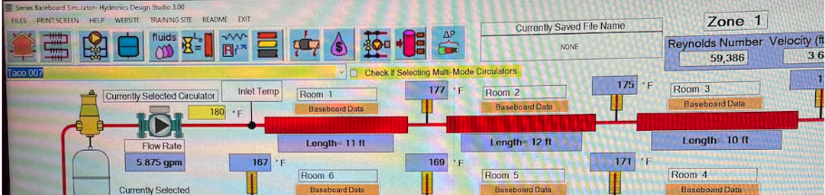

    Adjust these numbers to the operating condition you can obtain at the time of the visit. The room temperature at time of testing for example. The chart a few posts up allows for the ambient air temperature correction.
    With both of you there witnessing the actual operating conditions, temperatures mainly, the facts should be clear.
    If you report back with some actual data I can plug it into the software and get more accurate. Pump model, temperature leaving and returning at the boiler. Confirm the fin tube lengths, a pic of the fin tube element with a tape measure on it.

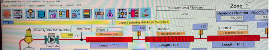

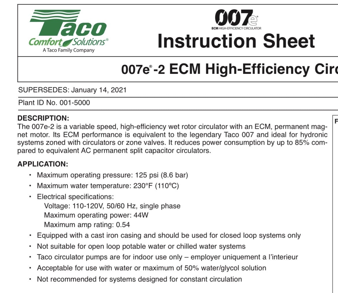

    In the SIM I ran earlier, it shows with a Taco 007 you may be flowing more like 5-6 gpm. Which is a bit high, but doable in 3/4 tube. At that higher flow rate notice the ∆ is 14.25, flow velocity is below 4 fps, acceptable, upper right of the lower slide..
    Possibly your pump has multiple speeds? Show a pic of the end with the model number and info.
    I don't see a minimum flow requirement in the boiler manual for your boiler. I think it could handle 4 gpm.
    No harm in reducing the speed, but doing so will also reduce the heat output. So bottom line run it as low/ slow as possible while still being able to warm the home on the coldest days.

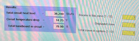

    Screenshot 2026-05-31 at 5.59.48 PM.png Screenshot 2026-05-31 at 5.59.09 PM.png
    But none of this changes the fact you have a boiler with a 77K output on a system with maybe a 40K load and distribution system.

    I can take a better picture tomorrow. It is actually a TACO 007e which apparently has multiple speeds and is supposed to maintain a delta of 20F?

    It is billed as a high efficiency version of the 007. I don’t think you can manually change or fix the speed. It is not a delta t version capable of maintaining a fixed delta either

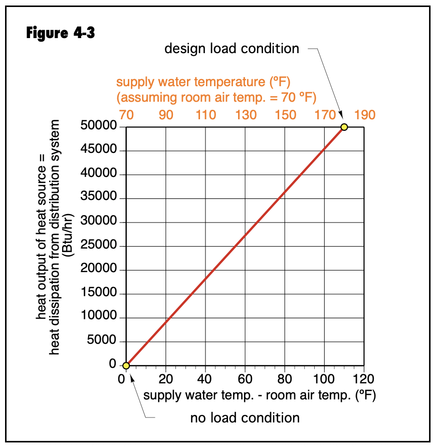

    Don't get too hung up on the systems ∆T. It should and will change as the load on the home changes. It changes as the boiler temperature is changing. It is merely an indication at any point in time of how much heat is being transferfed into the space.
    This is a good motto for hydronician to live by
    Now in your case you have a fixed speed circulator so flow rate is pretty stable. Use the hydronic formula to determine how much heat is being moved, with accurate supply and return temperature known. I'm thinking that 007E is moving 5-6 gpm based on the info you provides with fin tube lengths and assumed piping and fittings.
    500 X flow X (∆T)
    When the home is cold you see a wide ∆, indicating the system is transferring a lot of heat. As the space warms the ∆ will close, less heat is being transfered.
    Thermal Equalibrium is a point when supply and retrurn temperatures stablize, not going up or down. Defined like this:
    This graph is probably close to your system.
    A 50,000 btu system with a 70°space temperature and the boiler operating at 180 SWT, another look at how the ∆ (bottom axis) the ∆ between air temperature and boiler supply, changes the amount of heat transferred
    Could be there is nothing wrong other than the boiler not matched to the amount of distribiution?
    Your comment about an even larger boiler connected to the amount of fin tube you have did not short cycle ever, just doesn't pencil out baed on the Laws of Thermodynamics, and all the formulas, graphs and math I presented?

    To some extent that contractor is correct, the boiler is operating correctly for the situation it was put into.
    So no matter how many people you ask, or hire you boiler is way too big and will short cycle. Even on a design day.
    Here is a free load calc, fairly basic, but at least based on realistic numbers. Give it a try.
    https://www.usboiler.net/heat-loss-calculator.html
    Assuming the fin tube size, the average construction of the home, etc. that you supplied
    It could be worse, the 1000 ft home could have a 77K heat load! Then you would have expensive problems keeping it warm :)
    Suggestions have been made to time delay it, buffer tank it, tweak t stat cycles, etc. But you are treating a symptom, not the root problem.

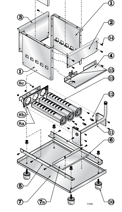

    As far as the old boiler.
    I have seen boilers in the wild with a burner removed. That turns your 90K boiler into a 60K, for example.
    Or orifices could have been downsized.
    I doubt any boiler manufacturer would sign off on those modification however.

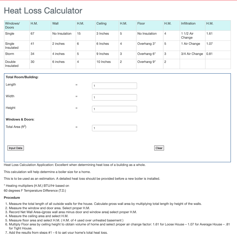

    A tape measure is about all you need to do your own load calc. 7 simple steps shown below.
    A calculator or slide rule.
    Probably do this calculation with just a phone!
    People tell me this calculator tends to calculate a bit on the high side.
    There will be some assumptions as far insulation quality, air leaks (air change factor) , etc. But still better than all the guessing so far.
    Take the load number and feet of fin tube to the person that sized and installed the boiler.
    We should post a poll here, my guess is 28,296 btu/hr :) if it is 1000 sq feet of area.

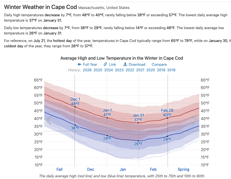

    Rarely gets below 26°F in that area, ASHRAE design temperature is 15°
