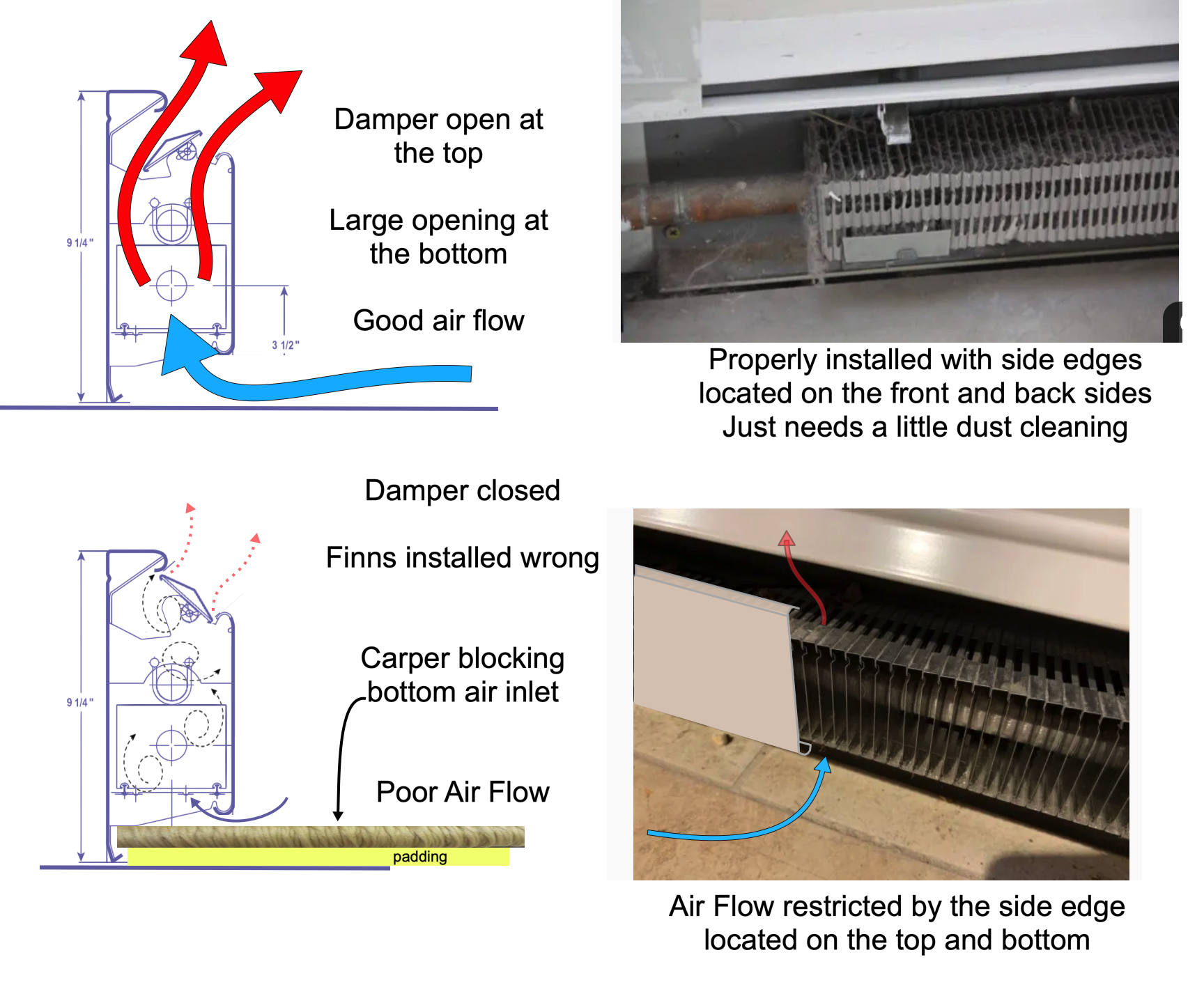

Show him your measurement of the entire fin tubed sections and this generic output chart.
If you know the fin tube brand you can zero in on an exact number. Most brands of 2-1/4" fin tube are similar output.
Get the boiler up to 180, start the pump, observe the supply and return.
If it leaves the boiler at 180, returns at 160 the average temperature in the fin is 170. Give it some time to reach equalibtrium. This condition is when neither the supply or return temperature is moving up or down.
On this chart, blue lines, with AWT of 170 a typical fin tube puts about 425 btu/ foot X 77= 32,725 btu. That is all that can realistically be pushed through the fin tube regardless if you have a million btu/hr boiler.
At 6 gpm through 3/4 copper you are right at 4 feet per second flow velocity. Beyond that flow velocity (speed) the system will become noisy from excessive flow, a hissing sound. No need to go there.
Adjust these numbers to the operating condition you can obtain at the time of the visit. The room temperature at time of testing for example. The chart a few posts up allows for the ambient air temperature correction.

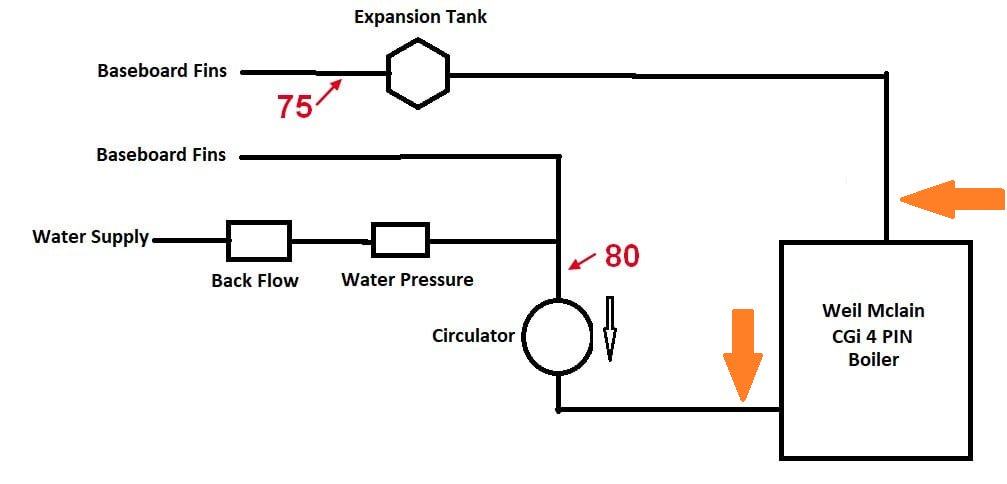

Should be a fixable problem regarding a lack of flow problem. The purge hose will give you a good idea if there is a major blockage. It should fill a 5 gallon bucket in a minute or less if 5 gpm is flowing.

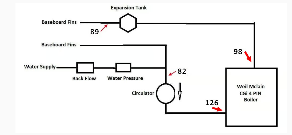

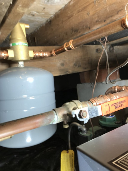

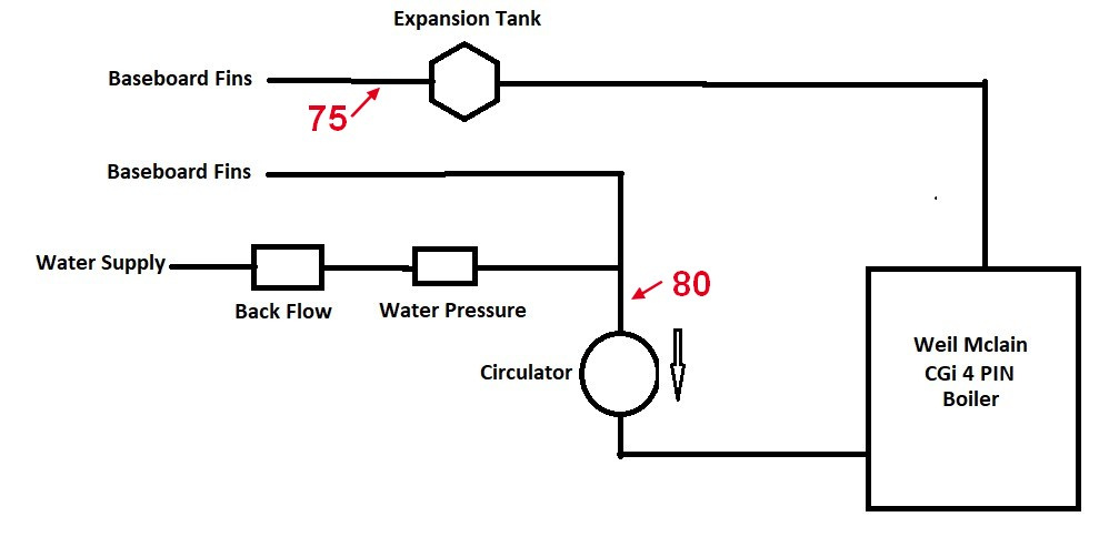

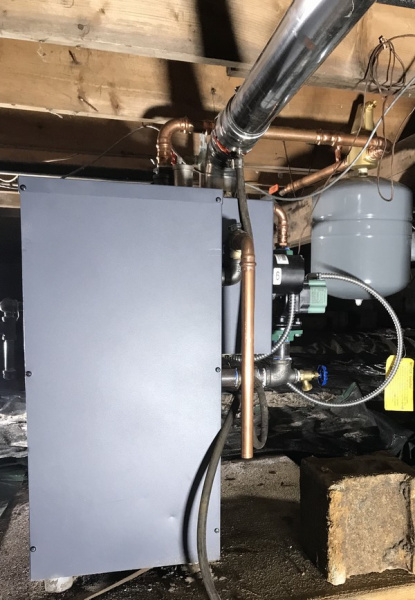

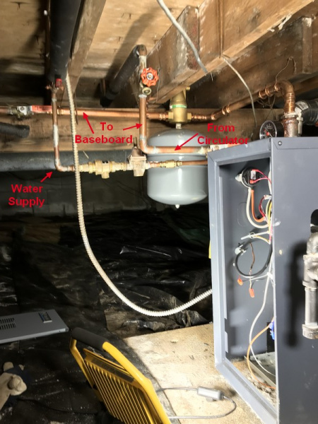

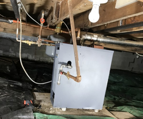

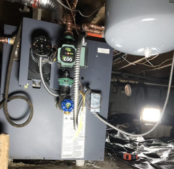

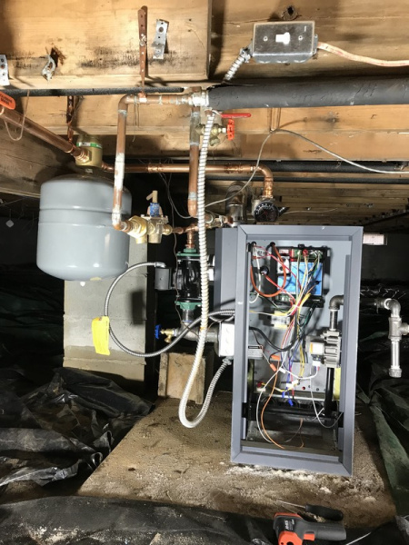

Any pics of the before boiler and it's piping to see what may have changed?

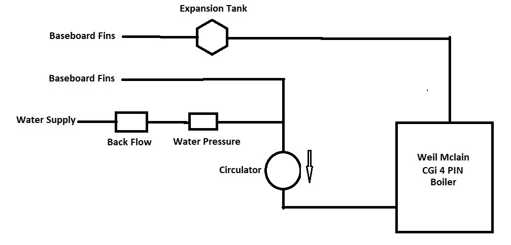

I prefer the pump on the supply side of the boiler after the expansion tank, but not a dealbreaker, this system should work as shown.

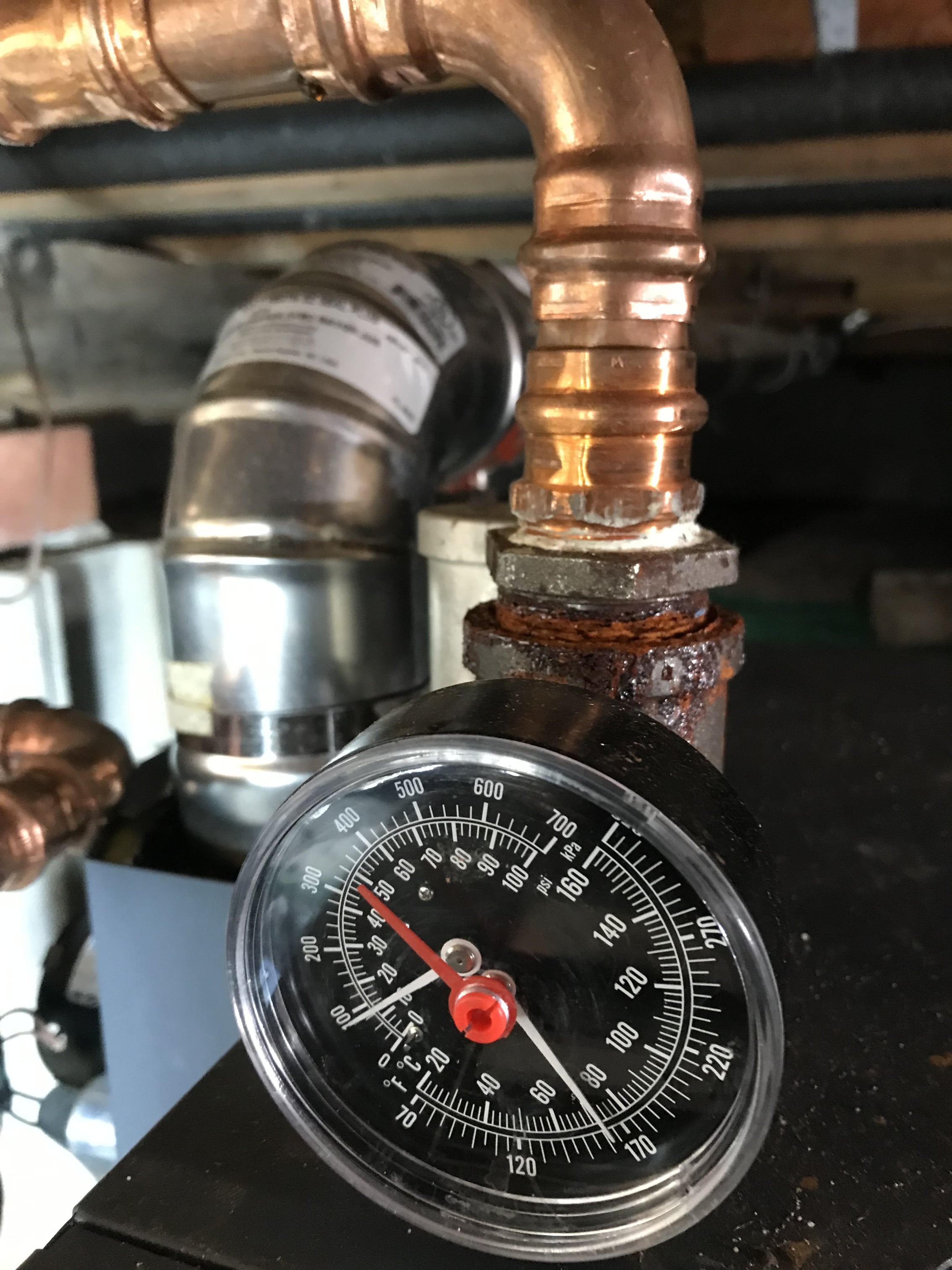

Being at the home now, I checked and there is no leak at the joint in the picture, or anywhere around the boiler. I measured supply/return, they averaged out to 154F supply, 143F return, a 11F difference. Do these readings indicate the circulator and flow is fine?

I don't see "balancing valves" on this system.

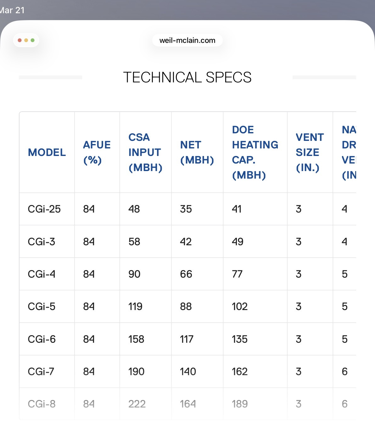

what size boiler?
Weil McLain CGi 4-PIN rated at 77 000 on the boiler tag or 76,000 BTU/hr google search.

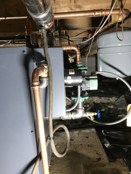

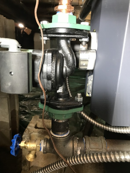

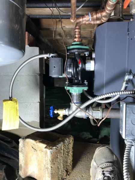

Possibly your pump has multiple speeds? Show a pic of the end with the model number and info.

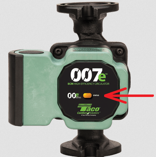

I can take a better picture tomorrow. It is actually a TACO 007e which apparently has multiple speeds and is supposed to maintain a delta of 20F?

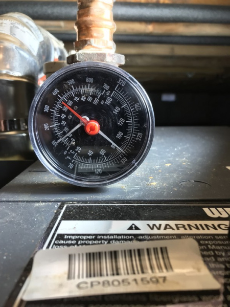

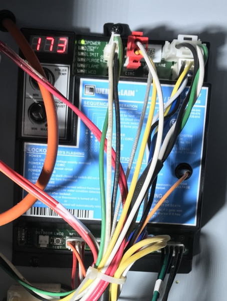

I also noticed something different today. Looking at the control module temp readings, once the boiler shut off at 190F and circulates, it dropped to 171F, then the temp rose to 175F, then back down to 170F and the boiler fired up again, this took 3 minutes. Which is longer than the cycle times I have measured previously.
It is billed as a high efficiency version of the 007. I don’t think you can manually change or fix the speed. It is not a delta t version capable of maintaining a fixed delta either
Hopefully a visit from the installer can confirm the boiler control is properly configured.

There is this one.
that is not the pump you show on your system. I don’t think I would spend 400 bucks on a different pump until you do more troubleshooting

I meant that pump as a a possible replacement.

The circulator is a Taco 007e.

I have no pictures of original plumbed boiler, only noticeable difference is expansion tank location.

@EBEBRATT-Ed Funny, I was thinking about what are the pipe temperatures around the rest of the system with the boiler running. However I did not make the jump to a Monoflow type system.
If it is a Monoflo system the 007e may not be the appropriate circulator.

Here's a crazy idea. What if the old over sized boiler was a cold start. Depending on how over sized it was it would need a long run time, store a bunch of heat and potentially satisfy the thermostat without short cycling.
Aren't they both cold start ? Or at least that is my assumption. I suppose if the system usage or the weather is different during use, but I would think @Ismellelephant may have noticed that.

To some extent that contractor is correct, the boiler is operating correctly for the situation it was put into.
So no matter how many people you ask, or hire you boiler is way too big and will short cycle. Even on a design day.
Here is a free load calc, fairly basic, but at least based on realistic numbers. Give it a try.
https://www.usboiler.net/heat-loss-calculator.html
Assuming the fin tube size, the average construction of the home, etc. that you supplied
It could be worse, the 1000 ft home could have a 77K heat load! Then you would have expensive problems keeping it warm :)
Suggestions have been made to time delay it, buffer tank it, tweak t stat cycles, etc. But you are treating a symptom, not the root problem.
