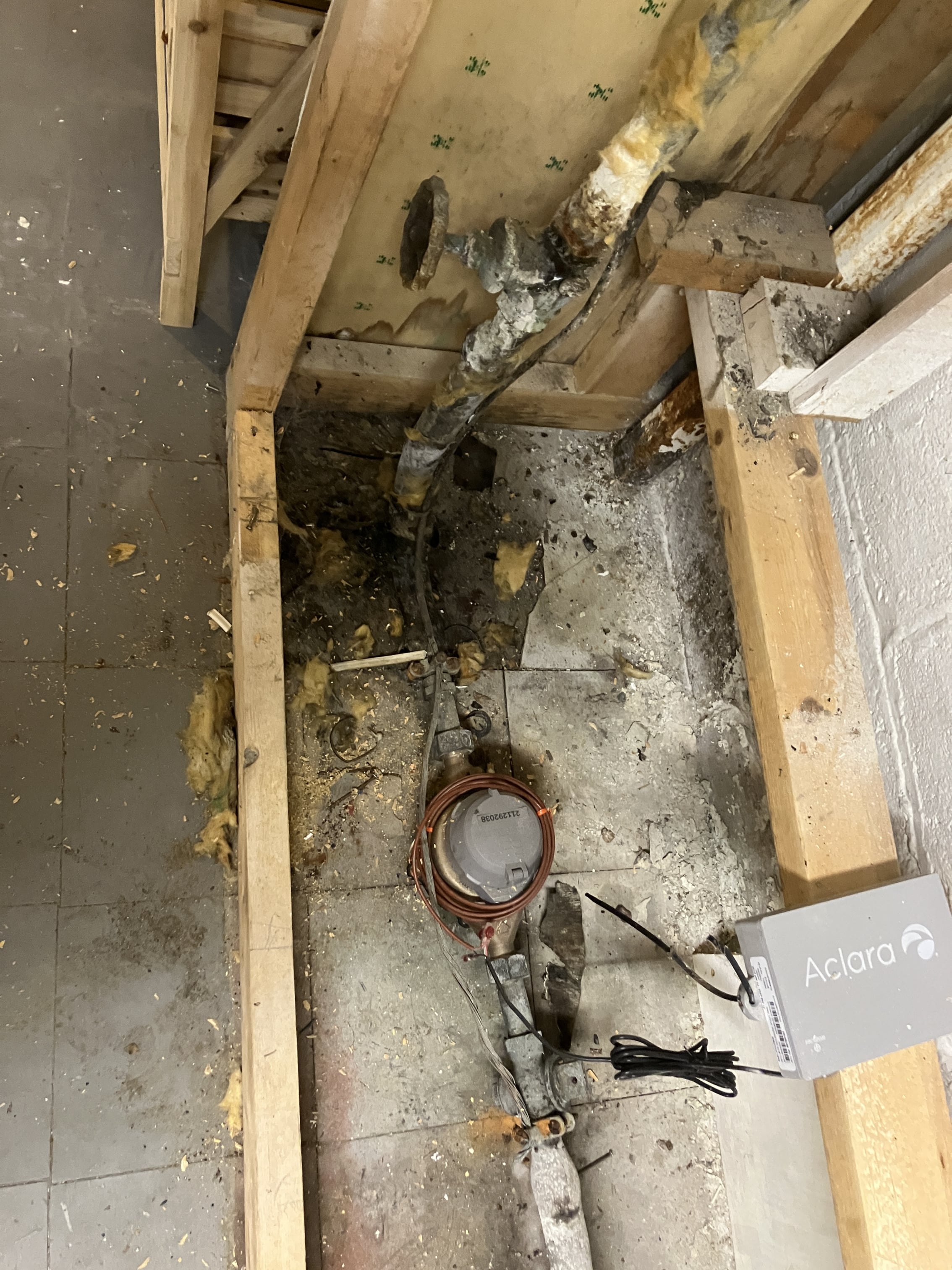

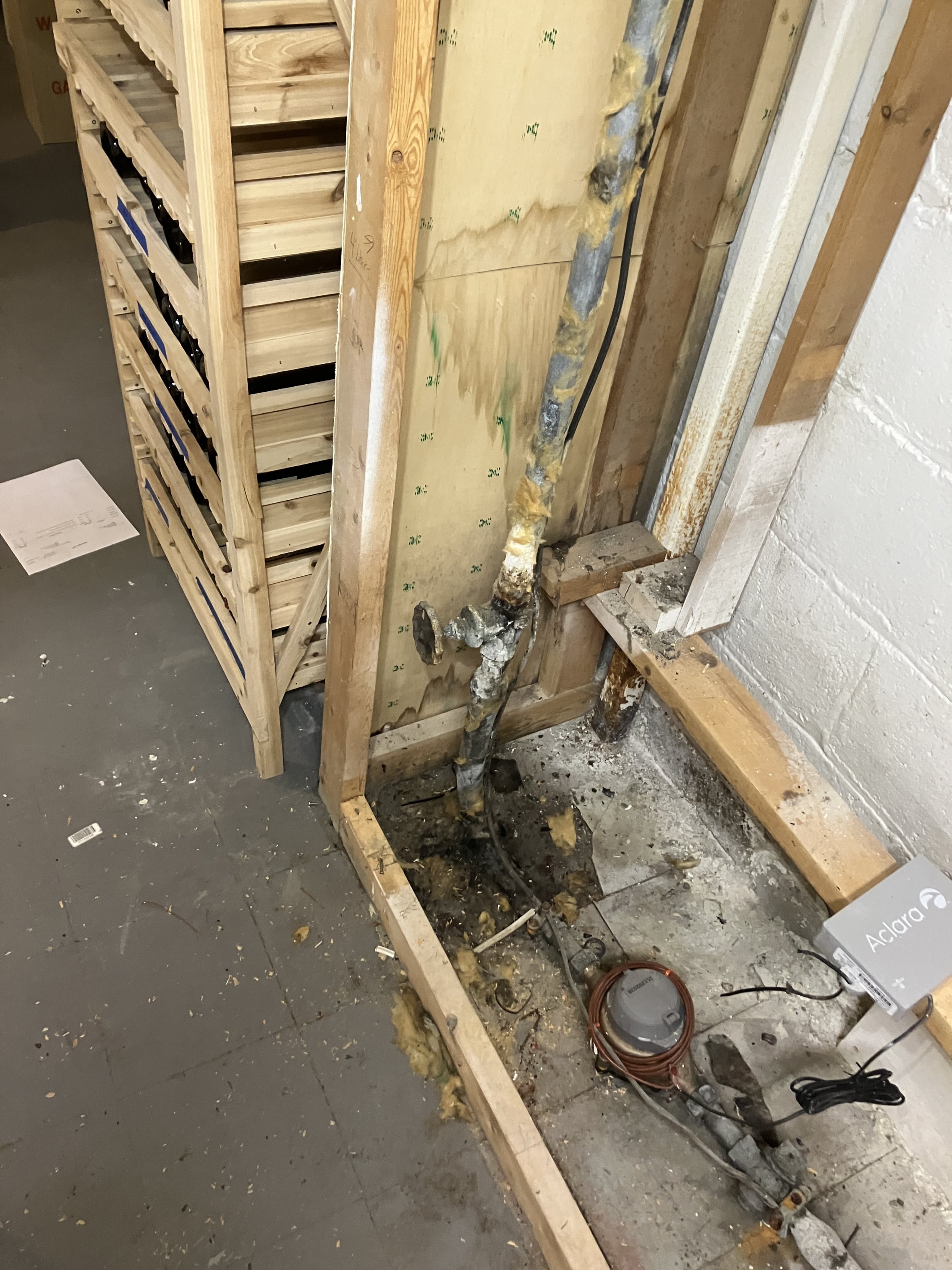

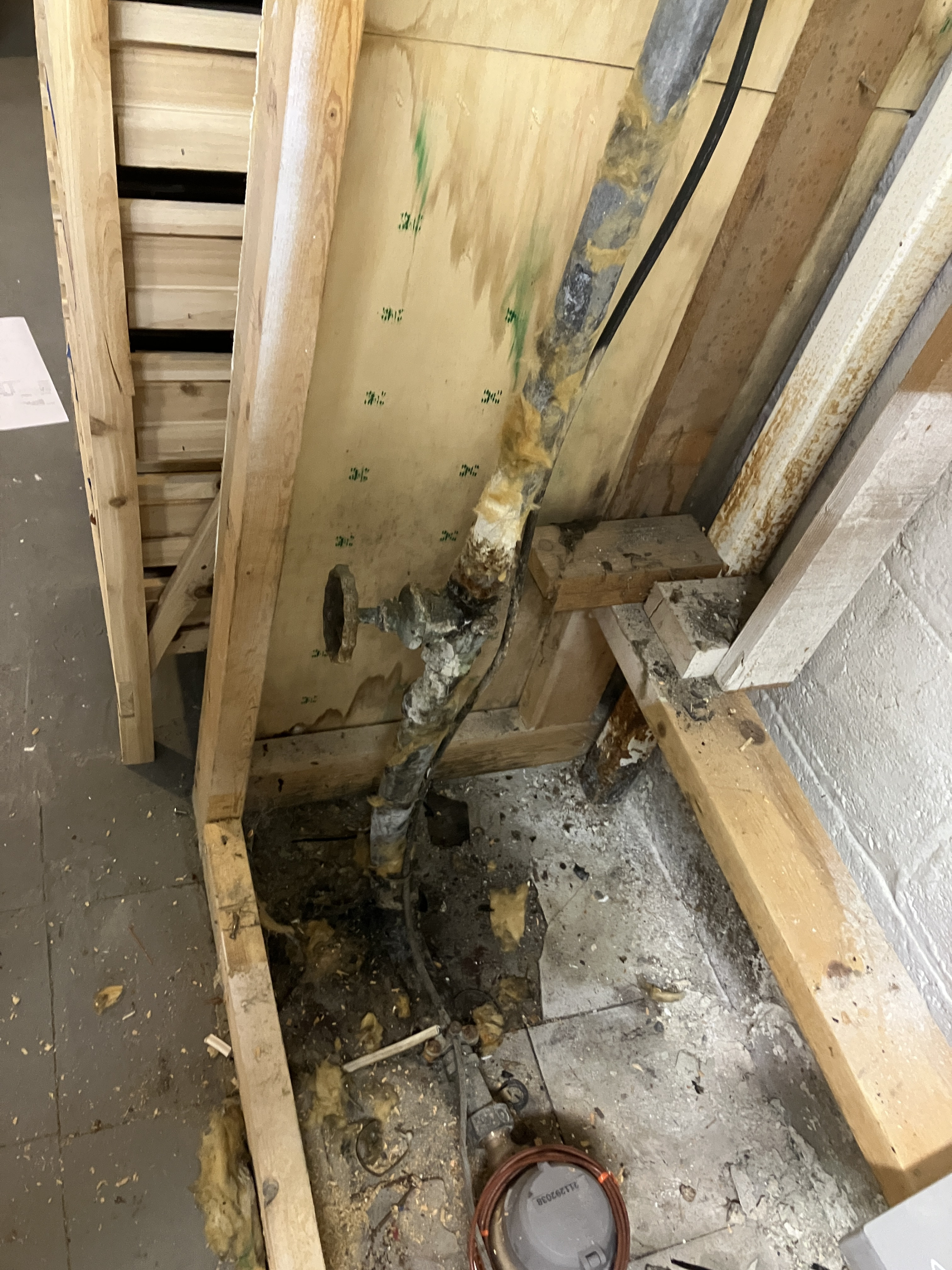

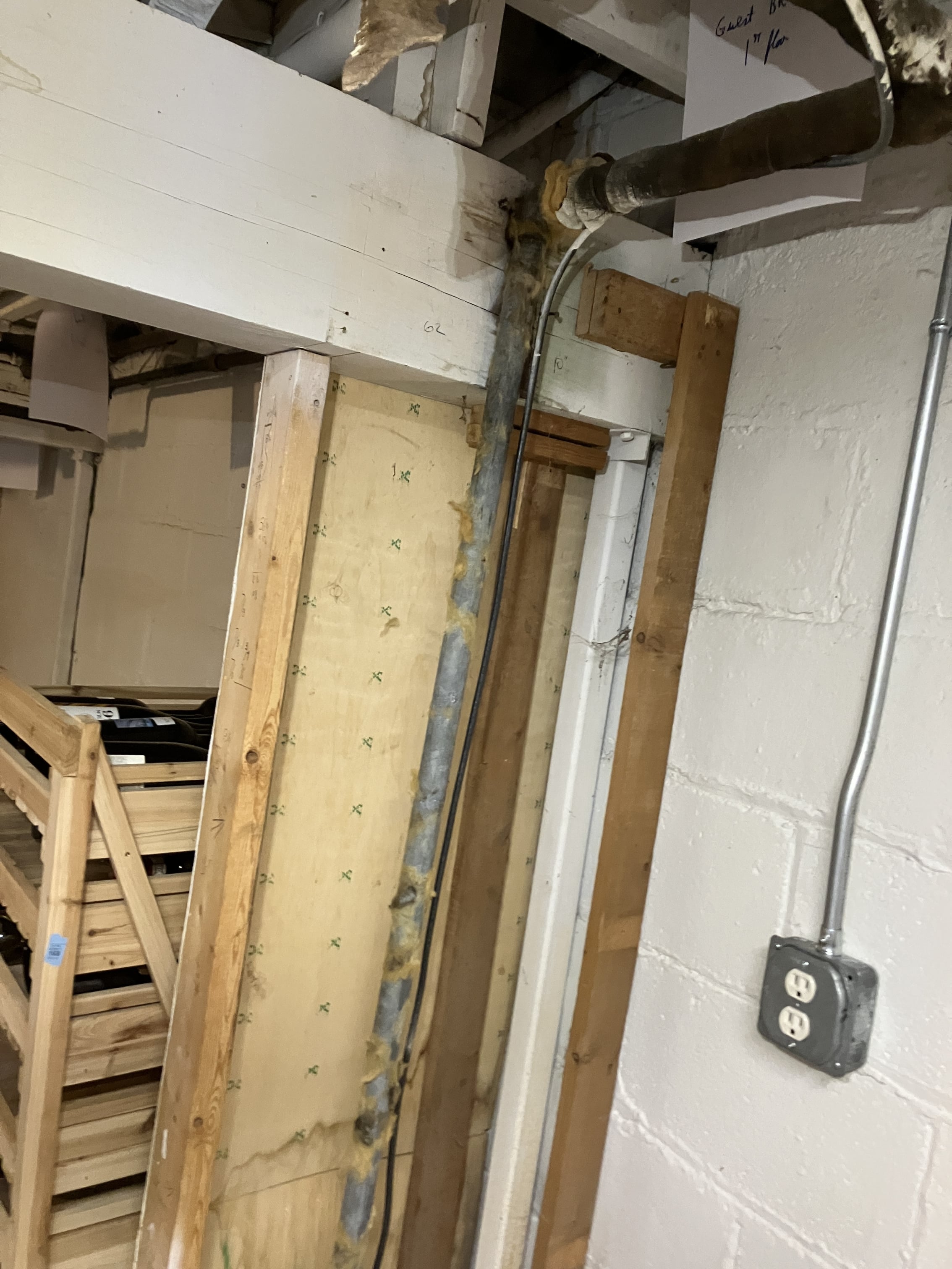

I live in a 100-year-old house with galvanized water lines and a lead service line.  (My municipality is scheduled to replace the lead service line in the next couple of years.) I recently decided to install a whole-house automatic shutoff valve, due to several friends who each suffered a catastrophic leak and subsequent flooding.
A bit of background: I am no stranger to plumbing.  On my last house, I did a whole-house repiping job, swapping out old galvy for sweated copper throughout the entire house, all work done by me.  I also also switched to a tankless water heater, which was relocated from where the tanked water heater was, and that required repiping all of the black iron gas supply lines to accommodate the tankless DHW and a high-BTU kitchen setup.  All of this was done under permit.
Looking over the meter and the service entrance in my new house, I decided to let a plumber pro handle this.  I am wary of the lead service lines and the mingy shut-off valves.  However, I have had two plumbers kind of go AWOL on me, and I am tempted to just do it myself, but I have questions/doubts.

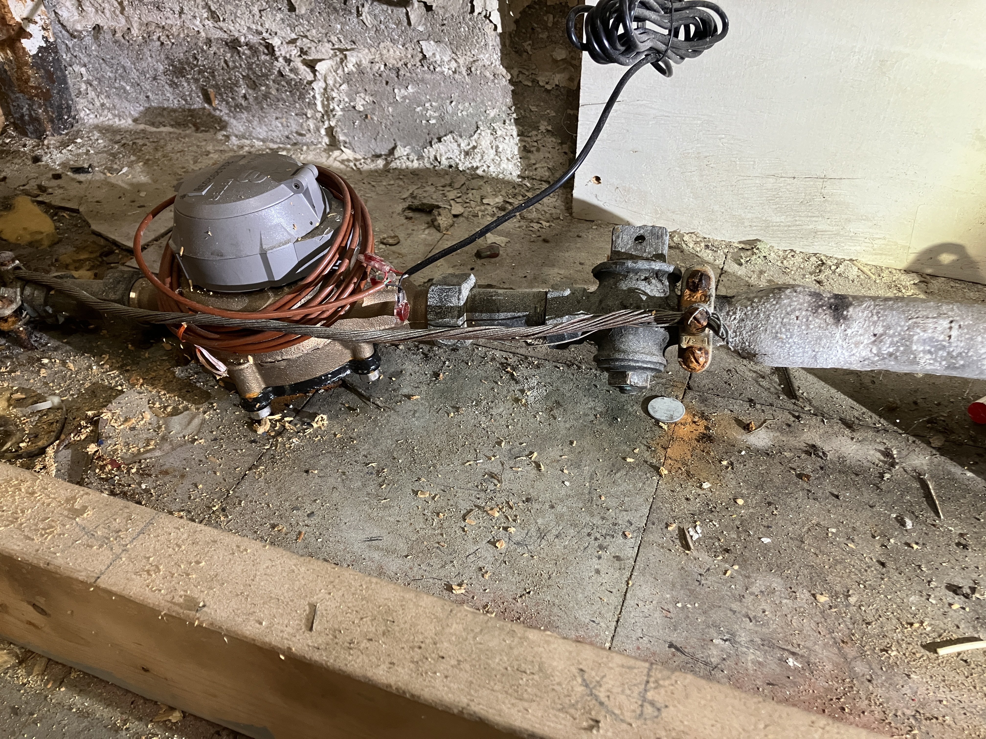

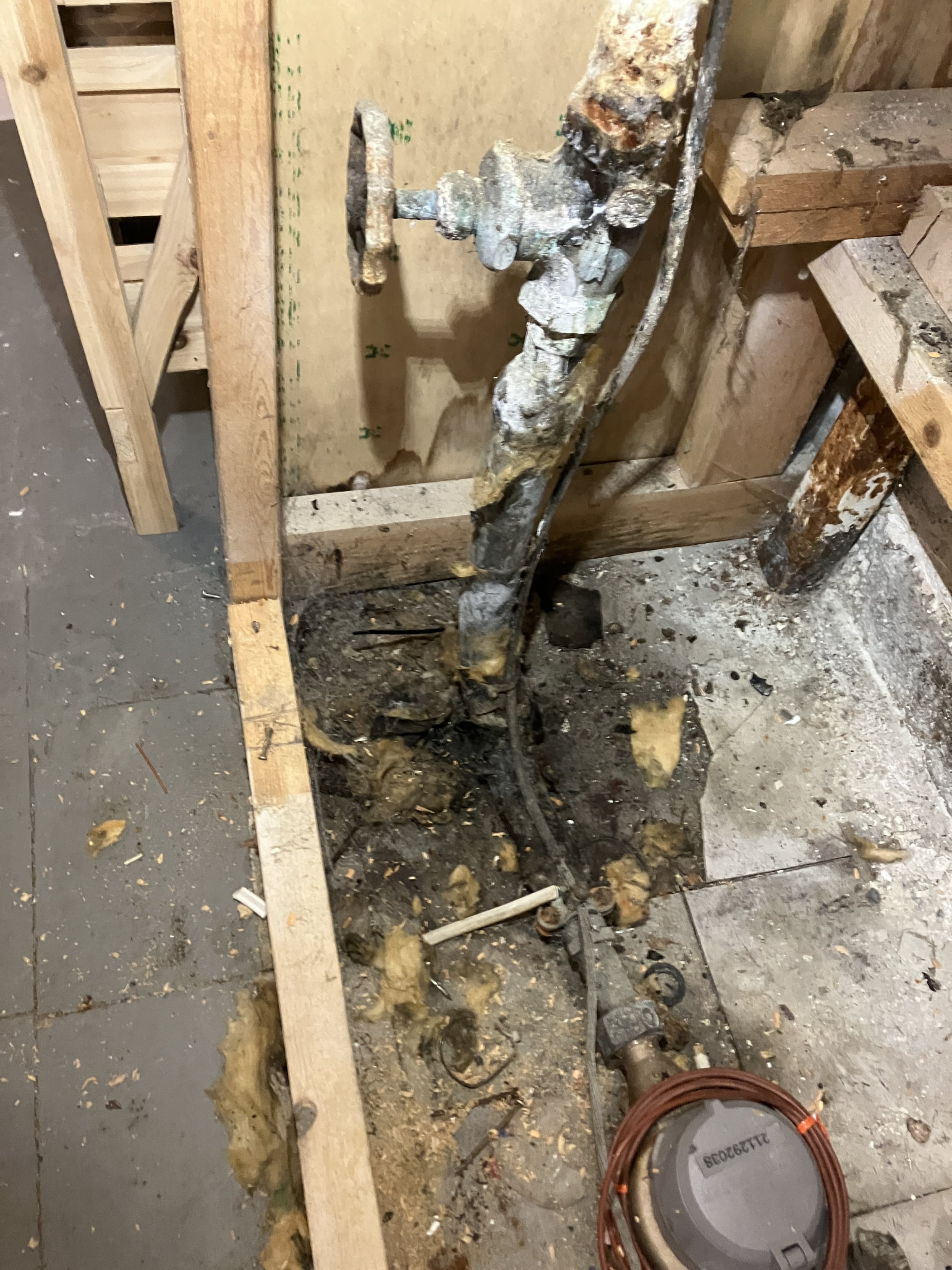

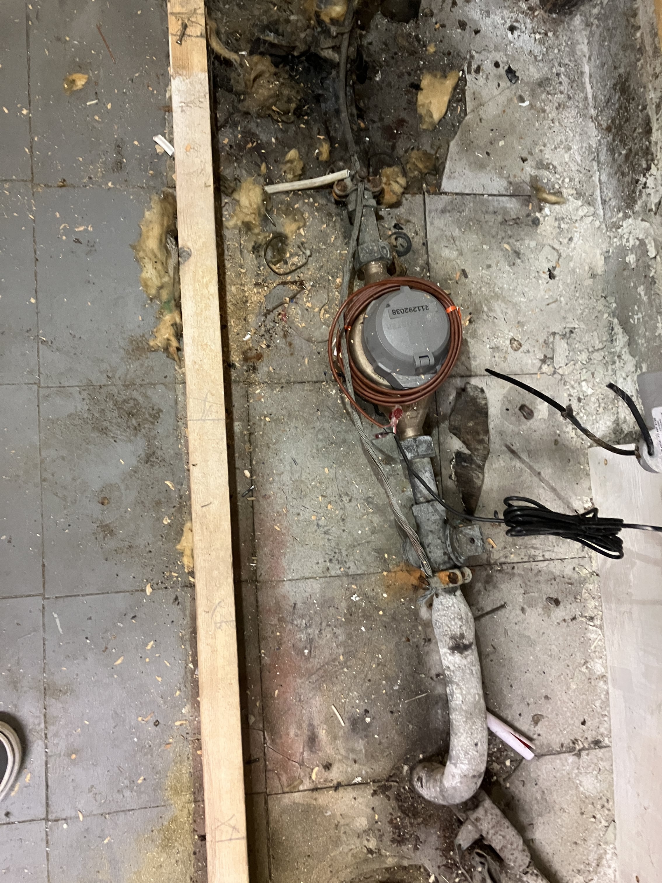

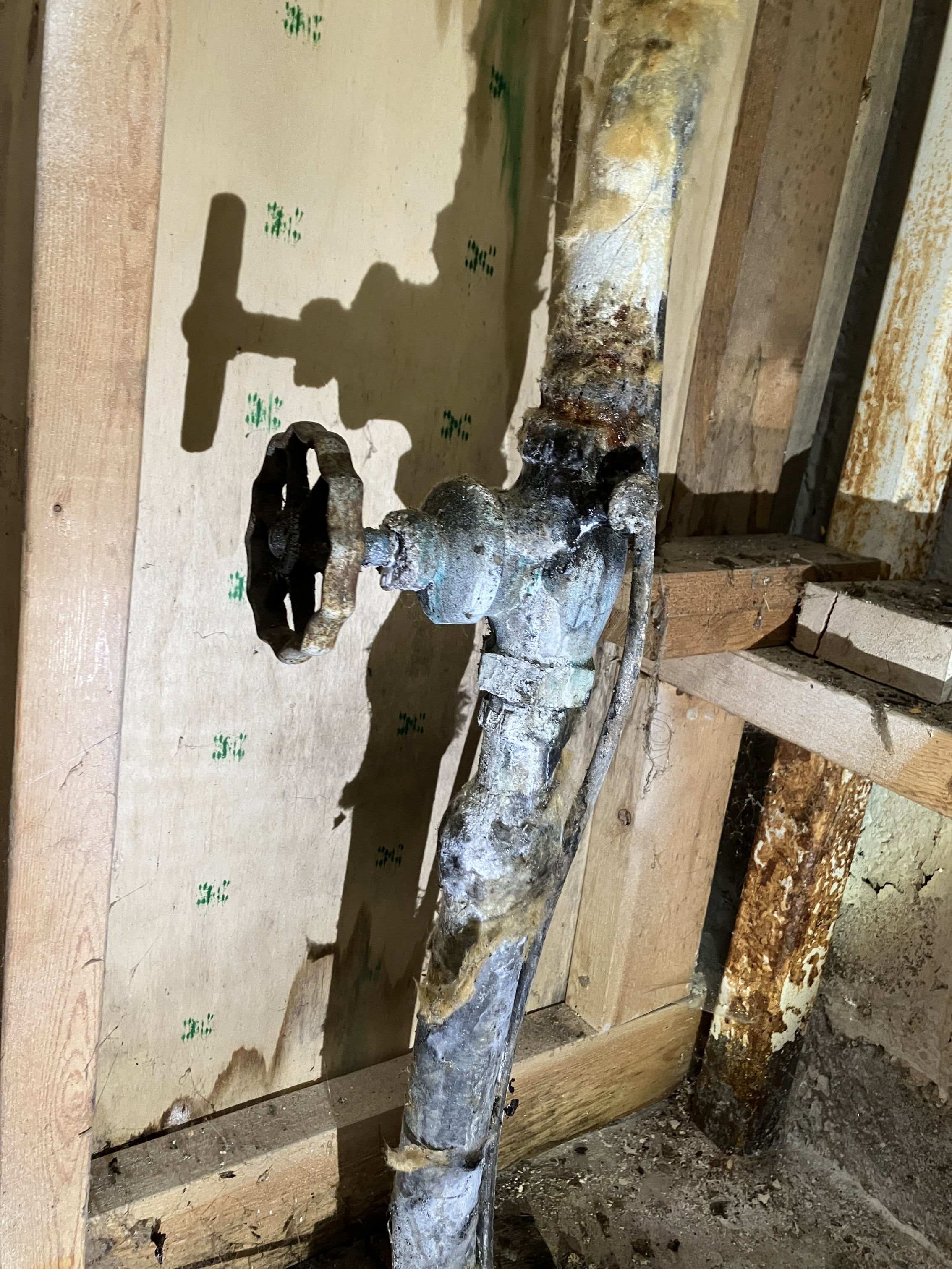

The lead service line enters the home, then goes to a square-headed shutoff valve, then to the meter, then to a 90 degree lead line, then to an ancient globe shut-off valve.  Beyond that is all galvy distribution lines.  I plan to replace the globe valve with two full-port ball isolation valves, and a whole-house Phyn brand automatic shut-off valve.
As a homeowner in my municipality, I am allowed to get a plumbing permit and request a curb stop shutoff. Here are my questions if I decide to proceed myself:
-I am a bit scared of the ancient square-head shut-off valve before the meter.  I think I would just leave it alone and assume the curb-stop will take care of everything.  If I were to damage that, I would be up the creek without a paddle.  Do you agree?
-What do you think about the 90 degree lead line after the meter?  The simplest course of action would be to leave it in place, but why would I keep it?  Wouldn’t I be better off just putting some regular piping and an elbow in there?
From there, I would just put in a ball valve, the automatic shut-off valve, another ball valve, and then a union and some 1” galvy to reattach to the house distribution system.  I decided to put in two ball valves as “isolation valves” for the automatic valve.  I want to do that because I figure the chances of that Phyn whole-house valve still working as planned in, say, 40 years, is close to zero.  I would like to minimize the trouble of replacing it.
I am undecided on tackling this myself.  If it were downstream of a reliable shut-off valve, I would have no hesitation, but….   Any thoughts or questions are warmly welcomed!

    Since they are not replacing the service line, yet I guess you need to do something so we both can sleep at night.
    I would not touch the square head cock. I would have them shut it down at the curb stop. Run any pipe you can ahead of the shutdown if possible. When they shut off the curb stop drain it down and use a wet dry vac at the water meter outlet. Disconnect the nut carefully on the meter outlet and re connect to your new pipe.
    Probably need a new gasket at the meter outlet

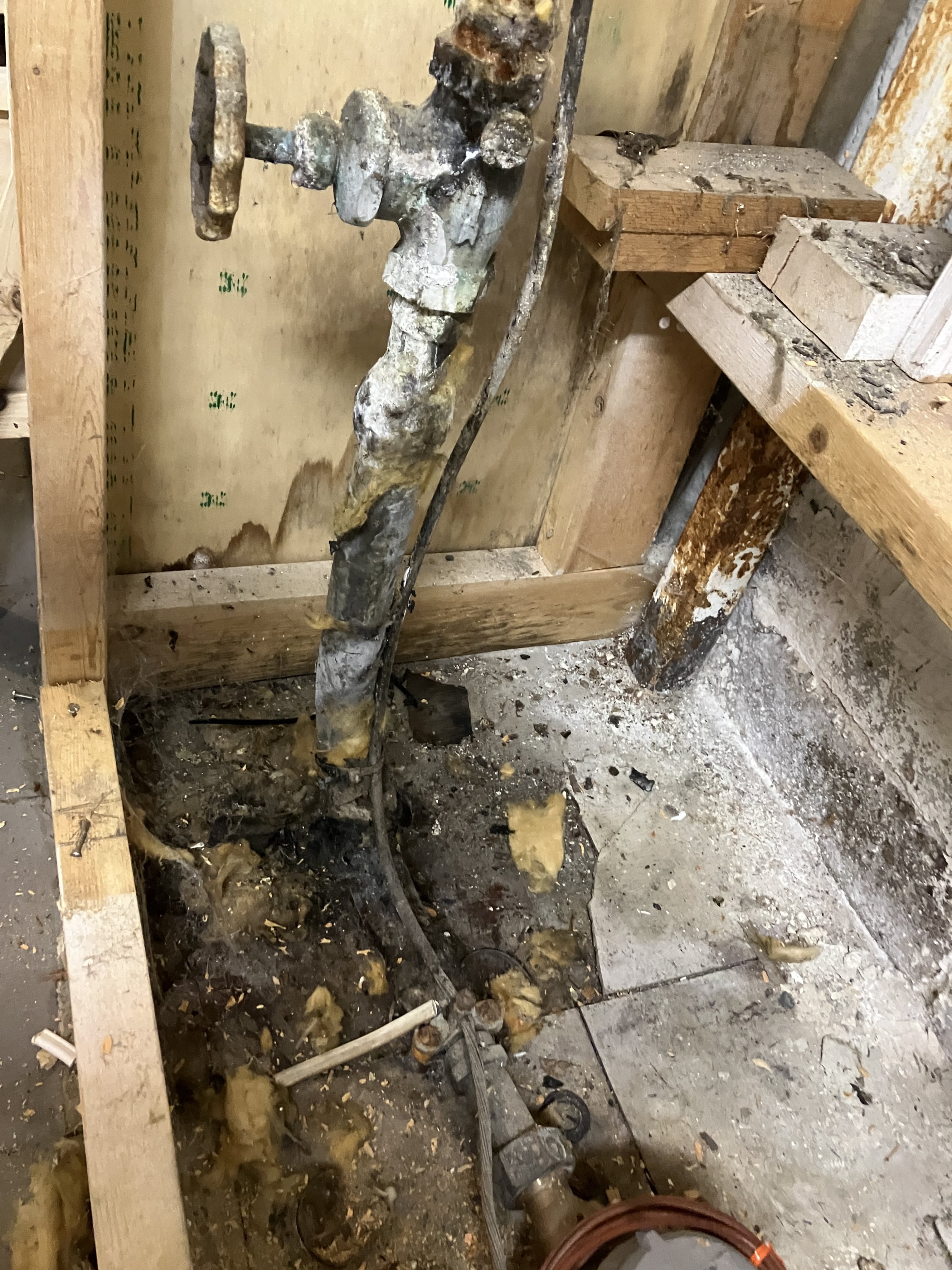

    obviously the only right way to do it is to replace the service which might be where you end up anyhow.
    if it weren't leaking all over the place i would leave the riser out of the meter in place but since it is weeping I would do as @EBEBRATT-Ed said and very carefully break the union out of the meter and build new from there. you should support the new valves with some hangers of some sort. hold the meter well with a backup wrench when you break the meter union so you don't disturb the service.
    lead pipe was fairly delicate when it was new and after 100 years it will be very brittle. it might just split down the seam if you bend or twist it much or try to cut it.
    if you break the service you will either have to hope you can get a good cut on it and use a dresser coupling or wipe it in to a new fitting, both of which are pretty dicey on a 100 year old piece of lead pipe.
    so what happens if the service crumbles when they try to close the curb stop? does the service get replaced?
    i think i see an old meter gasket on the floor. the vinyl asbestos tile is a nice added touch.

    Not sure how I'd go after that. Under an assumed name, I think. However, one thing I notice — that system is bonded around the meter for the electricity, and I'm a bit suspicious that that may be your primary house electrical ground, using the service pipe. I'd want to double check that and make sure that the bonding in replaced — and possibly have a new modern whole house ground installed for the electrical system.

    You'll be swimming 🏊‍♀️ in very deep waters. I'm doing this 40 years, and I'd be very cautious. Sounds like you just need to find the right guy. Where are you located? Mad Dog

    someone did manage to change the meter in the not so distant past.

    A lot can go wrong in that proposed project! What if you damage the lead portion? How would you deal with that repair?
    It's been how many years? Why not wait until you get the line replacement. Shut off the curb stop if you leave for extended time.
    You might drive a ground stake for the system ground?

    Thank you all for your input. Yeah, you are right…. I am not going to take this on myself. That is what I had concluded before, for the reasons you guys point out, but I was just getting impatient.
    I will give my plumber another chance. He hasn't seen the job, but I described it to him. My concern is just that he hasn't exactly jumped on setting a time to do the work after agreeing to do so. Saying "AWOL" was a little harsh. I want to use the mom 'n' pop shop, but if he doesn't come through, I could call one of the larger firms that have been bought up by private equity.

    As for the electrical bonding wire, yes, that heavy-gauge wire runs to the complete other side of the house and goes into the electrical panel.
