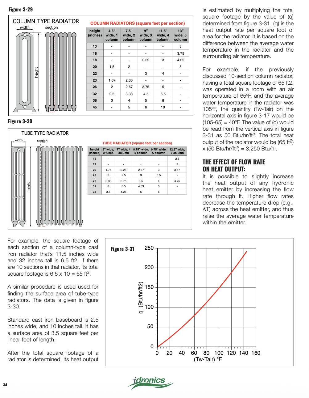

    the exact formula given in one of the recent idronics issues is: radiator output = 0.3748 * EDR * (avg water temp - room temp)^1.3, so it’s not quite linear in produced water temps.

    A very common radiator around me is the BaseRay cast iron baseboard. The manufacturer's data sheet is at: https://s3-us-west-2.amazonaws.com/catsy.782/Baseboard+and+Radiators+Product+Data+Sheet.pdf
    On page 2 there is an output vs temperature chart. I took the numbers from it and put in the graph below, it's a straight line:
    If you look closely you can see a dotted line, that's the actual straight line. But the values are rounded to the nearest 10 BTU/hr.
  • DCContrarian
    DCContrarian Member Posts: 1,569
    Another popular radiator is the Slantfin. Their datasheet is at: https://www.literature.mestek.com/dms/SlantFin/HD-10-6.pdf
    Output information is on page 3. Here's the chart;
    Again, it's a straight line.
    hot_rod Member Posts: 28,303
    The output when simulated shows a slight curve, but not that it changes the answer that much. Fairly linear would be a good description.
    The SIM adds some operating condition, the ambient air temperature, to the equation. The ∆ between the radiator temperature and surrounding ambient is what determines output. As the air warms, ∆ changes, output changes.
    Increasing flow causes the entire radiator to warm which can get a slight output increase also.
    This math assumes a CI baseboard 2.5" wide, 10" tall for 3.5 sq ft per lineal foot.

    You're not going to be able to get the interior to 120F using 125F water because the temperature difference is too small.
    Let's say you have a system that is capable of maintaining 70F with 125F water when it's 15F outside. The temperature difference between the inside and the outside is 55F, and the difference between the water temperature and the inside is also 55F. As a first approximation, the heat flow between both the radiator and room, and room and outside is proportional to temperature difference. Running that system full out with the same 125F water when it's 60F outside you'd expect the temperature differences to remain equal. The difference between interior and water is 65F, so you'd expect the interior to stabilize between them, 32.5F away from each, at 92.5F.
    This is basically the same game as using old fuel bills to estimate the heating load. You could measure the existing boiler's run time during cold weather to estimate how much heat the radiators are actually putting out.
  • DCContrarian
    Here is a graph of that formula. The dotted line is a straight-line trendline:
    X-axis is temperature in F, Y axis is BTU/hr per square foot. As you can see, in the temperature range that radiators normally operate it is very close to a straight line.

    Thanks everyone for sharing real data from the radiator manufacturers, and for checking my math. My point was specifically in regards to the statement that @DCContrarian made, about getting 40% of the output from 110F AWT compared to 170F AWT earlier in this thread. I think the actual number is 30% right? (110-70)/(170-70) = 0.400, but (110-70)^1.3/(170-70)^1.3 = 0.304. I agree that seems small, but if you took the 40% number seriously you'd only get 76% of the BTUs you thought you would get.
    If your wedge (^) symbol means multiply (and even if it doesn't), these two calculations should both yield the same quotient, no, as the 1.3 cancels out?
  • tcovert83
    tcovert83 Member Posts: 44
    @Alan (California Radiant) Forbes I am using the "^" symbol to exponentiate. I think the simplification you might be thinking of is (110-70)^1.3/(170-70)^1.3 = ((110-70)/(170-70))^1.3 = (40/100)^1.3, which is still 0.304.
