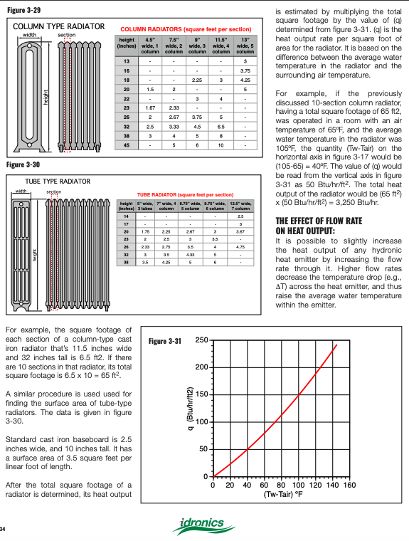

  • tcovert83
    tcovert83 Posts: 52
    the exact formula given in one of the recent idronics issues is: radiator output = 0.3748 * EDR * (avg water temp - room temp)^1.3, so it’s not quite linear in produced water temps.
    This is a common comment. Don't bet on it. I doubt very much that it's true more than half the time — at least in my area it isn't.

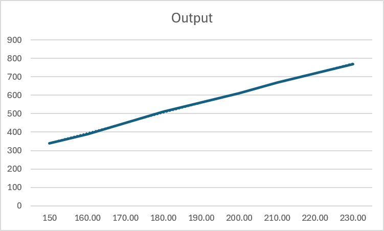

    A very common radiator around me is the BaseRay cast iron baseboard. The manufacturer's data sheet is at: https://s3-us-west-2.amazonaws.com/catsy.782/Baseboard+and+Radiators+Product+Data+Sheet.pdf
    On page 2 there is an output vs temperature chart. I took the numbers from it and put in the graph below, it's a straight line:
    If you look closely you can see a dotted line, that's the actual straight line. But the values are rounded to the nearest 10 BTU/hr.

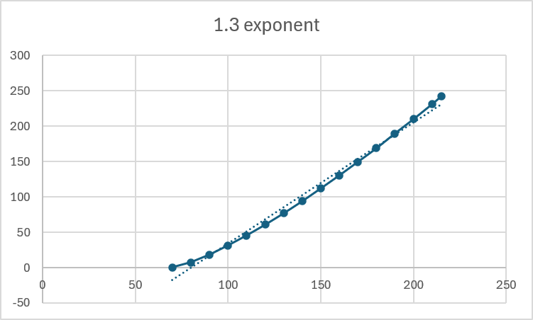

  • DCContrarian
    DCContrarian Posts: 1,588
    Here is a graph of that formula. The dotted line is a straight-line trendline:
    X-axis is temperature in F, Y axis is BTU/hr per square foot. As you can see, in the temperature range that radiators normally operate it is very close to a straight line.
  • tcovert83
    tcovert83 Posts: 52
    edited June 1
    Thanks everyone for sharing real data from the radiator manufacturers, and for checking my math. My point was specifically in regards to the statement that @DCContrarian made, about getting 40% of the output from 110F AWT compared to 170F AWT earlier in this thread. I think the actual number is 30% right? (110-70)/(170-70) = 0.400, but (110-70)^1.3/(170-70)^1.3 = 0.304. I agree that seems small, but if you took the 40% number seriously you'd only get 76% of the BTUs you thought you would get.

    From the OP: "We have hot water radiators cast-iron radiators in this old house was built in 1900 in New England. "
    @kcopp I'm not tracking your comment, can you clarify?
    edited June 1
    If your wedge (^) symbol means multiply (and even if it doesn't), these two calculations should both yield the same quotient, no, as the 1.3 cancels out?
  • tcovert83
    tcovert83 Posts: 52
    @Alan (California Radiant) Forbes I am using the "^" symbol to exponentiate. I think the simplification you might be thinking of is (110-70)^1.3/(170-70)^1.3 = ((110-70)/(170-70))^1.3 = (40/100)^1.3, which is still 0.304.
    Alan (California Radiant) ForbesPC7060
