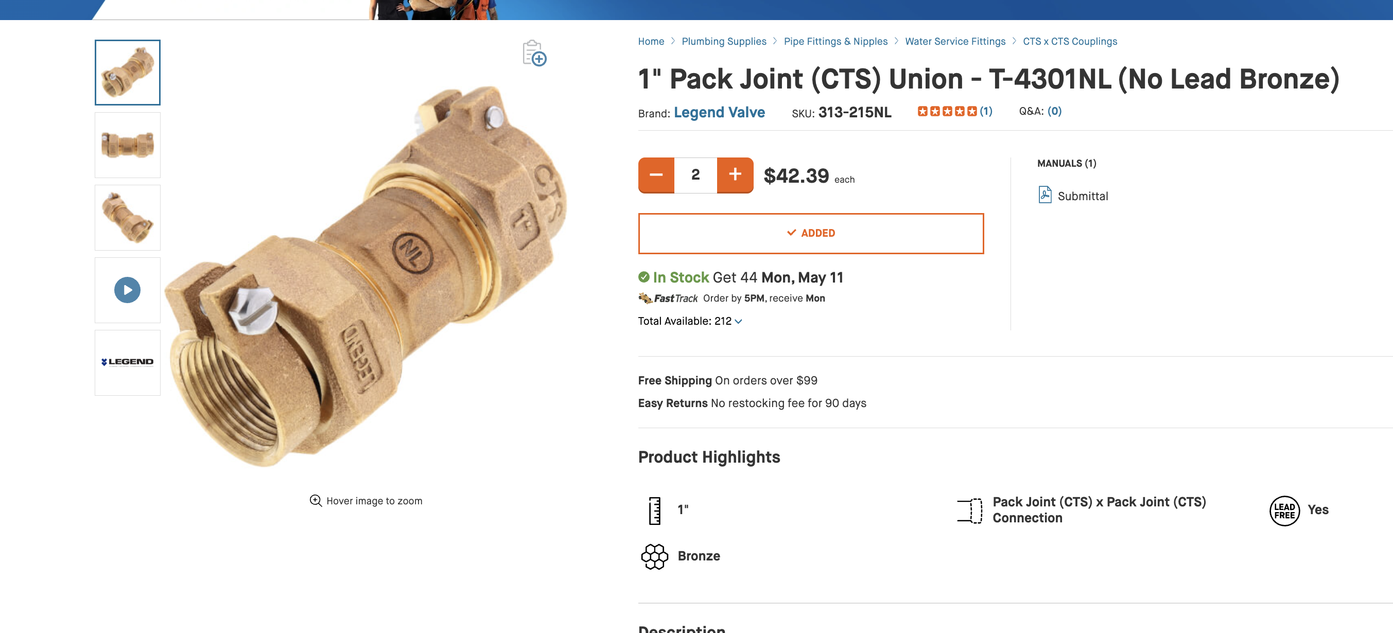

    I know flare fittings are the correct repair. I'm having trouble finding someone who wants to flare it. What do you guys think of using a 1" Pack Joint (CTS) Union. It's rated underground water service application.
    https://www.supplyhouse.com/Legend-Valve-313-215NL-1-Pack-Joint-CTS-Union-T-4301NL-No-Lead-Bronze

    are you sure it is 1”? 3/4” copper, the more common size for a home measures 7/8” od
    1” copper would be 1-1/8”
    That coupling may be hard to get over the tube which tends to be somewhat oval shape from being coiled. If you have the correct size and can clean the tube well, it should seal.
    With a flare fitting, the flare tool rounds the tube so the nut and coupling assemble.

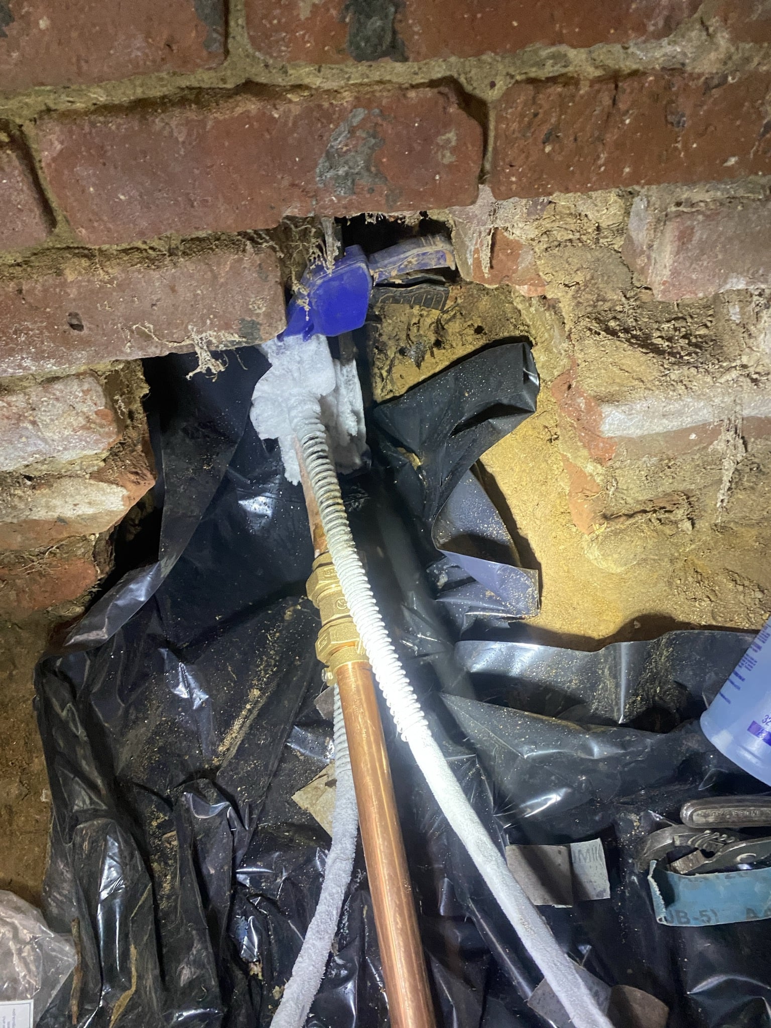

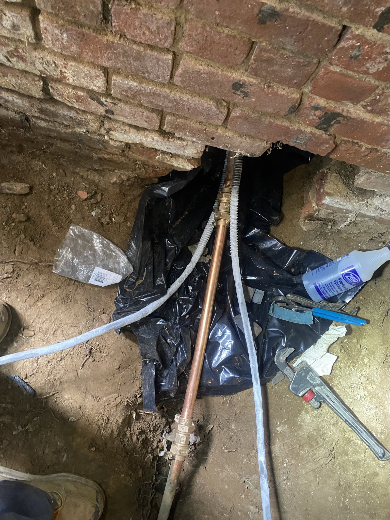

    Froze the line with the Ridgid SF-2500 ($100 rental), replaced 24" of damaged pipe.
    Thanks for all the helpful insight!!
    (location is after the meter)
