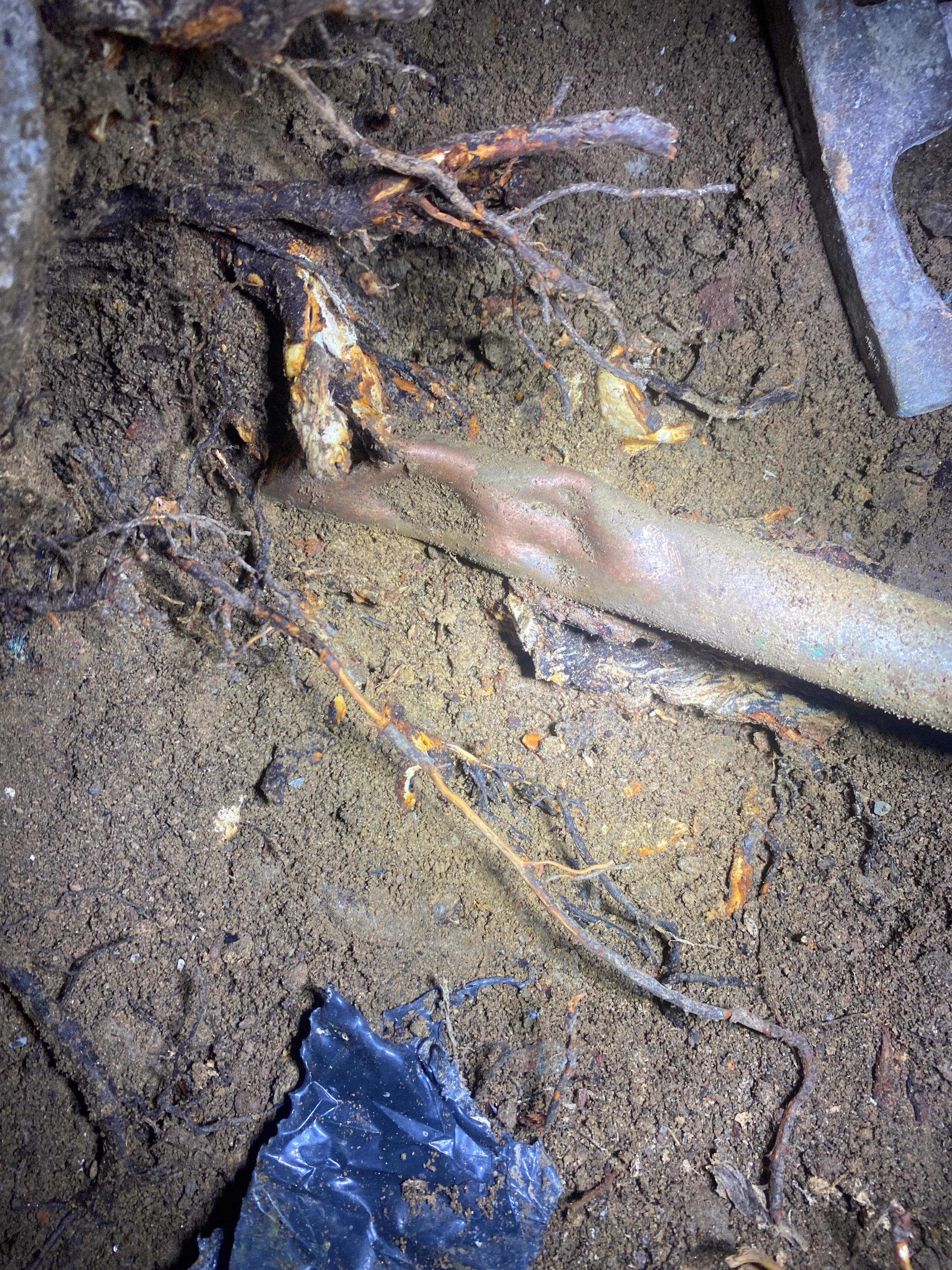

I'm having my basement slab redone and the contracter crushed my incoming water pipe with his demo hammer. It's not leaking…. yet. At first he tried to deny it was his doing. But the shiny copper is a dead give away. See pics. The repair sleeve was already there. This is in the areaway (the outside entrance to the basement). My main cutoff is inside the house.
I'm in an old brooklyn rowhouse and we could not find a street cutoff on the sidewalk or the street. According to AI, older homes don't have cutoffs at the curb (buried under the sidewalk with access thru a hole in the ground). I only see cutoffs on new houses and some renovated houses.
I started calling around to plumbers and I've got one coming tomorrow. The contractor also has a contractor coming by.
Kitchen sink pressure seems ok. But based on the crush I can only imagine how bad it will be with multiple fixtures running. This is a 3-family building.
Sweating bullets here. Any advice is appreciated.
FWIW - I've paid 40% of the slab quote. And they are pouring the basement tomorrow knowing they are not getting paid until my pipe is repaired. So good on them.
I've read a tool like WHEELER-REX Pipe Shut Off Tool could crimp the pipe and then re-round it. Also should I ask for flare fittings or will propress be adequate. I heard sweating couplings is not recommended for buried city mains.

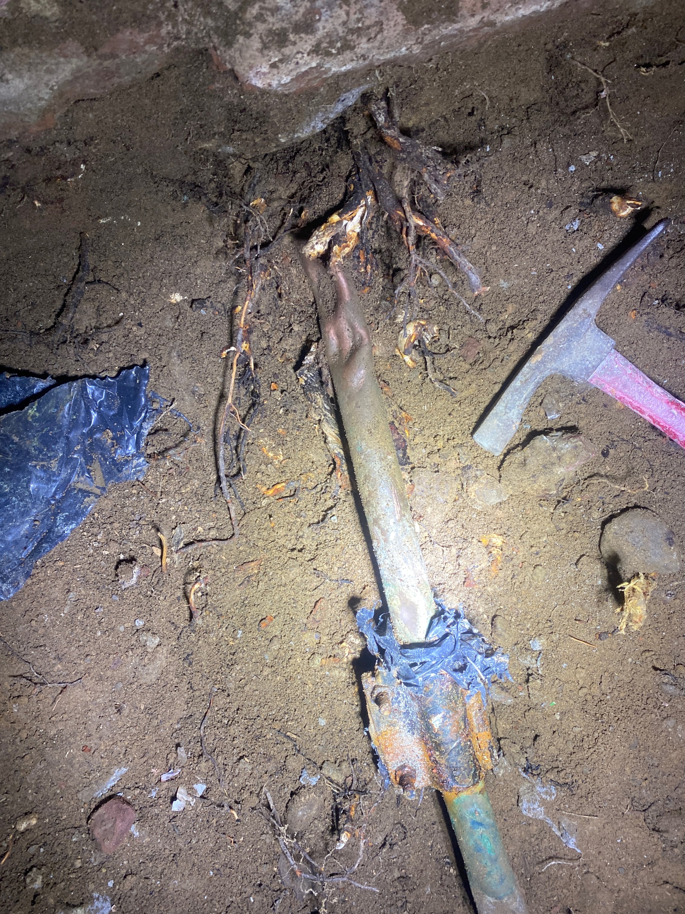

    Corrosion to copper, really any metal tube is greatly accelerated when you have aggressive soil, and moisture, the electrolyte.
    Based on the roots, they must be a source of moisture? Maybe that repair band?
    Any way to reroute it above the slab,

    looks more likely that it was damaged and someone used a repair clamp that is leaking and has corroded it.
    btw steel was sometimes used for services in to the 50's or so and lead in to the 80's so that is likely after 1950 but copper tubing like that became available around 1930.

    A section of that line needs to be replaced. That homemade clap is not allowed anywhere.

    i wouldn't bury a dresser coupling under the floor. flaring that shouldn't be hard for a plumber that does service work. try @JohnNY

    I'd cut out the crushed section as well as that repair and use pack joints to connect the new section of copper.

    Froze the line with the Ridgid SF-2500 ($100 rental), replaced 24" of damaged pipe.
    Thanks for all the helpful insight!!
