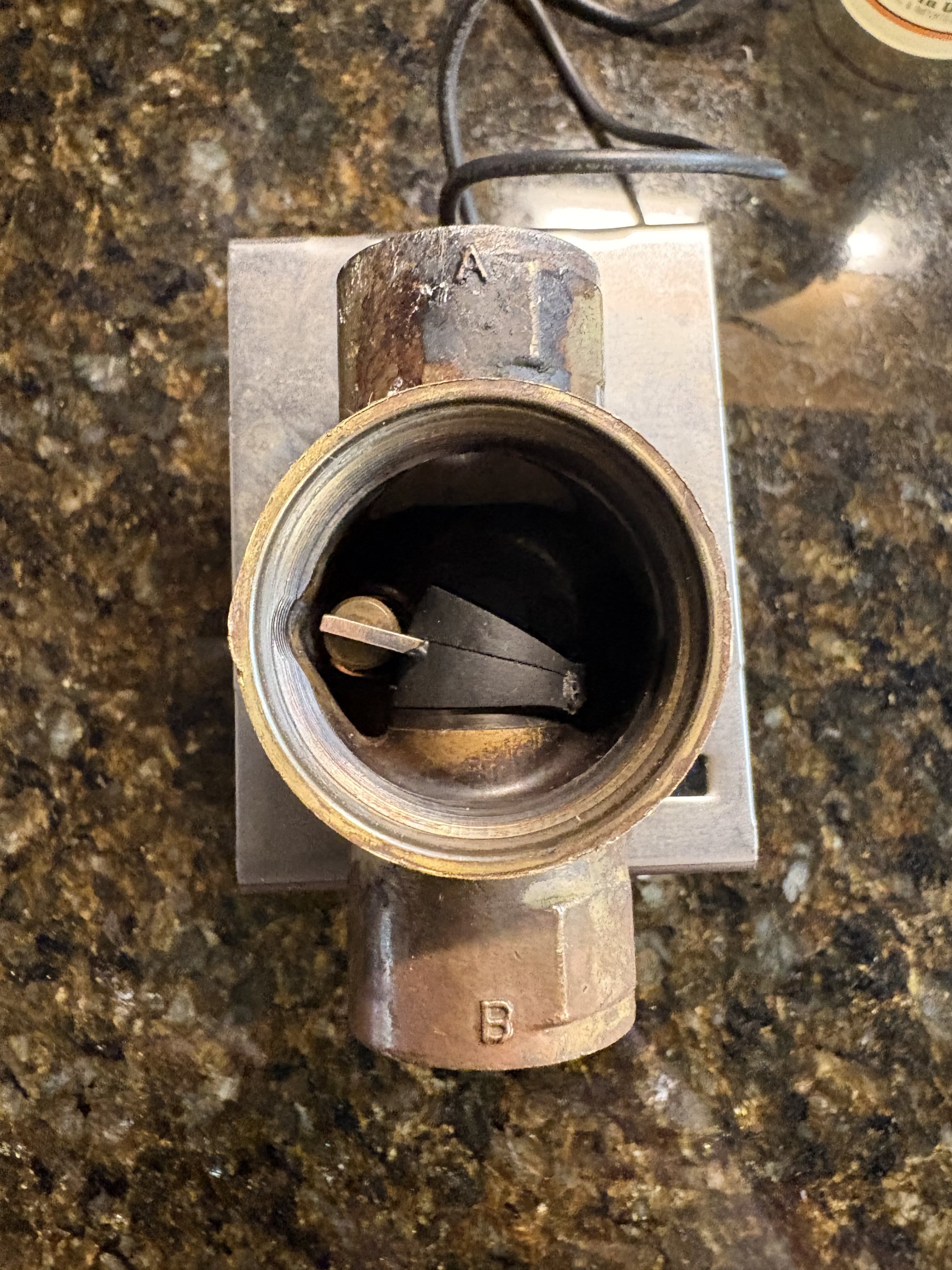

    Almost Done! Didn’t have to cut even one pipe!
    Sweat out sweat in. The exact replacement was the right choice. I will have 5 new valves and actuators.
    hot_rod Member Posts: 27,663
    Alan, consider an ECM delta P circ on the next upgrade. They all deadhead when all zone valves close, at a low rpm/ no flow codition.
    Alan (California Radiant) ForbesSuperTech
  • skyline137
    skyline137 Member Posts: 57
    5 new zone valves and the original actuators and everything is working fine…so far. I inspected all 5 old valve bodies. if there was a reason that #5 zone was failing I couldn’t see it.
    There were no cracks, wear, corrosion or any damage to any of the valve bodies or paddles. At this point I’m still not sure what was going on with zone 5. All actuators were working including #5. I didn’t touch the wiring. Valves were replaced, system refilled actuators popped back on and it’s working. There’s only one moving part in those valves so I can’t figure why 5 was leaking even after installing a new paddle and actuator.

    maybe the new gate isn't clocked to the shaft the same way as the older valves to so it didn't close all the way.

    I checked the gate/paddle for the correct operation. I had the back off and opened and closed the gate. It operated exactly like in the new valve body I took it from. I would’ve bet on that working but it didn’t.

    I wouldn’t think Erie redesigned that paddle from the original design, if do there would be different part numbers to match different vintage valves
    What did that small crack in the one body look like when you got it out?

    The valve body had no damage what had appeared to be a crack was just a black mark. Side by side comparison of the paddles was identical.

    you could put it together and close it and turn it so the inlet is up and pour water in it and see where it comes out.

    My guess is the paddle itself is weak and flexing open when there is circulator pressure against it. You can see where it ties into the hinge pin it just a very thin piece of plastic. my guess, it's flexing or cracked. if the valve is normally closed you can bench it, buy some poly tubing and test it. We would all encourage you. That its how we all got to where we are. seriously.

    The valve 5 leaked at any call for heat from any of 5 zones or hot water. The valve leaked with old actuator or new . The valve leaked with old paddle or (identical) new paddle. Any call for heat from zones 1-4 or hot water caused #5 valve to act as if open but lever on actuator was in the closed position. If zone 5 called for heat the actuator lever and valve worked properly. The new actuator on new valve body is not leaking and only open when it should be when #5 thermostat calls for heat. I have a toe kick heater on zone five or I may have never noticed it. It’s not really that much of a problem in the winter just extra heat. When there’s a call for hot water in warm weather zone 5 would heat the room (toe kick heater fan on) with the central AC system running. I will spend some more time carefully investigating that valve body.

    I forgot in my last post to say that I manually closed the valve #5 with vise grips with a bungee holding it closed tightly and it leaked as if open.

    I looked the #5 valve over carefully there’s nothing wrong with the valve body. I believe I have found the reason for that valve leaking/opening whenever the furnace turned on. According to some information I have found that the problem could be due to excessive pressure in the system. If there is excessive pressure in the system the spring mechanism in the actuator will back off to relieve the pressure. The position of zone 5 was at the end of the manifold probably having pressure build there first and causing that valve to open. Since zone 5 released the pressure the others were
    operating normally. I sure I’m not explaining this totally correctly but that’s the extent of my knowledge.
    This is talking about the pressure the pump adds to the system not the fill pressure. This added pressure is call pressure differential, and that valve should be able to take 15 psi or more delta P.
    It would take a fairly high head circulator to push past that valve.

    Whatever was causing it, opening the pipes to install the new zone valves and refilling the system has solved the problem… so far. It’s only been a few days of spring weather here, not much call for heat.

    I don’t think the valve body was leaking at all. I think pressure was causing the paddle to lift off the seat. The spring in the actuator applies pressure to the paddle. The valve is normally closed due to the pressure of the spring. When the actuator is energized the motor and gears compress the spring lifting the paddle and opening the valve. Enough pressure on the paddle will cause the same effect as the motor opening jt. I put a short piece of pipe into the valve body and put my thumb over the seat I blew as hard as I could in the pipe and there was no leaking of air. Pipe seat being sealed by my thumb and no pressure leak. Really not complicated how the paddle or my thumb closes the flow.
    The most common 3/4 sweat Erie is the 7.5 Cv. It has a 17 psi shutoff. You do not have a pump in your system capable of 17 psid. If you did all the valves would be blowing by, all the time.
    The static pressure in your system, no pumps running would have the same pressure on both sides of the paddle. The spring tension has the ability to hold 17 psi regardless.
