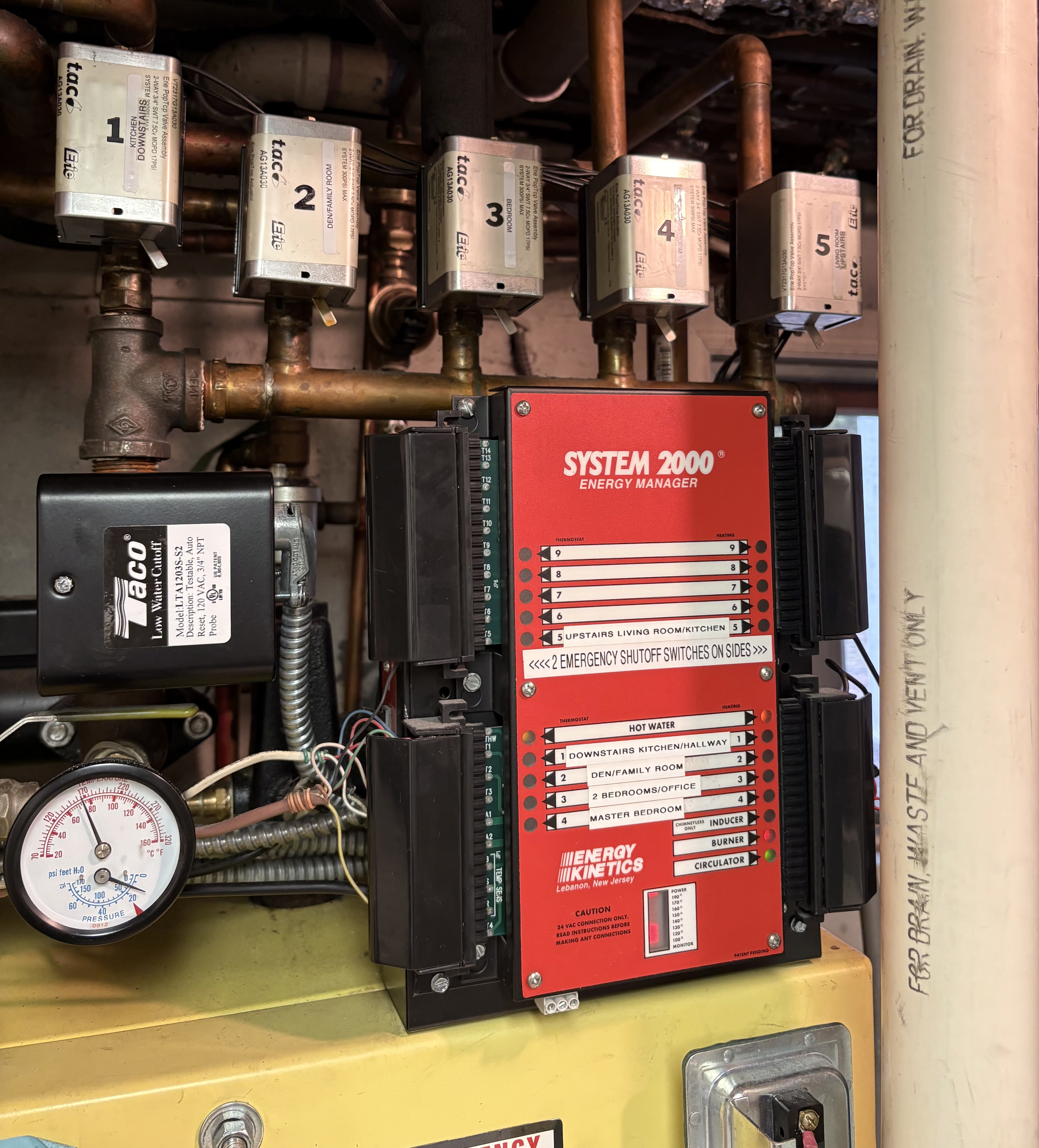

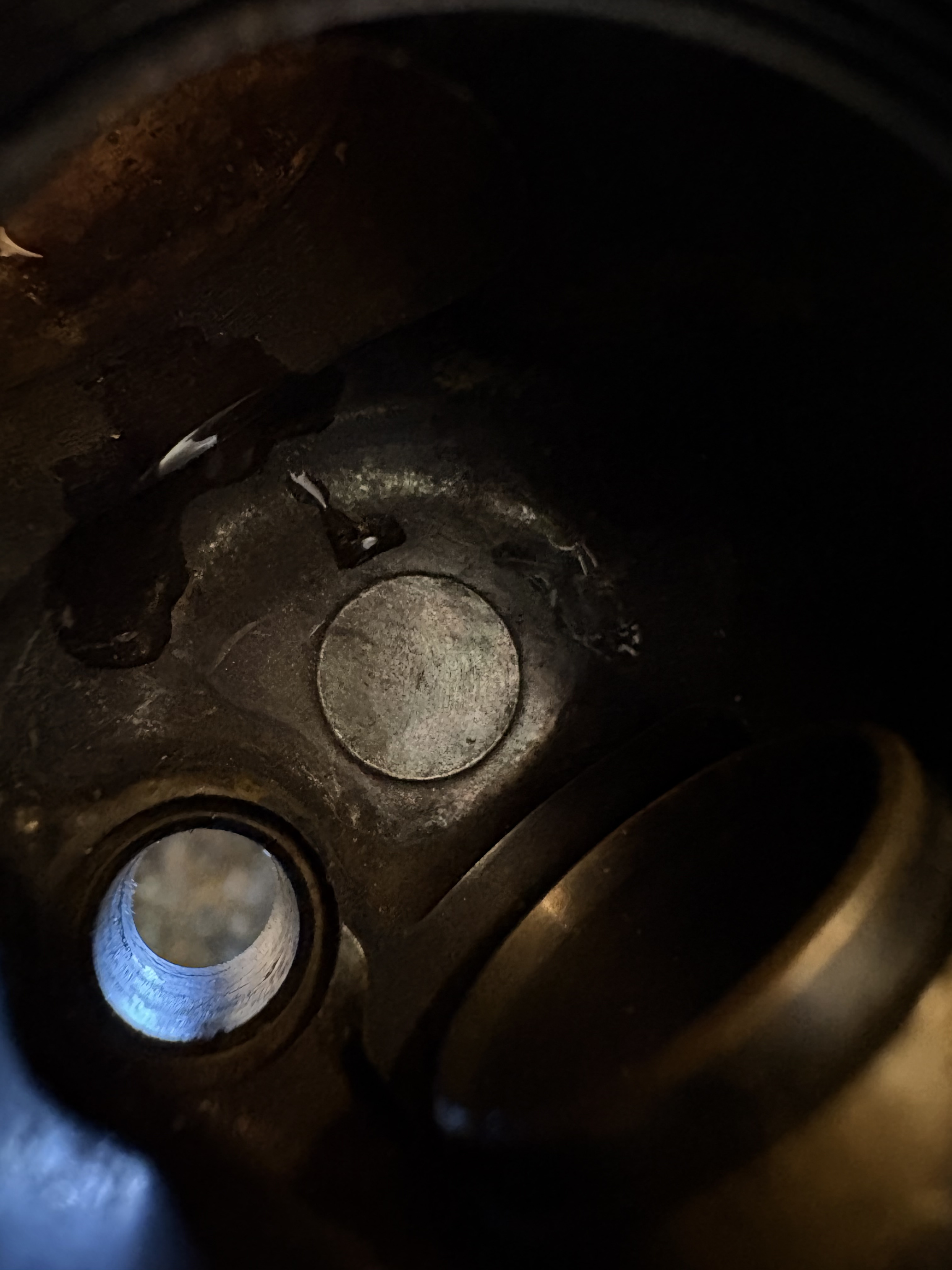

I’m starting a new discussion because I’ve narrowed down but not solved my problem. I have an oil fired hydronic baseboard heating system. I have 5 zones plus hot water. Zone 5 ALWAYS gets hot. If any thermostat on zone 1-4 or hot water calls for heat 5 get hot. It’s obvious the valve was stuck open. I purchased a new actuator and a replacement paddle for the valve body, the actuator is new and working and the paddle inside the body is new. Zone five is still getting hot, not just warm from conduction but blazing hot water is still flowing through it in both the closed and open positions. I didn’t inspect inside the valve body because it was hard to see inside and the original paddle showed damage. Could the valve body possibly be causing this. All other zones work perfectly and the two wire thermostat on zone 5 is new and working.

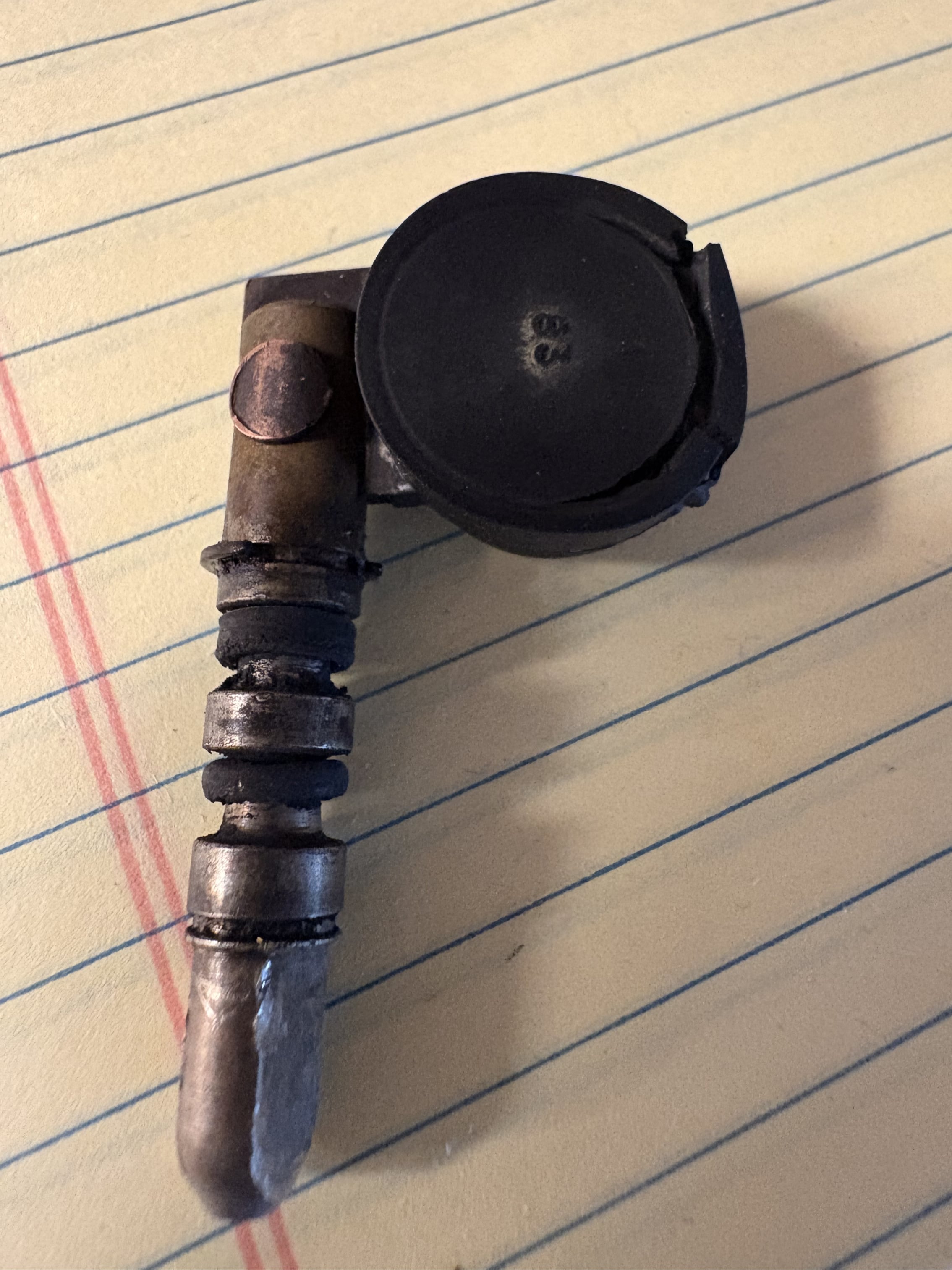

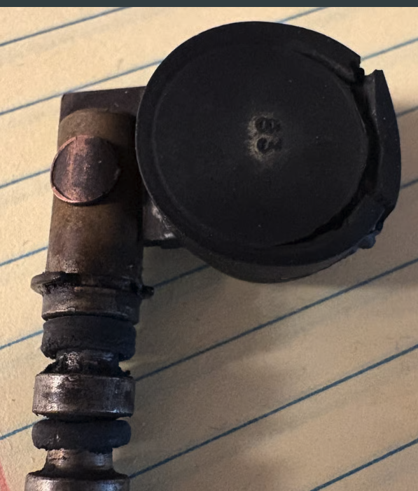

    The paddle is new, the original one is in the attached photo. I will have to open it up and if necessary clean or replace the valve body. I don’t think it is back flow because pipe from the manifold past the valve goes from cold to hot in a matter of seconds after the burner lights. It shouldn’t get hot with a closed valve. All of the thermostats are on 50 degrees only the hot water is active but as soon as there’s a call for hot water zone 5 pipe gets hot. I wouldn’t have even noticed it but there is a cabinet toe kick fan on that zone.

    The old one looks pretty chewed up. And the paddle is cracked. There might be some plastic lodged in there somewhere. I've never replaced the internals on an Erie Pop Top. Can it only go one way?
    As long as there's definitely no voltage to the actuator, you might be looking at complete replacement.

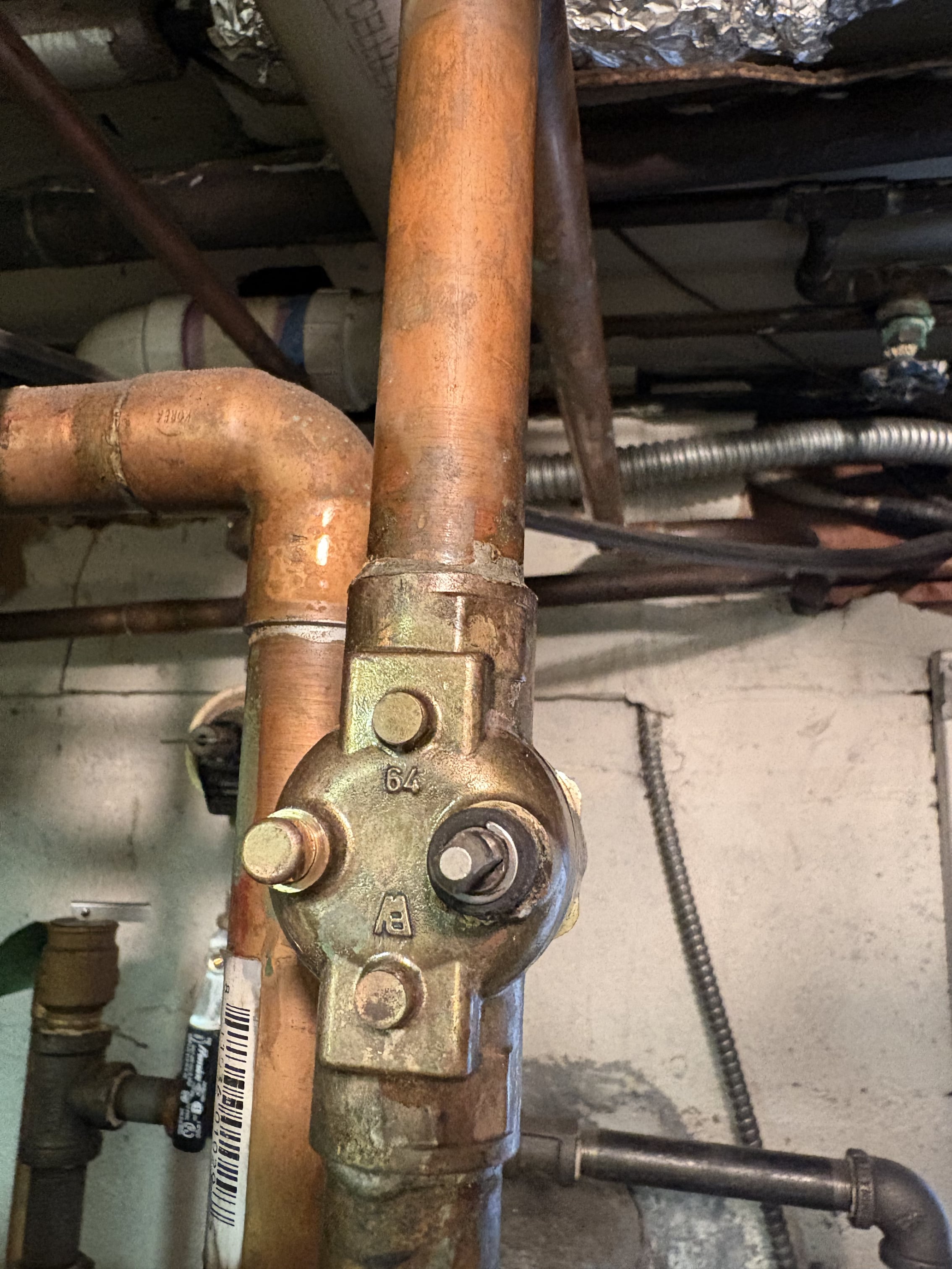

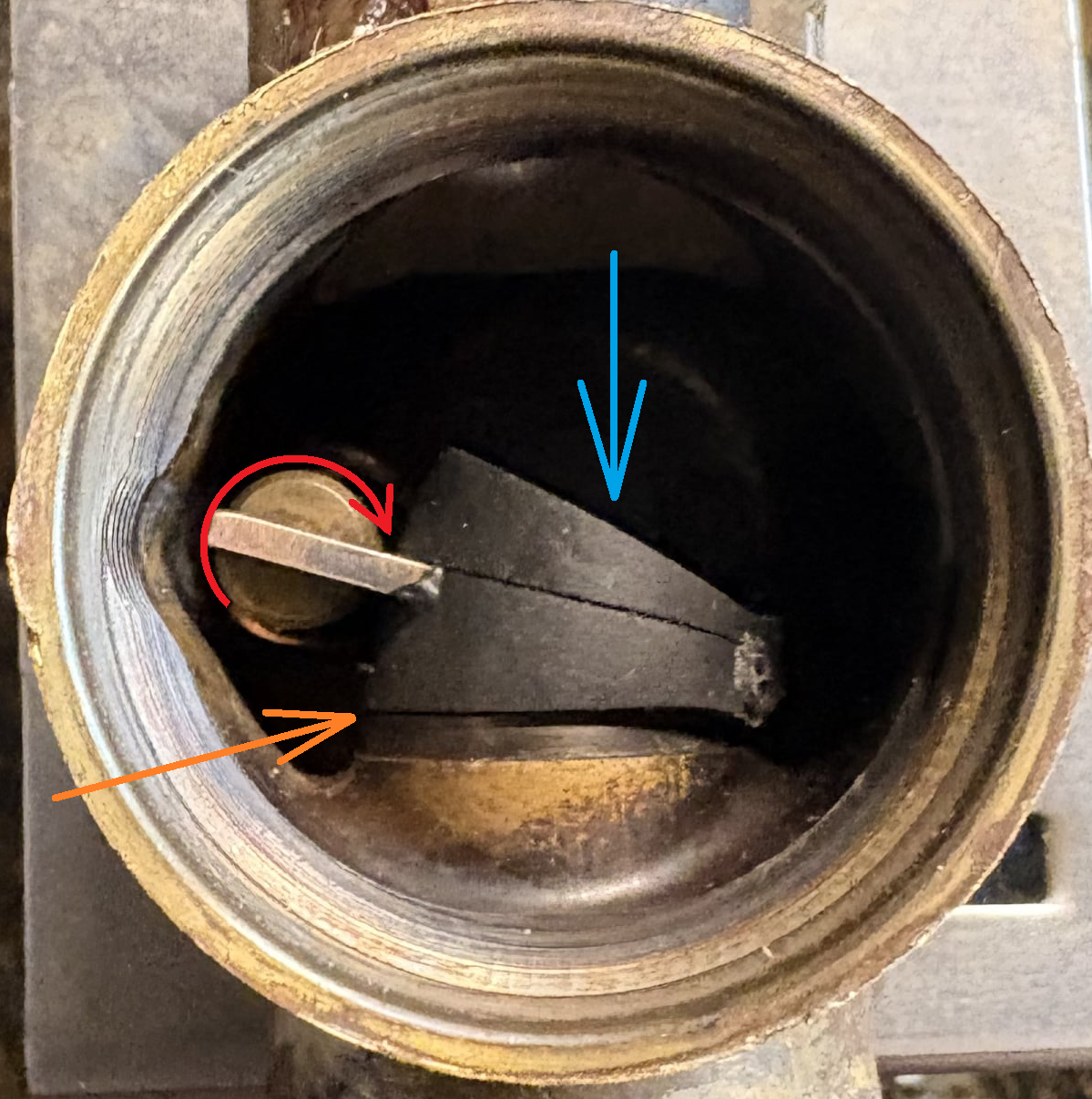

    The paddle can only fit in one way. There is a hole and. groove on one side of the body for the shaft. Easy to do remove retaining c clip and back cover put shaft in and put c retaining clip back on. This is a new body the shaft is the chewed up one. The new shaft is in the valve that is not working the shaft only can go in one position rubber paddle is permanently attached.

    This is why we, as techs, will replace the whole valve. It's not worth the risk to just change out parts of the valve and hope there isn't something else going on. If i was going to open up the valve and drain the system the smart play would have been to just change the whole valve body and actuator. Now your just questioning the issue again.

    With the paddle dilapidation as shown, it would not surprise me if the old valve seat is eroded also causing the zone valve to leak.

    I should have checked the inside more carefully. I did put my finger inside and I didn’t notice anything. It’s my house and I will remove the back and check the seat. I will post a photo when I do. Thanks for the help.

    unless it is a very old valve where the brass has become brittle, the seat should be fine. It may have debris, teflon tape, etc stuck on the seat
    The paddle and o rings look like maybe you have some aggressive fluid? Check the ph

    The seat looks a bit questionable.
    Maybe you could drill out the rivet and flip the paddle over for a temporary fix.
    EDIT: Not sure if the hole in the flat plate is centered.

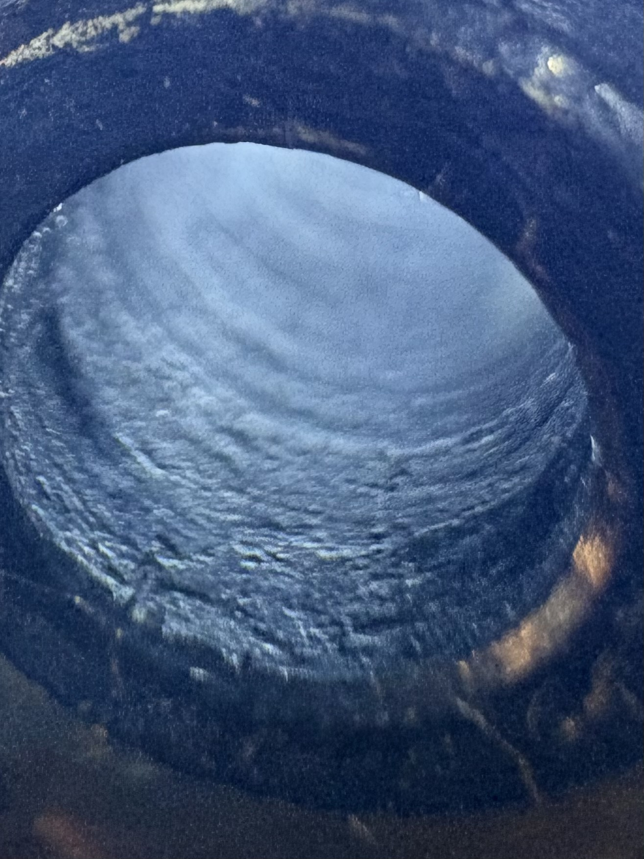

    The valve seat actually felt smooth. At this point I’m done with the trial and error. I’m just going to put new valve in.

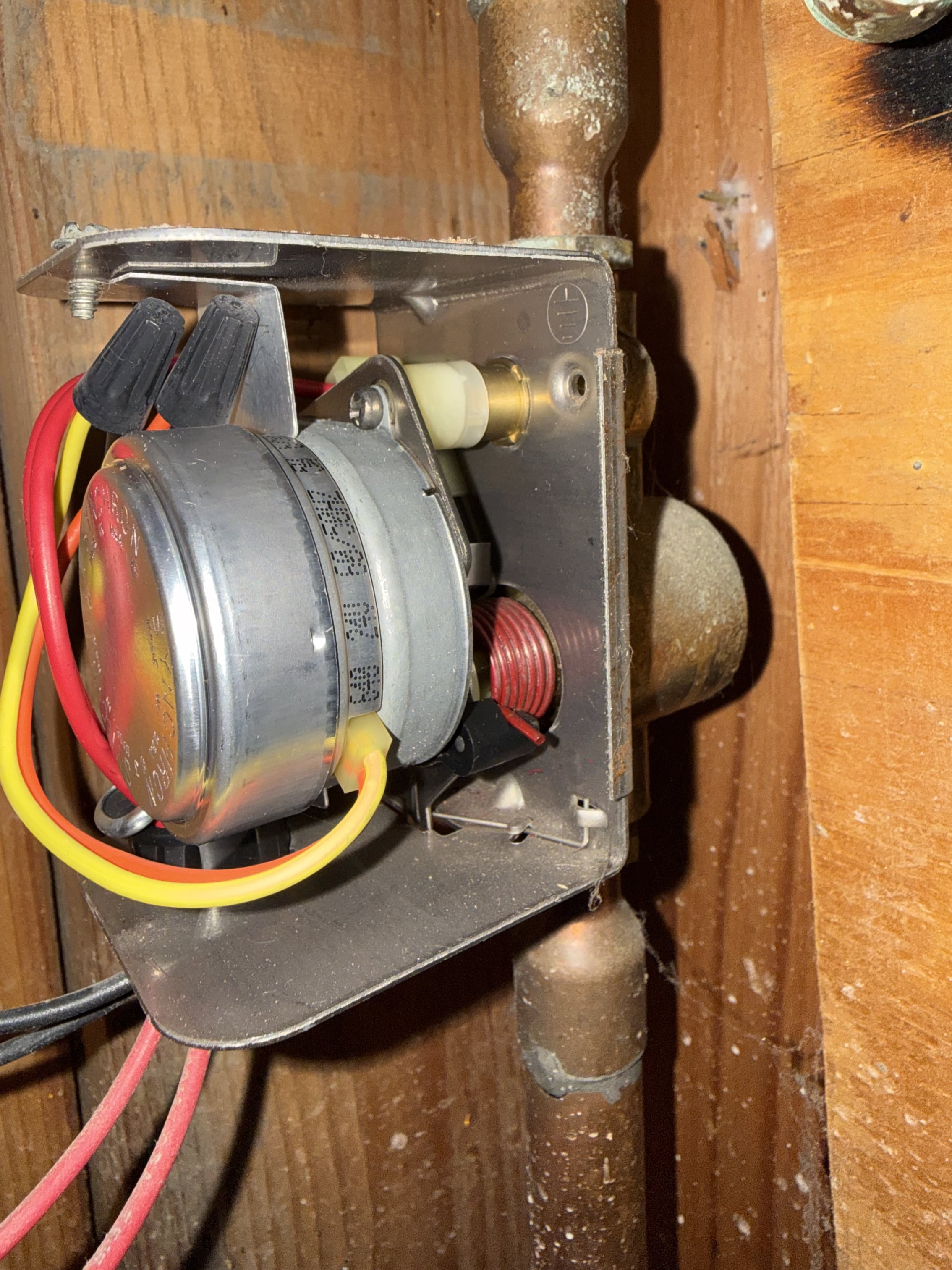

    it’s 9:45 PM this zone valve thing has got me beat. I put a new paddle in my zone valve and took it apart again to check what I knew in my head was working properly. The zone valve back is off the valve looks PERFECT inside. The new paddle looks to work perfectly.
    The seat looks new, perfect. This is a normally closed valve. The actuator is new. The thermostat is new. I know how to manually open these Erie valves with the lever. The lever is hard to push to open manually. When the actuator is activated and open the lever slides effortlessly. CLOSED hard to push OPEN slides easily. Why does my zone #5 get hot when the valve is obviously closed and every time the burner turns on?

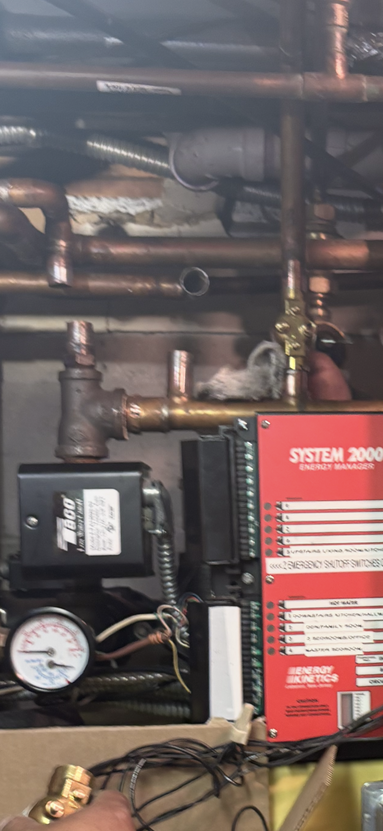

    The wiring from the thermostat is very straight forward no mistake which thermostat wire it is.
    the red and white wire is zone 5. The red is spliced to black the white is in a bundle with the other thermostat wires. The black (spliced) goes to T5 (thermostat 5) on the controller.
    The new actuator has two black wires one is connected to Z5 (zone 5) and the other is bundled with the other 4 zone wires. I DIDN’T TOUCH any wires just trying to to troubleshoot. I did connect the new two wire thermostat and the two wire actuator.
    hot_rod Posts: 28,699
    disconnect the wires to this valve when another zone and the pump is running
    Does flow go past the valve? If not that valve is getting power when it should not
    When you push the manual lever you are working against the spring tension. With that short lever it takes some force, plus the lever is sharp, hard on the fingers!
    When the valve is powered open you are not pushing against the spring, it should be a floating lever.
    You are sure it is not a NO normally open actuator?
    In some rare cases a high head circ can slightly open a high Cv, low close delta p zone valve. But if it has worked in the past, that is not the issue
    If all the above checks out, It sounds like the zone actuator is sending power to the valve, regardless of a thermostat call?
    if you do end up replacing the whole valve, put a manual valve in series with it so you can shut off flow from that end definitively.
    did you try removing power fro it before? it is possible the old valve was held a little bit open by some power it was getting and that wore out the gate so you now have 2 problems, a gate that won't seal and a contact that isn't fully opening or something shorted somewhere.
