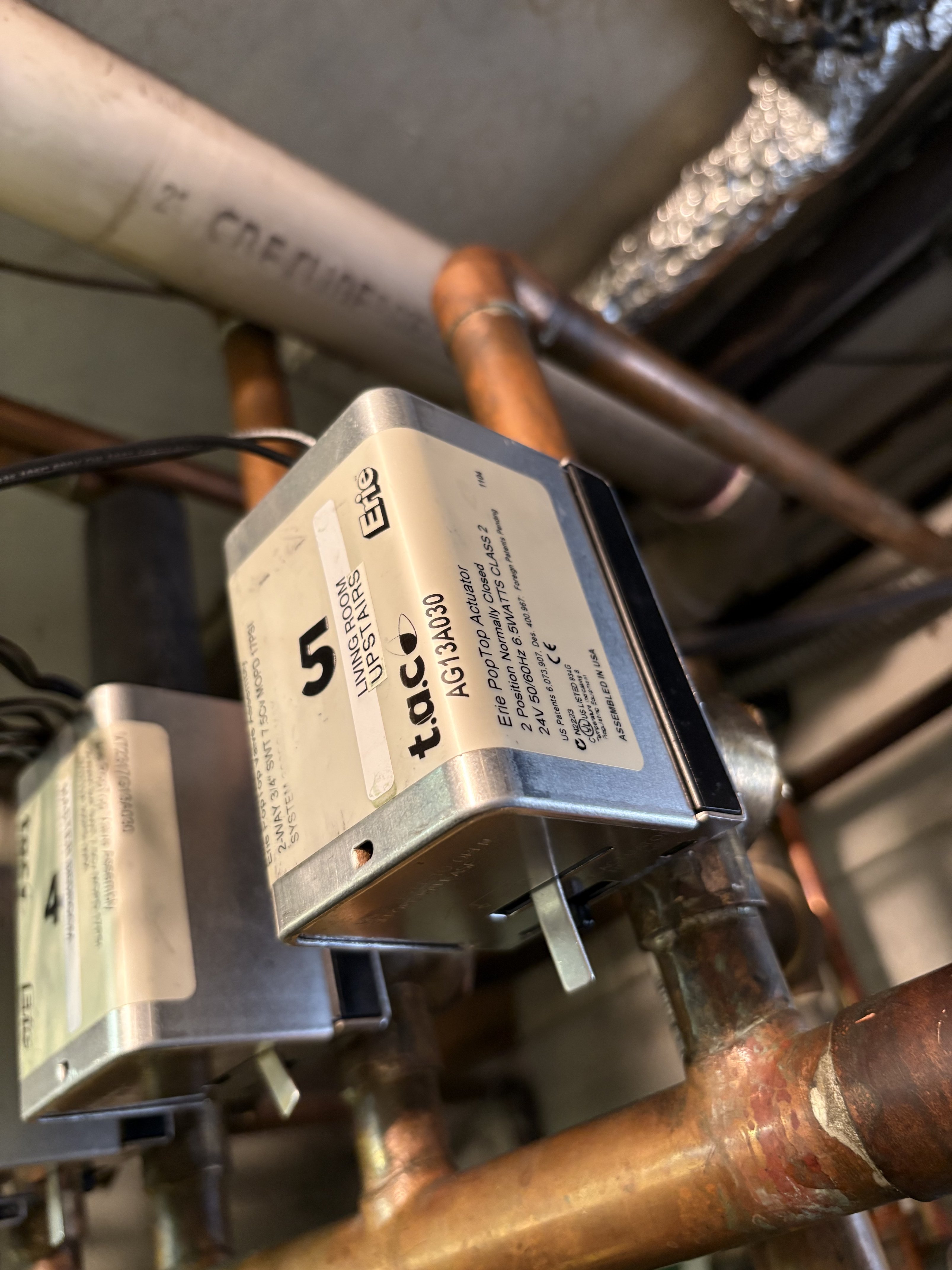

    I replaced the Honeywell.mercury thermostat. With a basic round new Honeywell. When thermostat clicks on the inducer light on energy manager lights, furnace turns on and zone valve opens. All 5 zones now have the same thermostat and work as they should except zone 5 gets hot with zone valve in the closed position. That happens anytime the furnace comes on. The actuator on 5 is new exact replacement. Is it possible that because zone 5 is at the end of the manifold there is back pressure causing the problem?

    All of the zone valves are showing above 26 volts AC.when energized except when thermostat calls for heat. This problem may have existed since the furnace was installed but was not noticed it until a toe kick heater was installed and turned on. The fan can be heard and the heat is forced unlike baseboards.

    If you are going to use a voltmeter to help troubleshoot the situation, only when the zone 5 actuator is expected to be active there should be 24 VAC (nominal) between the Red and Orange arrows.
    When the zone 5 actuator is expected to be inactive the voltage there should be 0 VAC between the Red and Orange arrows.
    Since it appears the zone valve actuator motor is a common synchronous motor like an old school clock motor I doubt a DC voltage across the actuator would do much of anything to cause this situation, but since it is easy to check it won't hurt anything.
    Disconnecting the zone 5 actuator at the Z5 screw terminal is the simplest way, then you know no power can get to the zone 5 actuator. Just don't let the loose wire touch anything else.

    I have done all the voltage checks, all are above 26. All zones measure 0 when closed. I have removed the covers and watched all of the actuators operate at the appropriate times.
    109A_5 Member Posts: 4,146
    So on zone 5 when inactive and another zone is active there is no visible shaft rotation on zone 5, correct ?
    OK if you have positively ruled out any possible electrical cause, how about excessive shaft run-out play at either end of the shaft ? That valve gate / paddle has to sit perfectly flat against the seat, if the hole through the valve housing that the shaft goes through is not perfectly round the water pressure and/or actuator spring pressure could be offsetting the shaft from the desired axis. Thus shifting the shaft lifting the gate / paddle off the seat enough to leak. Possibly more at the shaft end of the valve gate / paddle.

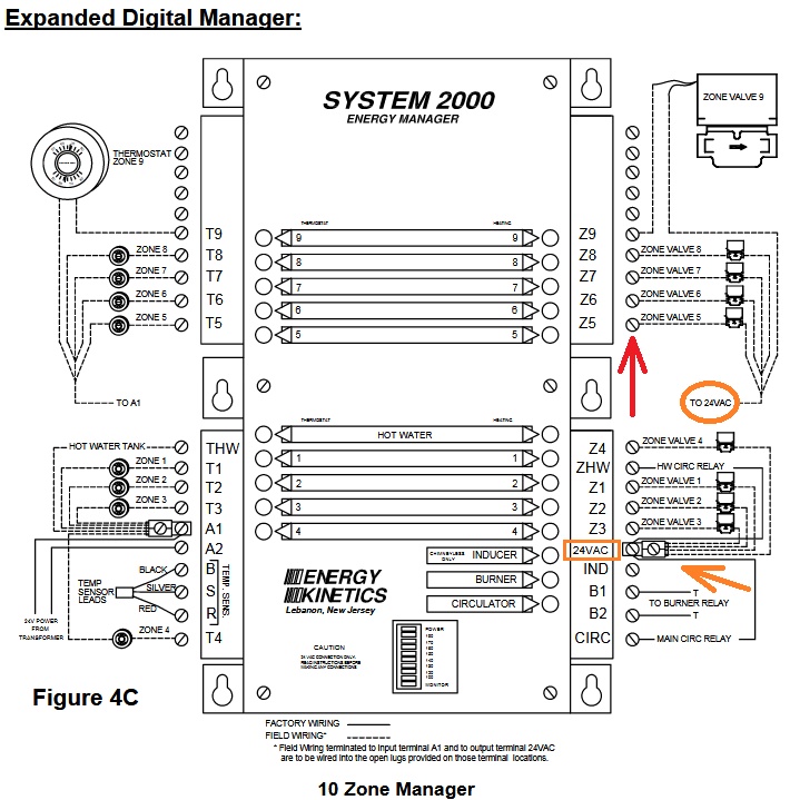

    skyline137 Member Posts: 45
    I measure 26 volts on the Energy Manager between T 1,2,3,4,5 and Z 1,2,3,4,5. Each thermostat call for heat and terminals on Energy Manager measure zero on corresponding zone. All actuators are working zone 5 valve is flowing not sealing when actuator is removed and closed with vise grips.
    edited April 25
    Measuring between T 1,2,3,4,5 and Z 1,2,3,4,5 makes no sense to me. Depending what is inside the Energy Manager the T and the Z of the same zone may be two entirely different circuits with a common 24VAC power supply.

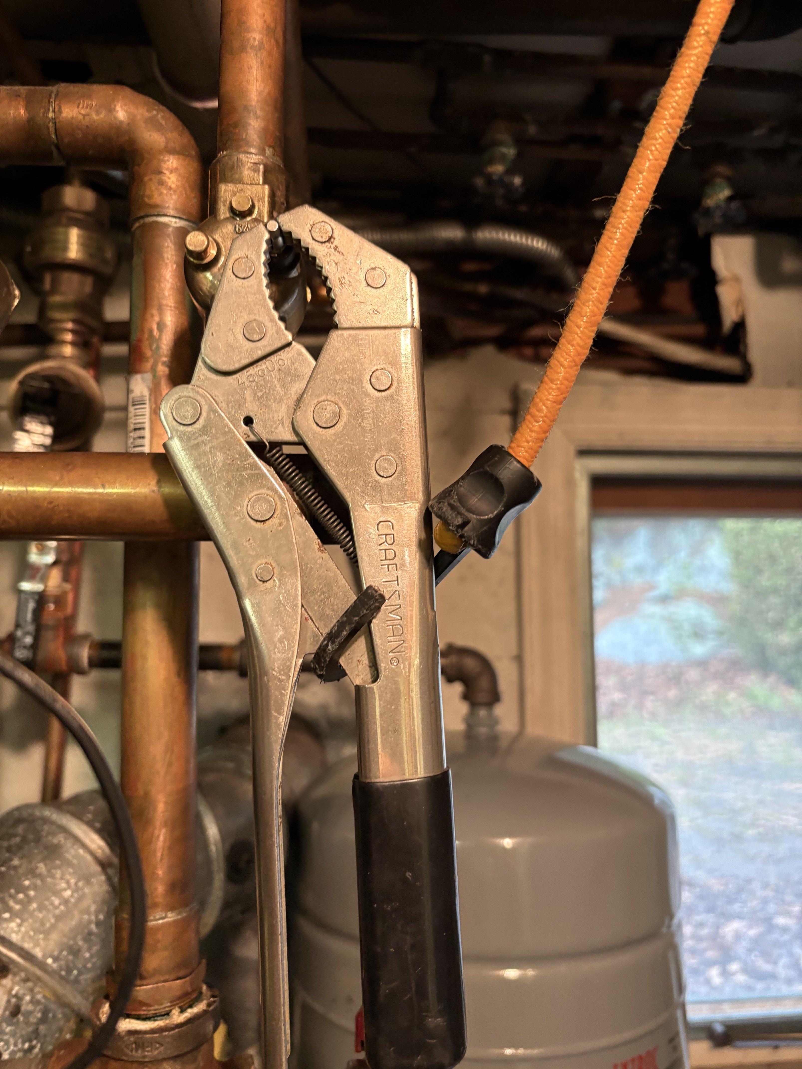

    Anyway with the valve being mechanically held closed by the vise grips there should be an obvious difference where the paddle meets the seat compared to a properly working valve. You may need a feeler gauge to actually realize the gap. Or your new paddle is porous.

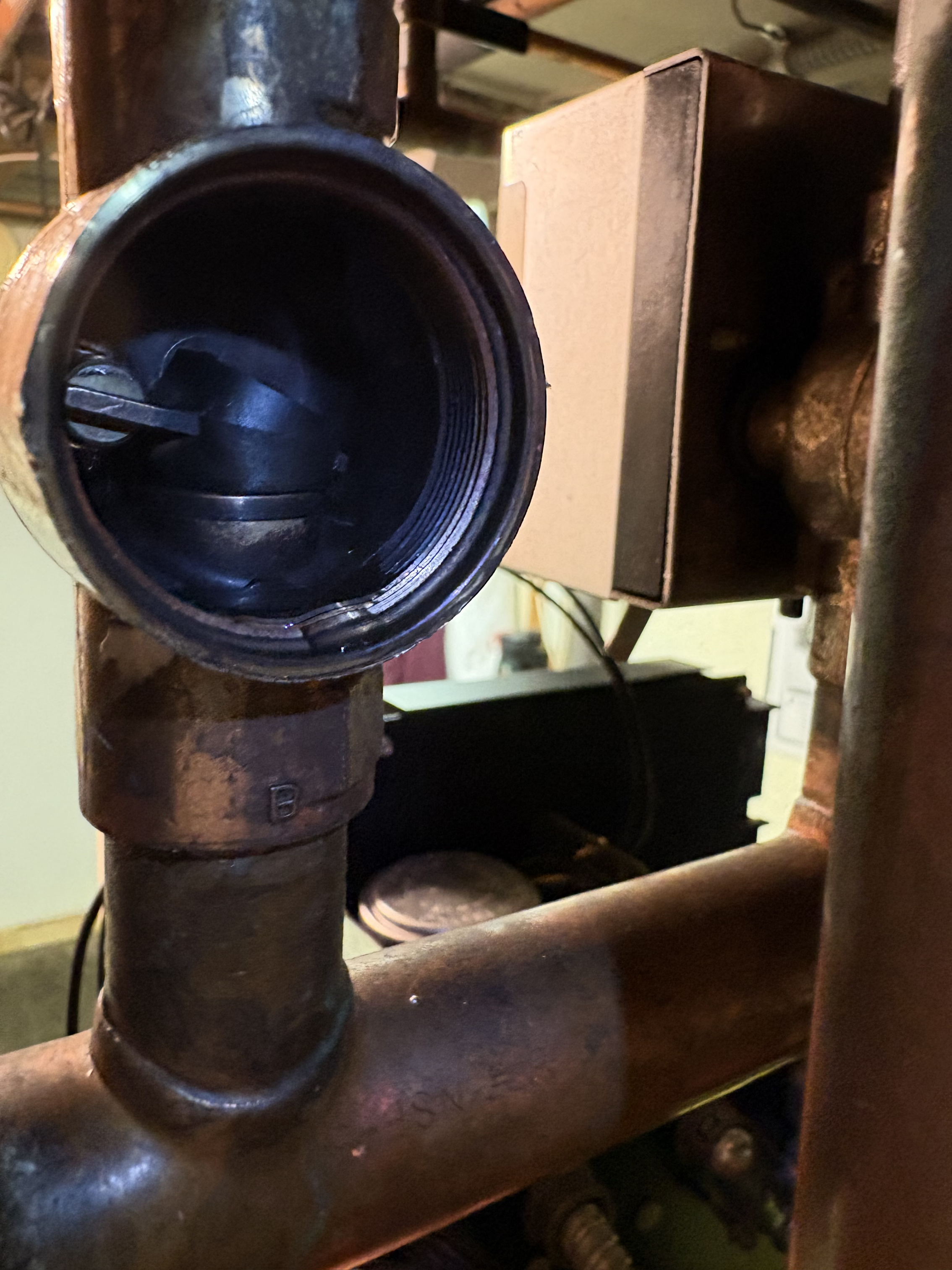

  • pedmec
    pedmec Member Posts: 1,426
    Did you replace the valve body? It still looks like the valve body is old.
    who soldered it in if it is new? did you have a plumbers solder it in?

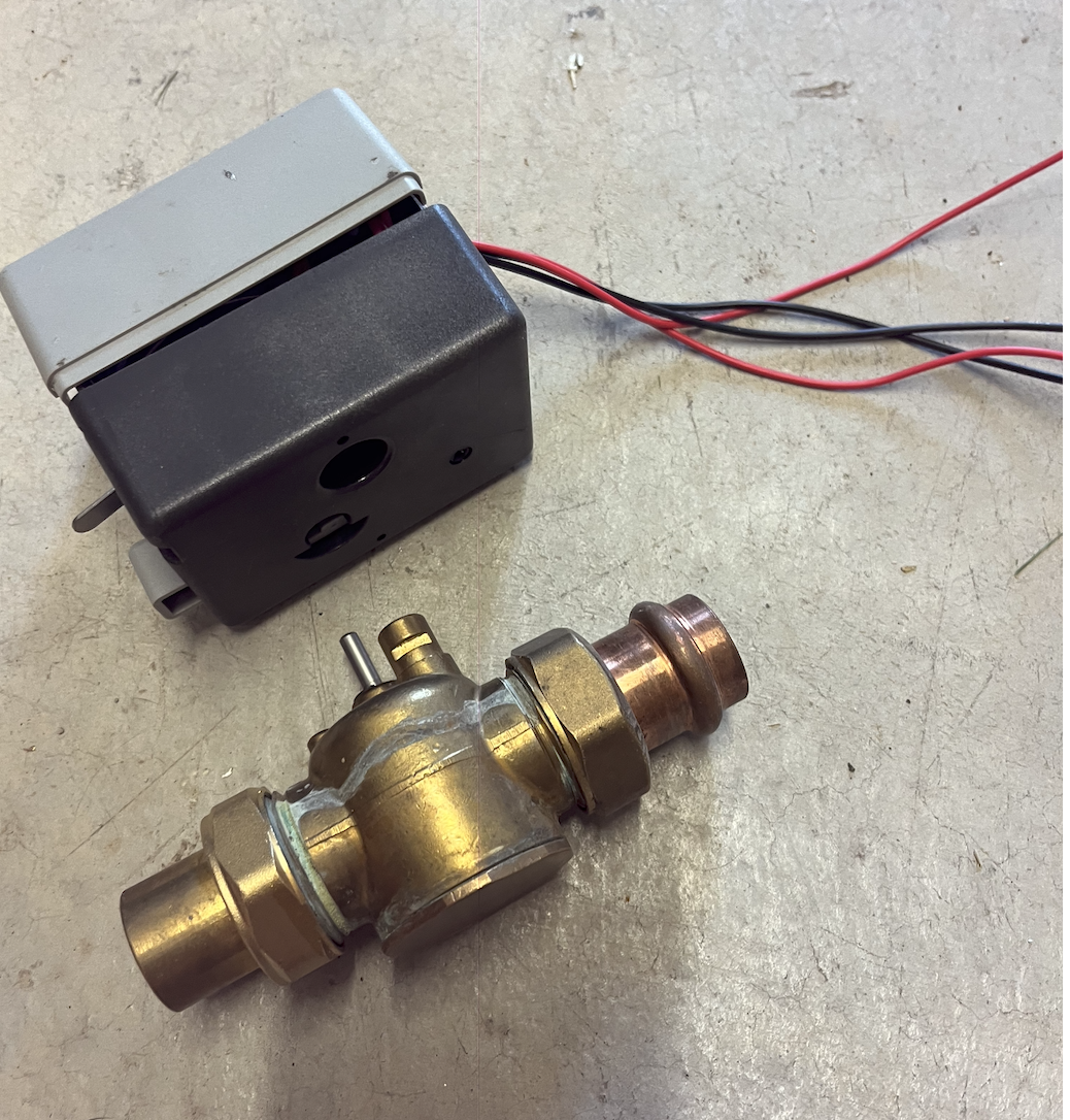

    hot_rod Member Posts: 27,613
    I don’t see that you have enough stub off the zone valve header to press in a new zone valve, so you may need to go with a solder version.
    Caleffi has a solder version with unions.
    I wonder how much torque that bungee is applying to the zone valve shaft🤔
    Send me that Erie if you remove it. I know the engineer that designed that valve, I’d like to send it to him for inspection after I flow test it

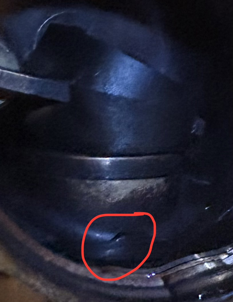

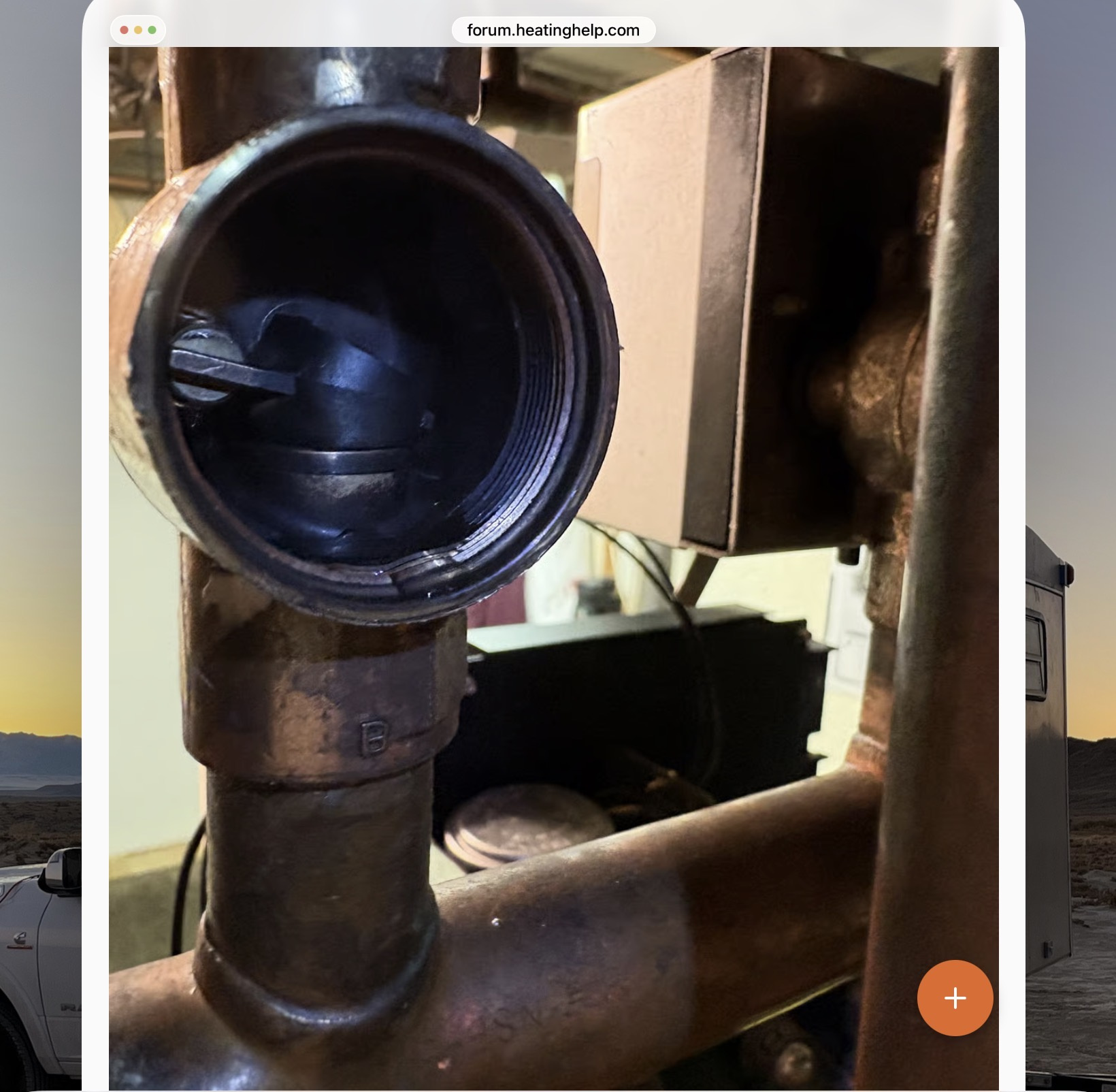

    I didn’t see this until I zoomed in on the photo.
    mattmia2SuperTechAlan (California Radiant) Forbes
    Is that a hole actually through the casting ??? That would kind of make sense.
    If so Good Find !!!
    Maybe been that way since new.
    If that is actually a hole you probably could solder or maybe epoxy it closed or drill, tap, 4-40 screw with Loctite.
  • skyline137
    I’m not sure if it’s a hole because that picture was taken before I put the new paddle in but sure looks like it. It wasn’t noticeable until I zoomed in.

    I replaced the paddle for an easy fix,. thought that was the problem. I didn’t see the hole at that that time. Posted a photo of that before installing it. Trying to figure why It still flowed so I took a closer look
  • skyline137
    zoom in there is a hole in casting
    take a punch and drive a piece of solder into the forging
    That is a rare condition to see a pin hole or forging defect in a zone valve like that. Zone valve bodies of any brand rarely "wear out"
