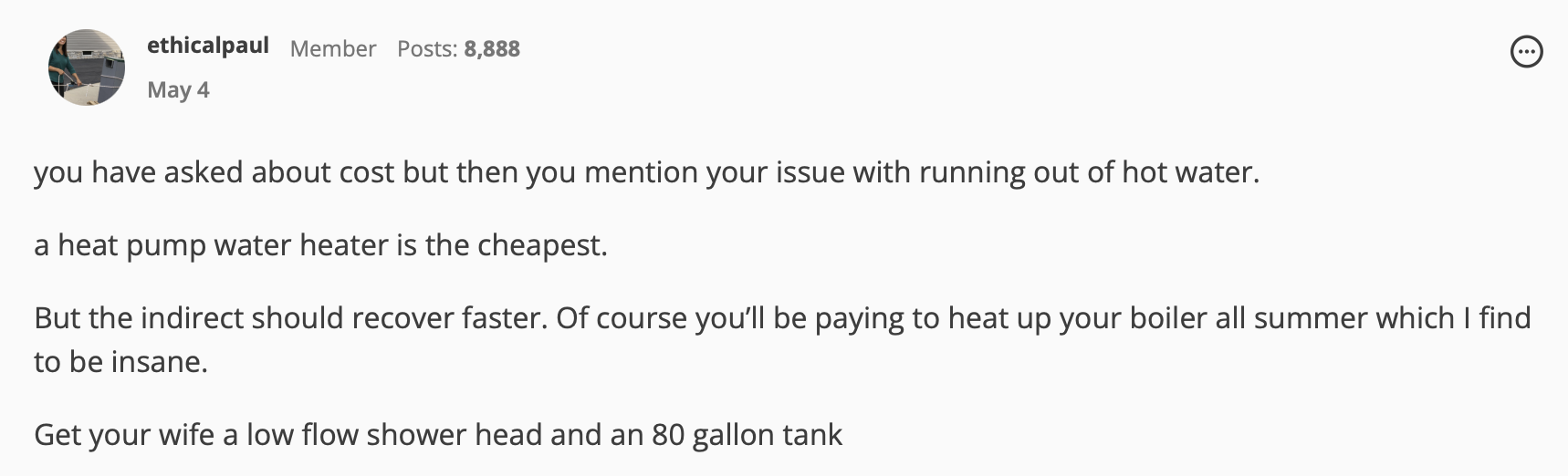

    ethicalpaul Member Posts: 8,958
    you have asked about cost but then you mention your issue with running out of hot water.
    a heat pump water heater is the cheapest.

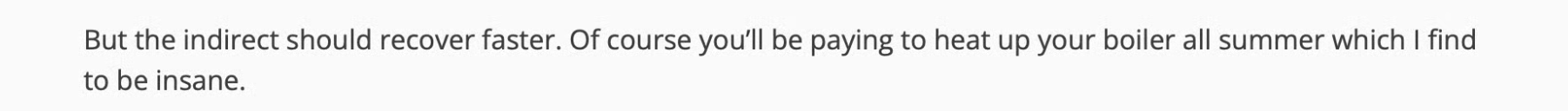

    But the indirect should recover faster. Of course you’ll be paying to heat up your boiler all summer which I find to be insane.
    Get your wife a low flow shower head and an 80 gallon tank

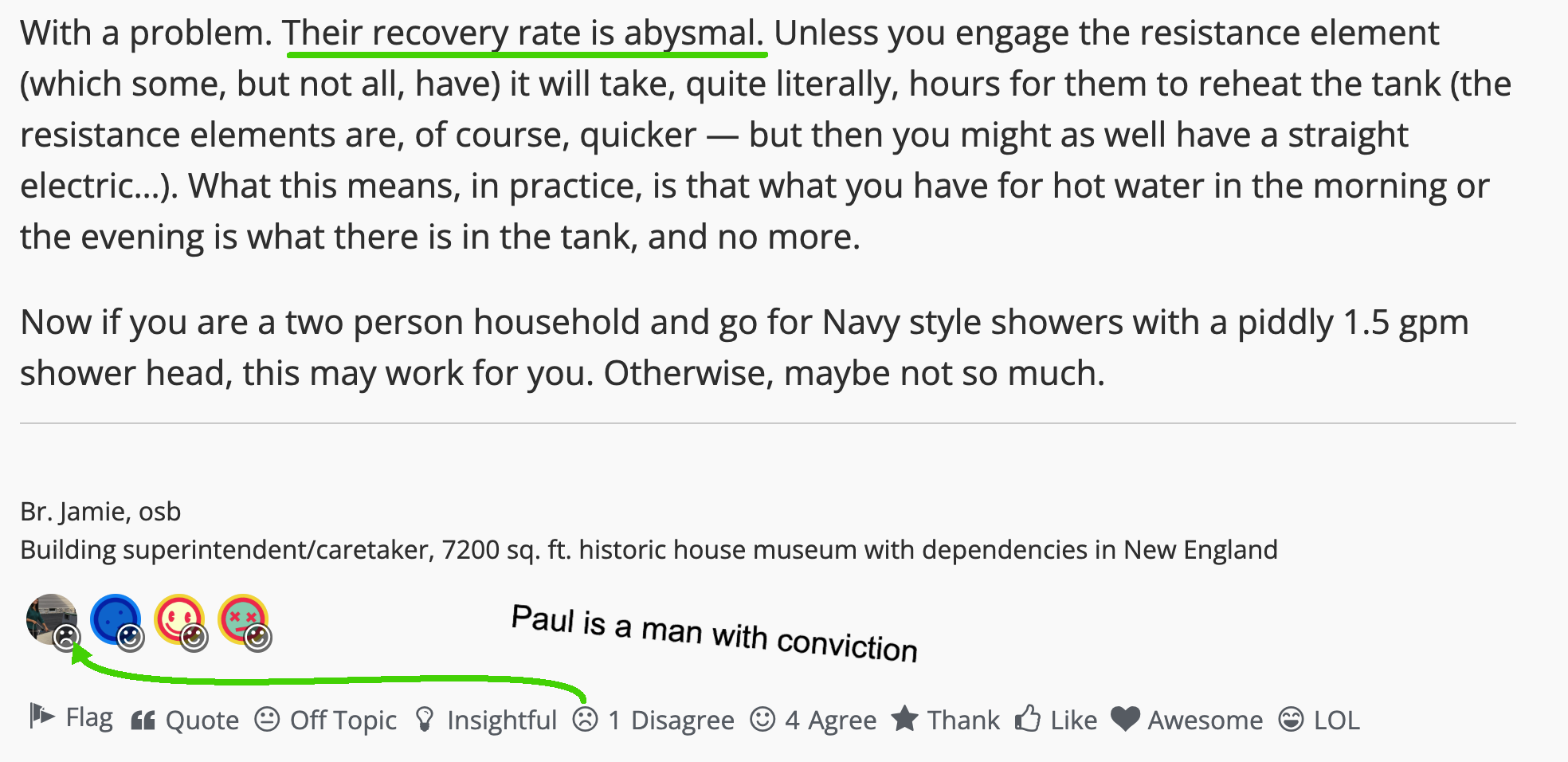

    A comment on heat pump water heaters. Wonderful gadgets. Expensive to buy and maintain, but wonderful on energy.
    With a problem. Their recovery rate is abysmal. Unless you engage the resistance element (which some, but not all, have) it will take, quite literally, hours for them to reheat the tank (the resistance elements are, of course, quicker — but then you might as well have a straight electric…). What this means, in practice, is that what you have for hot water in the morning or the evening is what there is in the tank, and no more.
    Now if you are a two person household and go for Navy style showers with a piddly 1.5 gpm shower head, this may work for you. Otherwise, maybe not so much.

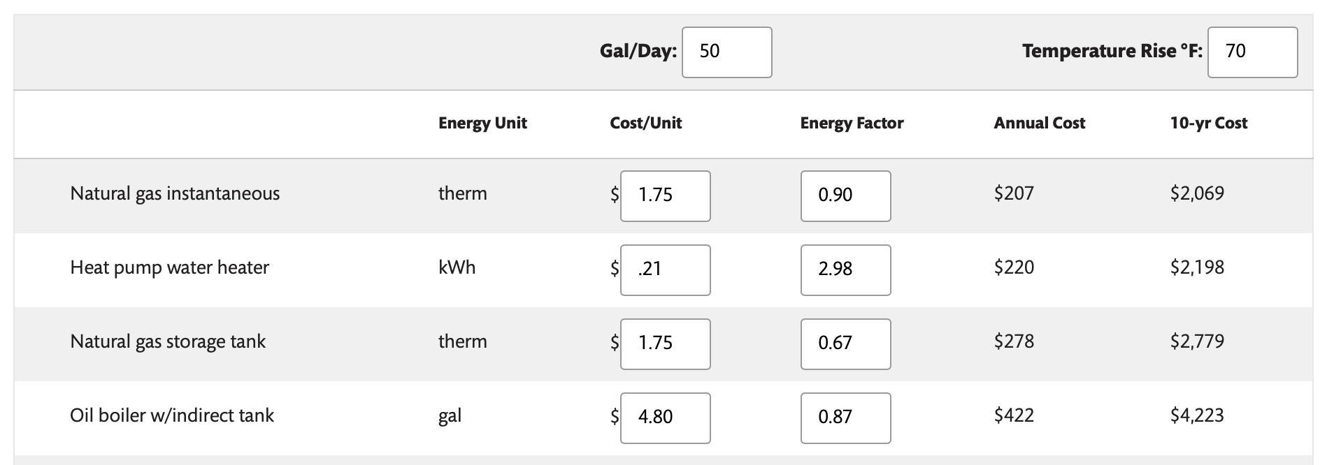

    Here is Maine's nice chart with your numbers, @EdTheHeaterMan
    And just to repeat what I first said, no, I don't think a HPWH is for everyone…I spoke to this in my first reply. But everyone keeps misquoting me. Whatever.

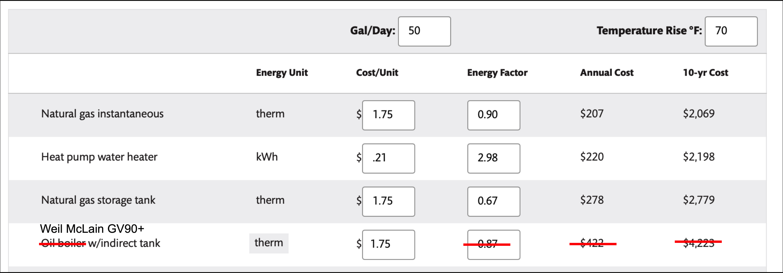

    @ethicalpaul I believe this says what you believe:
    That word “insane” was my clue to your opinion about using a boiler to heat water in the summer. You’ve made your position clear on this topic every chance you get. I don’t think it’s a misquote—you don’t believe a boiler should be used for DHW.
    Your heat pump water heater stays hot all summer long. My boiler does not stay hot all summer long. Those facts aren’t really in dispute. When I use that large boiler—big enough to heat my entire house in New Jersey on the coldest day of the year—it still has to fire up just to make a small amount of hot water for my indirect tank. Even so, it ends up costing a little less or about the same as what you might pay to make that same hot water with your heat pump.
    I guess I’ve had too many bad experiences with heat pumps that didn’t perform well for heating homes in New Jersey. After dealing with customer complaints about no heat in January—and being outside trying to add refrigerant in below-freezing weather—it’s made me less enthusiastic about heat pumps.
    You were the first one to reply to this discussion and you said "HeatPump Water Heater"
    And the OP switched from oil to gas and didn't get the savings they expected. How do you account for that?
    What does your chart say about this option? Fill in the AFUE of the WM GV90+ at 91.0% got the EF number in your chart.
    This represents the question originally asked.

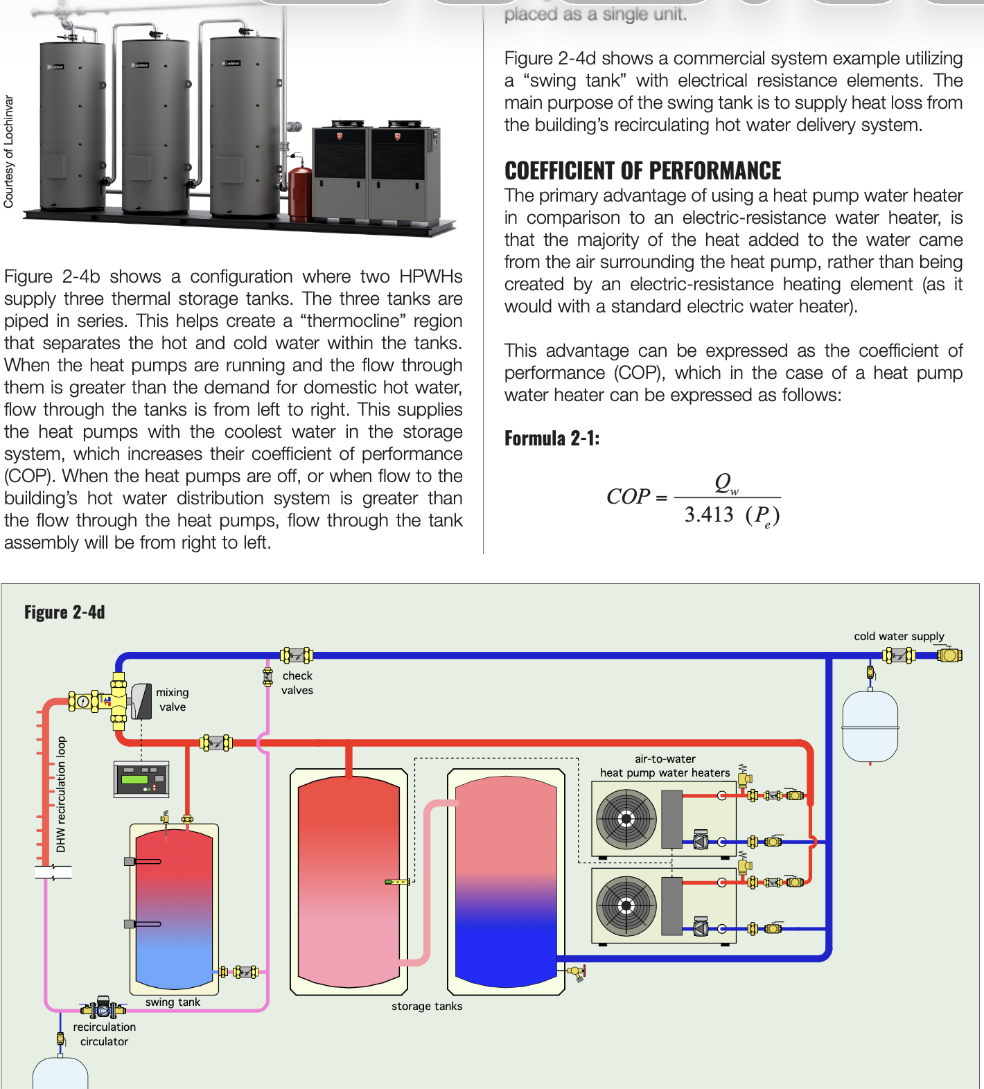

    Here is a good read on HPWH fundamentals.
    https://www.caleffi.com/sites/default/files/media/external-file/Idronics_33_NA_Heat%20Pump%20Water%20Heater%20Fundamentals.pdf
    This slide shows how proper piping is critical when storage tanks are used. Series piping helps maintain the HP efficiencies.
    The swing tank covers the recirculation loop heat requirements, avoiding busting up the thermocline in the storage tanks..

  • AlaskaDick
    AlaskaDick Member Posts: 43
    On the difference between energy cost and total consumer cost - most of the add-on costs are dependent on usage, but some may be a fixed. Looking at my most recent gas bill the $20 fixed fee is bit less than 10% this time of year but will be 20% come mid-summer. Electricity usage is fairly steady through the year so the $18 in fixed costs are fairly consistent at 8%. Not recognizing the fixed costs can skew comparisons.
    For me, electric resistance can't compete with gas costs. I chose an indirect for several reasons over a combi, on-demand, or stand-alone gas-fired. My incoming water is about 38 degrees year-round which made me leery of a combi properly sized for the heating load for a fairly well insulated house. The indirect operating at 140 degrees with a tempering valve gives me all the water I want for even a long shower. With the indirect I only have two flame sources in the house - the clothes dryer and the direct vented boiler which gets its combustion air from outside and exhausts directly without additional flue losses or having to draw cold air into the rest of the house. I also love having the DHW return loop which gives me nearly instant hot water for my shower in the morning. That wouldn't be practical with on-demand.
    As was said above, there is no one-size-fits-all, but for my particular circumstances I am very happy with my choices.
