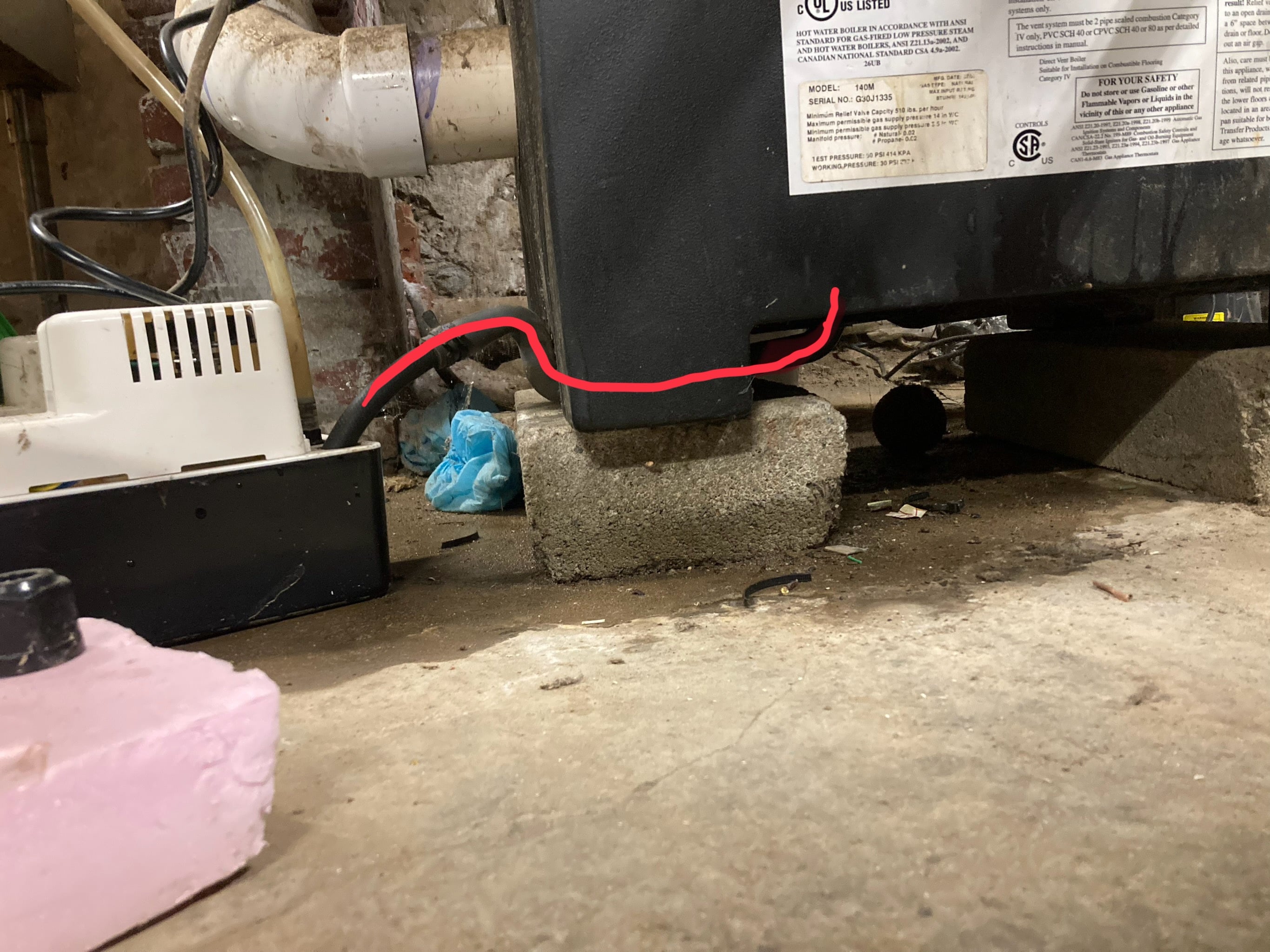

I'm a homeowner with an old Munchkin that I've been nursing along. It recently started dripping off the bottom of the condensate drain tube. As far as I can tell, this is only happening when it's condensing (pressure steady w/ auto-fill valve closed, puddle bigger in the morning).
I opened it up to take a look and didn't want to disturb all the fiberglass without knowing what was going on. So I called my plumber… who also didn't want to disturb the fiberglass and just gave me a quote to replace.
So my first question here is about the drip: Any advice on tracking it down? Or is it, indeed, time to finally replace?

And please don't forget my first question: Can I track down this condensate leak? If so, how? (or should I just replace?)

If the boiler is leaking from underneath check that the trap. It is either plugged or cracked. it's just a molded rubber trap. no need to change your boiler of a stupid trap. its not easy to get too but if thats it you'll save a little money

I tried getting a view of the internal side of the drain line with my endoscope; it looked a little bit rusty, but the view was not good. If I'm understanding this correctly, I'll need to disconnect the exhaust and tear out the insulation to get to the internal trap (which seems like a fair amount of work for annual servicing… am I misunderstanding something? Where is the trap and vent that the installation manual says to routinely check? I didn't want to learn this, which is why I called my plumber… but here I am anyway). I don't want to take apart the exhaust on a Sunday on the off-chance that some parts have deteriorated and I won't be able to get replacement parts today.
@hot_rod 3 floor Victorian twin (1895) with roof insulation and a mix of modern and original+storm windows. 2800sq ft. My retired plumber friend said that the 60k sounds very low, so maybe I did the math wrong. Design temp 14 degrees.
Edit: Ok, so this drain line seems to have its own trap? Should I just cut off the riser?

And yes the red line is the trap location. it's a preformed rubber trap

The drain spud on the bottom of the boiler sometimes leak. Is the boiler level?

If the leak is under the cabinet, then there is a failure of the silicone tubing or I guess the red tubing from the heat exchanger to the disposal drain. I have replace several of these drain hoses. Not a simple (easy) job if the unit is sitting close to the ground or support stand. The hose can be purchased at Jupiter Heating ( Part #7250P-7724). It is an after market adaptation as the original rubber hose is out of stock. You could make one.

@HomerJSmith sounds like a job I’m qualified for… but under my boiler doesn’t look like I’d expect it to given your explanation. Here’s a shot from under the cabinet looking into the join of the drain to the hose. No clamp (maybe there’s one partially visible just inside the cabinet?)
. I think I might’ve seen a clamp when i tried to shove my endoscope in between the heat exchanger and the insulation… hard to say. Let me know if this is installed incorrectly, because it will add to my tally of “every time you look at it, you see something else wrong with the installation.”

If I had to do it, if I couldn't shift the HX, I would use a multi-purpose tool with the blade at 90 deg and cut the case around the tube, about 3" square to access the clamp.
Oh, @HomerJSmith , you're a genius. I think I'll give that a try. As promised, the closer you look at it, the more you find wrong with this install.
