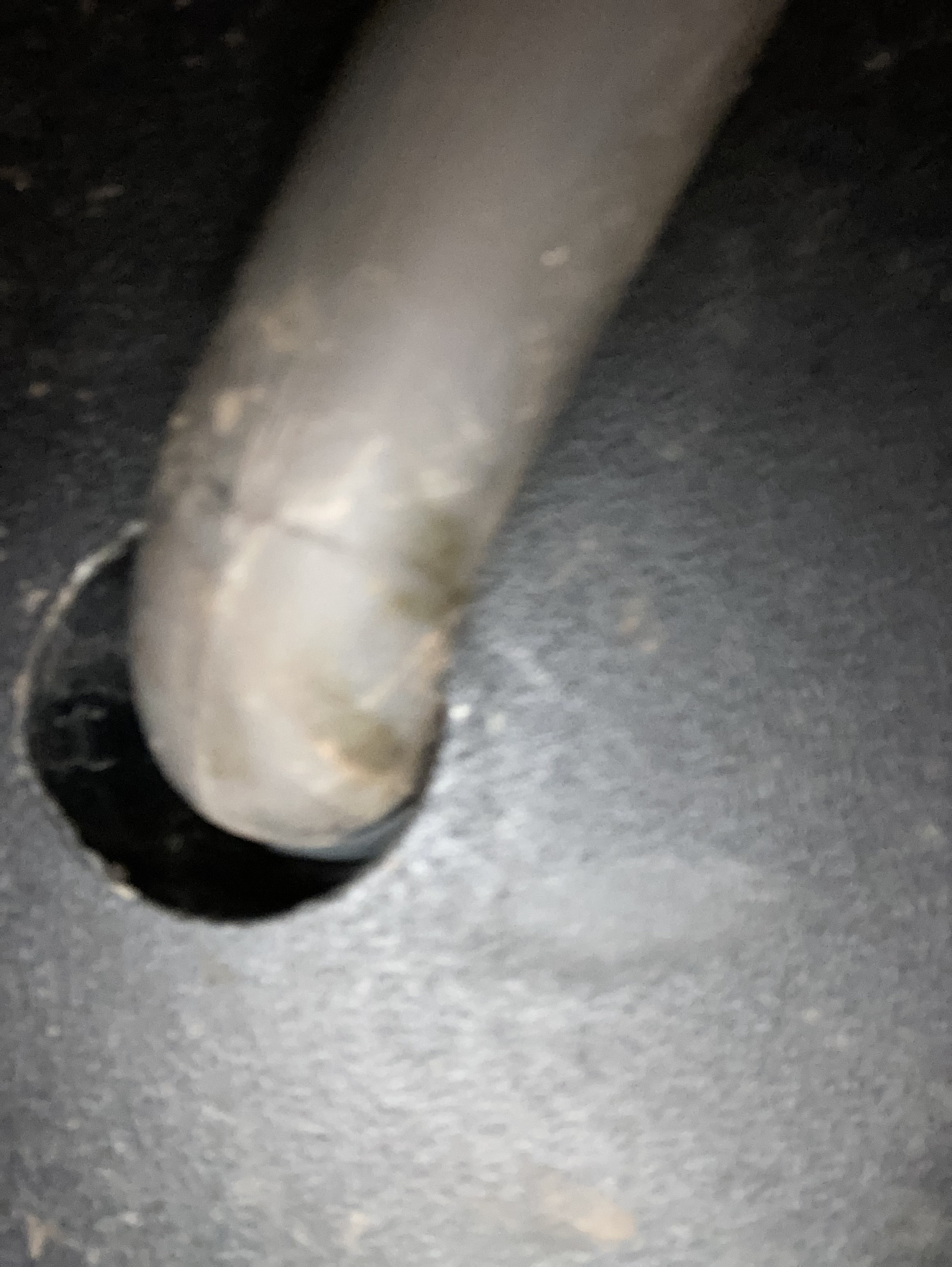

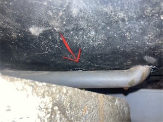

    I tried getting a view of the internal side of the drain line with my endoscope; it looked a little bit rusty, but the view was not good. If I'm understanding this correctly, I'll need to disconnect the exhaust and tear out the insulation to get to the internal trap (which seems like a fair amount of work for annual servicing… am I misunderstanding something? Where is the trap and vent that the installation manual says to routinely check? I didn't want to learn this, which is why I called my plumber… but here I am anyway). I don't want to take apart the exhaust on a Sunday on the off-chance that some parts have deteriorated and I won't be able to get replacement parts today.
    @hot_rod 3 floor Victorian twin (1895) with roof insulation and a mix of modern and original+storm windows. 2800sq ft. My retired plumber friend said that the 60k sounds very low, so maybe I did the math wrong. Design temp 14 degrees.
    Edit: Ok, so this drain line seems to have its own trap? Should I just cut off the riser?

    And yes the red line is the trap location. it's a preformed rubber trap

    If the leak is under the cabinet, then there is a failure of the silicone tubing or I guess the red tubing from the heat exchanger to the disposal drain. I have replace several of these drain hoses. Not a simple (easy) job if the unit is sitting close to the ground or support stand. The hose can be purchased at Jupiter Heating ( Part #7250P-7724). It is an after market adaptation as the original rubber hose is out of stock. You could make one.

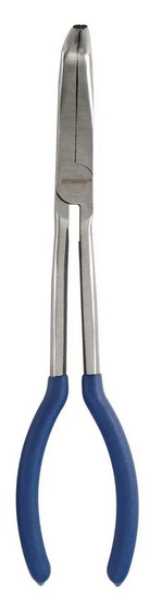

    SENorthEast1895er, thanks for the pic. I have never seen that. The stainless nipple has always protruded below the case. Perhaps, the boiler was installed in an incorrect position. Removing that silicone tube is problematic as the clamp is out of reach. I wouldn't be looking forward to replacing that.
    If I had to do it, if I couldn't shift the HX, I would use a multi-purpose tool with the blade at 90 deg and cut the case around the tube, about 3" square to access the clamp.

    Oh, @HomerJSmith , you're a genius. I think I'll give that a try. As promised, the closer you look at it, the more you find wrong with this install.

    SENorthEast1895er, I have two muli purpose tools that I bought at Harbor Freight. A great price. I would also use 90 deg Offset Long Reach Pliers to grab the clamp.
