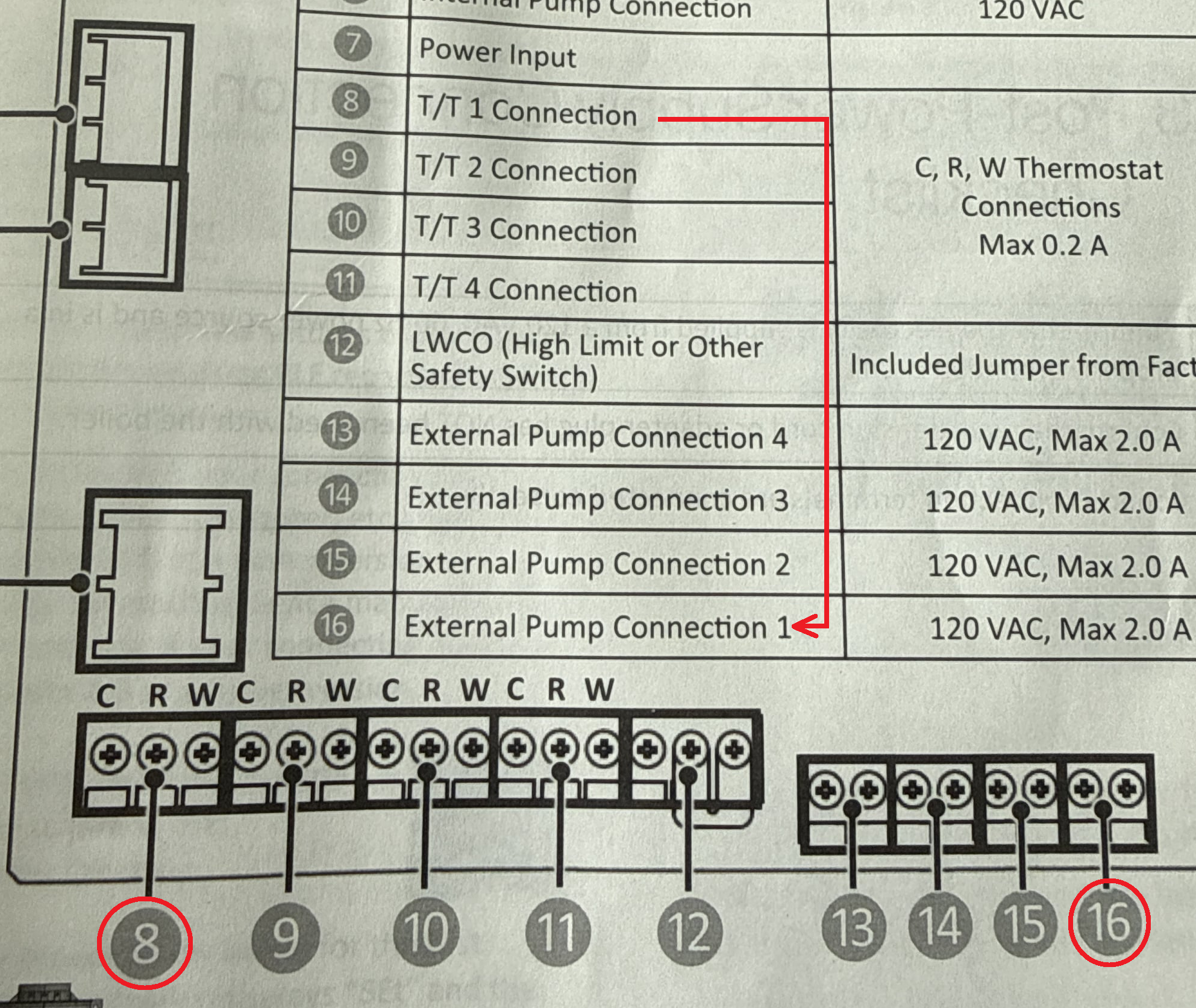

Connection from Taco SR501 to RINNAI I-Series combi boiler
I understand the I-series boiler has a switch relay internally for single zone. I have already set up a switch relay and grundfos pump powered separately from my boiler. I have a tekmar smart thermostat already connected to the switch relay. I need to know how to connect my switch relay to the combi boiler. I am thinking the T/T 1 Connection at the boiler to the C and N/O connection at relay but the t/t conn has the three connections C, R and W. Is there a different place in this panel I should connect for call for heat when pump kicks on?

    Use R and W on the boiler. C is provided for a common return from powered thermostats.

    ok. So c and w on boiler to the n/o and c on relay?

    R and W will run the boiler. R and W. = Will Run
    In this illustration I have fadded out the unimportant parts of your photo and highlighted the important parts of the diagram. Take 5 (COM) from the Taco SR501 and connect it on R for zone 1 of the Rinnai I-Series. Take 6 NO from the Taco SR501 and connect it to W on the Rannai I-Series as shown above.

    The common and the N/O on the relay really don't matter which go to the R or W on the control board. The ''C" on the control board is not used.
    109A_5 Member Posts: 4,113
    It just acts like a switch, closed calls for heat, open no call for heat.

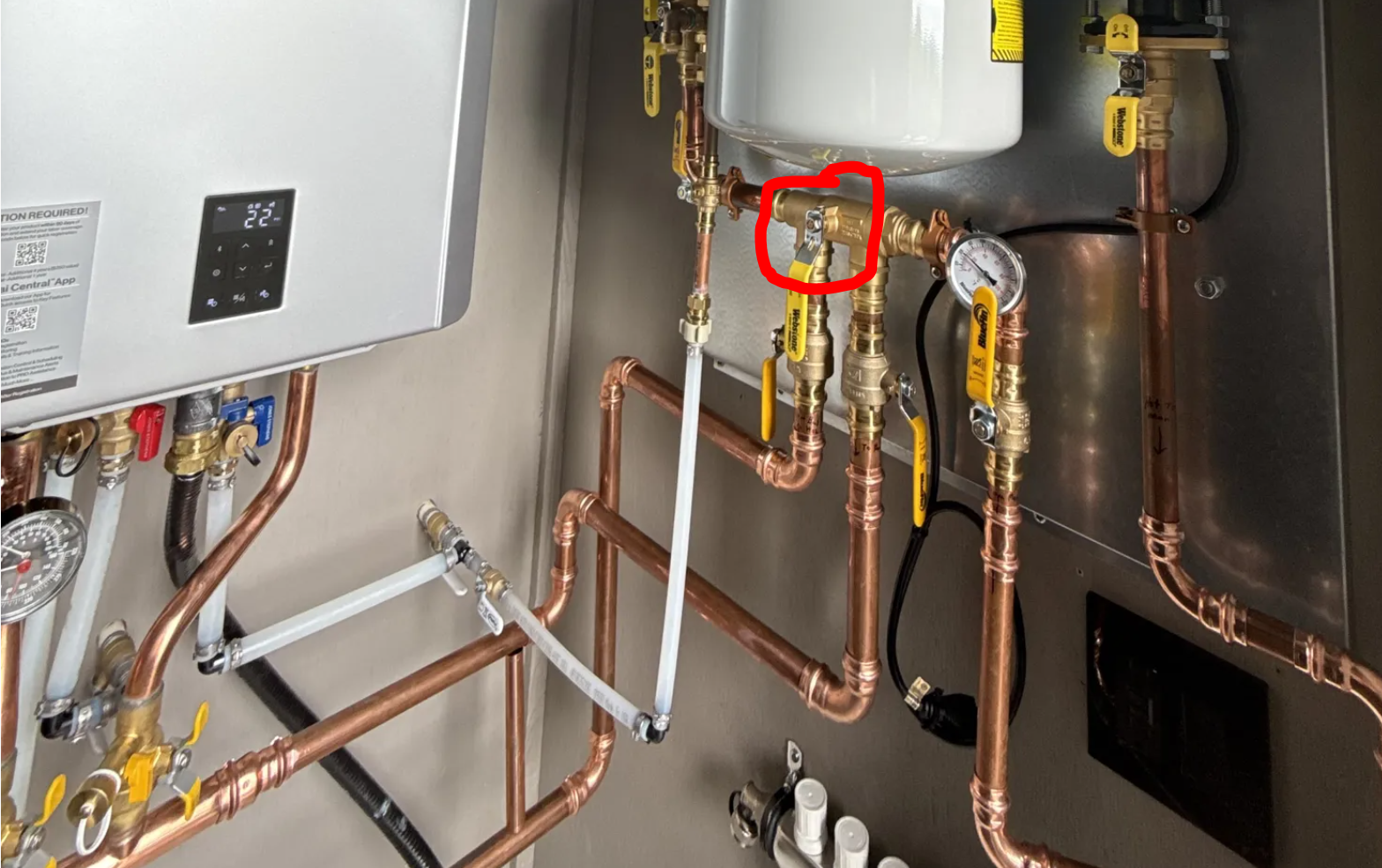

    Since you are using the P/S kit, the purge valve is also not really needed here, make sure you keep this valve always closed.
    To purge the primary loop, connect a garden hose to the P/S kit drain valves.
    hot_rod Member Posts: 27,561
    let’s see more of your piping, how you are using two sets of close tees.
    There may need to be a boiler pump, loop pump, then zone pumps?
