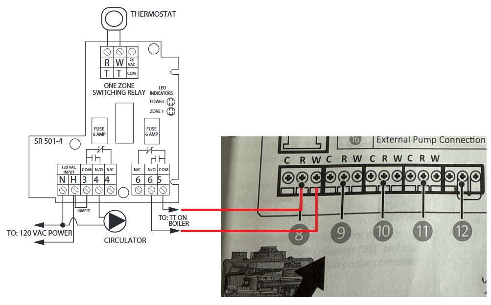

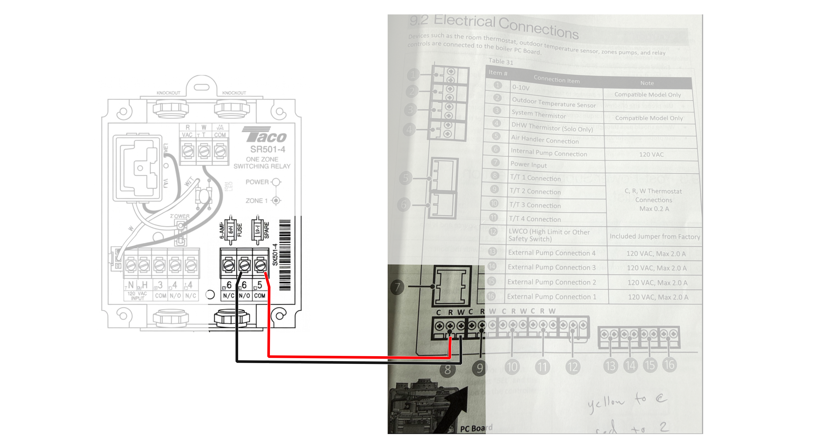

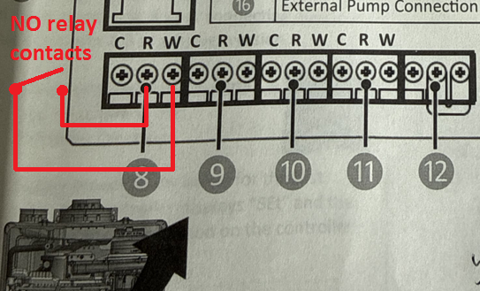

I understand the I-series boiler has a switch relay internally for single zone. I have already set up a switch relay and grundfos pump powered separately from my boiler. I have a tekmar smart thermostat already connected to the switch relay. I need to know how to connect my switch relay to the combi boiler. I am thinking the T/T 1 Connection at the boiler to the C and N/O connection at relay but the t/t conn has the three connections C, R and W. Is there a different place in this panel I should connect for call for heat when pump kicks on?

    Use R and W on the boiler. C is provided for a common return from powered thermostats.
  • ok. So c and w on boiler to the n/o and c on relay?

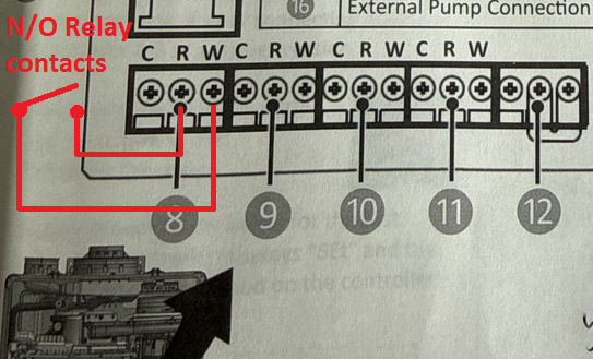

    R and W will run the boiler. R and W. = Will Run
    In this illustration I have fadded out the unimportant parts of your photo and highlighted the important parts of the diagram. Take 5 (COM) from the Taco SR501 and connect it on R for zone 1 of the Rinnai I-Series. Take 6 NO from the Taco SR501 and connect it to W on the Rannai I-Series as shown above.

    The common and the N/O on the relay really don't matter which go to the R or W on the control board. The ''C" on the control board is not used.
    109A_5 Posts: 4,790
    It just acts like a switch, closed calls for heat, open no call for heat.

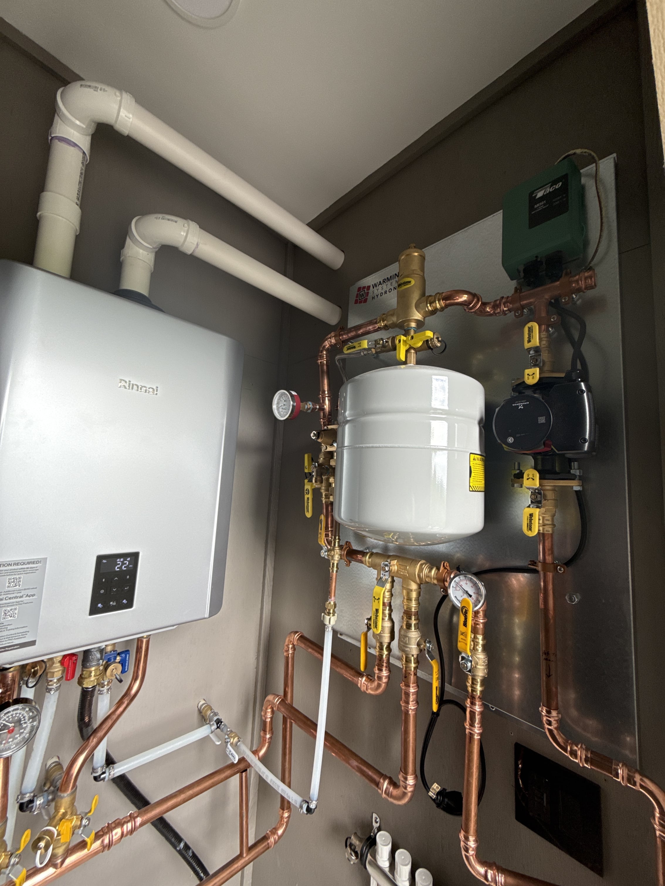

    PeteA
    hot_rod Posts: 28,789
    let’s see more of your piping, how you are using two sets of close tees.
    There may need to be a boiler pump, loop pump, then zone pumps?
  • tcassano87
    tcassano87 Posts: 164
    being able to connect 4 zones directly To the boiler is such a great design
  • PeteA
    PeteA Posts: 328
    Wow these photos can be used as a Webstone and Bluefin advertisement there has to be at least 20 valve handles in just these 2 photos, I see Yellows, Red, White and Blue. This will be one person who will not have any issues isolating any part of this system.
    EdTheHeaterMan Posts: 13,030
    I think there is a rule about how many valve handles you are allowed in a 5 square foot area. You have certainly gone over the allotted amount here. You may get a call form the valve division of the mattress police if they ever get a look at this photo.
    PeteA
    It is a nice looking job!
