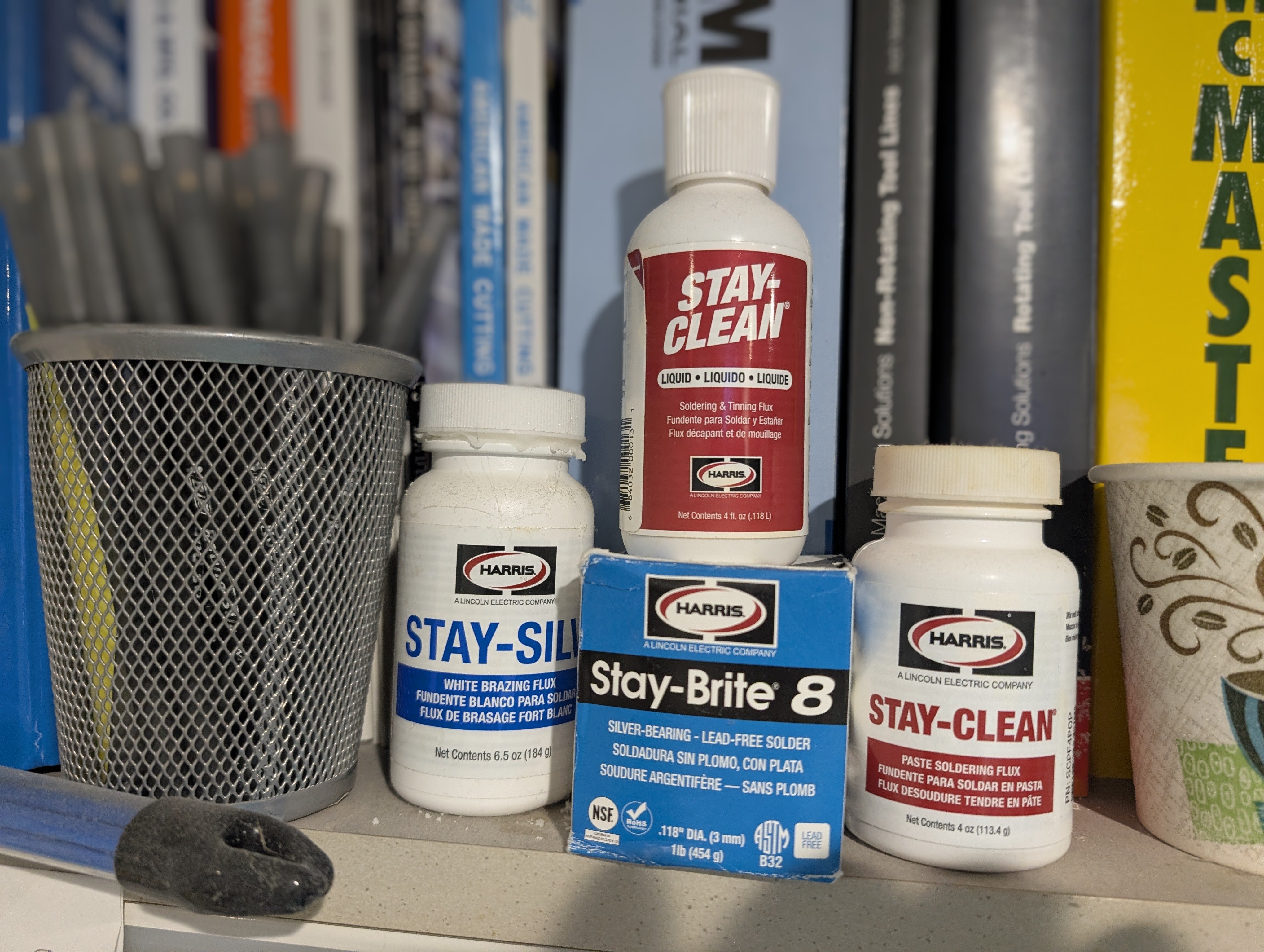

I forgot to check my dad's old plumbing box before soldering up the heating/plumbing pipes for my combi boiler. Turns out there's almost a full spool of Taramet Sterling in there.
Did they change the formula for the 2011 low-lead requirements, or is this still good for potable water pipes? I'm running out of my new Harris Sterling.

If it says lead-free on it, you are covered. If it doesn't, do not use it on potable water.

I still do that with Stay Brite #8
Should someone have a rant about how only hacks use Straybrite?
I have a spool of it above my desk, the only reason I didn't use it so far was laziness. I didn't feel like cleaning all of the fittings and dealing with flux.

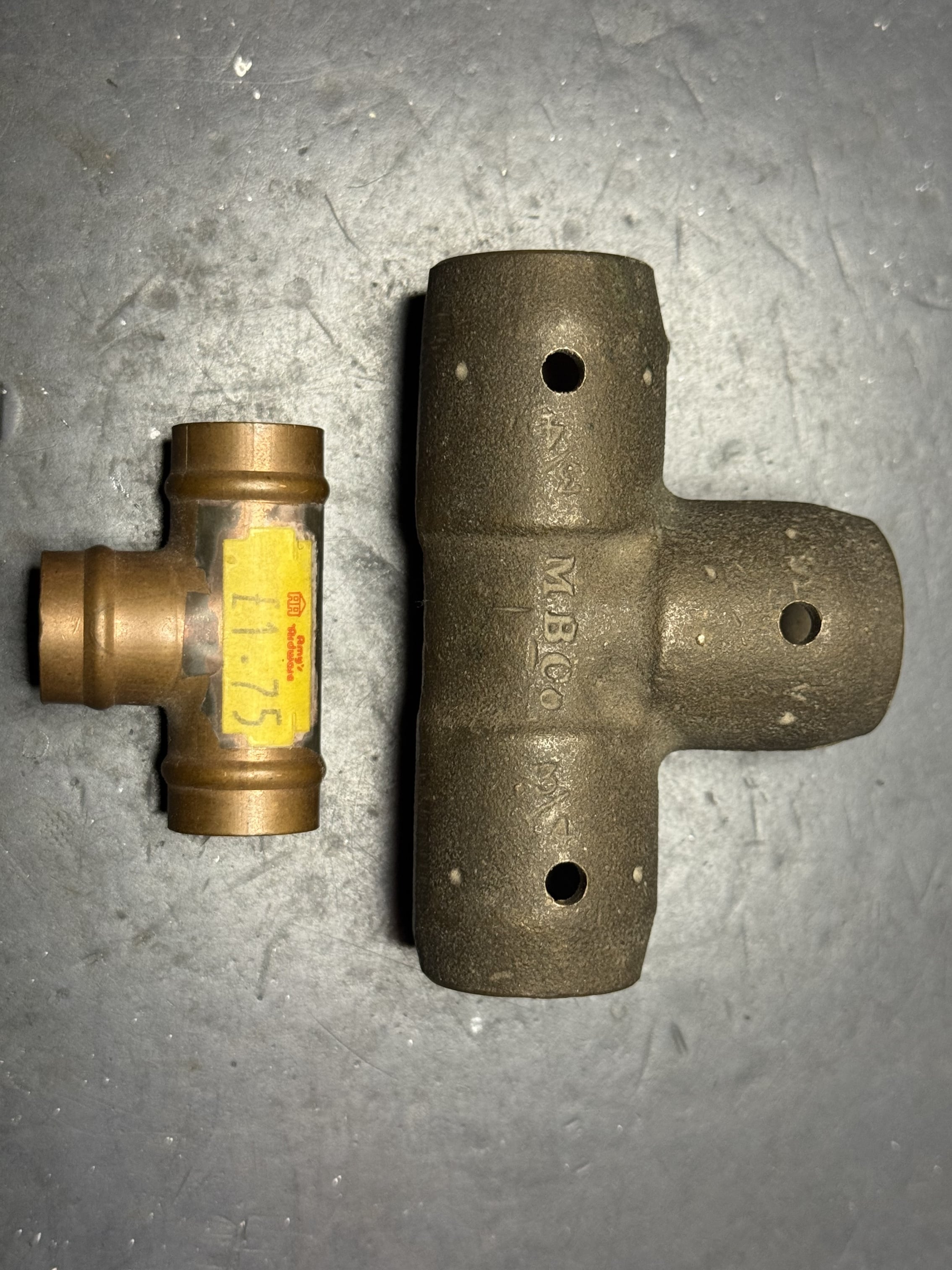

I remember those pre-solder copper fittings , they came with ring of solder inside .. I still ran a roll and "wiped " each connection :)
I've seen similar fittings for soft solder as was an an incorporated brazing ring in the cup. Mad Dog
I saw those at home depot a long time ago. I assumed it was to help homeowners solder.
or to heat the fitting evenly so the flux didn't burn out of part of it before other parts got hot enough to melt the solder
