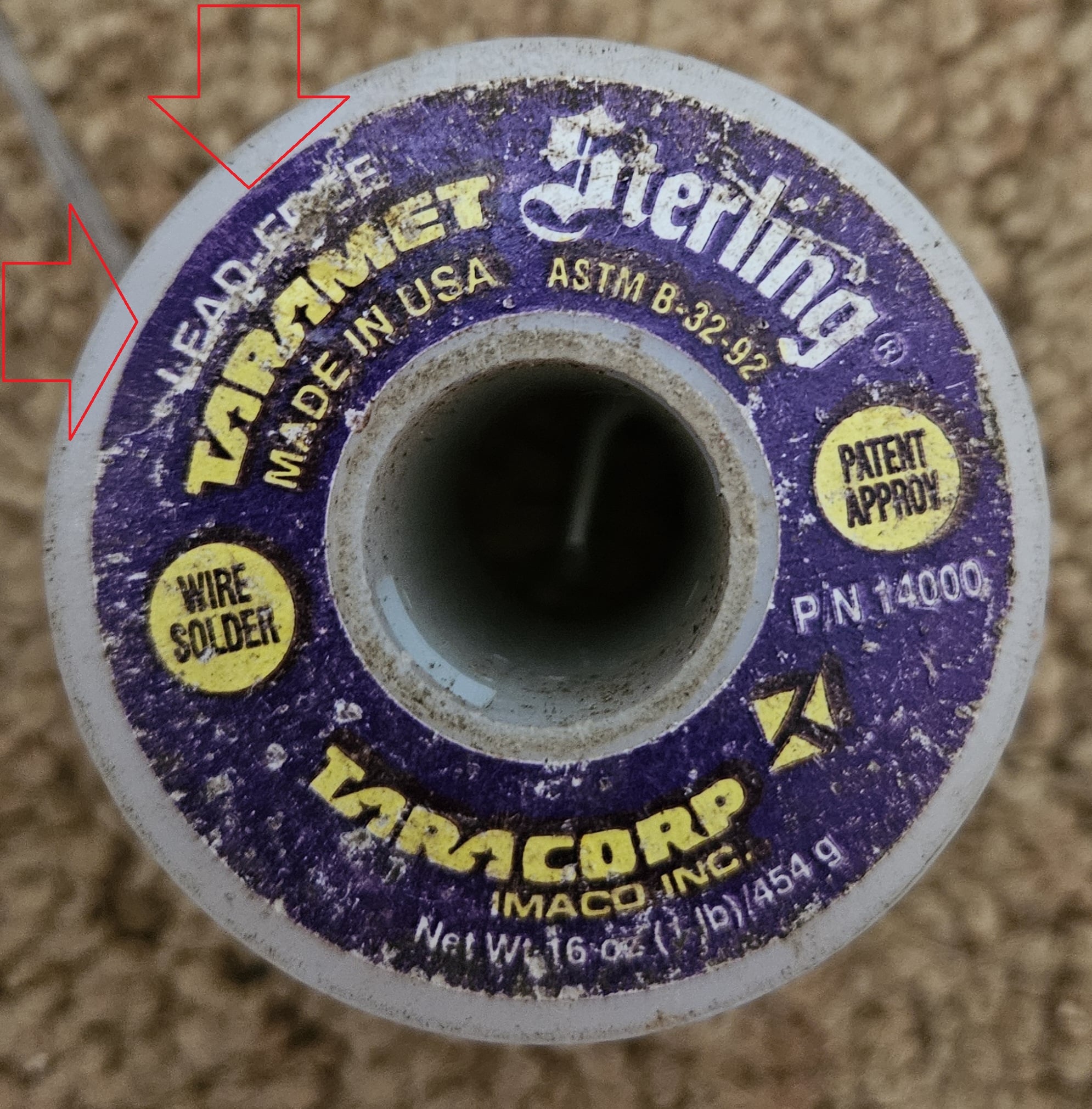

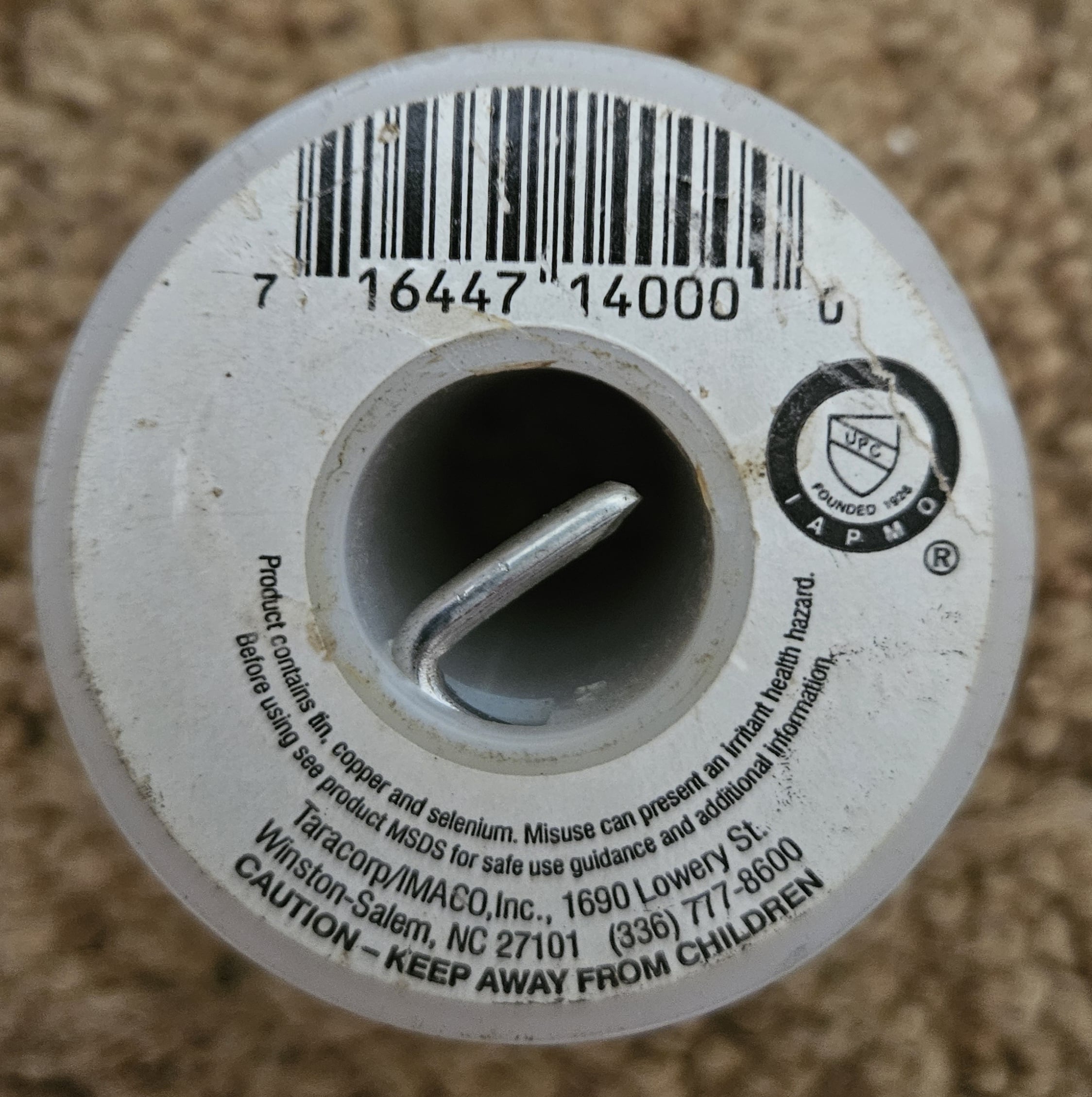

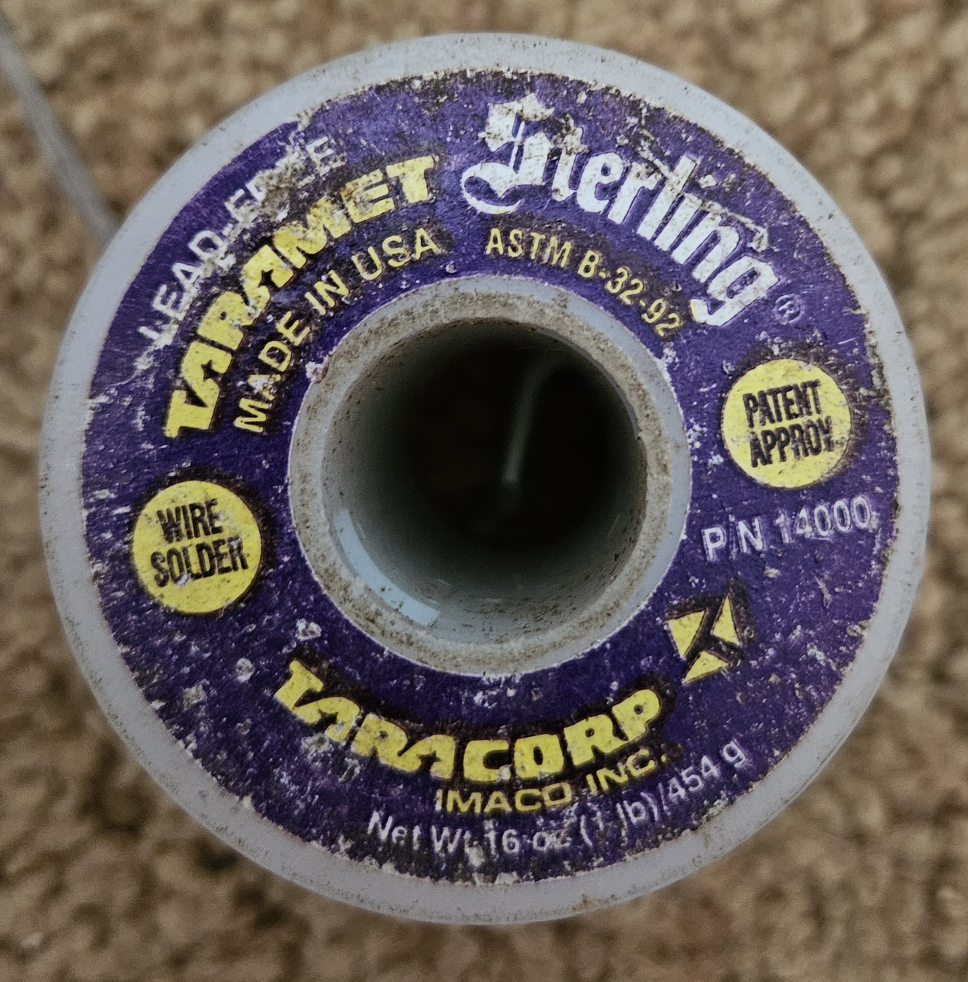

I forgot to check my dad's old plumbing box before soldering up the heating/plumbing pipes for my combi boiler. Turns out there's almost a full spool of Taramet Sterling in there.
Did they change the formula for the 2011 low-lead requirements, or is this still good for potable water pipes? I'm running out of my new Harris Sterling.

i assume they changed the formula in like 1986…
You're good to go unless you live in California....they MAY have changed there thresholds. By the way, Taramet Sterling has been my favorite solder for many years. Mad Dog
2 -
Thanks. It looks like it was set to 0.2% in 1986 and remained unchanged in 2011, with the 2011 rules mostly impacting fittings <0.25%.

If it says lead-free on it, you are covered. If it doesn't, do not use it on potable water.
