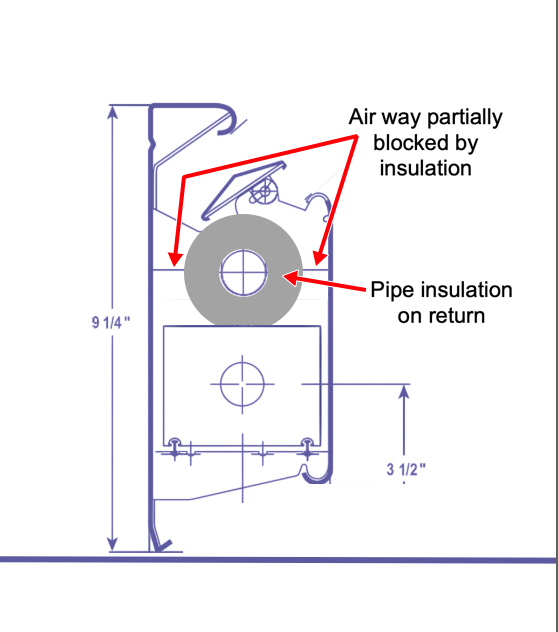

I have hydronic baseboard on a house that has a slab floor. The return lines are inside the metal covers. I insulated the returns with foam pipe insulation thinking it would prevent condensation in my old steel boiler. Was this a bad idea?

    EdTheHeaterMan Member Posts: 12,323
    Probably.
    This is what I am picturing in my minds eye:

    either way it blocks air flow!

    Jamie Hall Member Posts: 27,421
    Assuming that the diagram is for real, I can't think of a better way to kill the heat output of those baseboards. I wouldn't care to estimate the output loss, but I'd guess at least 75% loss.
    Yes indeed. A very bad idea…
