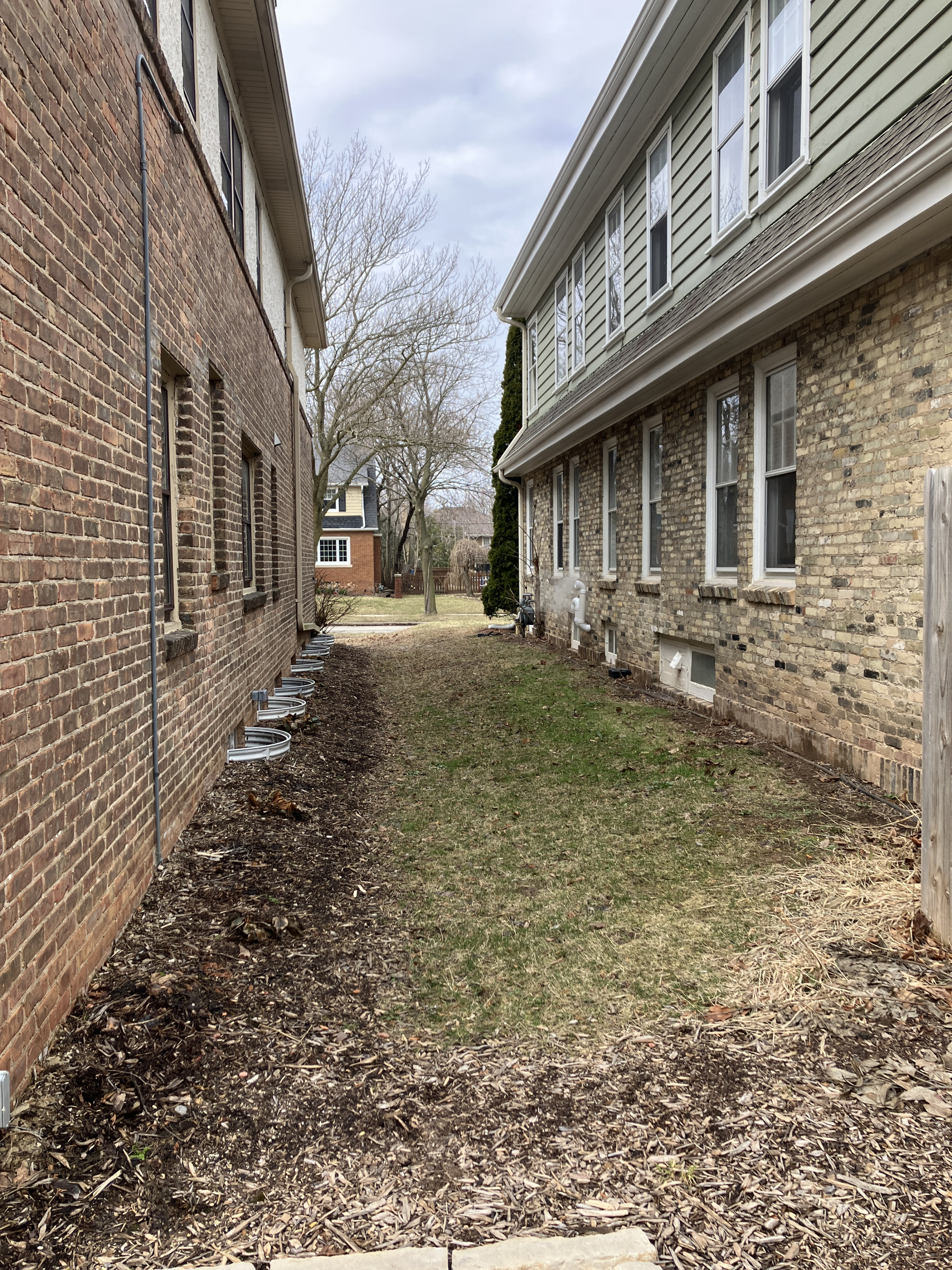

    Probably a naive question, but how do you get the vent high on a sidewall? In my case, you would have to have a pipe runing through living space somewhere.
    Where I would like to vent is in the sort of "back" space between my house and the neighbor. It is only ~10' separation, and isn't used at all by either of us. That is where HIS mod-con vents, for example, and I have never noticed it.

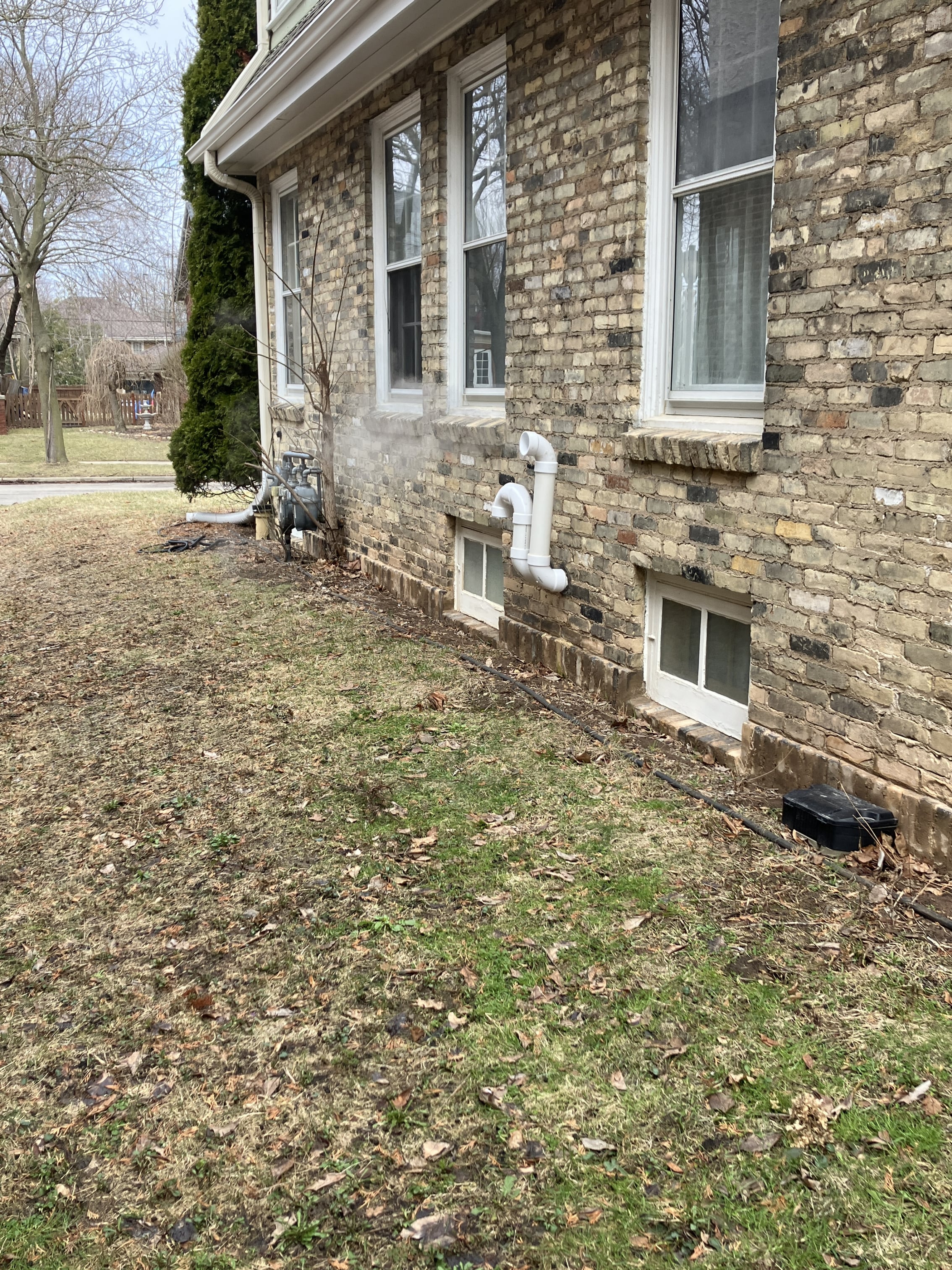

    Where will you pull the intake air from? You do not want to recycle either the neighbor or your own exhaust gas. Does the neighbors exhaust and intake on the side wall?

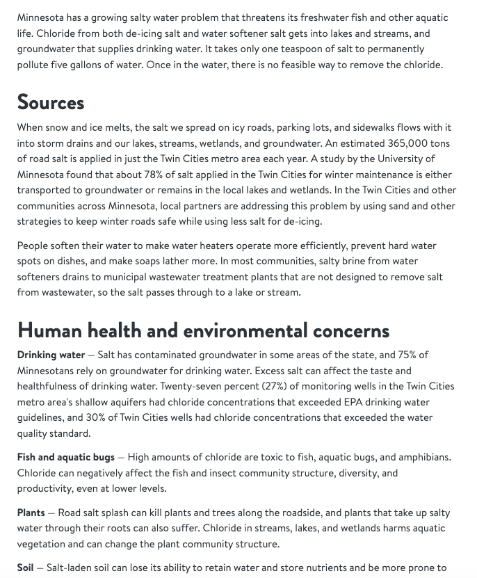

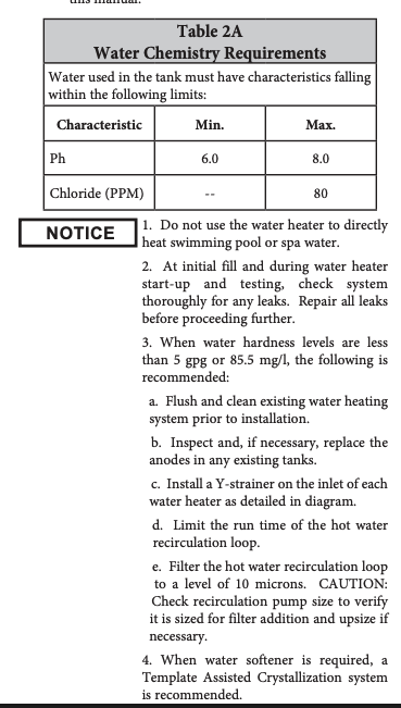

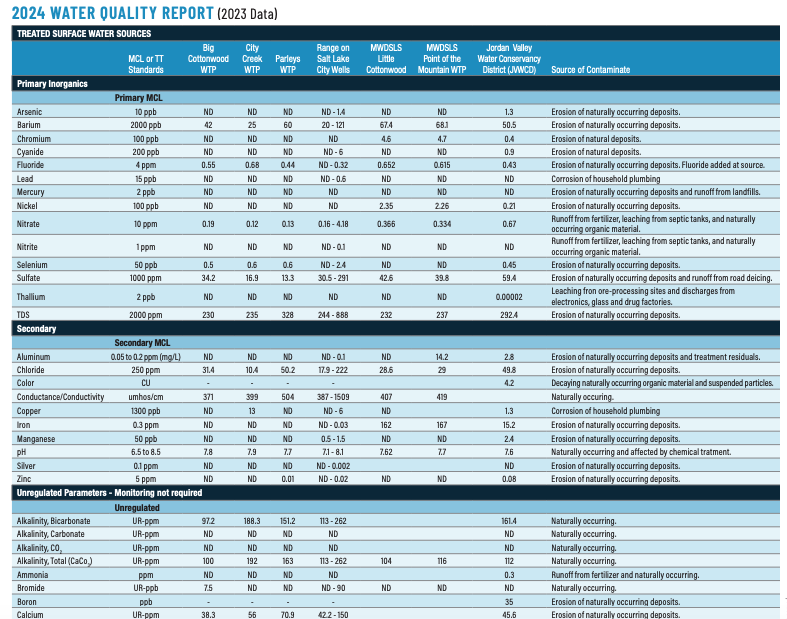

    Test you water for chlorides if you do go with a stainless tank or tankless. if you are on a public supply they should have a report like this available.
    Here is a water quality spec for a stainless indirect. Over-softened water can drive chloride levels up. Chloride levels tend to be high in snow belt areas where the road deicers enter the aquifers.

    Here is a view of the space between our houses (which are about 15' apart). And here is a shot of his intake/exhaust. My proposed intake/exhaust would be located between the two closest window wells, which would be about 18' as the crow flies from the neighbor's. Does that seem acceptable?

    Thanks for this. Our water source is Lake Michigan, and our chlorides are about 15 ppm. Hardness is 8 grains per gallon.

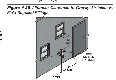

    As long as it meets the manufacturers venting dimensions.
    In some cases wind can drive the exhaust condensate against the walls and windows.
