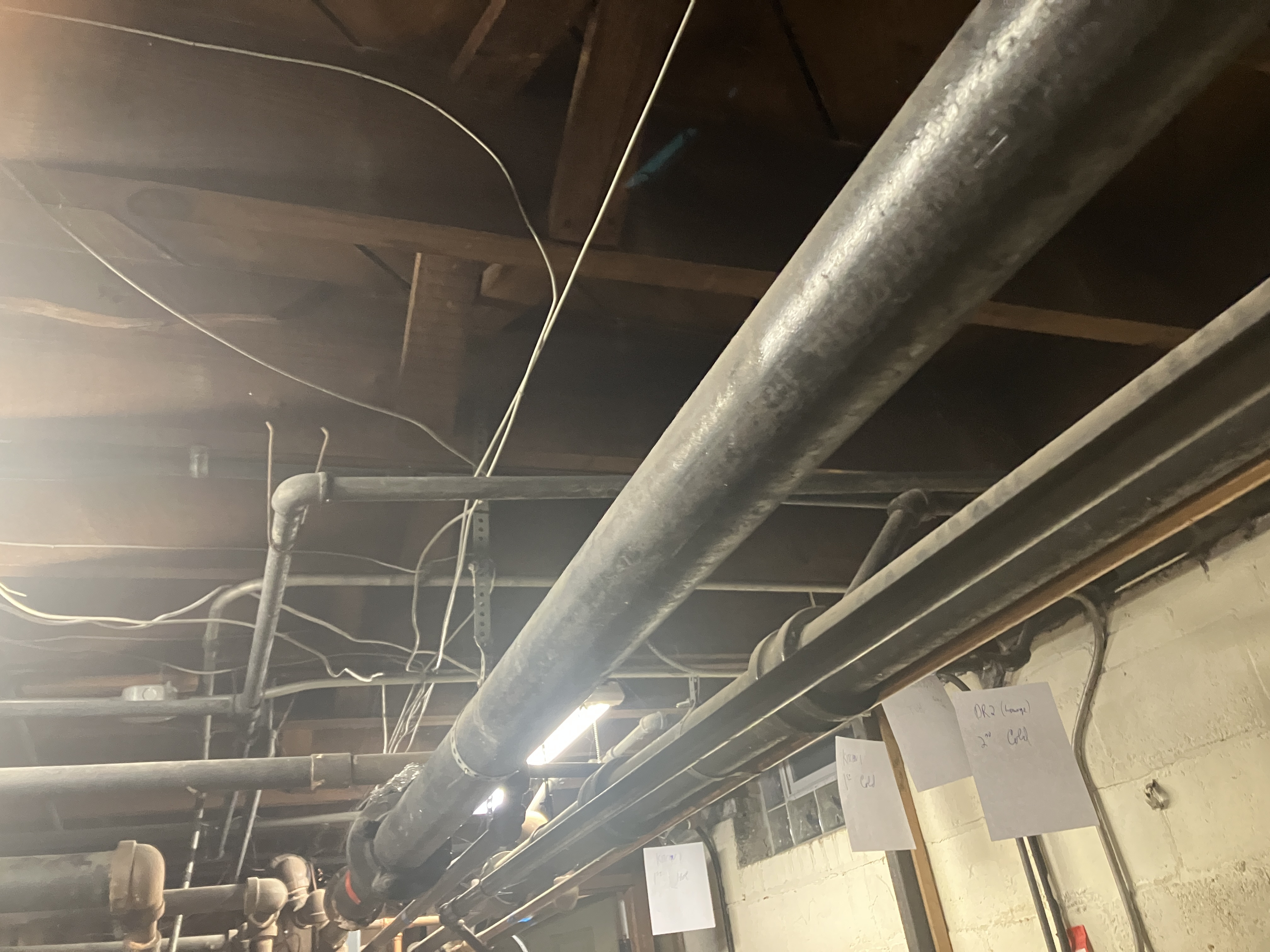

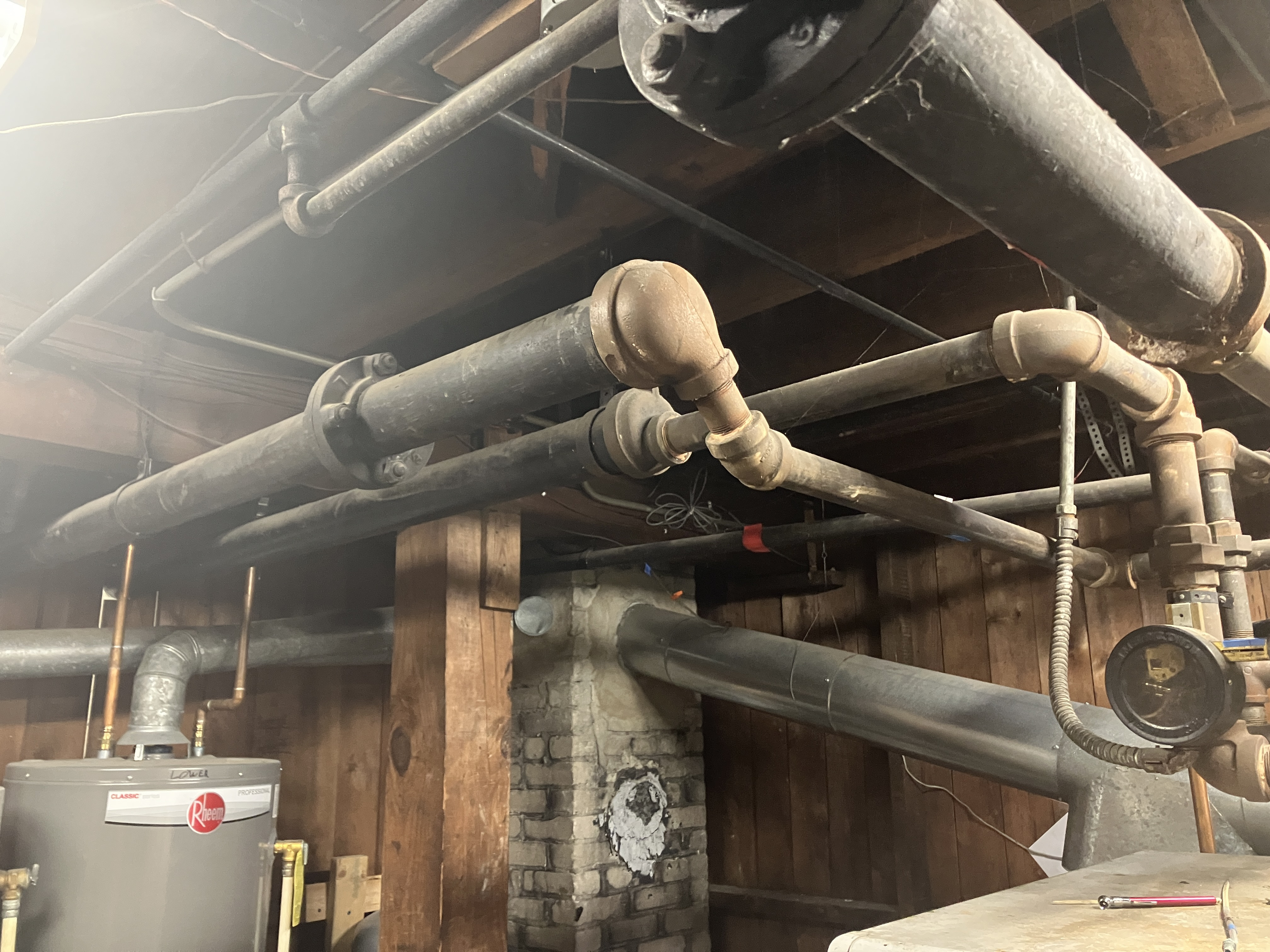

My main question is if it is feasible to “hack off” the supplies/returns to the 1st floor radiators from the giant gravity distribution pipes, cap those off, and build a new distribution system for the 1st floor, while keeping the original 3” gravity pipes for the 2nd/3rd floors?  I would hate to think of the labor and trouble it would take to remove those monsters running around the basement.  I am hoping they can be repurposed without issue for the mod-con, while feeding only the 2nd/3rd floors.

Luckily for me, somewhere along the line, someone also added 1-1/4” steel pipes all the way across the house to feed just 2 radiators on the 1st floor.  I plan to use those as the backbone of the distribution system for the rest of the 1st floor.  I assume that the installation pro would probably use 1” PEX from the terminus of that 1-1/4” pipe to feed the rest of the radiators on the 1st floor?

The related question is about how the water volume plays into this.  I currently have ~200 gallons in the piping and radiators.  Much of this will wind up in the 2nd/3rd floor zone.  I THINK that the large water volume will have some good effects with a mod-con, by providing a high-mass buffer.  Is that correct?

    @Bernie _the_Brewer everything you have outlined sounds like it will work. As @jesmed1 mentioned, one of my earliest “new Install” jobs in the late 1970s was to convert a 4 unit building with one massive coal converted to oil boiler so that each apartment owner would pay for their own heat and hot water. I did this with 4 water heaters and three gas boilers. One of the second floor units (the right side) was to use the original gravity hot water piping and boiler (still oil fired) and all the second floor gravity piping was left connected to the second floor radiators. The second floor with the new gas boiler needed only the near boiler piping to be connected to the gravity mains that were isolated from the first floor on the left side of the building, just as you described in your original post. Only the first floor zones needed new 1" copper main piping to connect all the first floor radiators from the old system, much like you plan in your post.

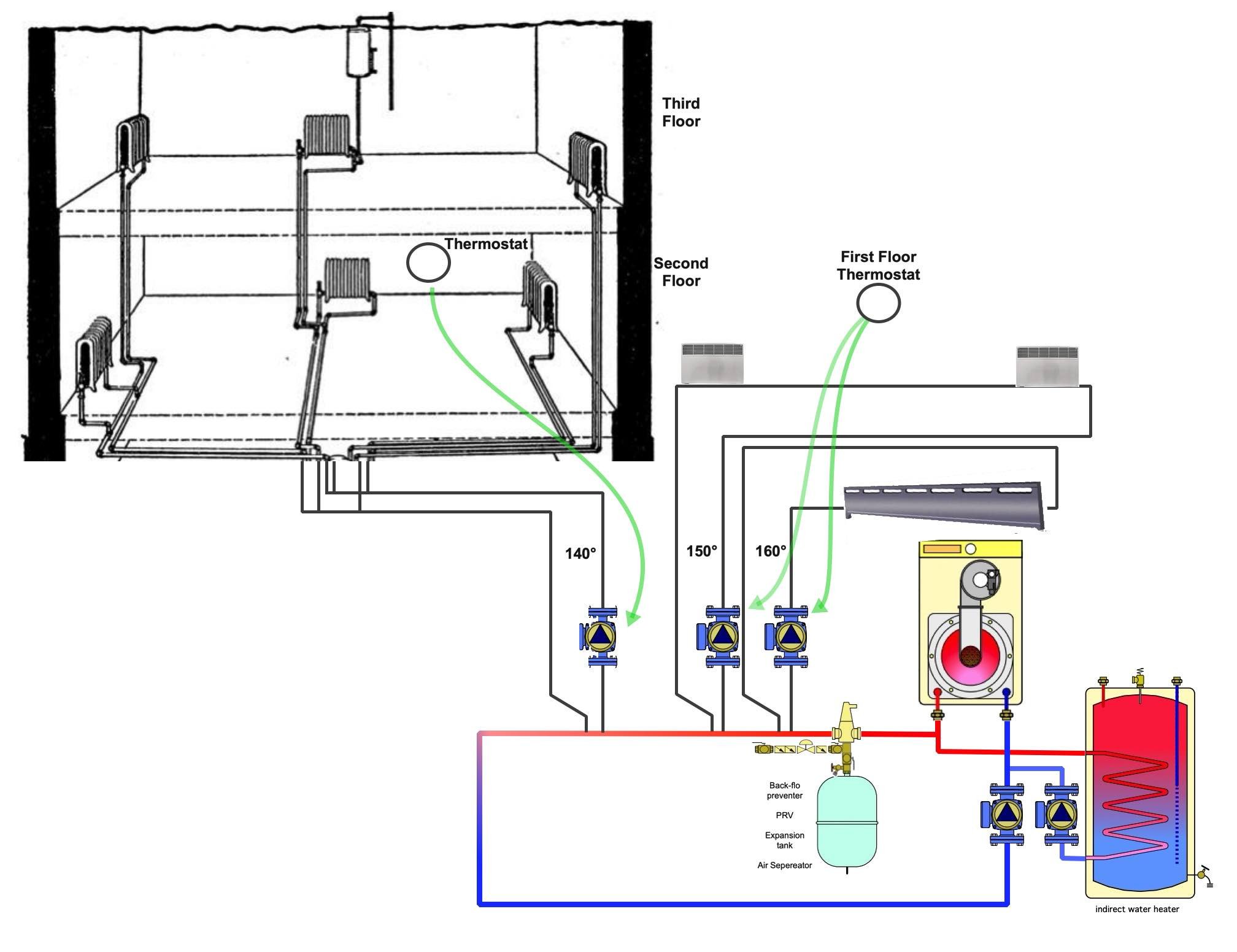

    Agree with @hot_rod on keeping the like radiators on the same part of the system. one idea would be to use the secondary loops in order of temperature. The baseboard can stay in a series as the first loop off of the boiler then the convectors, then finally the upper floors as the last secondary. If you add DHW to the mix then you can use DHW loop directly off of the boiler with the hot water on priority so you only get the highest temperature to the indirect. After the DHW is satisfied, the boiler can go back to the lower reset temperature.
    Look at this piping arrangement to see how the return water from the first secondary loop will be mixed with the second secondary loop to yield a lower water temperature as desired without the need for special mixing ore metering valves and controls. the third loop for the second and third floor will get the coldest supply water. When you use the ODR feature inside the boiler, and take some time to tweak the reset curve, you may not need any additional controls to get the water temperatures in the radiators you require for comfort and energy efficiency.
    During the colder days both the first and second floor will be circulation more that it is off, as a result of the lower water temperature offered by the ODR feature in the boiler, you may see a temperature range like I have illustrated 160°/150°/140°. When the weather is mild those water temperatures will be much lower as a result of the ODR feature for example: 110°/105°/100°. that will add to the boiler efficiency with return temperatures about 10° to 12° lower than the supply temperatures
    These are only examples of what might happen… Your actual results will vary.
    hot_rod Posts: 28,529
    The series primary has some advantages and disadvantages. It works when a 3 are calling for heat, if only zone 3 calls you get 160° SWT to that last zone. Many boilers can offer multiple temperatures via their control. But obviously only one at a time.
    Zones within 10 degrees of one another it is not really worth another mixing station. I'd suggest a 160 and 140. If that?
    With radiators you could supply 160 SWT and run a 30- 35 delta. Then you are always condensing. More so as ODR reduces SWT.
    These are adjustments you would make as the system operate.
