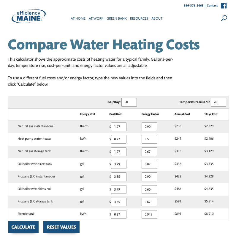

    The other option is to reduce DHW demand. Low flow shower heads, reduce water pressure to 45-50 psi are two way to lower the DHW load, and cost of DHW generation.
    If costs are a concern, plug in you actual numbers here.
    Hard to beat operating cost of a HPWH or tankless.
    https://www.efficiencymaine.com/at-home/water-heating-cost-comparison/

  • I was including HPWH in my discussion. Looking only at the water heater, and assuming a 3.5 efficiency factor, it pencils out to more than 2X the cost to heat via heat pump than NG with my utility costs. And you DON'T run a boiler all summer. It comes on only when the tank temperature is low. You know, like every other tanked water heater on the planet, including HPWH.
