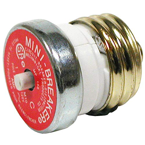

    Easy way to change from fuses to circuit breakers.
    CLamb
    Jamie Hall Member Posts: 27,379
    Except those mini-breakers — which work — are standard Edison base, rather than type S, and are subject to the same critical flaw: you can substitute a larger size for what should be there, and people do. I, at least, would not accept them in a panel I was responsible for.

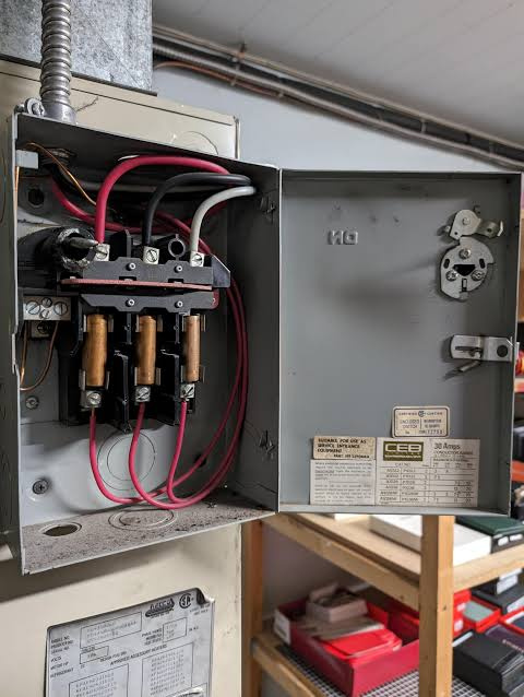

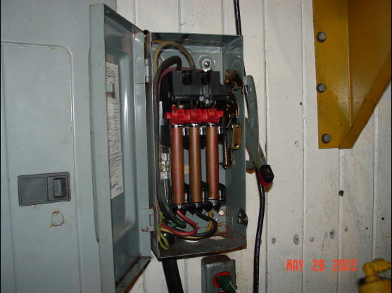

    there is no way to key cartridge fuses, right? some have a key for interrupt rating but they do not have any keying for ampacity
    EBEBRATT-Ed Member Posts: 20,194
    Cartridge fuses no you can replace a 15 with a 30 or a 35 with a 60 or a 70 with a 100 etc.
    I guess they were mostly concerned with home owners.
    I had a neighbor a few houses away years ago. Holly managed a rock & roll band. I won't say any more. Her furnace quit in mid-winter and she already had someone signed up to do that.
    So, with the furnace being out she went out and bought a bunch of space heaters and plugged them in. She called me to see if I had fuses.
    I went over and almost every fuse was too big. A couple were "S" fuses where she tried to put in the wrong ones. I had a whole box of fuses I used to save from changing services to breakers. She had plugged multiple heaters into the same circuit.
    The whole band was there, and the alcohol was keeping them warm among other things. So I straightened things out and moved the heaters to different circuits and made sure the fuses were the right size for the conductors.
    6 months later its summer and she calls me at midnight for more fuses. She decided to have the band strip the wallpaper (yeah at midnight) and they were sloshing water and vinegar on as wallpaper stripper. Some of it got into a light switch and the sparks flew.
    I went down to the panel and everything was all messed up again.

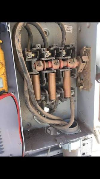

  • Larry Weingarten
    Larry Weingarten Member Posts: 4,103
    Hi, You keep posting pictures like that and you're going to turn @EBEBRATT-Ed 's stomach! 🤮

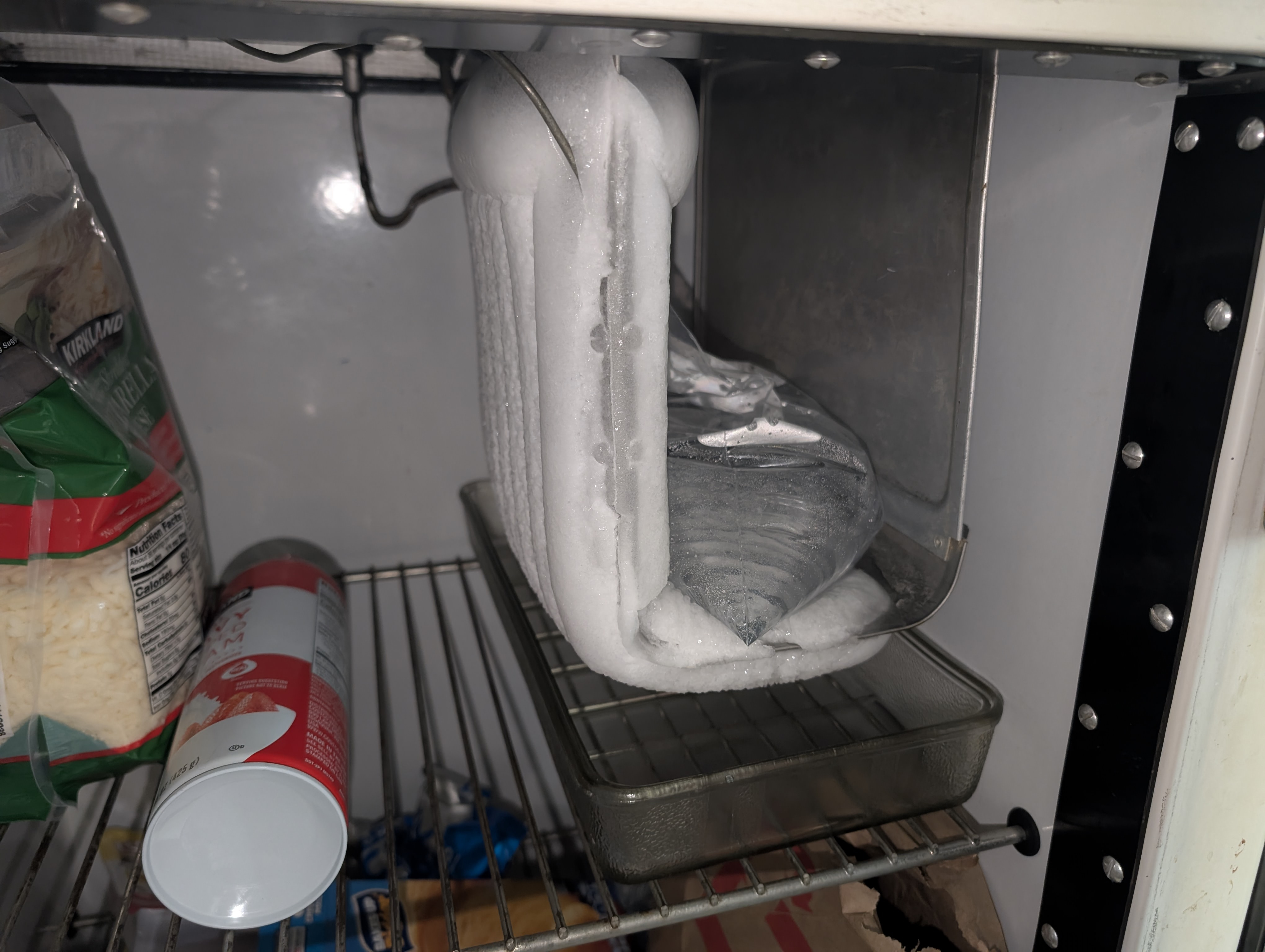

    I'm defrosting 3 of our fridges today. It takes almost no effort but apparently it's too difficult for most.
    mattmia2 Member Posts: 16,825
    the keeping the food cold while it is happening is the hard part. my basement freezer only gets defrosted when it is around 0 out
  • ChrisJ
    ChrisJ Member Posts: 17,391
    Chest freezers are a little harder but even more worth having manual defrost on.
    My normal fridges I turn off, put a 1 gallon Ziploc of hot hot water in and let it defrost. Once the ice releases I pull the chunks out, pour the tray out and drain it and restart. Nothing gets above 40f
