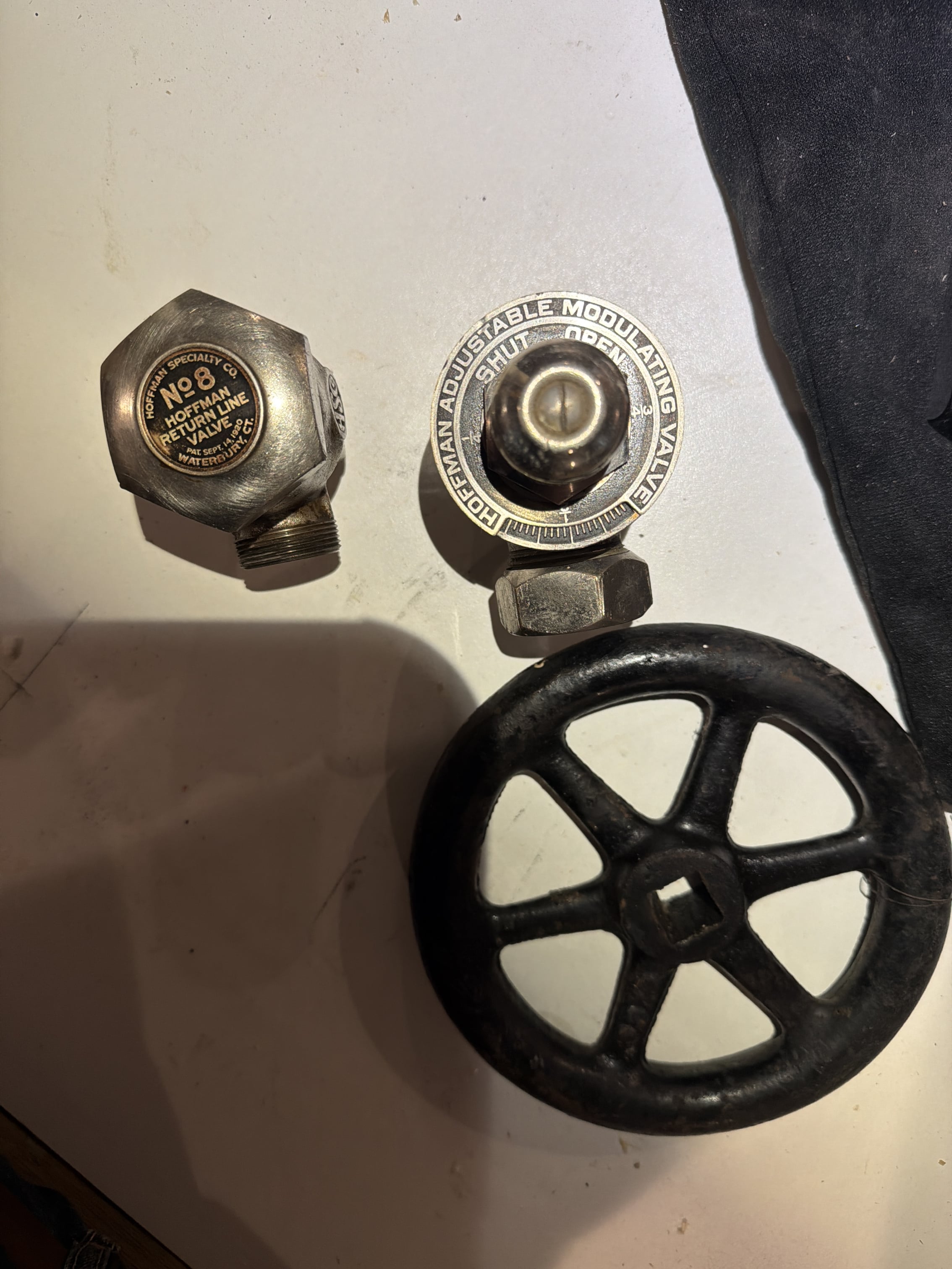

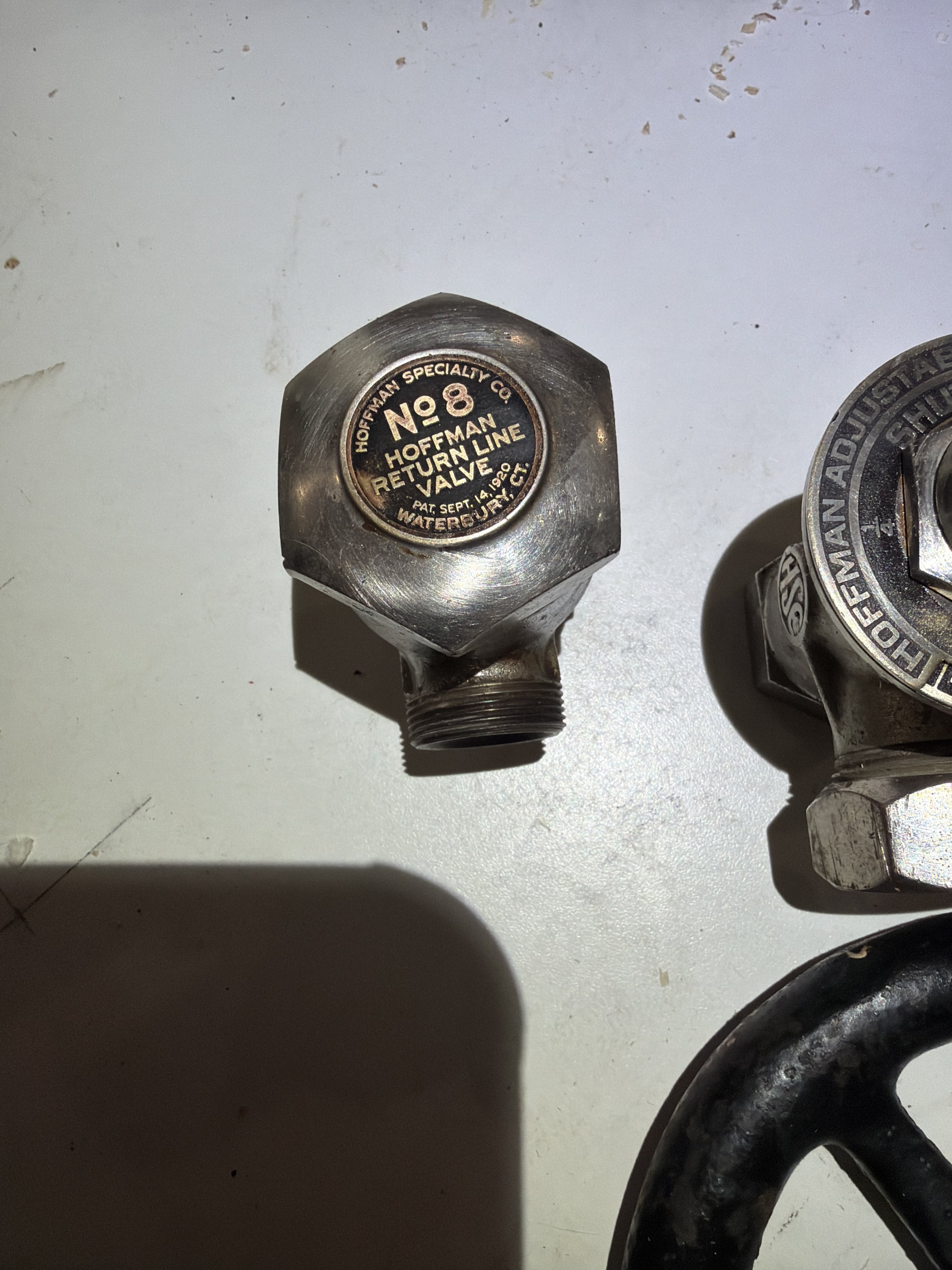

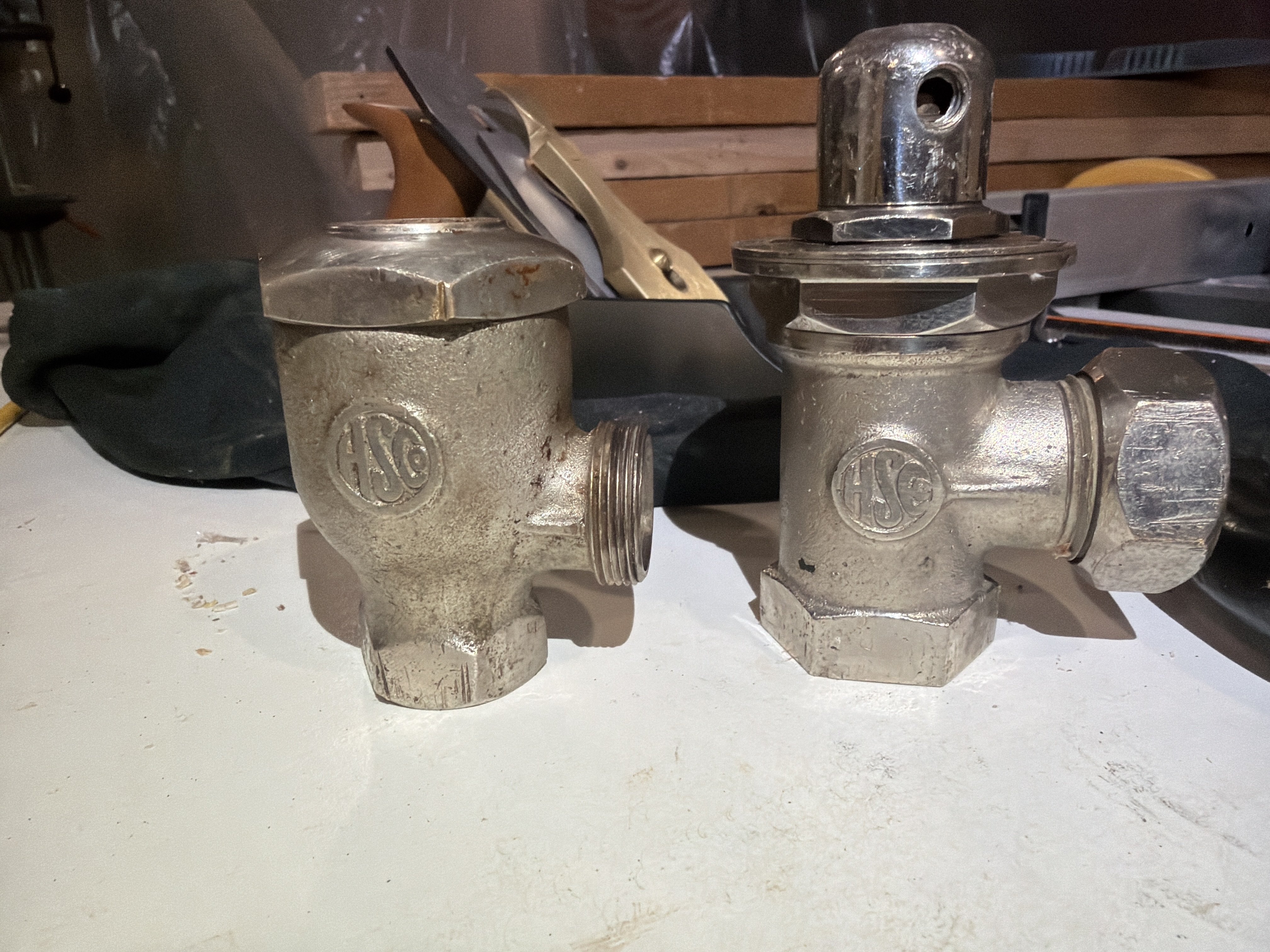

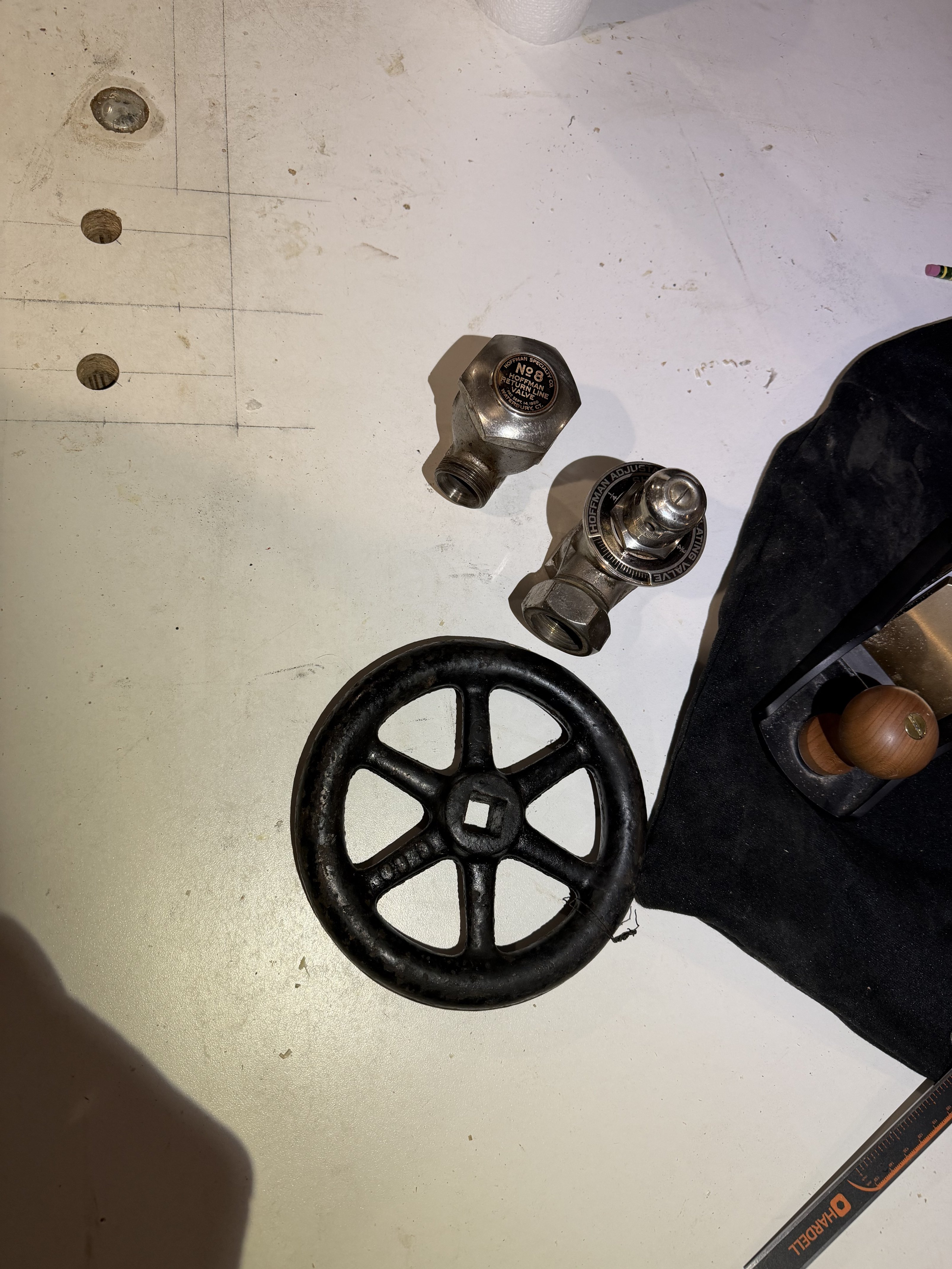

    I’m glad you asked Frank. Always with informed questions you are. These are some of the artifacts I was able to salvage
    aren’t they gorgeous. Taking them out was like killing a unicorn
    THINK

    That is a Hoffman system. Did/does it have a Differential Loop near the boiler? Check around the old Spencer to see if there are any unusual devices in the piping there.

    so it is a hoffman vapor system
    Jamie Hall Member Posts: 27,644
    Hoffman Equipped. Any sign of the Differential Loop? Bet it was taken out when the new boiler was installed. "I don't know what this piece of junk does"…
    Those radiator inlet valves were usually calibrated for the radiator they were used on. ut
    That system will run best with the cutout set to 6 ounces per square inch, 4 ounce differential.

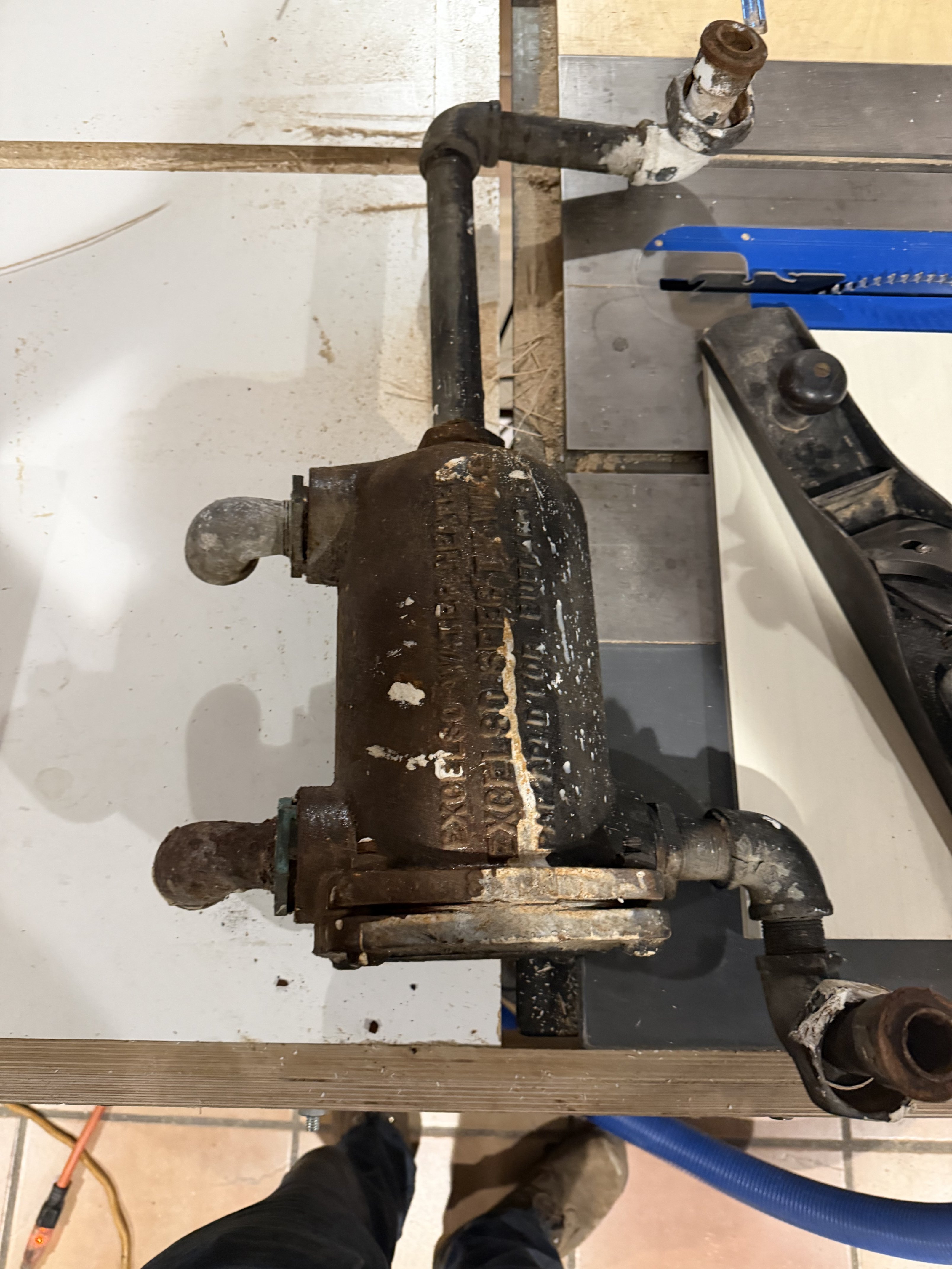

  • 4GenPlumber
    4GenPlumber Member Posts: 176
    NO! You may be extraordinarily skilled, but i dont think you would be able to find the specs on the internals. I had to reassemble one after an employee got over zealous with a sawzall. It was not a good day.
  • AndythePlumber
    AndythePlumber Member Posts: 111
    I did cut this mf off the Spencer. It was restricting my access to some wet return I was repairing and I couldn’t sneak past it…plus a man can’t have too many heat exchangers
