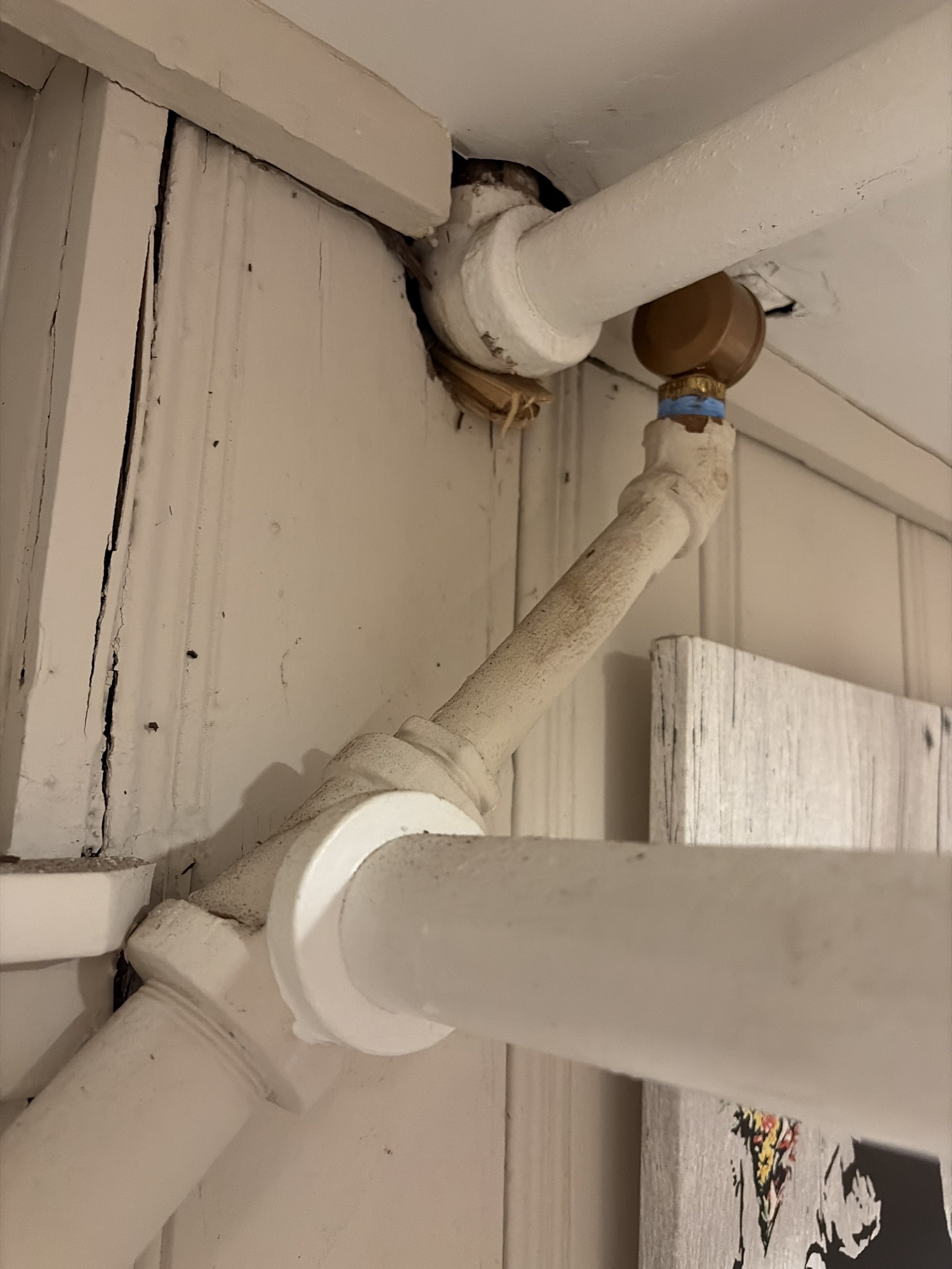

we had a new boiler replaced last year, attic this winter gets all the heat - windows need to be opened - middle floors struggle to heat- not all radiators heat evenly - Is the piping install our problem ? Multiple “specialists” have inspected and said pressure is set right, piping is correct and boiler may be undersized.

    What was installed for main vents?

    will check main vents when back home-

  • vc123
    vc123 Member Posts: 9
    unsure if the valve above and below sight glass is open but the water does bounce slightly up and down inside when the boiler is firing.
    This is installed on the two main vents in the basement - gorton vents as pictured
