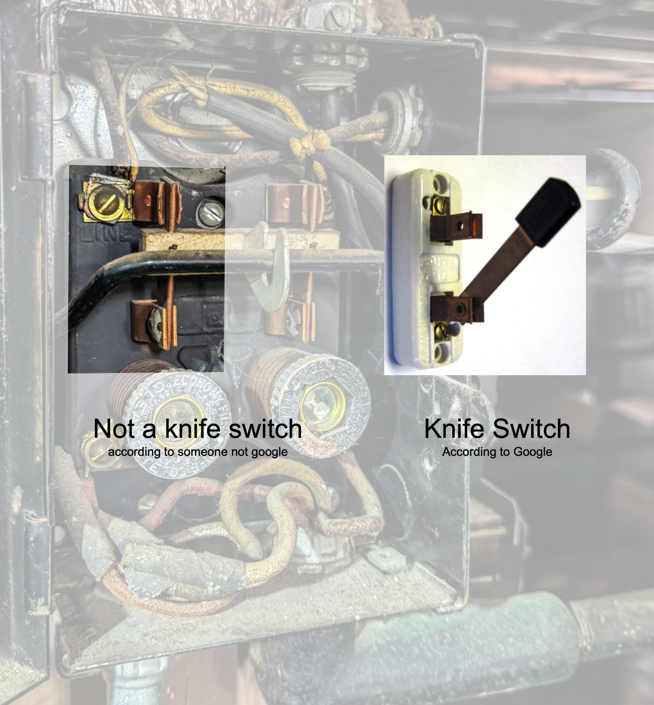

    That is not a knife switch, it is an enclosed safety switch, it is more or less the opposite of a knife switch. They still make more or less that same fused disconnect today out of slightly different materials. Square D invented the enclosed safety switch.
    The requirement for type s fuses appears in the code in the 50's but as far as I can tell it wasn't enforced until the 70's or so.
    EdTheHeaterMan Member Posts: 12,150
    So I googed "Knife Switch" and looked at images that were all very much like the one on the right.
    @mattmia2, can you explain how the one on the left is not a knife switch? Does the enclosure make this not work the same way as a knife switch? Does the handle need to be that piece of bakelite of rubber or some other insulating material at the end you lift to open the circuit? I thing this Square D enclosed fused disconnect uses two knife switches in the assembly. But I might be mistaken. I want to be accurate when explaining the facts.

    I get your point but I also get Matt's
    I think the term knife switch is almost if not always used to describe open switches.

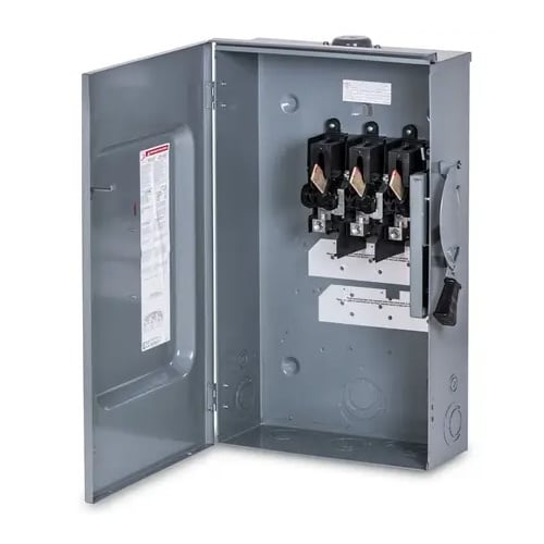

    Here's a current 3 phase disconnect.

    These are knife switches
    109A_5 Member Posts: 3,978
    I knew what Ed meant. IMO Safety switches commonly use knife switch 'type' switches for the disconnect means. I suppose in the case of this boiler, it is a safety switch with fuses, since the switch is enclosed and close to the appliance.
    In modern times they usually do not open the Neutral, and the Neutral is not fused.

    mattmia2 Member Posts: 16,739
    a knife switch is open, it isn't enclosed. almost any high current switch's contacts are going to be a bar of metal moving in any out of a pair of contacts, usually rotating on a shaft like in that enclosed safety switch, even high voltage transmission line switches have similar contacts. that contact arrangement in itself doesn't make it a knife switch. you could have a knife switch in an enclosure but in a knife switch you are moving the contact bar directly, usually with an insulated handle on the end of the bar, it isn't moved from outside of the enclosure with a remote handle.
    edited February 14
    Since it is an exception, knife switches inside an enclosure must exist.
    square d made their business selling that switch as a safe replacement for knife switches.

    To me a knife switch is a basic style of switch. If you enhance the application of it by putting it in an enclosure and that may also include mechanical interlocks, etc. and you call it a safety switch that is fine too.
    So the consensus is that once you take the parts of a knife switch and place it inside of an enclosure, put a bar on it so you can operate the knife portion from outside the enclosure, then it is no longer a knife switch.
