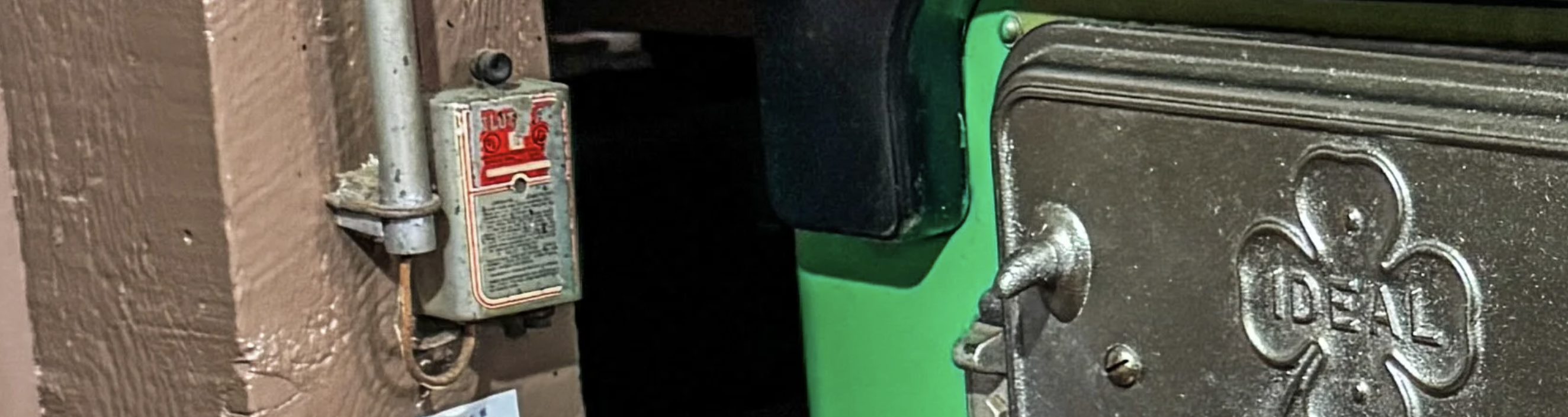

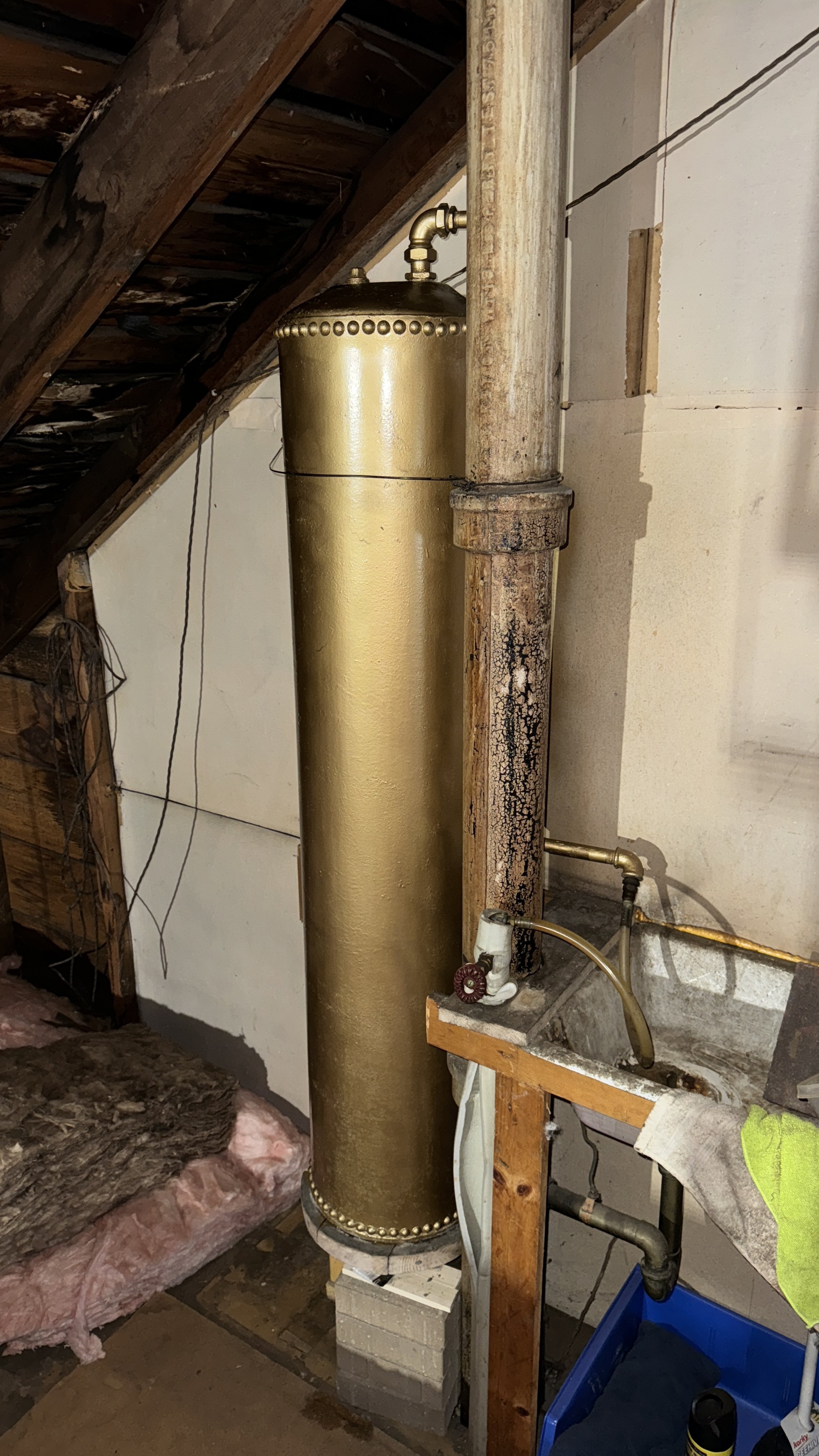

Hello,
I’m making plans to finish rewiring the rest of my 1909 house (1st floor and basement) and updating to 200 amp service. Rest of the house was updated in 2024.
My question for the heating pros here, can my 1937 gravity boiler’s power also be easily updated to modern standards away from the old fuse panel seen here in photos? Any considerations I need to warn my electrician of?
Just to be clear, I have a modern 100 amp circuit breaker panel for the house. Only my boiler has this old vintage fuse box setup. The wiring is old BX that snakes around the basement and terminates to a junction box. The circuit my boiler is on is a 20 amp circuit and as with most old houses shares with a bunch of random areas in the house. If I flip the circuit breaker the boiler goes off just like everything else. The goal after rewiring is to have my boiler all by its lonesome self on a circuit. Most of what you see in the first pic like the vintage Honeywell aquastat is disabled already. The only “live” part is the power switch and transformer.
I do NOT want to ever get rid of my No. 7 Ideal boiler unless it outright fails due to a leak or a crack pumping high levels of CO out. But the thing doesn’t have a speck of rust inside so I don’t foresee that anytime soon. It’s celebrating 89 heating seasons and operates well for its age. So I have no desire to ever get rid of my green beast. See power setup and most recent combustion analyzer result from last month. (I have my own analyzer)
Thank you,

    Any competent licensed electrician can replace that older wiring with modern wiring and connect to your existing boiler controls, while feeding power from a new independent circuit.

    15 am circuit is all you need. No issue with updating the wiring
    Do you have another aquastat? Why is the old one disabled

    Do update that — although technically, in many jurisdictions, you may not have to.
    But two things: remember that when you update, all the new stuff (and sometimes more) has to meet the current code requirements. Since you have other circuits involved, they may (and probably should) need to be updated as well — and, of course, the boiler must be on its own circuit (as @EBEBRATT-Ed said, 15 amp is ample).
    I would be VERY surprised if the present 20 amp arrangement is correct, by the way. Just because you can screw in a 20 amp fuse doesn't mean that the wiring it serves is adequate for 20 amps. That age, it's very likely to be 14 gauge, which is a maximum of 15 amps.

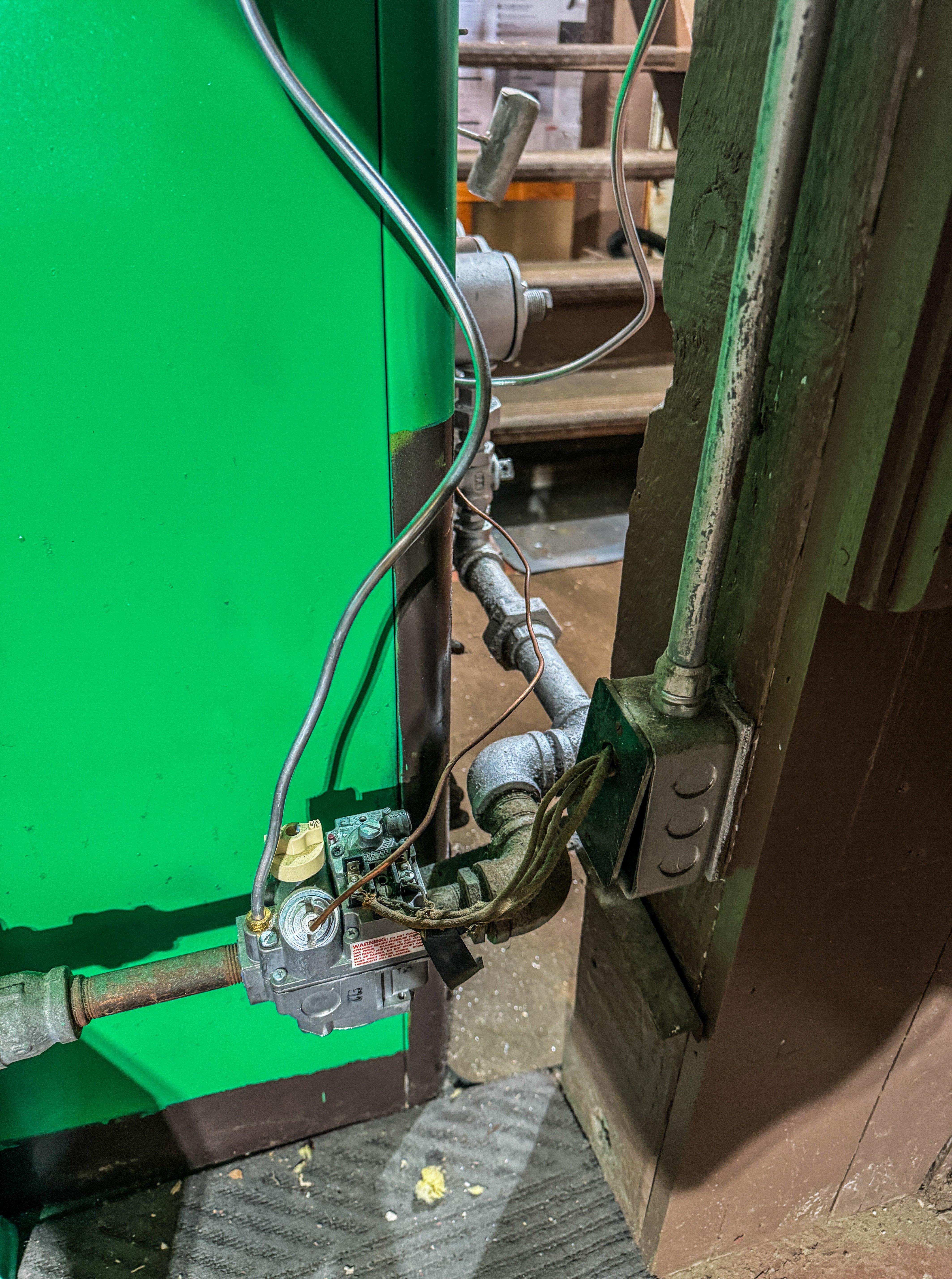

    My biggest concern would be this boiler running without a working high limit control if the old aquastat is disabled.

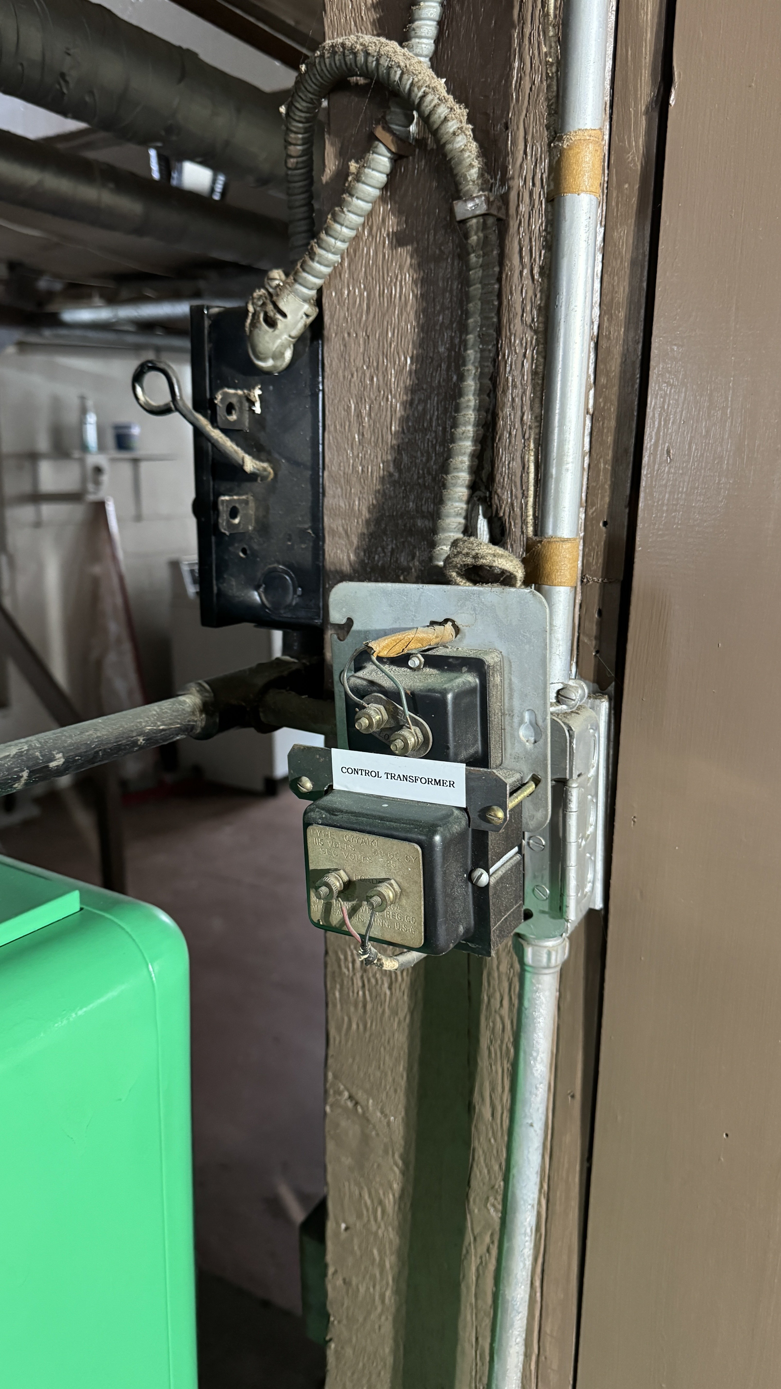

    what is the second pole of the switch used for(i remember trying to figure that out in another thread)? are those 24vac transformers? the fused switch itself can be replaced with a modern toggle switch. if the transformers are 24vac I would replace them with a new transformer because the primary wiring is likely to crumble as soon as you start trying to bend it.
    like others said you would wire a new dedicated circuit to it because central heating equipment has to be on its own circuit.
    is one of those xfmrs for a doorbell?
    Steve Minnich
    i think those may be replaceable element fuses and it looks like the link says "10"
  • You are correct, this area was the subject of another post last year. My doorbell transformer is at the front of the house.
    The second one (on the bottom) is not live. I put my non contact tester near it and nothing, other one, loud beeps.

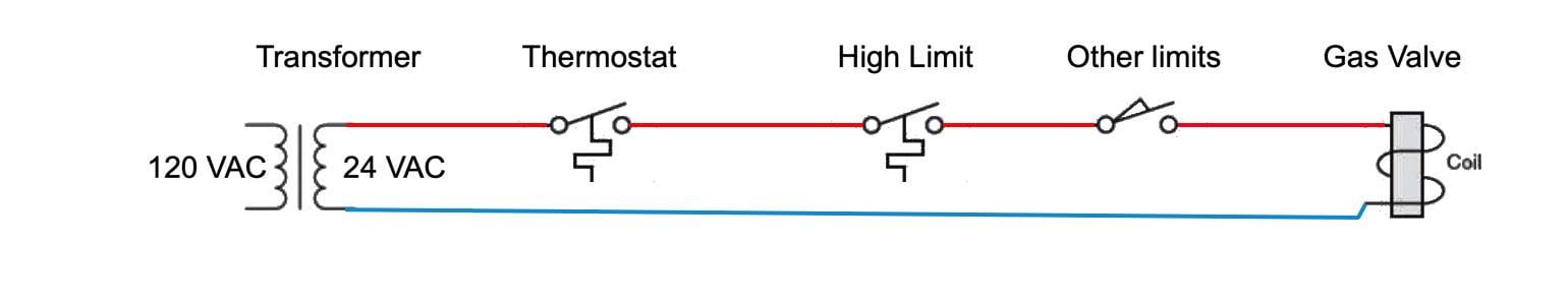

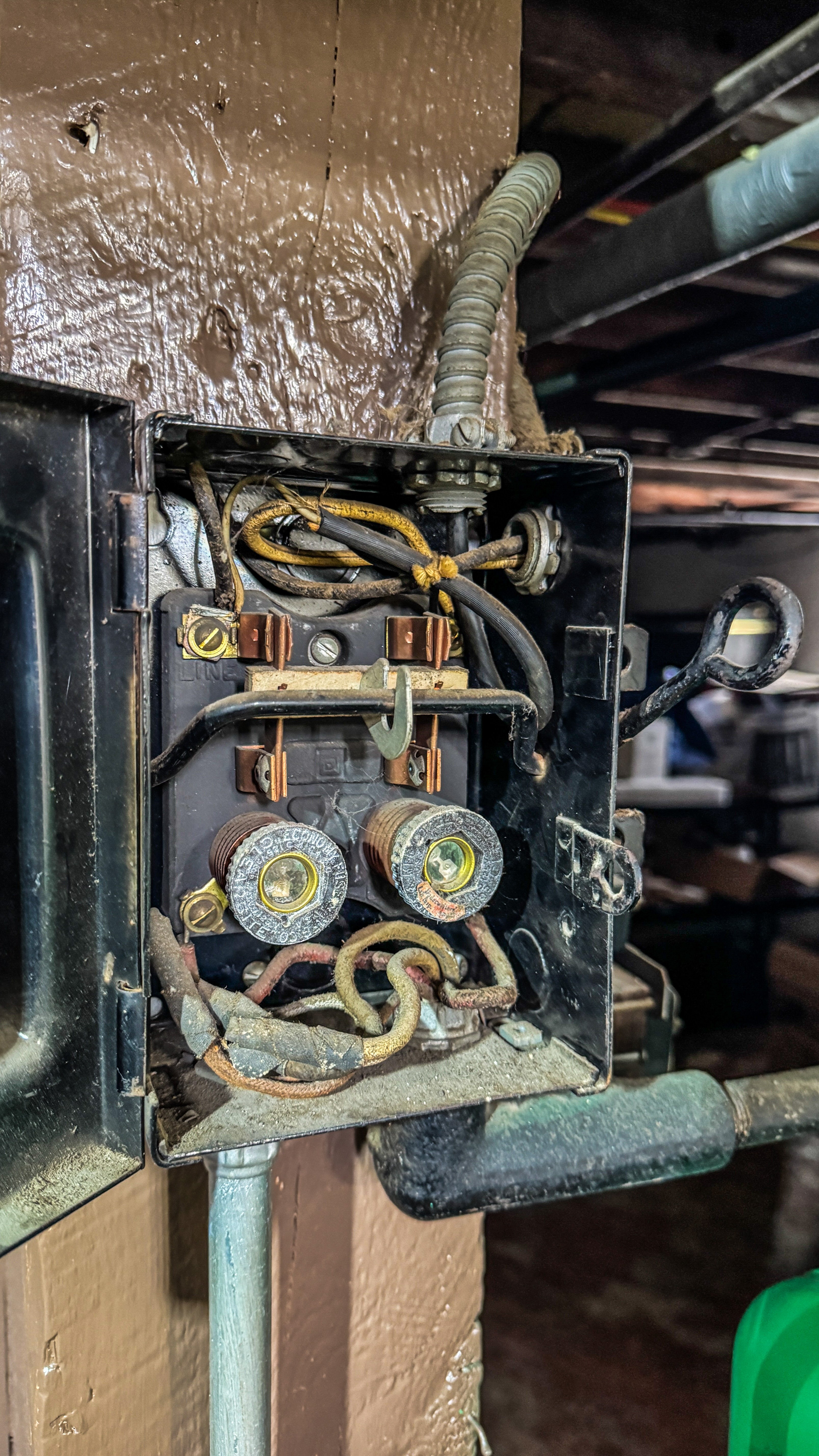

    As I see your setup, you have old cloth-insulated wiring for both the line voltage and the low-voltage wiring. There was nothing wrong with that when it was installed, and you can also use 14-gauge wiring for the new control wiring to keep the look original. Any electrician will certainly want to remove and replace all the wiring
    The fuse box can be replaced with a standard 15-amp switch in a standard junction box. The 15-amp breaker in your new circuit breaker panel is all you need for the dedicated circuit.
    The only 120 VAC item in your setup is the transformer. It does not even draw 5 amps, so the 15-amp breaker and 14-gauge wires from the panel are sufficient.
    Where I think you should change the control strategy is with the 24 VAC transformer. I would replace it with a new one for the reason @mattmia2 mentioned: the wire insulation will likely crumble as soon as you start working with it, and a replacement transformer is not that expensive.
    The next step is to connect all the controls with thermostat wire in series from the transformer R terminal to the thermostat, (red wires) then to the limit(s), and then to the gas valve. From the gas valve, you need a return path back to the transformer C terminal (blue wire).

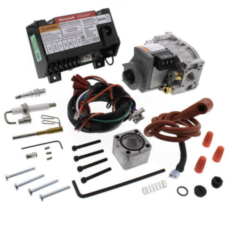

    That gas valve is not original to the boiler or burner system you have. It is a modern redundant gas valve and has more safety features than the original gas valve and pressure regulators with the pilot safety switch on the wall around the corner from the transformer. So keep that gas valve you have, unless you want to upgrade to electronic ignition.
    Depending on the size of the pilot that may save you a little on your annual gas bill but only about $20.00 to $40.00 per year if it has a large flame pilot burner this is the kit for that Electronic Ignition retrofit kit
    Your electrician may not want to get involved with the old boiler to install that kit so think about before you buy.  You will need a gas heat guy that isn’t afraid of old stuff.

    switching the neutral which they did in the old days and it is still legal to do that as long as you open the hot with the same hand movement..
    Some old jobs I have seen had fuses in both the hot and the neutral wires.
    switching the neutral is legal if it is interlocked. fusing it is not.

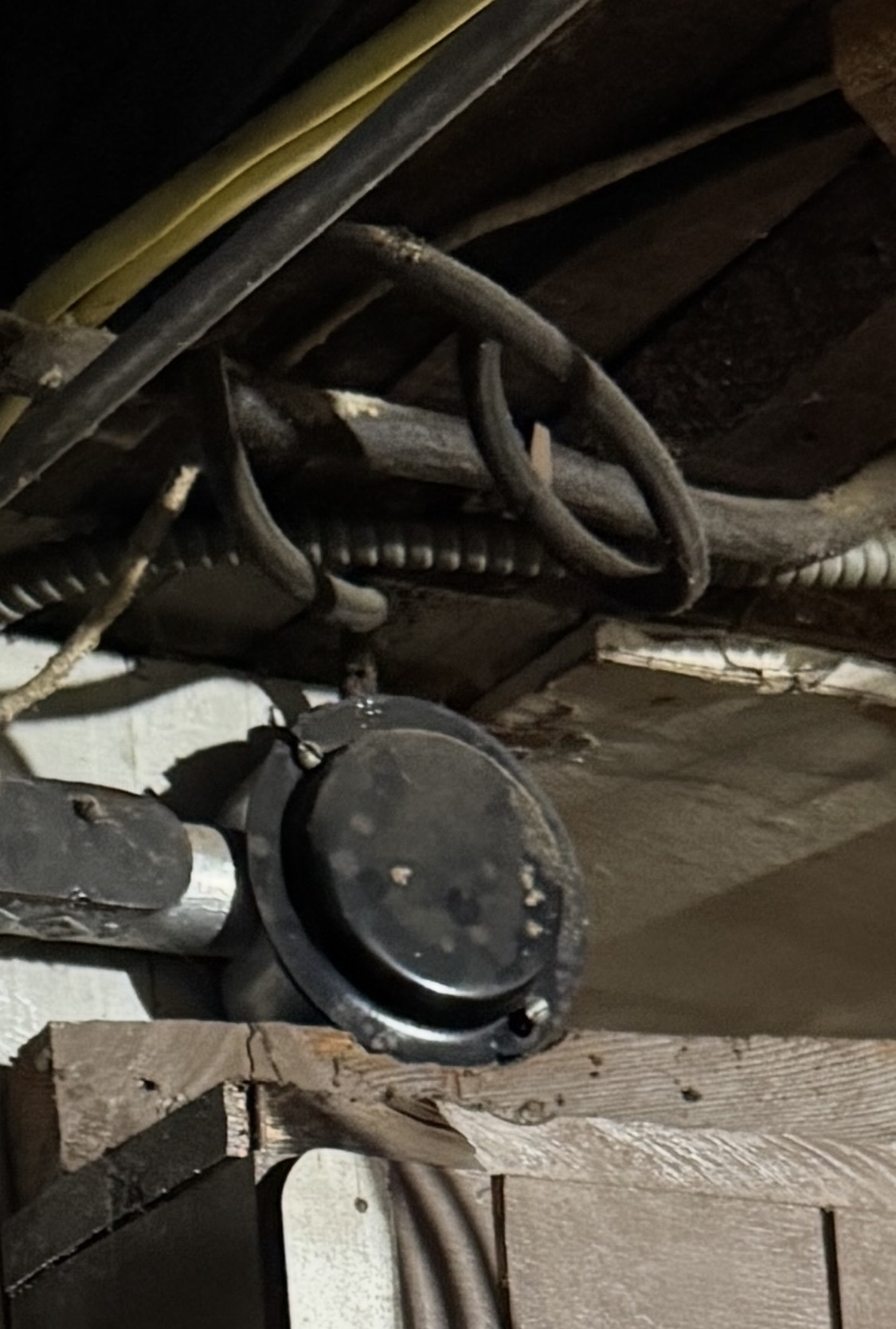

  • Here’s where things get weird too. So in my other comment, remember I said only the top one has juice. See the picture below. The wire runs up to that bundled coil up in the ceiling in photo 1. Still active. It literally connects to nothing. I’m going to at least cap that off. It’s just me so it’s not like anyone would be monkeying around in my basement.
    in the second zoomed in photo, that black cloth wiring coming out that old junction box is completely dead. It seems that the current BX replaced that. My system is such a mystery on what the dead men did. And the fact I was able to get my Google Nest to work, without touching anything down in the basement has me just as talented as them with magic tricks. 😂

    That bundle of white wire hanging from the ceiling looks suspiciously like old telephone wiring. Wonder what it is… or was…

    i think there are screw terminals behind the giant insulation of that old cloth and rubber wire in the front

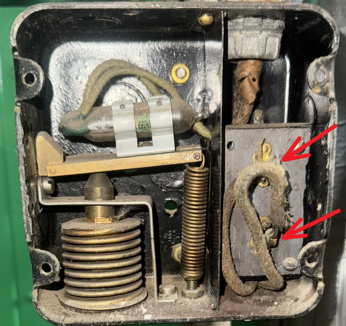

    You do have one switch that can be disconnected. It is the BASO switch. BASO is a brand name for the gas pilot safety switch. That switch is no longer connected to the pilot because that safety device is included in your upgraded Redundant Gas Valve. The old gas valve and pressure regulator gas train was replaced some time ago with a modern redundant gas valve that is designed to turn off the pilot gas if the flame goes out. The old Gas Train would allow the pilot gas to continue if the flame blows out. That was not a problem when that burner was installed but it will not pass code today. Since you already have the better gas valve you no longer need the BASO switch.

    The existing (current) gas valve is made by Robertshaw. It reminds me of the 700 series that uses a standard thermocouple.
    If you are talking about the BASO switch that is about 18" below the fused disconnect switch, I believe that was operated by the same type of thermocouple. No mercury switch involved.

    The Mercury switch device is a pressure switch. I suspect it is wired like a LWCO. So if the systems water level drops (pressure drops) due to a leak it shuts the burner off. The trip pressure is unknown, it looks like it can be adjusted a bit.

    Here is everything under the hood. I replaced everything fall of 2024. Including the gas valve which was old new stock my boiler guy had and replaced the exact same model in place before. I was having an issue with the pilot going out randomly. Everything was so old it all needed updating for sure. And since doing everything it’s been reliable ever since. Well worth the fairly low cost as seen here for parts.

    Basically there is a power source, the transformer, there is a load, the gas valve. For control and safety function, the Thermostat, the Aquastat (boiler water temperature limit control), and the “Expansion Tank Relay” (a pressure switch, a LWCO (Low Water Cut Off)), they all have to be closed or 'On' for the burner to work. If any switch opens or shuts off for their own unique purpose the burner shuts off.
    Electrically they are all in a series circuit. Like the old Christmas light strings, one bulb burns out (or you unscrew it) they all go out. In this case if one switch opens, it does not matter which one, the burner shuts off.
    @EdTheHeaterMan's drawing is probably very close if not exactly the way your system is wired. It certainly electrically describes the functionality of the circuit. The 'High Limit' is the Aquastat, the 'Other limits' would be the “Expansion Tank Relay”.

    Looking closely at the wires inside the pressure switch there is a possibility that the pressure switch is connected on the 120 V. side of the transformer. in that case the wiring diagram might look like this.

    There are several possible ways to connect all the parts to each other. A licensed electrician performing the wiring upgrade should be capable of tracing the existing conductors and developing an accurate wiring schematic before proceeding. From there, both the line- and low-voltage wiring can be replaced methodically, ensuring that every safety and limit control is correctly reconnected and functioning as designed.

    If that fused disconnect was breaking both the L1 and the N as you have it drawn, that would not be consistent with the electric code of the day.
    1930s electrical codes did not allow the neutral (grounded conductor) to be fused or disconnected independently in a typical 115 V circuit for a reason.  Back then the governing document was the National Electrical Code, already well established by the 1930s. The code required that: The grounded conductor (neutral) remains solidly connected. Overcurrent protection can be placed in the ungrounded (hot) conductor only. A disconnect, when required, opens all ungrounded conductors — not the neutral.  If you open or fuse the neutral while leaving L1 energized: The equipment chassis can remain energized through the load. The circuit appears “dead” because nothing operates. But the hot conductor is still sitting there at full potential.
    That’s a classic “looks safe but isn’t” situation.  I remember learning that in 1976 while taking an evening course on oil heat at Philadelphia Wireless Technical Institute. On the 1600 block of Pine Street.    They taught how to fix radios and also about oil burners. I still remember some of the basics from those old classes.
    Next time you come across one of those, look closely and you will see the white wire (with all the white paint faded off the cloth insulation) does not get connected the the switched/fused connector terminals. Also you never place a limit or a switch on the neutral side of a 115 VAC control circuit This is a corrected diagram for your perusal. The two poll switch can be used for a 220 VAC appliance or can have 115 VAC with both switches from the same leg of the power entering the building. That is why I didn't label L1 and L2, just Hot and Hot
    TheUpNorthState88PC7060
    109A_5 Posts: 4,759
    @EdTheHeaterMan My example wiring diagram was how it MAY be wired since @TheUpNorthState88 was not having much luck with the non-contact tester, not the way it SHOULD be wired.
    And as mentioned above (by others) it is probably OK to switch the neutral as long as the Hot opens also. The Neutral should not be fused.
    I would have opened the neutral fuse and re-done the non-contact tester test. But @TheUpNorthState88 did not want to do that.
    I would have probably verified it with an actual Multimeter.
    To me this would be more acceptable if the safety limits are actually rated for 120 VAC. Although there is really is no benefit to switching the Neutral. I would put the limits on the 24 VAC side of the transformer.
    EdTheHeaterManPC7060
    EdTheHeaterMan Posts: 12,948
    @109A_5 The code in the 1930s did not call for a third green or bare copper conductor that you find in romex wires today. About 1947 or 1950 was the first mention of a dedicated ground wire in the NEC code books but I might be wrong about that. But I agree with your newer diagram if Northstate88 wants to keep the old look of the knife switch and fuse. The reason that there were fused disconnects back in the 1930s was to use several circuits off of one 30 amp leg and then drop down to two or three 20 amp circuits that could handle multiple appliances. If the new gas burner needed only 5 amps or less to operate the control transformer, it might be added to a basement 20 amp wire and then drop down to a lower gauge wire that had the 5 amp fuce in the switch box.
    The average homeowner in the 1930s was a little bit more hands on with electric stuff and that was the reason for the 5 amp screw in fuse that also fit the same socket as the 30 amp screw in fuse. The homeowner was supposed to know not to put a 30 mp fuse into a 5 amp circuit . We all know how that turns out…
