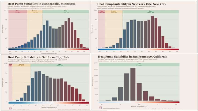

Natethehousewhisper.com put a link to a temperature database.
This is important when considering a mod con, or HP, on a high temperature requirement system. How many days do you actually need that 180°F SWT?
Outdoor temperature and required SWT track fairly consistent, a 1:1 setback is commonly used for ODR setting..
So if at 0° you need 180, drop 1° SWT for every drop in outdoor. If so on a 30° day, 150 or so SWT should cover the load.
4 examples I tried

This post shows how to use the data from NEEP.org to model a house's heating load: https://www.greenbuildingadvisor.com/question/how-to-model-and-predict-electricity-usage-for-a-heat-pump
While it's targeted at heat pumps, the load part of the calculation works the same for any heating source.
Using that method for Boston, 50% of the annual heating occurs below 33F. There are 1557 hours in a typical year below 33F. Design temperature for Boston is 13F and mean annual minimum is -6F.
In Washington, DC, 50% of annual heating occurs below 37F, there are 1303 hours per year below that temperature. Design temperature is 22F and MAMT is 5F.
If you're heating with combustion, a BTU is a BTU, but if you're heating with a heat pump BTU's a colder temperatures take more electricity. In Boston, if you were heating with a heat pump half of the annual electricity usage would be in the 1129 hours below 30F. In Washington, it would be in the 937 hours below 34F.
@hot_rod: "Natethehousewhisper.com put a link to a temperature database.
How Much of the Year Will a Heat Pump Work In My City?"
That's an unhelpful characterization. Basically he's taking a complicated subject and simplifying it in a way that's not useful.
First, it's just the wrong way to think about it to say when does a heat pump "work." It won't stop working until the refrigerant stops being able to boil, which is going to be around -40F. When does a heat pump stop being practical to run? That's a complicated question that depends upon your climate, the construction of the house, the choice of equipment and the local cost of electricity and competing fuels.
But Nate chooses to just say that heat pumps don't work below 25F.
As a first-order approximation, anyone who quotes a specific temperature as the point where heat pumps stop being practical, without bringing in all of the other factors, doesn't understand heat pumps.
