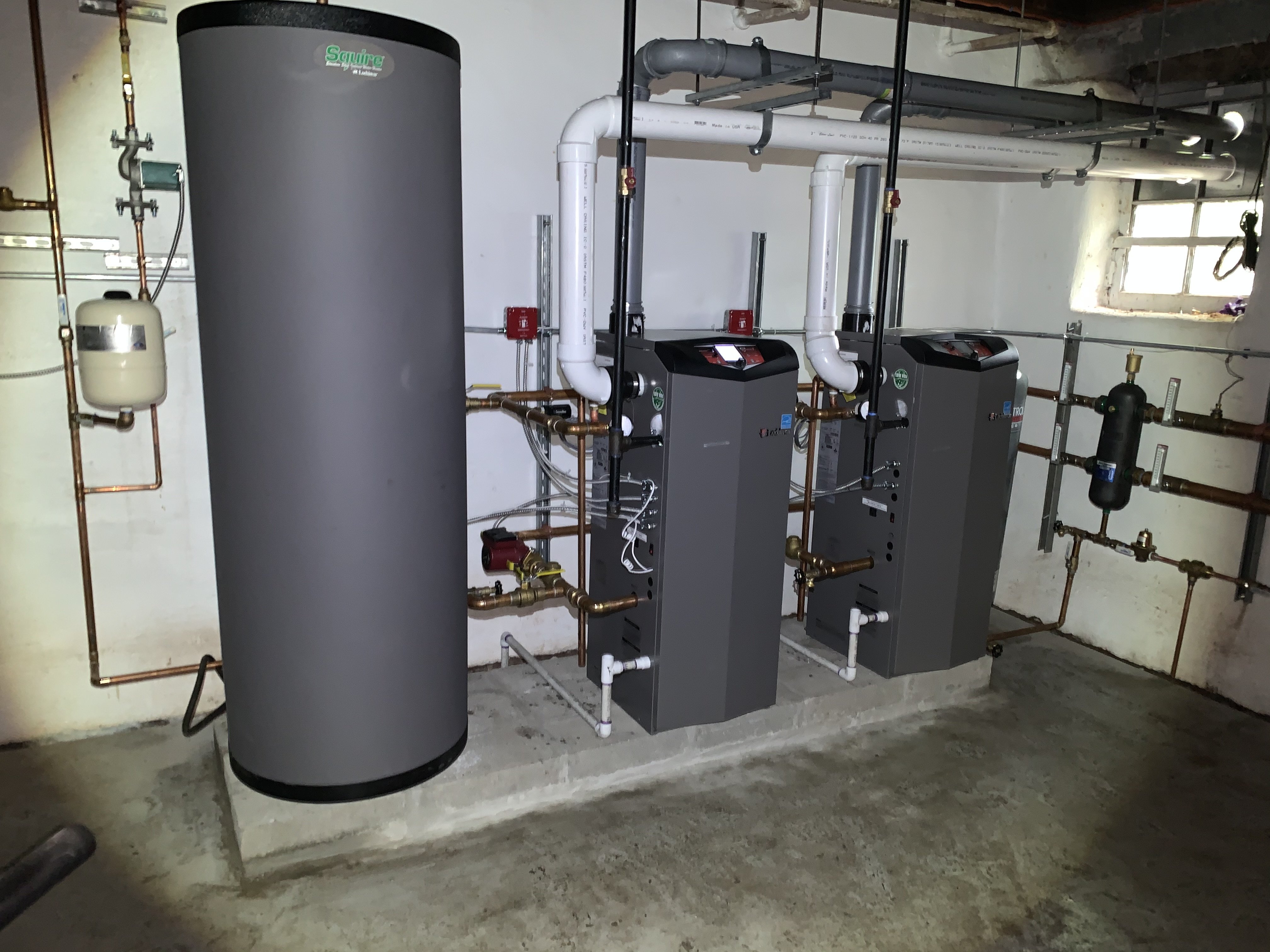

In the world of Heating and Cooling, there is a temperature that gets thrown into the mix of both longhand calculations and computer models that establish the BTU outputs of all our equipment. It’s called a “design temperature” and it varies as we follow typical climate variations going north and south, and up and down in elevation. In our part of the world in 2026, the design temperature is 13°F.
That means that heating systems are designed to maintain an indoor temperature of 70°F when the outdoor temperature is 13°F.
Efficiency is defined many ways by the different industries that use the term but in fuel-burning boilerspeak, peak efficiency means the boiler runs at 100% of its output at design temperature, and never shuts off while hovering around that outdoor temperature, and combustion is steady with minimal standby or flue losses at the boiler which factor heavily into manufacturers' published efficiency ratings. In other words, the two most *efficient* boiler heating cycles will have the boiler never come on, or have the boiler maintain the 70° indoor temperature by never shutting off. We call that a "Design Day" heating condition.
So, what happens when the outdoor temperature drops below design temperature? Like lots of days these past two weeks? Well for us professionals, the first thing that happens is all our online forums and message boards start blowing up with warnings to each other about trouble coming, and stories of engineers on current projects nervously considering supplemental heat sources in their designs.
But the bottom line is design temperature is often an average of the ten coldest days of the year and it is well known and expected that there will be be a handful of days colder than the median or average cold day. And so it is accepted that the internal ambient temperature of some of those structures operating on design have the potential drop below 70°. Does that sound like a failure? Maybe. But what you have to consider is that aside from the heating system, there are plenty of other things in the home or building that give off heat to the space. Cooking a pot of stew adds heat energy to a space for hours. Lights, TVs, computers, cable boxes, solar gain, hair dryers… all these things being in place or running add BTUs to the home and take some of the onus off the boiler or furnace. So, this high-design-temperature-vs-low-outdoor-temperature thing is rarely ever an actual problem. To design a home heating system with significantly higher heating capacity, or to change the design temperature to 5° or less will often change the design greatly, increasing installation costs substantially and operating costs permanently.
If you feel you are getting close a to problem caused by low outdoor temperatures versus your system’s design, you would be well advised to do what you can to close that gap. Literally. A tight building envelope will outperform even the most highly efficient of boilers and furnaces. You heat your home only with the BTUS you keep inside. The rest are gone instantly and forever. A lot of words for a Sunday morning but I hope this helps someone.
(In the photo below, two boilers provide redundancy to make heat and hot water. Multiple smaller boilers tend to burn fuel at higher efficiency than a single larger one due to something called "turn-down-ratio" limitations so each of these units is sized for 75% of the home's peak demand. If the primary boiler can't meet the target temperature, the secondary unit kicks on at 10% intervals. The full capacity of both boilers being 150% of the demand means the home's heating zones are always satisfied in the most efficient way possibly.)

    So the reason for the two boilers in the above design is redundancy? That looks like an older home with most likely cast radiators. How do you get the efficiencies w/ condensing boilers at high temp water for the old radiators?
    I grew up in a stone monster on Philly's main line and did a rehab of a large stone house in Chestnut Hill, PA in the 90's. Both houses were built just after WWI and both were originally coal. Both required high temp water. When I did the Chestnut Hill house I was able to incorporate some radiant floor/ wall and panel radiators in areas of the house being gutted but most of the main living spaces were not touched. I used two cast iron Buderus boilers w/ ODR — one having an auto mixing valve for a second water temp to supply the radiant. I had been helped by a local guy a few years earlier on odd property that became my first home/ office. He did a room by room design temp heat load and that was an eye opener. I was a bit worried because the BTU's he said were required seemed too low. The existing forced air system was 2x the size. We did radiant in most of the first floor — panel radiators in lower level and 2nd floor. All the panels were designed for lower temp water (I think 150). I trusted him when he did the same for me at the Chestnut Hill house … we were lucky that the original design of the house had slightly oversized radiators. Also, a surprise how well constant circulation and ODR worked in that house. Interesting — I still own the first place and a friend bought the Chestnut Hill house. The original boilers are still in place — Is a condensing boiler going to last 30 years?
    What is the future for hot water anyway ? My last project with full radiant is almost 4500sf and it uses the smallest Viessmann boiler available. With spray foam and modern windows the heat load per square foot is getting very low …. almost too low in many parts of the country for radiant. It made no economic sense to do any type of hot water in the outbuilding — uses a heat pump.
    It seems that the majority of high efficiency boilers are installed in older buildings and are pumping out high temp water — what is the real efficiency of those units and what is the life span?
    The place I grew up in had mostly all enclosed radiators in what one would call the public areas and all kids of odd ones in other areas. But they all needed very hot water — some were ducted and took air from outside. What is the lifespan of very large condensing boilers ?
    we see many people here with systems where the size of the radiators in the gravity system is such that they heat the house with low temp water most to all of the time and they are challenging to connect to a conventional boiler without it condensing because of the sustained low water temps. where condensing boilers don't do so well is on systems with fin tube baseboard because the output of that falls dramatically when the water temp falls and they are generally designed for 150f-180f water so when modcons are used with baseboard they usually don't spend much time in condensing mode.
