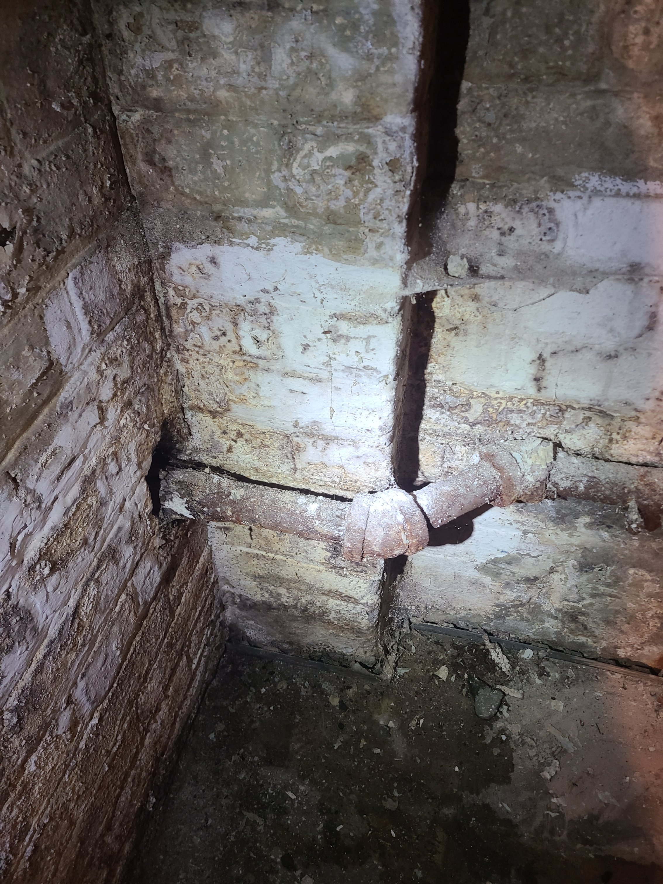

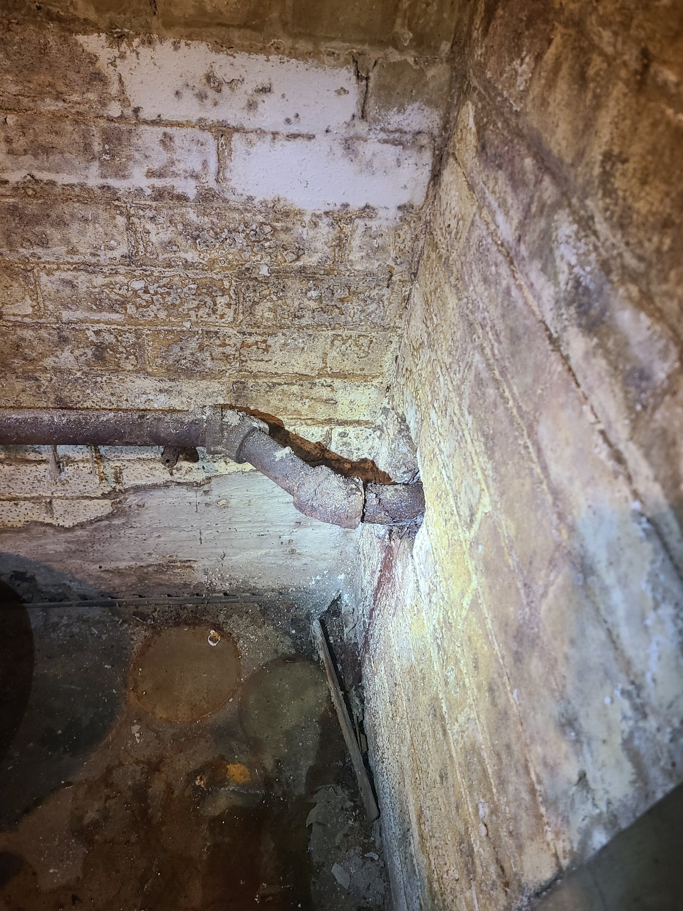

Now I hear a hiss and find this wet return pipe has decided 105 years is enough.
Suggestions and best practices for this, please?
Leaking where it's sitting inside the wall. Photos of both sides of the wall.

    any plumber should be able to cut out the bad pipe and replace it. They may find all that pipe is shot

    I would replace that whole run with copper. If you put something between the masonry and the copper where they touch/are secured it will last longer. I would also put tees and appropriate fittings at both ends so you can flush it with a hose.

    For now, I might replace just that small section of pipe. I’d use copper, and probably a ProPress-to-MPT adapter on each side.
    Be sure to add something it can slide against—maybe a thin shim of wood with a piece of plastic milk bottle—so it can handle expansion and movement in the brick opening.
    The thinner copper pipe will also leave room for a friction-reducing wood/plastic spacer, so we don’t mess with the proper pitch of the return.

    I don't expect that single section between the first 45's is any good.
    So cut the first two 45's and add adapters on both sides, new copper 45s then a straight copper between the new 45s through the wall? Does that sound like a plan?

    Replace as much of it as you can. If a pipe like that goes in one place, the whole thing is going to go soon (don't ask how I know that). Copper is fine.

    Since your return is accessible, change as much as you can. Once you go to cut the bad nipple, you will: 1.Find more nipples rotted. 2. Drop rust/sediment into your return and not be able to flush it. Might as well do the job once.

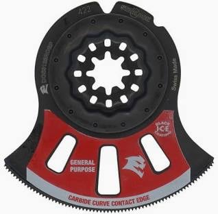

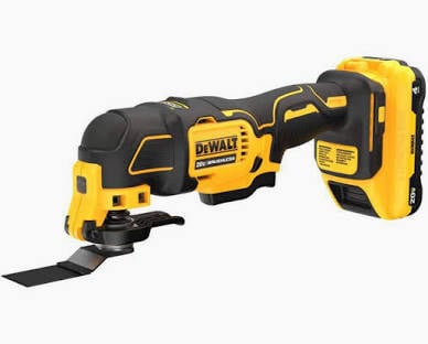

    Do you have one of these?
    With a good metal cutting blade?
    This would help. Get one that is meant for cutting metal. You can also more easily gauge the depth of cut on the neck of the fitting you are cutting. This is great to use specially when cutting the neck of a black cast iron fitting. They do great and do not cause a lot of vibration. If you don't have any of these, elbow grease and a good hack saw will have to do.
    Cut the pipe to where you can find a usable thread and go from there.
