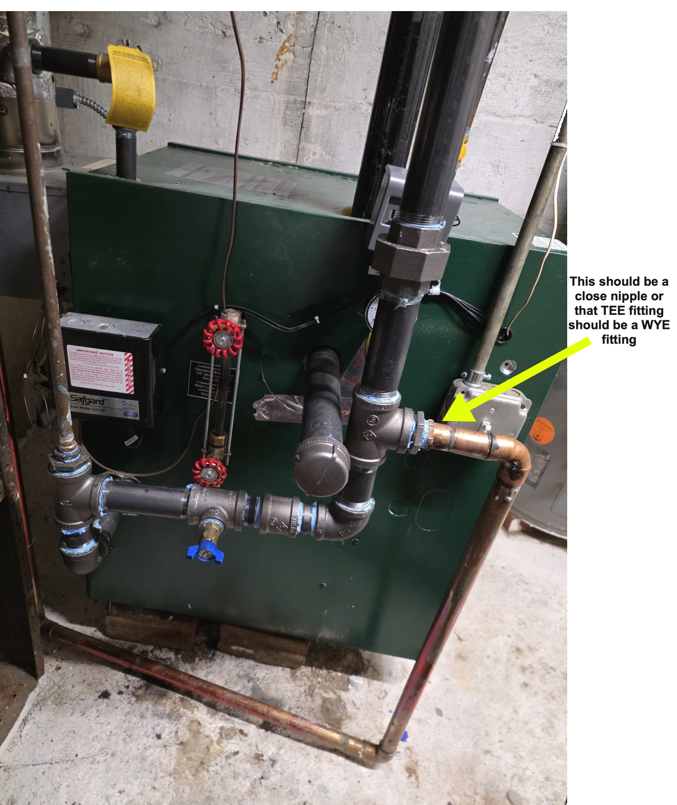

Hello all,
I had my new boiler done a few months ago. I'm experiencing some problems like water hammer, radiator leaking among others.
A plumber told me The Hartford loop is incorrect and he's going to charge me a fortune to fix it. The loop is causing all the problems. I'm not sure I trust this guy.
Is this done wrong or right? Thank you.
PFloro
    EBEBRATT-Ed Member Posts: 19,850
    Not the best-looking Hartford loop I have seen but I guess it will work. Take a ruler and check the height off the floor to where the copper tubing comes out of the return tee. Then measure off the floor to the normal water level which is where the boiler MFG marks it or to the center of the gauge glass.
    The copper tubing should be 2"-4" below the normal water level. Yours looks high but It could be the camera angle.
    Post some pictures of the piping above and around the boiler so we can see if you have other issues.
    Why not get the installer back if you need changes and not the plumber?
    Did they measure your radiators when they sized the boiler? Did they skim the boiler.

    Yeah it's wrong. Looks too high to me. As Ed says, the top of the Hartford should be 2 to 4 in. below the normal water line. Also that Tee should be a reducing tee with a Street elbow or a close nipple with an Elbow. With it that long you could get water hammer, especially with it probably being too high.
    I don't think that is the right place to put the shutoff valve in the return which is to allow you to do a no return flush. I would put it in the vertical part just below the elbow in the Hartford.

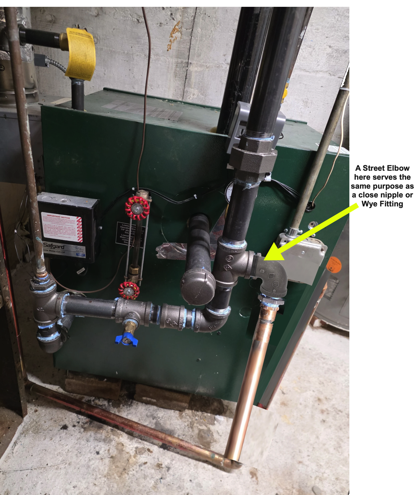

    Wrong and may be the cause of the hammer
    It looks like a 8" to 10" long pipe between the copper elbow and the Tee fitting
    You want the pipe here to be as short as possible. A street elbow serves the same purpose as a Wye fitting or a close nipple.

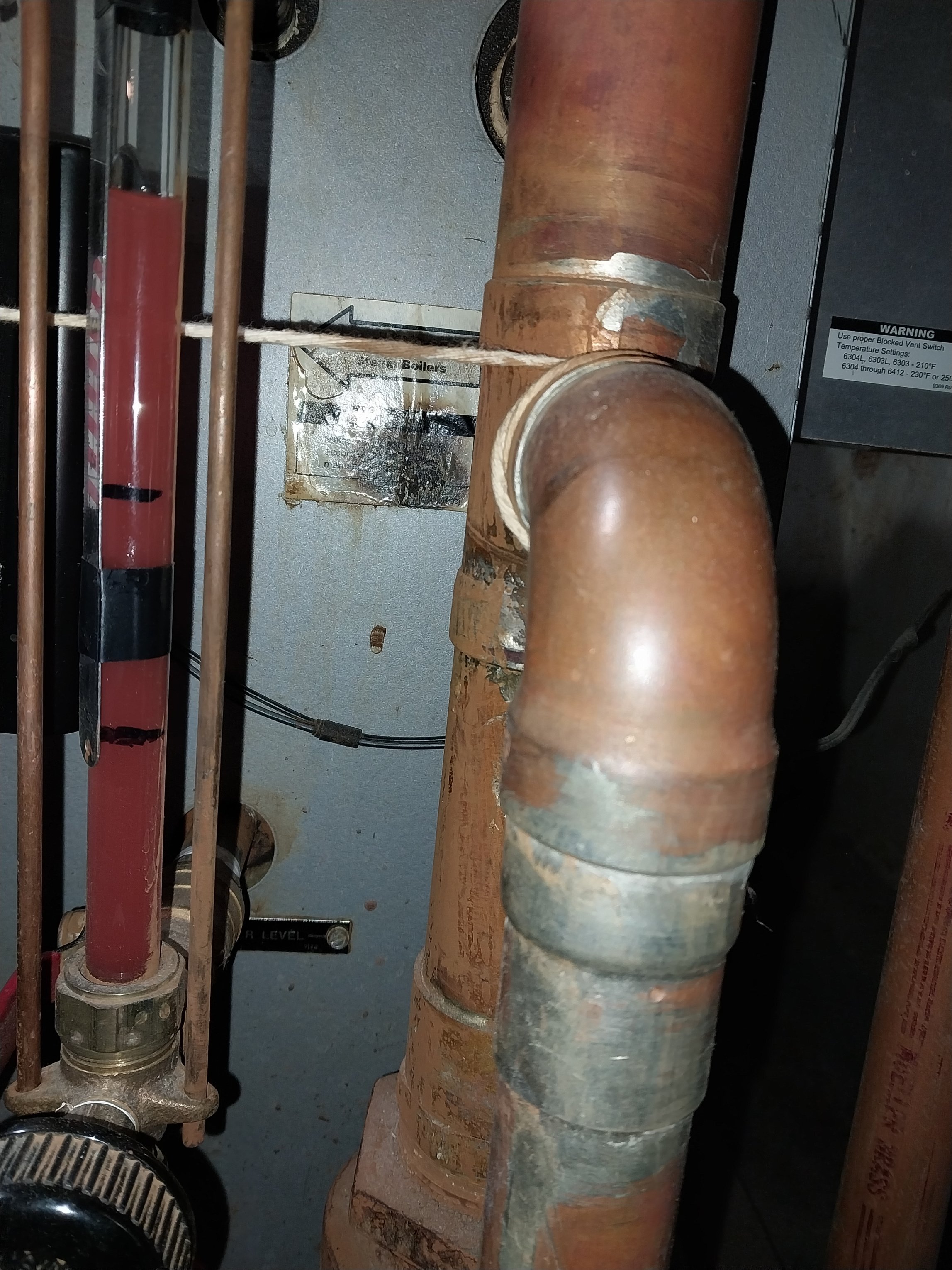

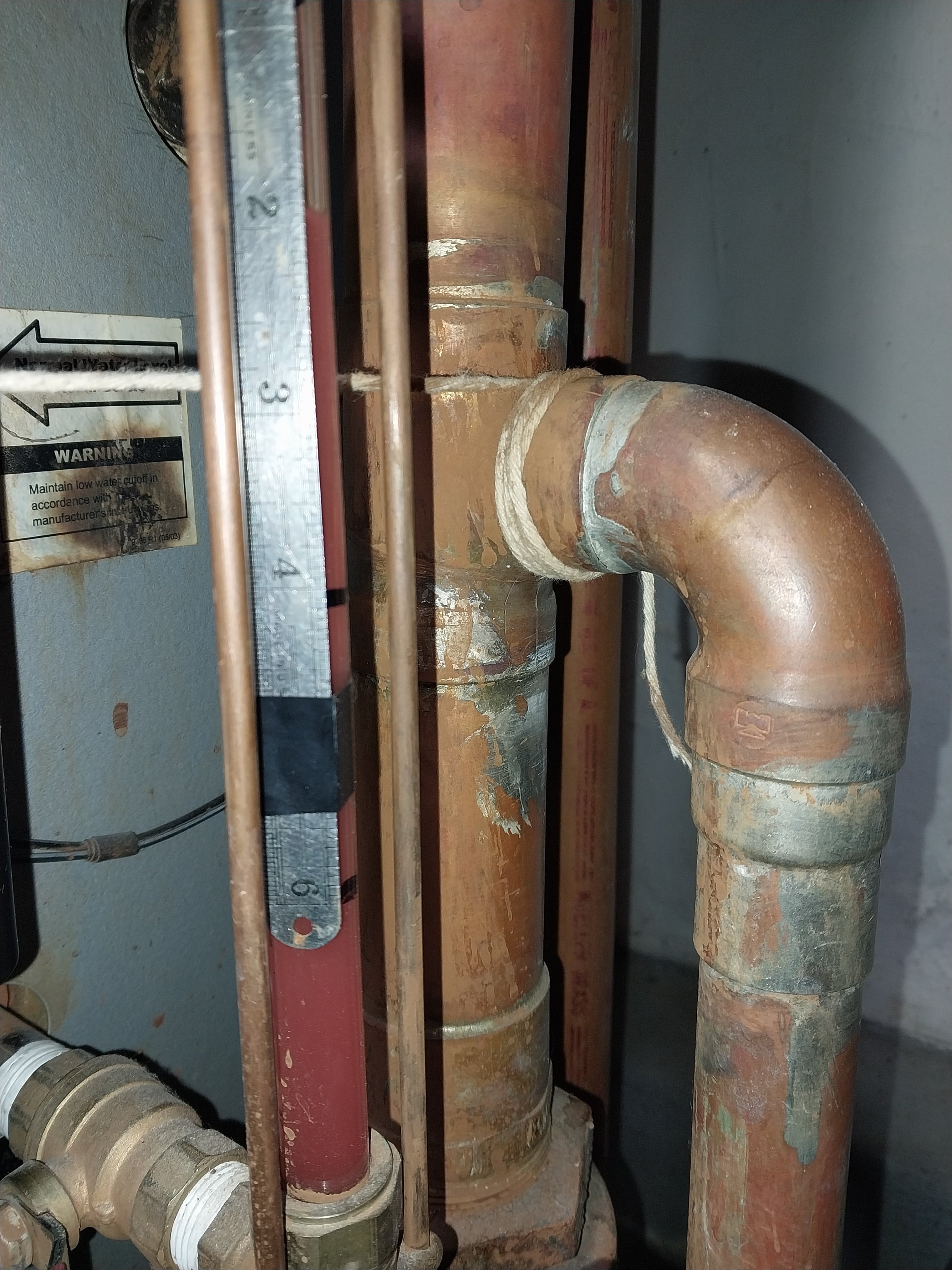

    Let's see some pictures from a couple different angles of the header and the takeoffs from the boiler. There could be something wrong there too, if the installer did what he did with the Hartford Loop.
    Just to make you feel a bit better, my installation is a S show in it's own right, being way too high. I have to keep water level higher because of this and monitor water quality like a hawk, along with too small riser and header etc. etc.

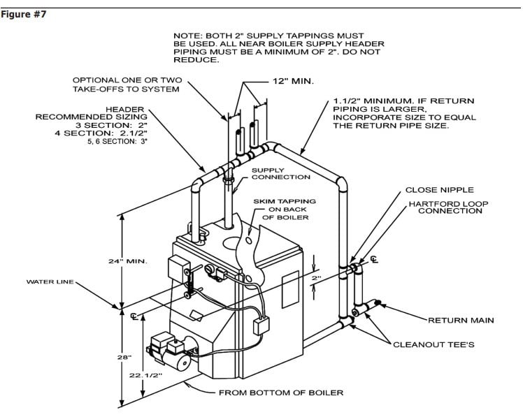

    Here's a Dunkirk Oil Fired Steam Boiler install where they say centerline of Close Nipple is 2 in. below the centerline of the bottom sight glass tapping waterline. Much lower than most people seem to be installing them. It's a safety from dry firing (in the case of a leak in the wet return) for crying out loud, and the 2nd one in line after the LWCO fails. Seems to vary a lot by boiler manufacturer though which may be leading to confusion. Peerless says "Pipe the Hartford Loop such that the top of the close nipple is 2 to 4 inches below the boiler normal water line".
    109A_5 Member Posts: 3,660
    @Captain Who (may be off topic here) These are the first pictures I've seen of your sight glass. You speak of monitoring your water quality, what do you have in that boiler that the water is so murky ? Have you ran it with just clean water in it ?
  • Captain Who
    Captain Who Member Posts: 543
    edited January 24
    This is after I flushed and re-filled with clean pre-boiled distilled treated with Rectorseal 8-way. That's about the target color of light violet to medium violet (normal phenolpthalein pH indicator). 21 year old boiler and I'm not running it without treatment or lousy super hard tap water with high chlorides. It is running very good now with less than 1/4 in. of bounce in the sight glass (good for this boiler install) and no apparent carry over/wet steam issues. System very quiet now. Just a faint whisper from the vents with very little panting. pH seems to be 9.6 from Hydrion paper but I'm waiting for new batteries for my digital meter. The issue is that I have to keep my water level on the high side due to the improper Hartford Loop, which reduces my steam chest, especially with the 2 in. riser and header that was installed when it is supposed to be 2-1/2 in. (= 56% more cross sectional area) and the boiler is not level being tilted so that water level at the takeoff is about 1/2 in. higher than at the sight glass, and the header is tilted upwards towards the equalizer.
