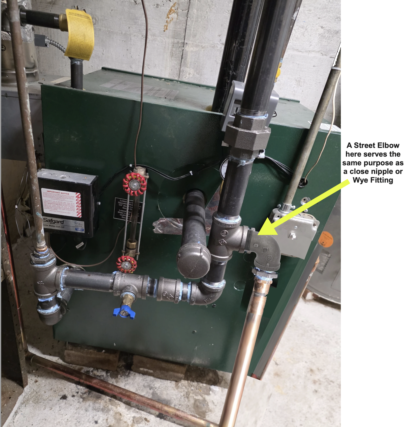

Hello all,
I had my new boiler done a few months ago. I'm experiencing some problems like water hammer, radiator leaking among others.
A plumber told me The Hartford loop is incorrect and he's going to charge me a fortune to fix it. The loop is causing all the problems. I'm not sure I trust this guy.
Is this done wrong or right? Thank you.

    Not the best-looking Hartford loop I have seen but I guess it will work. Take a ruler and check the height off the floor to where the copper tubing comes out of the return tee. Then measure off the floor to the normal water level which is where the boiler MFG marks it or to the center of the gauge glass.
    The copper tubing should be 2"-4" below the normal water level. Yours looks high but It could be the camera angle.
    Post some pictures of the piping above and around the boiler so we can see if you have other issues.
    Why not get the installer back if you need changes and not the plumber?
    Did they measure your radiators when they sized the boiler? Did they skim the boiler.

    Yeah it's wrong. Looks too high to me. As Ed says, the top of the Hartford should be 2 to 4 in. below the normal water line. Also that Tee should be a reducing tee with a Street elbow or a close nipple with an Elbow. With it that long you could get water hammer, especially with it probably being too high.
    I don't think that is the right place to put the shutoff valve in the return which is to allow you to do a no return flush. I would put it in the vertical part just below the elbow in the Hartford.
    edited January 25
    Wrong and may be the cause of the hammer
    It looks like a 8" to 10" long pipe between the copper elbow and the Tee fitting
    You want the pipe here to be as short as possible. A street elbow serves the same purpose as a Wye fitting or a close nipple.

    Let's see some pictures from a couple different angles of the header and the takeoffs from the boiler. There could be something wrong there too, if the installer did what he did with the Hartford Loop.

    Where are you getting the banging? The boiler water is filthy and certainly needs a cleaning and a skimming. I can't imagine the Hartford loop is the cause of the problem, unless the banging is in the Hartford loop itself. First step is certainly clean clean, skim skim..
    mattmia2bigjoe1980
    mattmia2 Member Posts: 17,756
    you have to skim the boiler to get the oil out before it will work right, the sight glass is full of oil, it wasn't skimmed after it was installed. the piping isn't right but may be ok once you get rid of the oil so it isn't surging

    relief valve needs to have its discharge within 6" of the floor and not threaded

    the near boiler piping is wrong so any water that gets pushed out of the boiler by the steam is going to go in to the mains instead of in to the equalizer and back in to the boiler. the lower water level may be helping it separate more before it goes in to the riser that should go to a header but goes directly in to the mains instead.

    Your Hartford Loop is way way too high. In order to keep the waterline 2 in. above that close nipple (I use that term loosely because it ain't), you wouldn't even be able to see the waterline in the glass and it would severely limit the steam chest inside the boiler.
    Looks like a Bullhead Tee header which is a disaster and a huge no no.
    Are the mains sloping upwards away from the boiler, ie. a counterflow supply? Parallel flow would be sloping downwards away from the boiler. If it is counterflow which it appears to be that is compounding the problems because any water coming back into the header will just go down the supply riser, tall as it is, but there is no way it makes it into the equalizer and it just acts to oppose the steam rising and restricting it's flow and making it wetter.
    That equalizer is supposed to be coming off of one end of the header (the downward end because it shold be sloped downwards towards the equalizer) but the way they piped the header with a bullhead tee that wasn't going to work I guess.

    So I understand. My problem is
    1. header is too short
    2. Need to put a close nipple and elbow on hardford loop and possible lower the tee below nwl.
    This is causing water hammer (very loud) and one radiator to always leak through air valve when heat is called instead of steam coming through , it gets water coming thru..

    the header is nonexistent, it is just a pipe straight up with a tee in it. what should happen is the riser out of the boiler should come up make a 90 to a horizontal, it should have 2 tees in that horizontal section, preferably with the branch straight up or at a 45 to each individually connect to the mains, then after those tees it should continue horizontally with ells as needed to get around to a 90 that drops in to the equalizer that drops down to the return with the tee for the hartford loop in there somewhere. the piping above the boiler is far more important for it to operate properly than the hartford loop. make sure all the pipes are at least the size specified in the manual.
    it looks like it is counterflow so there should be drips teed in to the mains that individually drop down and connect to the return before they drop down to the header
