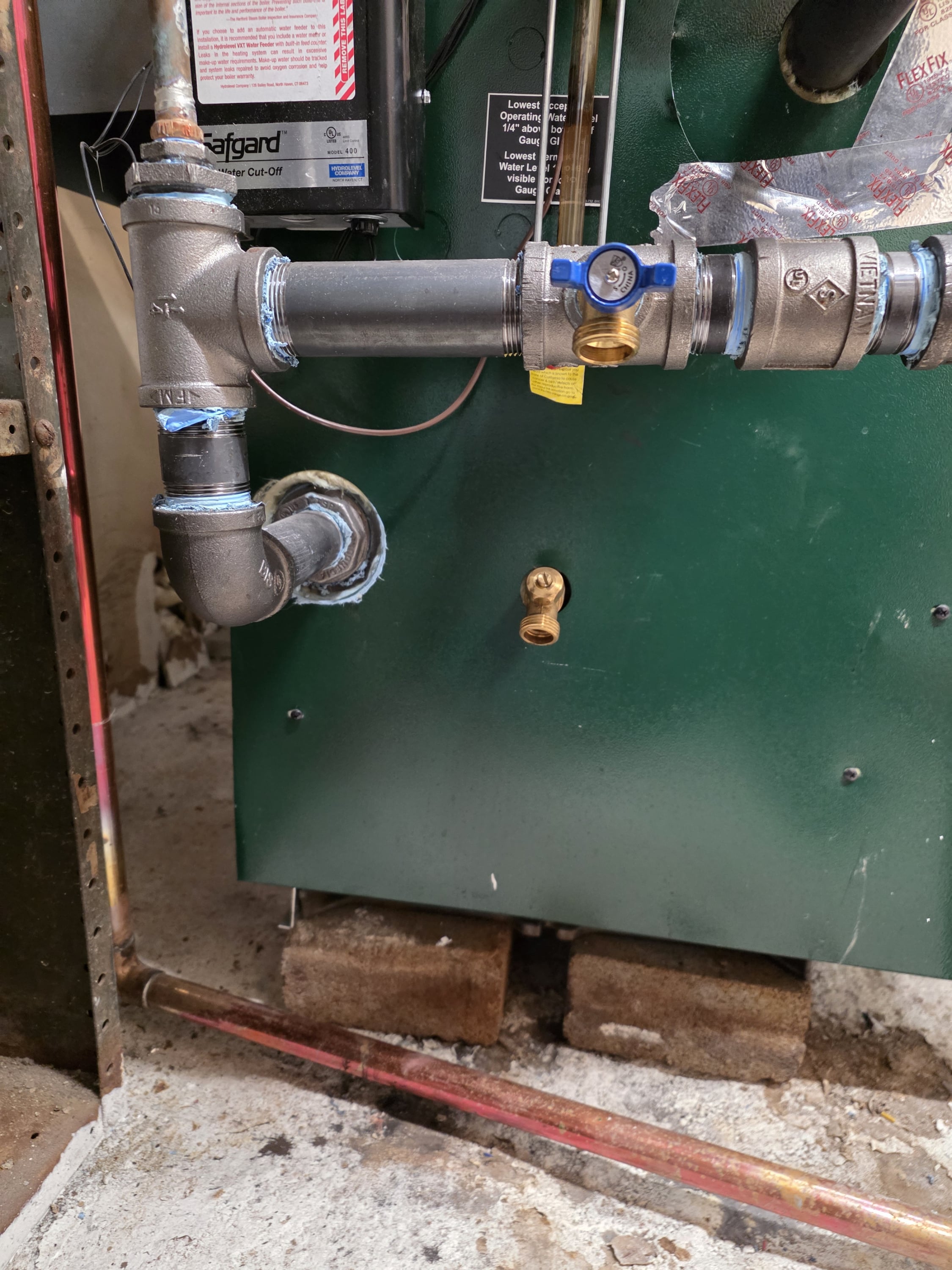

Hello all,
I had my new boiler done a few months ago. I'm experiencing some problems like water hammer, radiator leaking among others.
A plumber told me The Hartford loop is incorrect and he's going to charge me a fortune to fix it. The loop is causing all the problems. I'm not sure I trust this guy.
Is this done wrong or right? Thank you.
PFloro

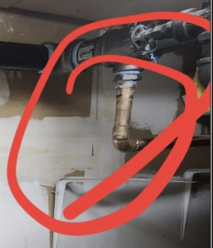

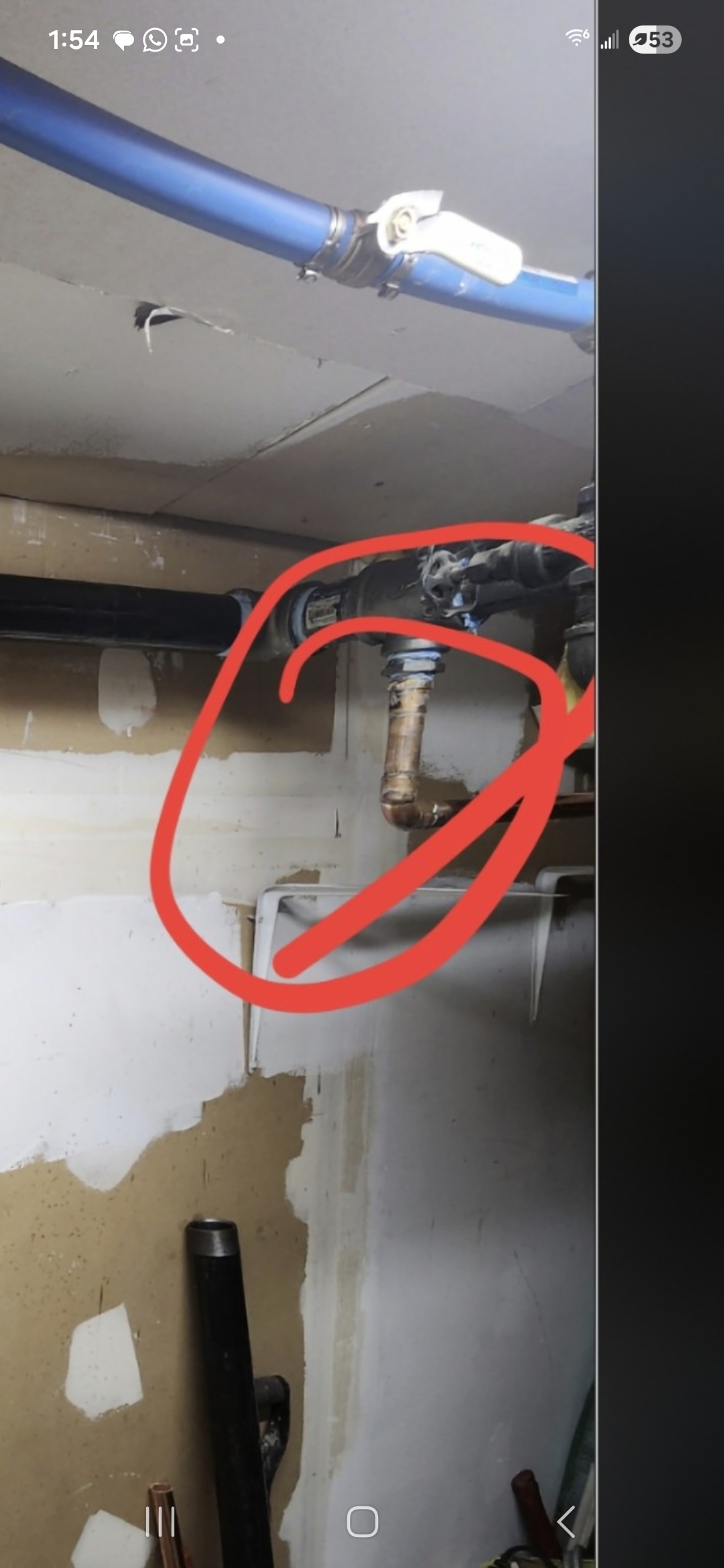

    Not the best-looking Hartford loop I have seen but I guess it will work. Take a ruler and check the height off the floor to where the copper tubing comes out of the return tee. Then measure off the floor to the normal water level which is where the boiler MFG marks it or to the center of the gauge glass.
    The copper tubing should be 2"-4" below the normal water level. Yours looks high but It could be the camera angle.
    Post some pictures of the piping above and around the boiler so we can see if you have other issues.
    Why not get the installer back if you need changes and not the plumber?
    Did they measure your radiators when they sized the boiler? Did they skim the boiler.

    I am just a homeowner, not an expert. But the more I stare at that picture, the more I see things that concern me....

    Yeah it's wrong. Looks too high to me. As Ed says, the top of the Hartford should be 2 to 4 in. below the normal water line. Also that Tee should be a reducing tee with a Street elbow or a close nipple with an Elbow. With it that long you could get water hammer, especially with it probably being too high.
    I don't think that is the right place to put the shutoff valve in the return which is to allow you to do a no return flush. I would put it in the vertical part just below the elbow in the Hartford.

    Wrong and may be the cause of the hammer
    It looks like a 8" to 10" long pipe between the copper elbow and the Tee fitting
    You want the pipe here to be as short as possible. A street elbow serves the same purpose as a Wye fitting or a close nipple.

    Listen to this story and you will hear the explanation of why your Hartford loop is wrong at about time stamp 4:24. I recommend you listen to the entire story but your info is at 4:24
    And as the other ED said it might be too high. Two Eds are better than one

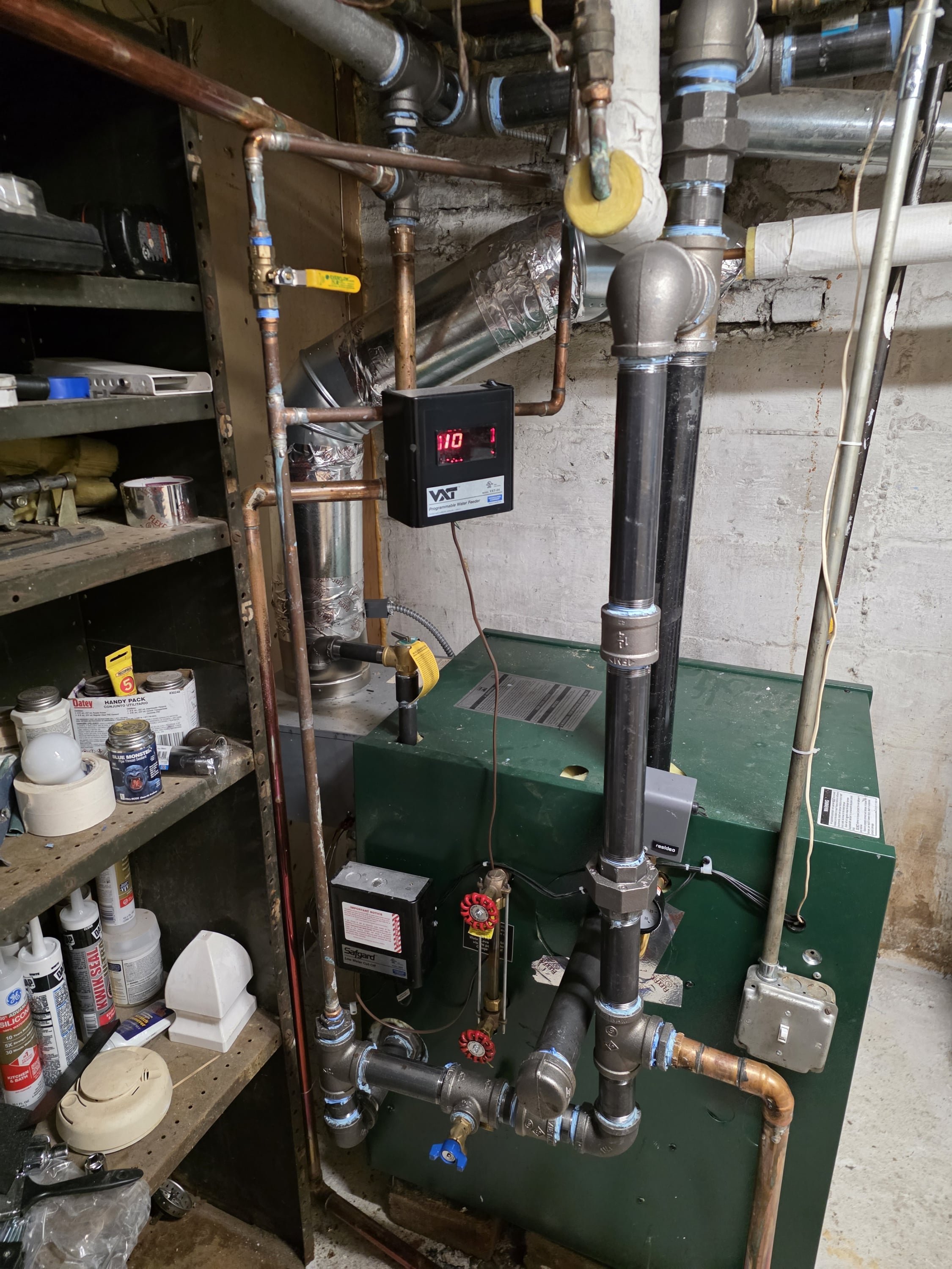

    Let's see some pictures from a couple different angles of the header and the takeoffs from the boiler. There could be something wrong there too, if the installer did what he did with the Hartford Loop.
    Just to make you feel a bit better, my installation is a S show in it's own right, being way too high. I have to keep water level higher because of this and monitor water quality like a hawk, along with too small riser and header etc. etc.

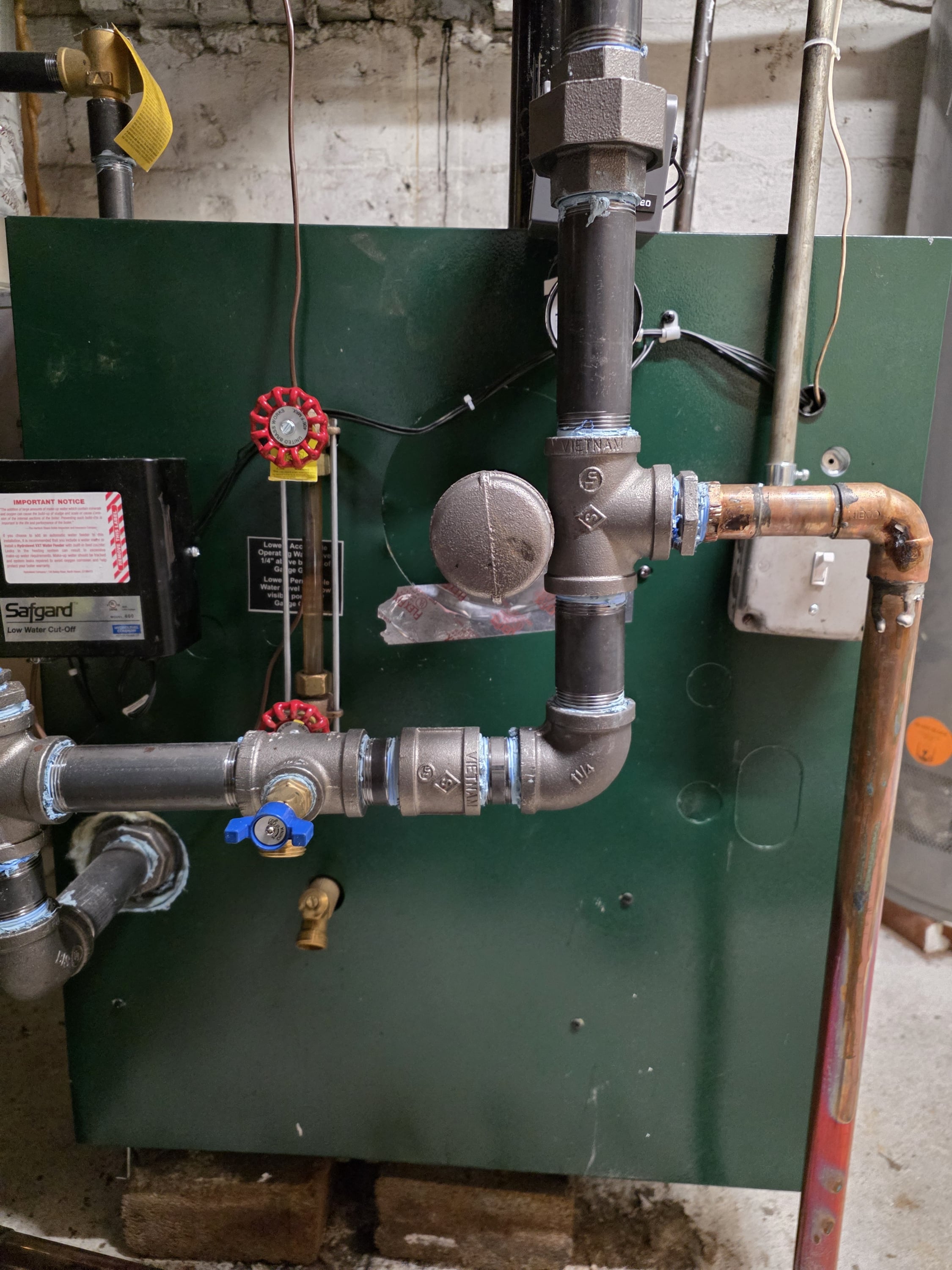

    Definitely looks like the Samsonite gorilla got drunk and threw pipe and fittings against the wall and then started putting that mess together.
    Is the boiler power switch attached to an exposed ceiling joist?
    Having the both the pressure gauge and pressuretrol obstructed by pipe is not safe in my opinion as you cannot simply look at them and you would become complacent and simply forget them.
    Is this steam boiler gas fired? The power switch is not visible, is it at the front of the boiler behind a cover?
    I hope the power is for the boiler is not direct wired in that junction box.
    I hope you get that mess fixed. IN MY opinion a plumbing inspector may tag it because the pressuretrol and pressure gauge cannot be seen easily.

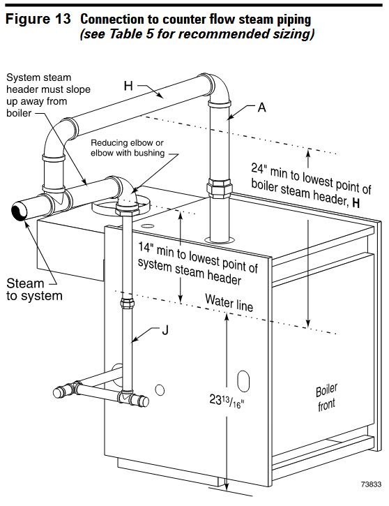

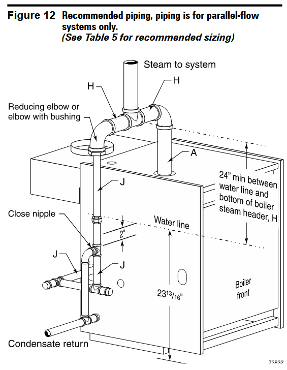

    Here is Dan Halohan's specific language in that video (thanks for bringing my attention to it again)
    @1 :20 The wet gravity return line, which returns the condensate from the system, rises up from the floorto join the equalizer at a point about 2 in. below the boiler's lowest operating waterline.
    @3 :34 The point where the loop connects to the boiler's equalizer is higher than the boiler's “crown sheet”, and that's what provides the safety.
    @5 :07 Generally you should connect the close nipple about 2 in. below the bottom of the gauge glass, but check the boiler manufacturer's spec. on this. The centerline of the close nipple has to be below the waterline, but above the boiler's crown sheet. And don't install the close nipple 2 in. below thec enter of the gauge glass because that's probably too high. You see when the water leaves the boiler as steam the level in both the boiler and the equalizer will drop, If it drops below the close nipple, steam will push down through the equalizer into the wet return and create water hammer. This usually happens near the end of the firing cycle and it causes a very noticeable racket.

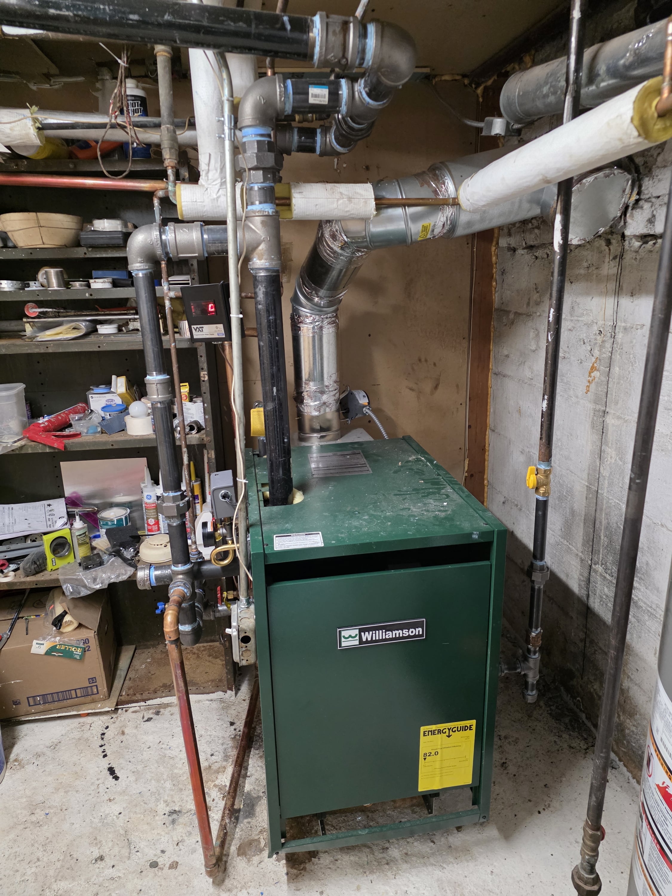

    do you have a picture of the entire install? Curious to see what the header looks like, based on what the other near boiler piping looks like it can't be pretty

    Here's a Dunkirk Oil Fired Steam Boiler install where they say centerline of Close Nipple is 2 in. below the centerline of the bottom sight glass tapping waterline. Much lower than most people seem to be installing them. It's a safety from dry firing (in the case of a leak in the wet return) for crying out loud, and the 2nd one in line after the LWCO fails. Seems to vary a lot by boiler manufacturer though which may be leading to confusion. Peerless says "Pipe the Hartford Loop such that the top of the close nipple is 2 to 4 inches below the boiler normal water line".

    Where are you getting the banging? The boiler water is filthy and certainly needs a cleaning and a skimming. I can't imagine the Hartford loop is the cause of the problem, unless the banging is in the Hartford loop itself. First step is certainly clean clean, skim skim..
    mattmia2bigjoe1980
    you have to skim the boiler to get the oil out before it will work right, the sight glass is full of oil, it wasn't skimmed after it was installed. the piping isn't right but may be ok once you get rid of the oil so it isn't surging
    bigjoe1980
    relief valve needs to have its discharge within 6" of the floor and not threaded

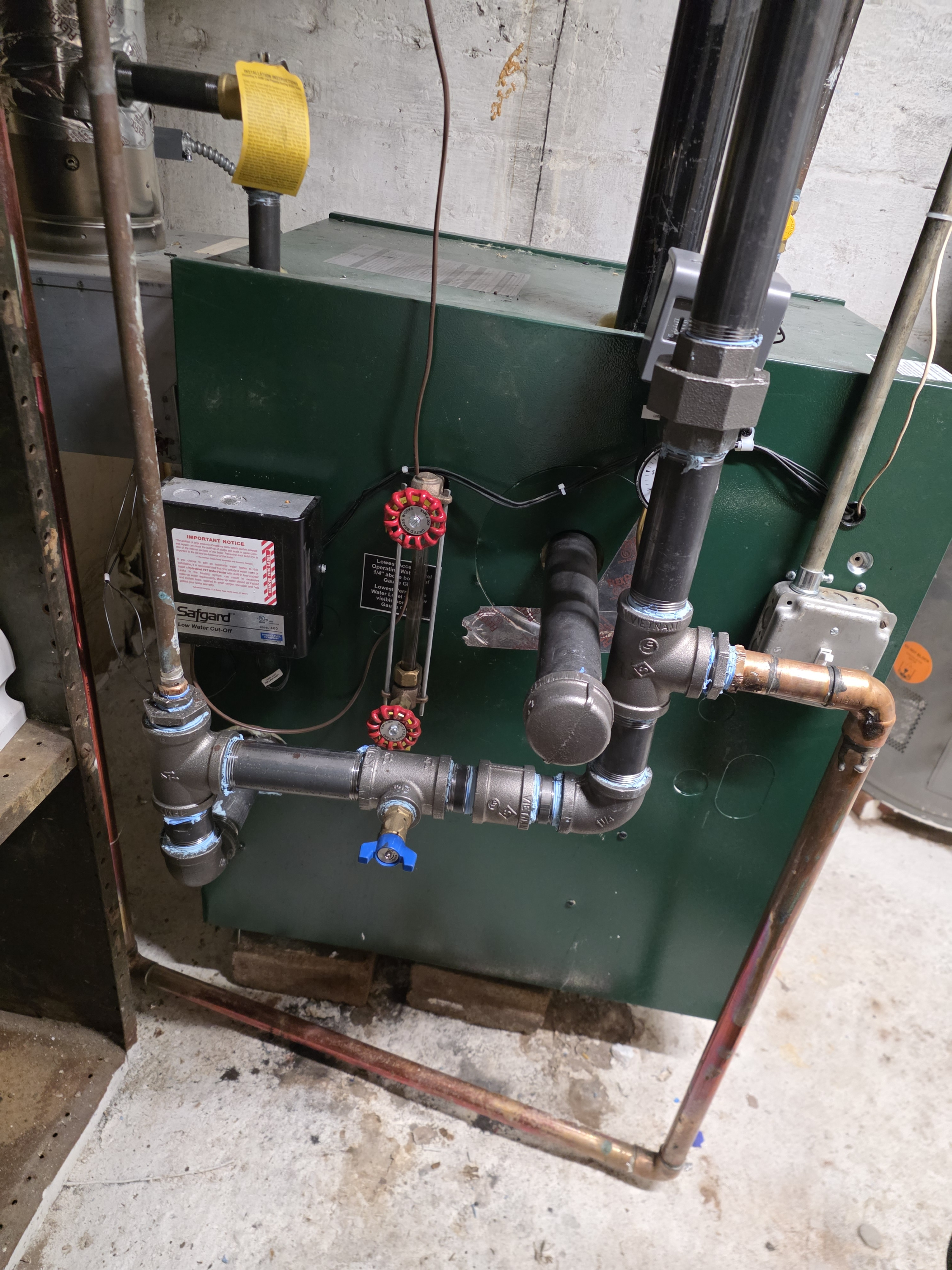

  • I am adding some additional pictures. Updates:
    1. I have replaced all my air valves with plumbers edge air valve from home depot.
    2. I notice after I drain water from boiler, I don't get the water hammer sounds but after a few days it comes back especially with one radiator that's in the back of the house. And that radiator always leaks a lot of water after that.
    3. Looks like my return tee is not above the sight glass. It's about in the middle as seen in the picture.
    Thanks all.
    the near boiler piping is wrong so any water that gets pushed out of the boiler by the steam is going to go in to the mains instead of in to the equalizer and back in to the boiler. the lower water level may be helping it separate more before it goes in to the riser that should go to a header but goes directly in to the mains instead.

    Your Hartford Loop is way way too high. In order to keep the waterline 2 in. above that close nipple (I use that term loosely because it ain't), you wouldn't even be able to see the waterline in the glass and it would severely limit the steam chest inside the boiler.
    Looks like a Bullhead Tee header which is a disaster and a huge no no.
    Are the mains sloping upwards away from the boiler, ie. a counterflow supply? Parallel flow would be sloping downwards away from the boiler. If it is counterflow which it appears to be that is compounding the problems because any water coming back into the header will just go down the supply riser, tall as it is, but there is no way it makes it into the equalizer and it just acts to oppose the steam rising and restricting it's flow and making it wetter.
    That equalizer is supposed to be coming off of one end of the header (the downward end because it shold be sloped downwards towards the equalizer) but the way they piped the header with a bullhead tee that wasn't going to work I guess.

  • Thank you all for your help.
    So I understand. My problem is
    1. header is too short
    2. Need to put a close nipple and elbow on hardford loop and possible lower the tee below nwl.
    This is causing water hammer (very loud) and one radiator to always leak through air valve when heat is called instead of steam coming through , it gets water coming thru..

    the header is nonexistent, it is just a pipe straight up with a tee in it. what should happen is the riser out of the boiler should come up make a 90 to a horizontal, it should have 2 tees in that horizontal section, preferably with the branch straight up or at a 45 to each individually connect to the mains, then after those tees it should continue horizontally with ells as needed to get around to a 90 that drops in to the equalizer that drops down to the return with the tee for the hartford loop in there somewhere. the piping above the boiler is far more important for it to operate properly than the hartford loop. make sure all the pipes are at least the size specified in the manual.
    it looks like it is counterflow so there should be drips teed in to the mains that individually drop down and connect to the return before they drop down to the header
