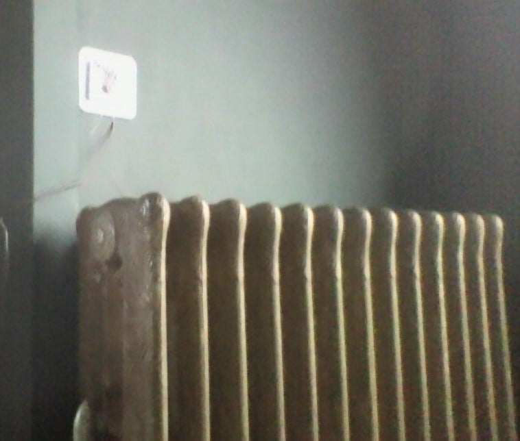

    Yesterday, I moved the controlling t-stat to six inches above the end column of the 13 column, 75EDR, radiator.
    Evidently, this works.
    I got up in the middle of the night, the t-stat read 70, the room felt warm, and the radiator was warm to the touch. I checked three times, all three times same result.
    I wonder what would happen if I turn the t-stat down a degree. probably need to turn of the entire system off to reset to a different temperature.
    So I have one t-stat to turn the entire system on. (Primary and secondary)
    one (Digital) to set the room. but this one does not move. it is too far from the radiators. It will allow me to turn the heat up, I do not know about down. With the primary producing 75k input, output should be 62k with 82 EFU. The radiators currently running, at design temp of -40, I have 68k, or 227 EDR. The basement, before I turned on the boiler was 41 degrees. now, about 68. lots of heat escaping from the pipes. the point is that I am supplying slightly less than what the house is using when only the primary is running.
    The third t-stat, pictured here, simply tells the secondary, 200k to turn on for a few minutes. it is connected in parallel to the second t-stat
    I will give it a few more weeks, but so far, 24 hours, it seems to work.
