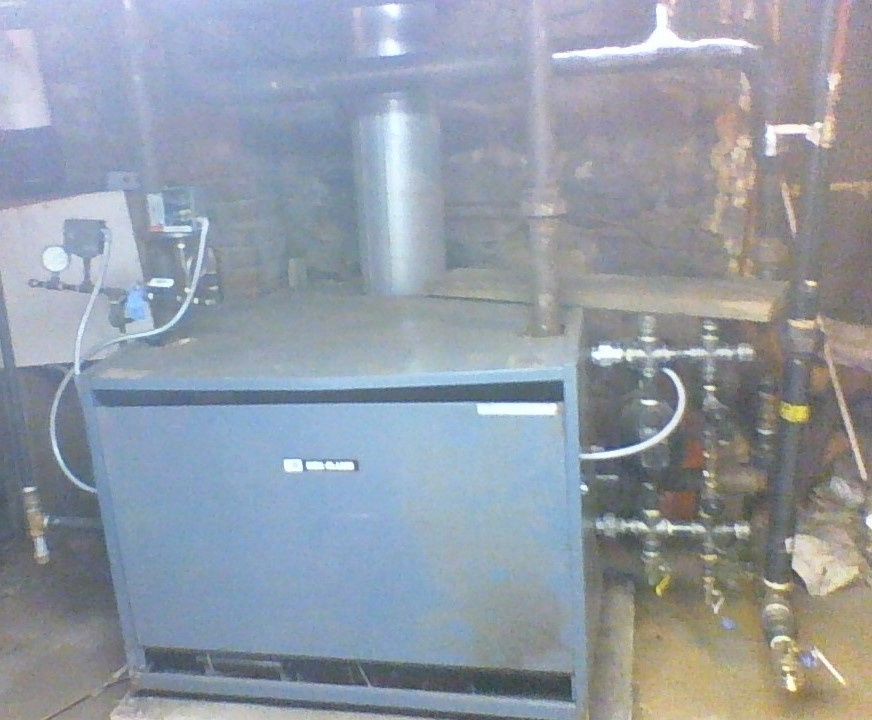

    Okay, here is the stark photo. Funny how pictures tell the reality and not the image I have in mind.
    Here are the details: Two 2" risers, Max output: 875 sq ft steam, or 215 lbs per hour. Elevation 1000 ft. I am using 26.78 cu ft / lb steam at startup.
    Rate of steam rising out of the 2" risers: 34.3 ft / sec. Risers rise 45" above the water line, travels eight inches then drops 14". Speed in the first part of the three-inch header is 15.6 ft/sec. the second part is 31.2 ft/second.
    The diagonal pipe coming out of the header is a steam separator taken from the book "Superheater" from the Superheater company, Chicago Illinois, I do not remember the printing date. The book and the library from which I borrowed it no longer exists. It is the "hump" found on steam engines. I always wanted to build one, so there it is. Dan mentioned something like this on page … well somewhere where some old timers place a copper kettle before the main. It is a separator. In this case I made it out of a two-foot 6" pipe, with a specified takeoff about two thirds the distance, the takeoff has a slit in the pipe I will have to draw a picture.
    The speed of steam in this separator is 8 ft/sec.
    The steam then exits into the 3" main at 31.2 ft / sec.
    This wraps around the house as old coal mains did, reducing to 2" when the speed drops to 12.5 ft/sec in the three-inch main. The speed then increases to 24.5 ft/sec in the two-inch main.
    Through the doorway, you can see the 14th riser. then the end tee for the end of main vent. It just happens to return between the boiler risers, and the drop header. comes to the near side of the boiler where it drops into the 2" Hartford loop, then the equalizer.
    The hope is to reach the ideal where Dry steam leaves the header at 215 degrees, and Saturated water returns through the Hartford loop at or near 212 degrees.
    The water makeup enters at the Hartford loop through a 3/8ths manual valve take from the hot water heaters. this will drive some of the calcium and oxygen out of the makeup water. I do not presently have a water softener, but it is in the plans. the hot water will of course be softened. The city water is alkaline at about 8 or 9 ph.
    I need a few more hangers, and when it is tested, insulation.
    However, my time for this winter project is up. I will be working overtime for the next month. after which time, I need to get my upstairs projects finished. (like the roof). So, since I still have a leak in the boiler sections, and i took another look at the scale, I will disassemble it again and give it an acid bath. A dirty boiler is not only inefficient, but dangerous. Why install all these energy efficient devices then use a boiler with a quarter inch scale in it? No. got to do it right.
    I must admit however, all the water I have placed in her to test it has loosened the scale some.
    I still have a long way to go. I have the new burners, but only half the trim. and I wonder if using the old is worth it. maybe get all new and lose any worry.
    ethicalpaul Posts: 9,035
    My advice, don't over-focus on the math. Just see how close to the manufacturer's recommendation the pipe is. They did the math. It's been running for decades, I wouldn't mess with the pipes until you replace the boiler. I just realized you replaced a section in this boiler? I would be highly nervous about the viability of that…another section could be about to go after all. But I wish you the best result!

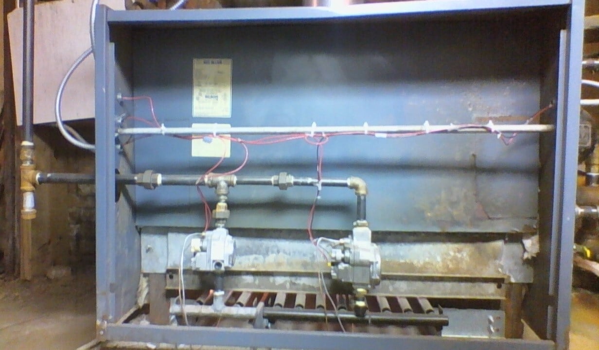

    The EGH also has a burner and base shield. I do not remember this. and was unsuccessful at locating the old burner tray in my scrap heap. again, not part of the EG, but part of the EGH series 5.
    I will welcome comments of this and what is it?
    The EGH Figure 7a page 11, now has a single rear base panel and refractory. however, I have a panel and a channel. I was able to clean and restore the original parts. Is this a "new and improved", difference in the upgrade to the series 5"

    I am still using the rebuilt EGH85, boiler but in replacing the burners, (they were ruined) I downsized the burners. so oversized boiler, undersized burners.
    The building was originally coal fired. In coal fire, the boiler stayed on all day, possibly running a vacuum at night. here, I have a lack of knowledge, I think the vents were different. but I would like to duplicate this where the boiler stays on meeting the heat load of the building.
    Because I live in an area were we have a 150 degree temperature swing, with winds ranging from zero to ninety, coming from any direction, a one size fits all heat system… well, what works one day, will not work the next.
    As a high pressure boiler operator, from a factory where the heat load would vary according to the time of day, I kept the boilers balanced according to load. I want to do the same thing here.
    My The Weil-Mclain EGH85 does not offer a duel burner, so I replaced the original with what will become a duel burner system. The objective is for the first burner to stay on at temperatures of thirty degrees and below, with the second cutting in and out between freezing to minus forty.
    Dan covered very well how oil fired systems need to breath. and need adequate air vents. However, I am going the other way, trying to duplicate the coal fire where the boiler is on all the time. (therefore, I am guessing)

    Today was a good day. most of the trim is on, and the gas valves are installed. I am waiting for two parts and should be ready to test it next Saturday. Then I can lay it up wet and start on the fourteen risers.

    The question today concerns wiring. What is the best wire to use at the gas valves and around the trim work? Do I need high temperature wiring?
  • cgutha
    cgutha Posts: 152
    I found the schematics on the front cover. all wires are indicated to be black. I will use 14g THHN. that is good for 600 degrees.

    The old transformer weighed in at 27.8 volts. Rather than risking my gas valves, I bought a new one which is rated at 24 volts, but I am running 120 volts input not 110, so it is a little high. β€” 60 v-a.
    I "bench tested" the boiler today.
    That is, I isolated the boiler at the king valve and ran it up to temp. The first thing I noticed is that I had a burner that did not light. I guess, letting them sit for a year or so, means the orifice needs cleaning. Got that working.
    The second stage did not light at all. This is the old original gas valve, but the pilot lit so I checked the voltage. I bypassed the vaporstat. All burners lit. I will leave the vaporstat problem for later.

    Let me give you a tour.
    The boiler body is a EGH 85 Weil-Mclain. 400,000 BTU input. Which, I am certain was needed before I insulated the house. The boiler leaked. the burners were toast. the right section cracked. I chose to rebuild the boiler rather than buying new. Whether or not I chose wisely is immaterial at this point.
    I replaced the burner with two burners: EG-30, and EG-55. I was suppose to order the 35, but I messed up. That would have been 4 burners and 8 burners. I have 3 and 8. These replace the fourteen of the EGH85. Oh, I also went with standing pilots. some people say that it is a waste to have a standing pilot. Let me ask something. Where does the pilot heat go?
    Stage one burner is controlled by the pressuretrol, Stage two by the vapor stat. At present, I am running three pounds minus 6 oz. That is the way it came out of the box.
    I had a couple of float valves laying around, so I used them. I also have two electronic low water controllers, but the one I installed made sparky noises, so I removed it for now. I will try the other one later. I will probably revert to running two floats. duplicating the float and sight glass on the other (left) side. This will allow me to supply a battery backup with the load being only two 20ma valves as the electric load.
    I quick tour upstairs leads me to believe I have a cracked radiator with a valve that will not close, also, another problem in another room.
    end of test,
