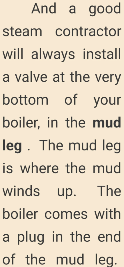

Is the valve where I drained in my quoted post the same as the "valve at the bottom of the mud leg" mentioned in the book?
What does a mud leg look like?
