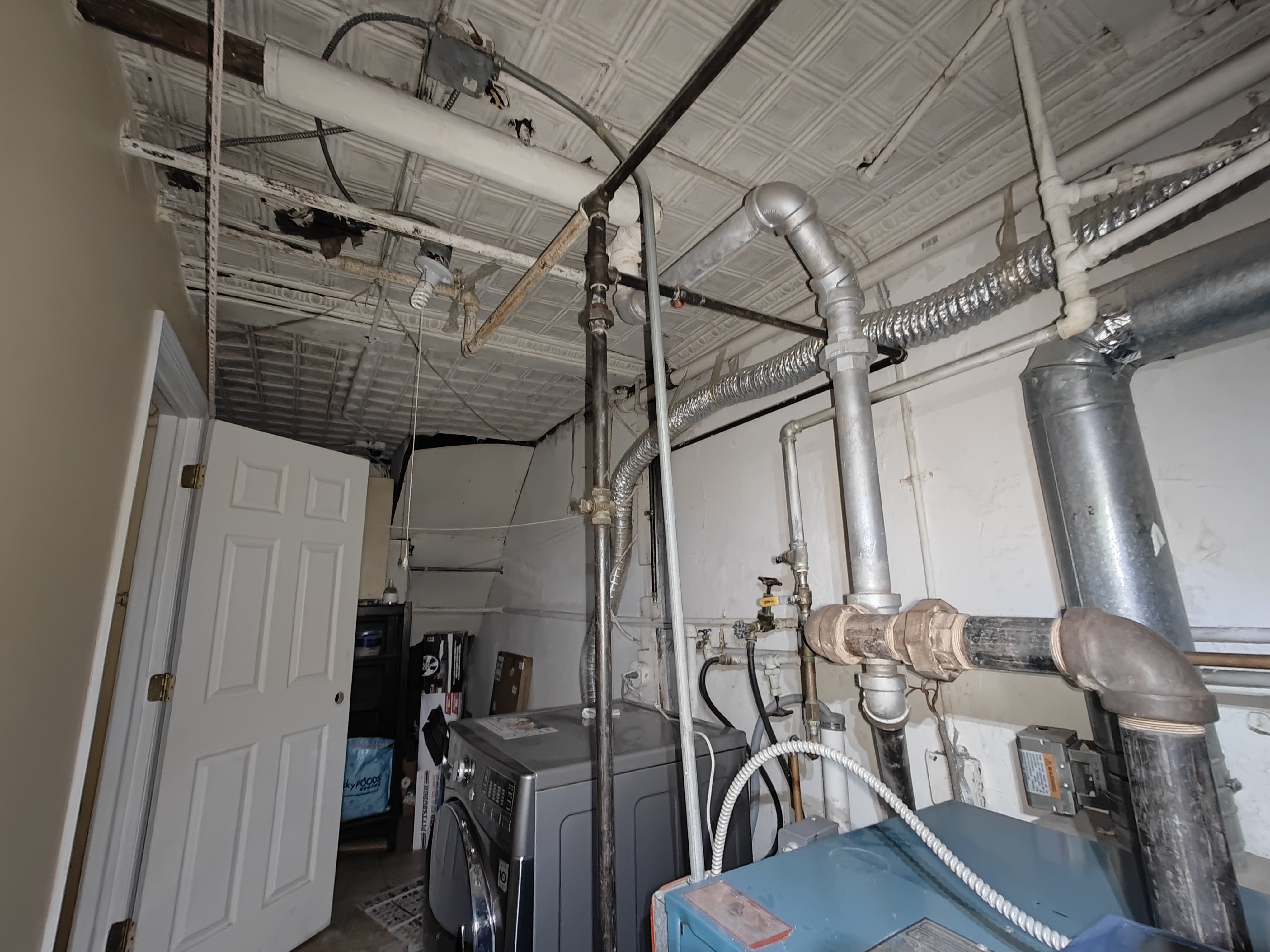

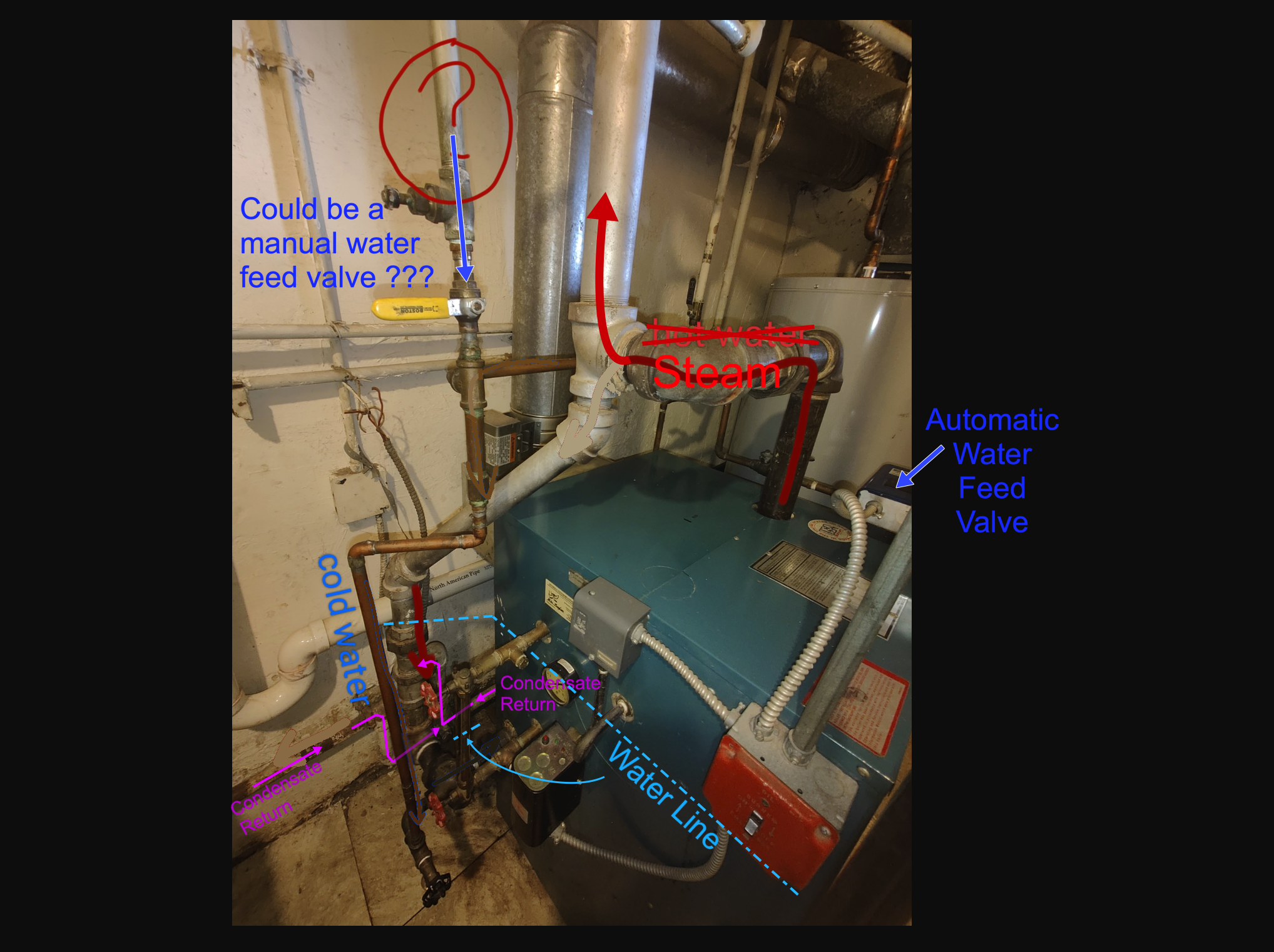

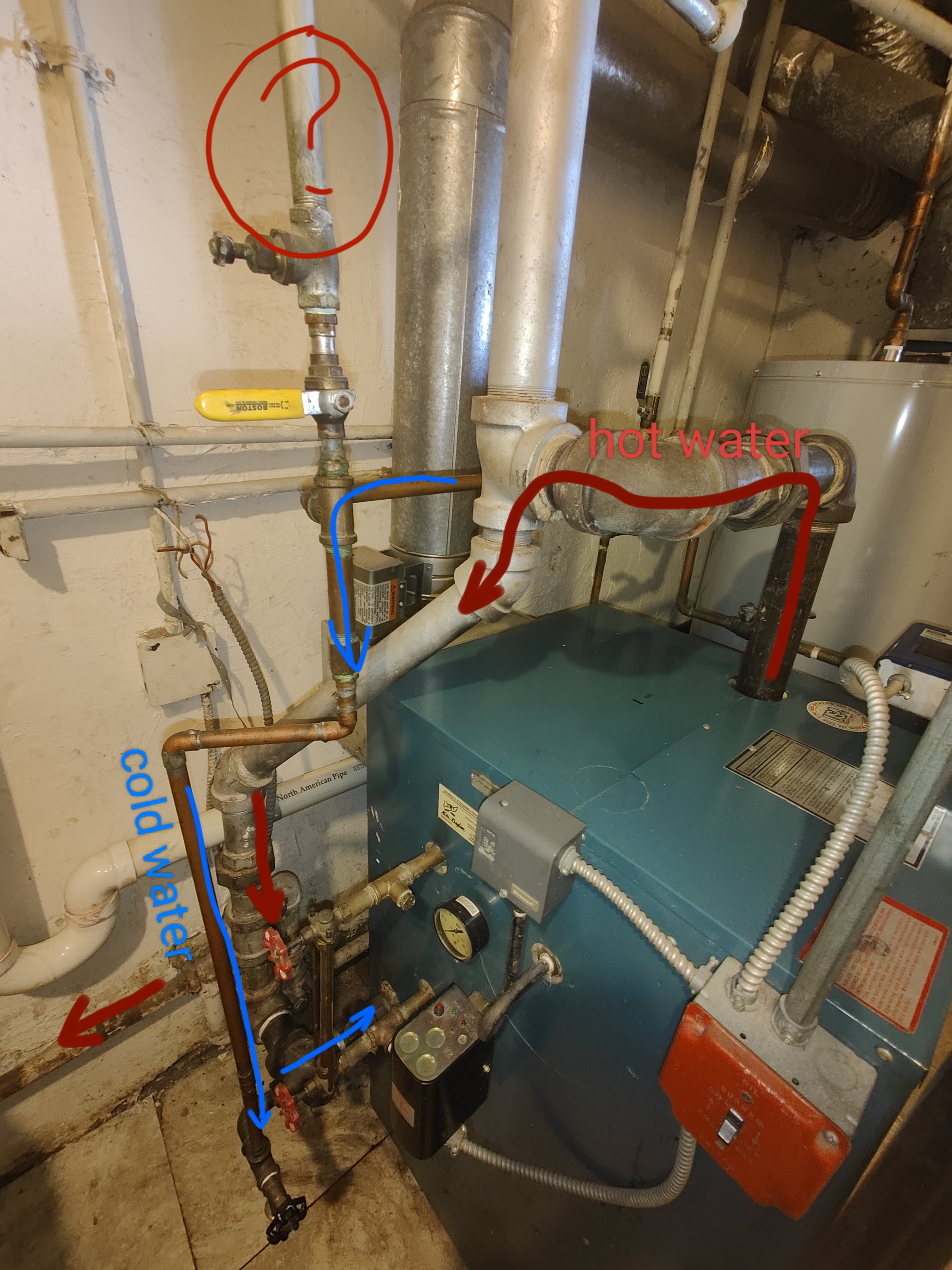

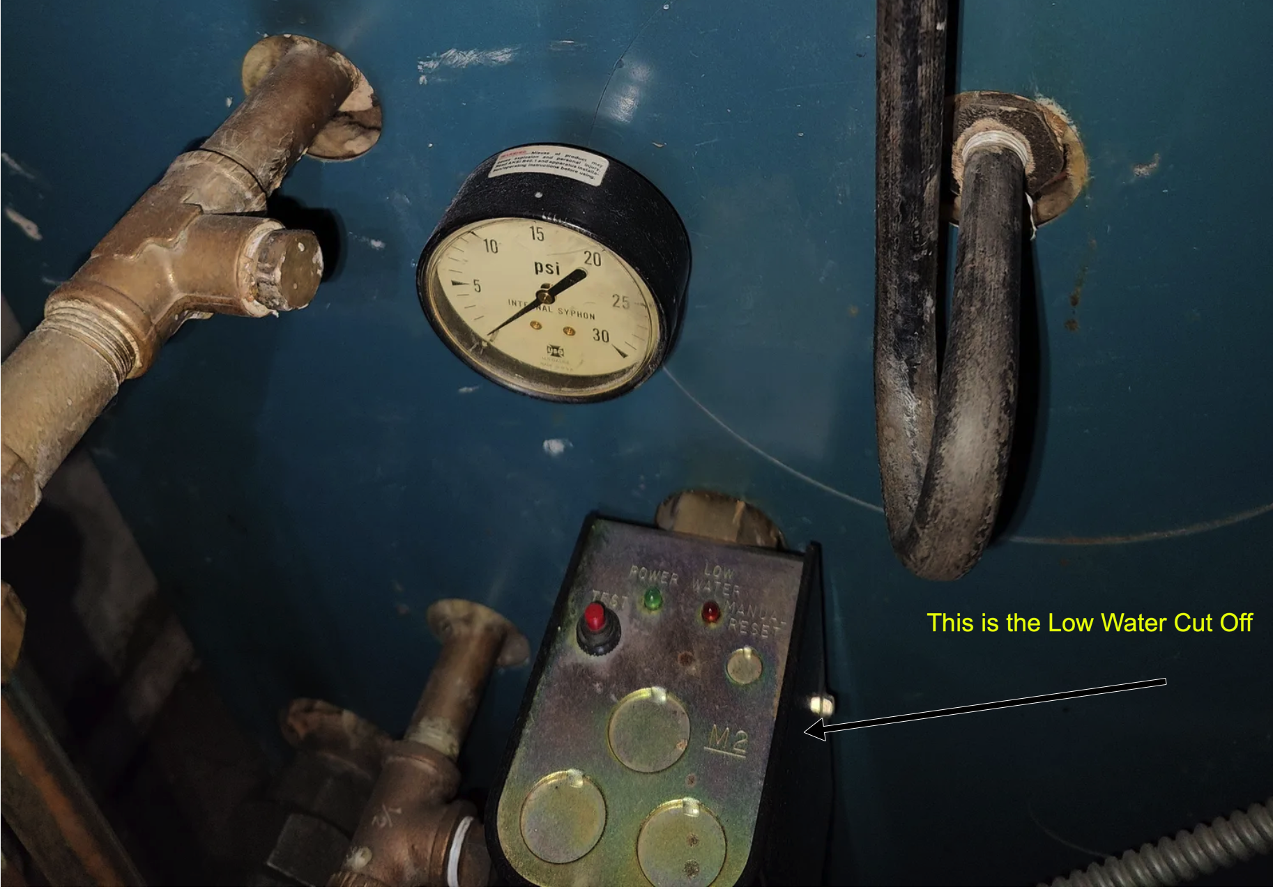

I have an old Burnham boiler made more than 30 years ago. The manufacturer did not respond to my inquiry for the user manual, so I'm posting my questions here.

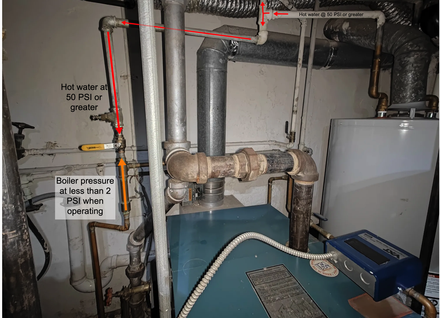

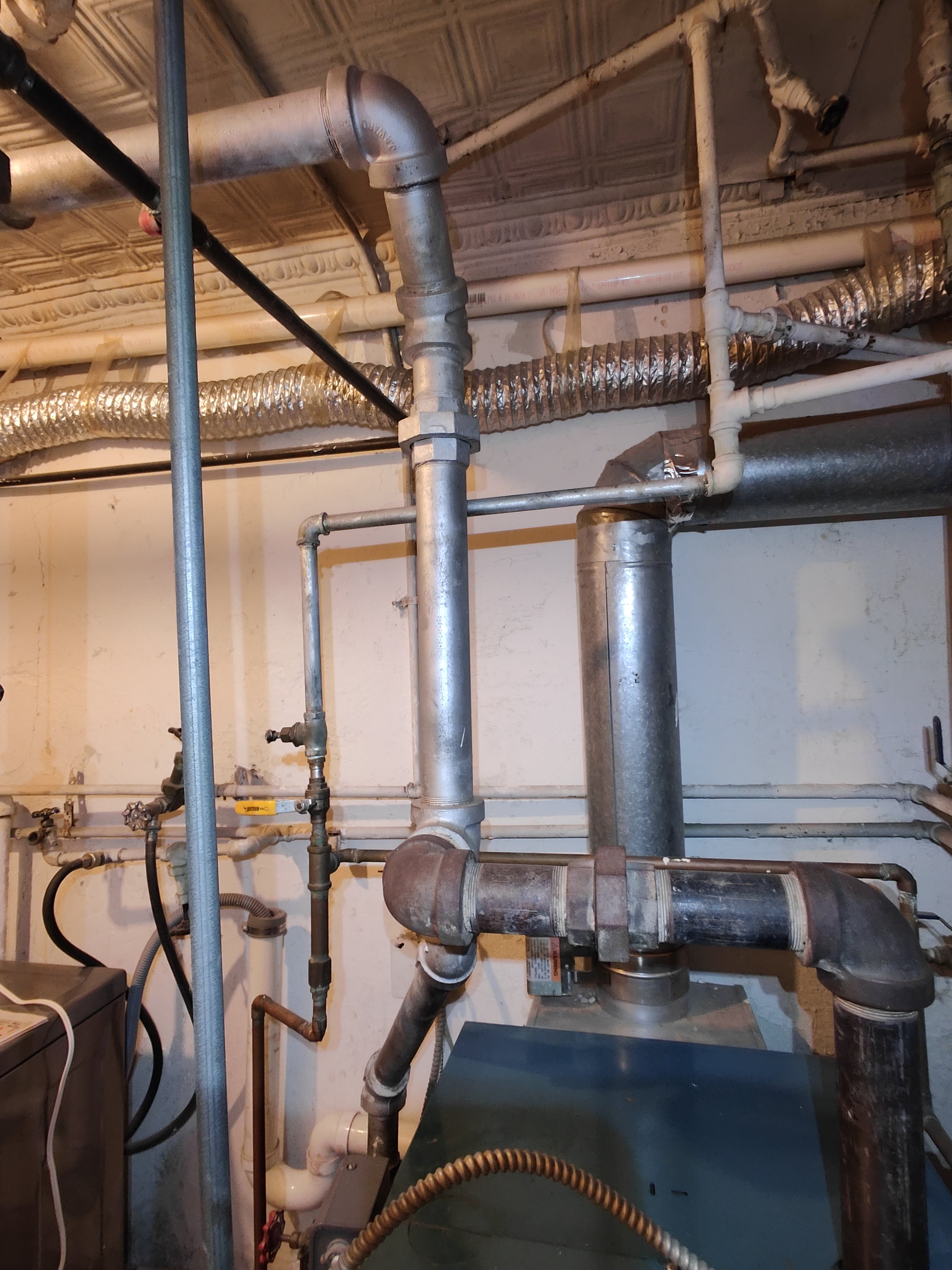

I have marked the water flow direction based on my understanding. The pipe where I marked "hot water" should be hot steam output, but further splits left me confused on what is going where.
How to turn on this boiler for a test run?
Thanks
The pipe circled with the question mark is closed off by the ball valve with the yellow handle. If you are new to this boiler I would recommend getting in a professional to walk/talk you thru everything.
The valve is closed for a reason. Maybe your coil is bad and it will immediately over pressure/flood the boiler.3 -

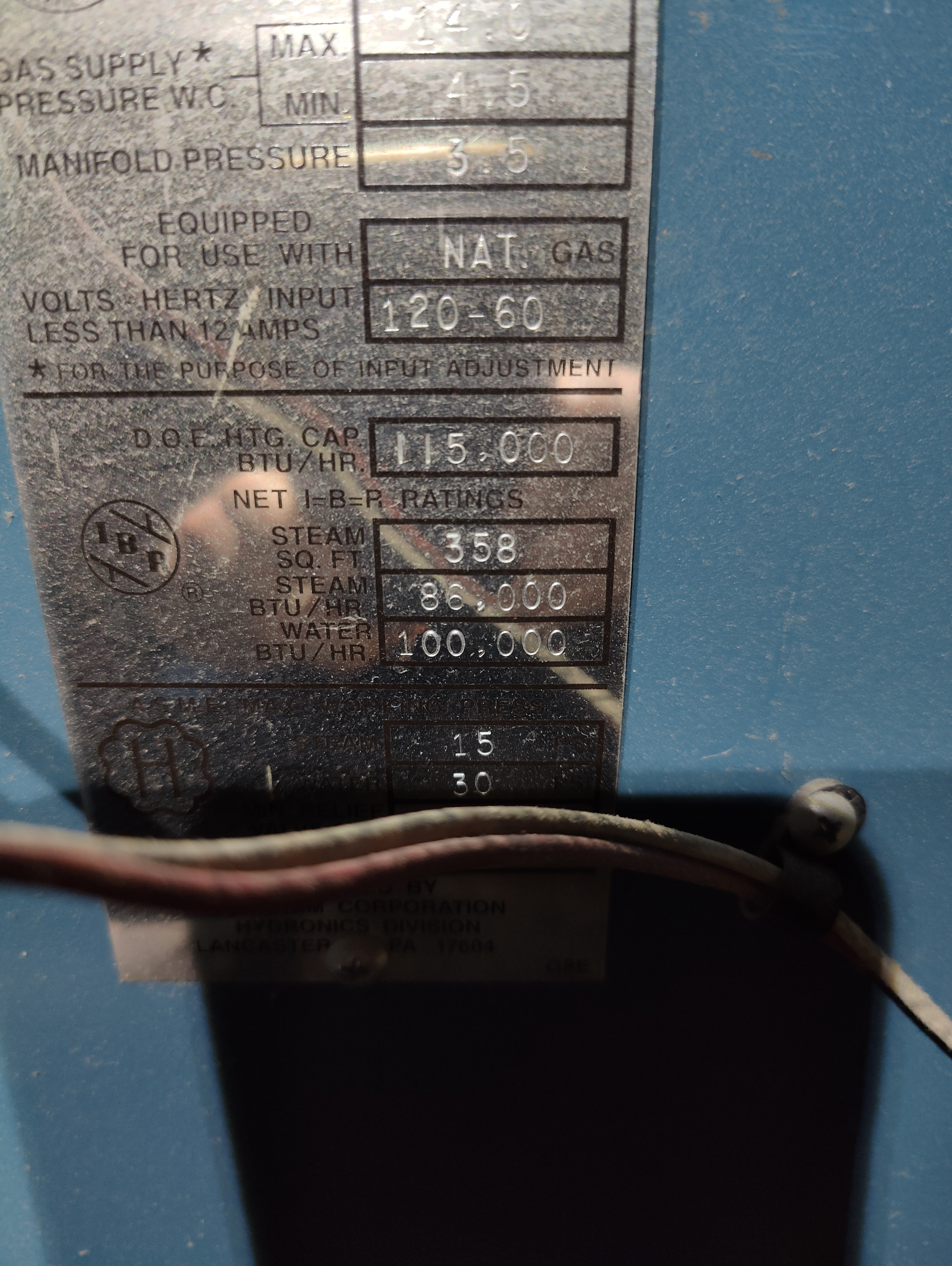

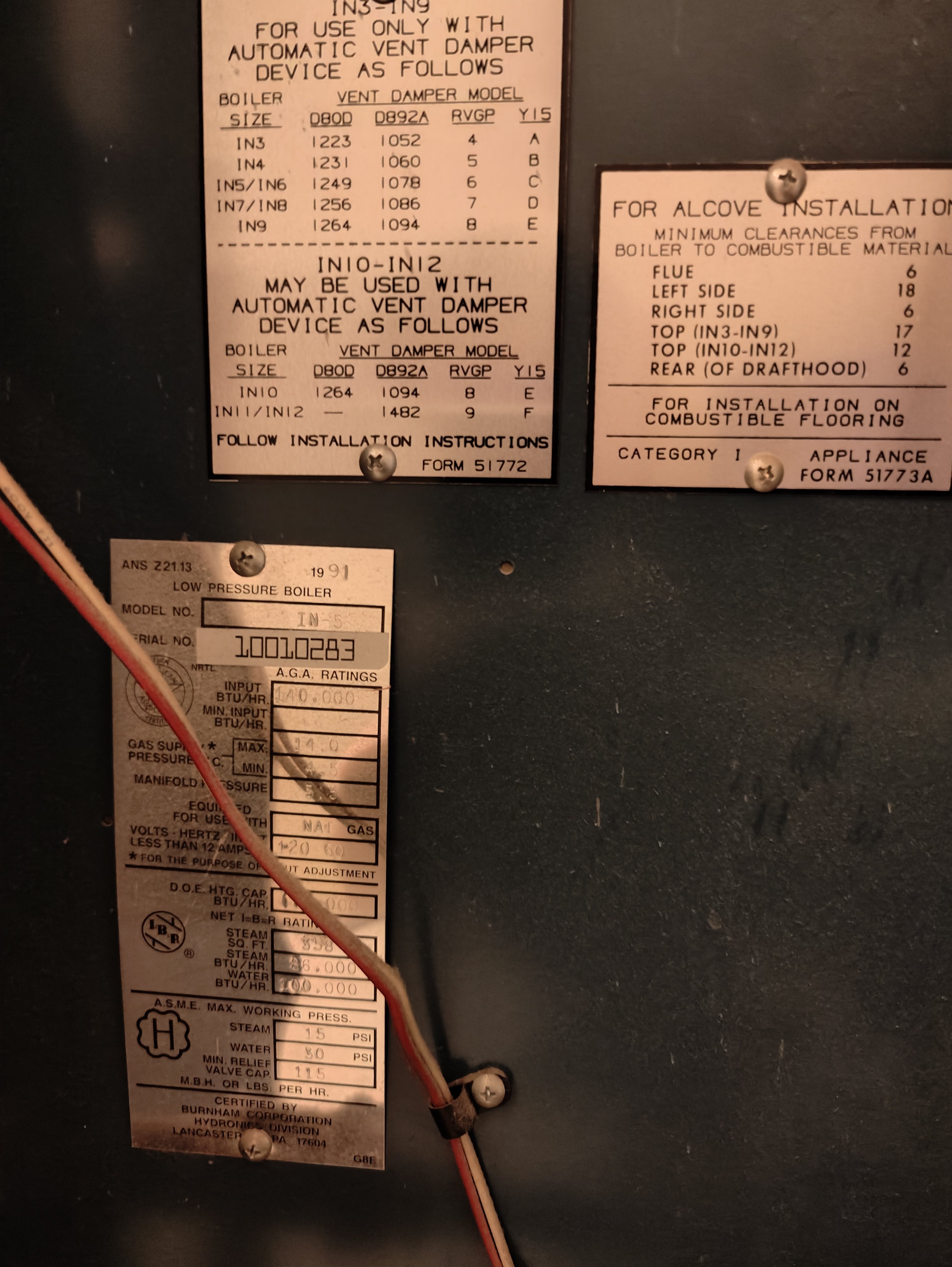

Thanks for recommending the book. Reading the book takes weeks, it would be great if there is a quick start guide to get it up and running.

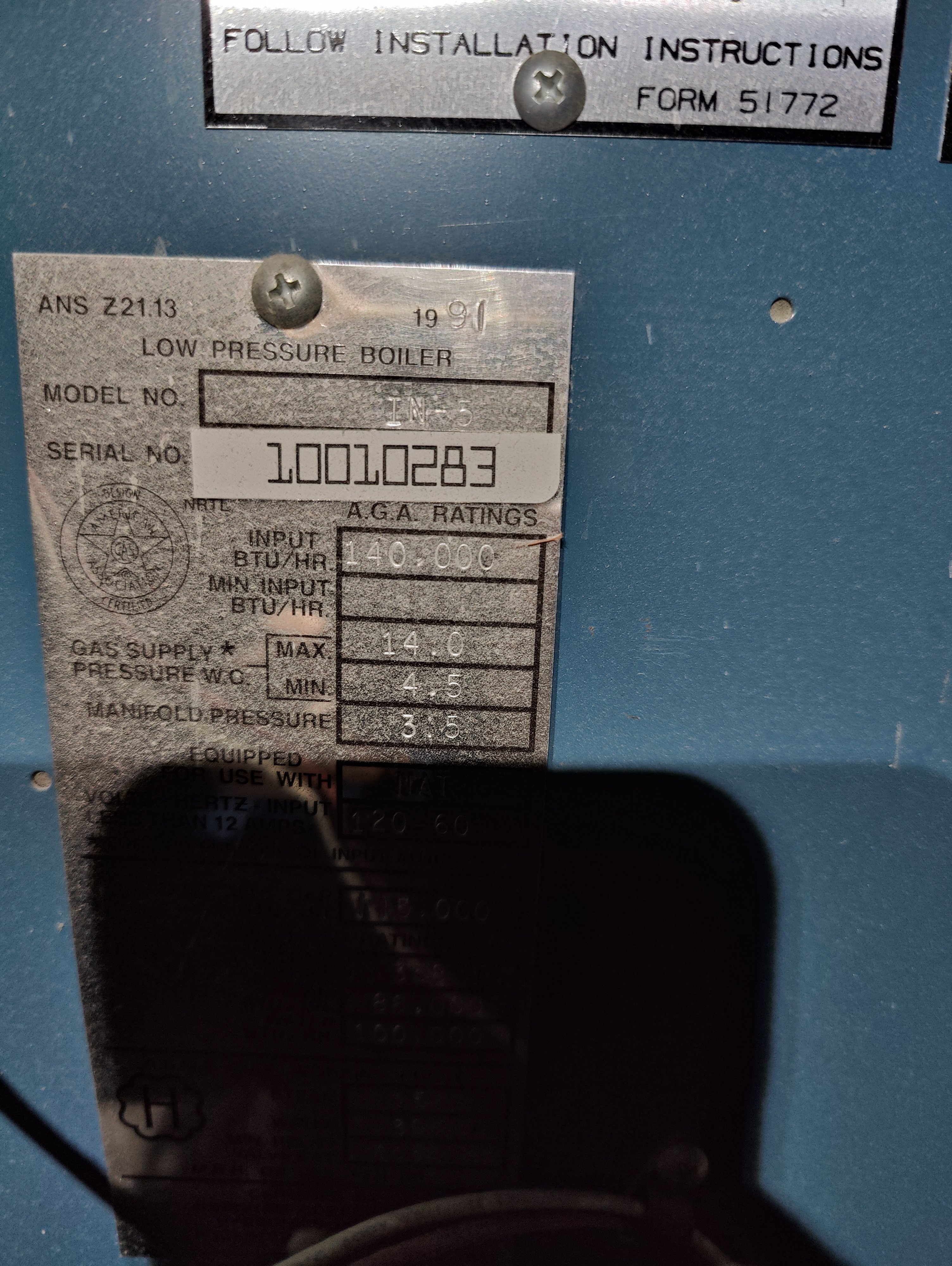

I did follow the model number (IN-5? please refer to the attached photo) but was not able to find the right manual.

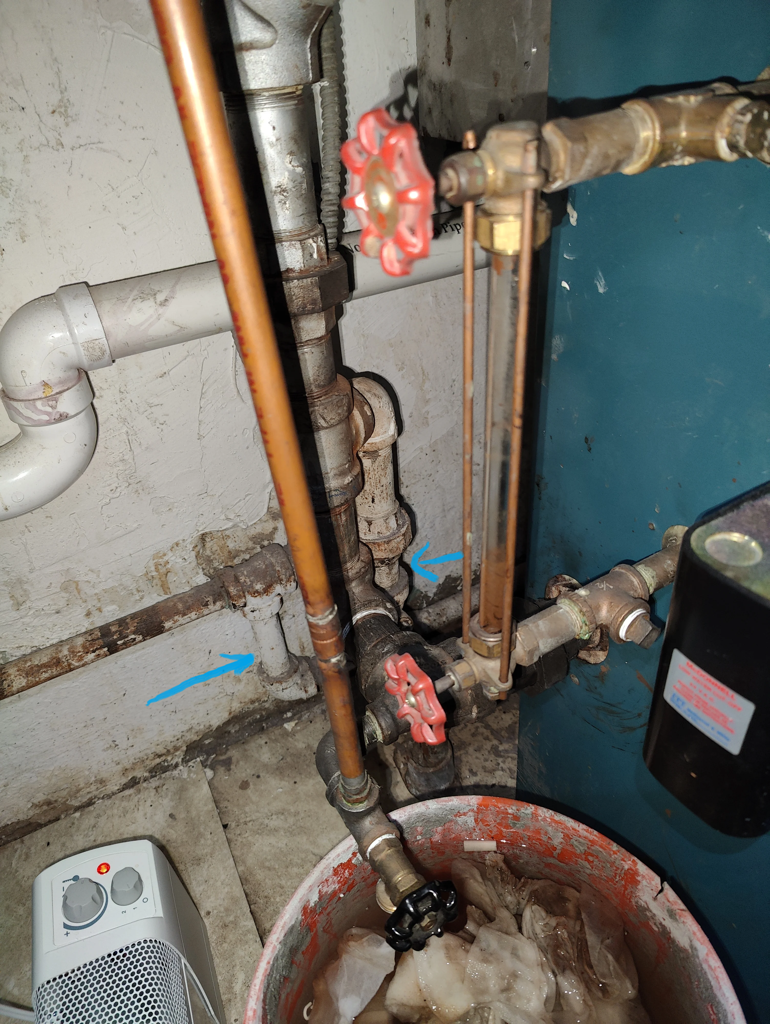

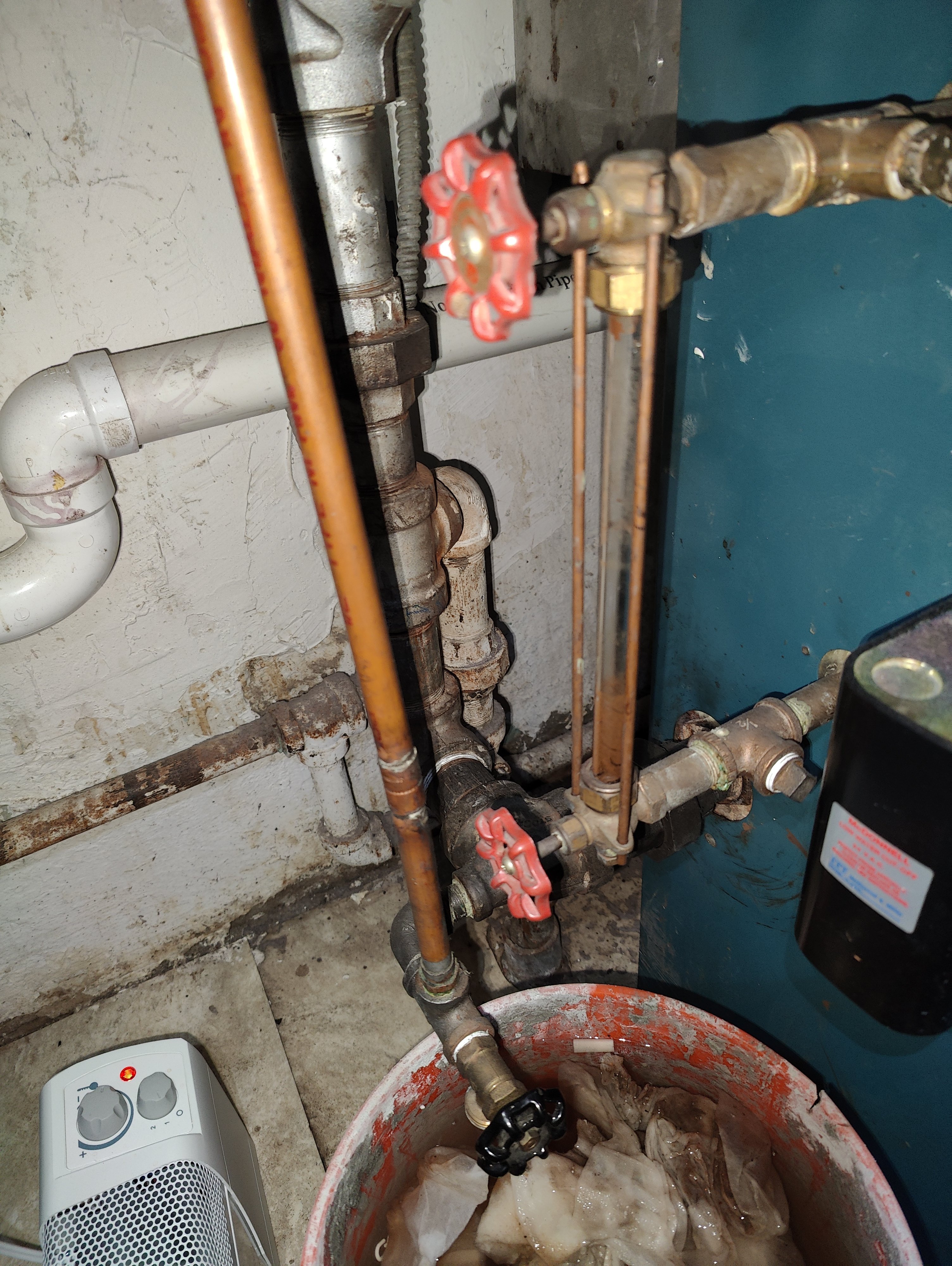

I drained about 5 gallons. The glass gauge is completely empty now. The water level was in the middle of the glass, and the initial drain was brownish color.
What does each of the upper and lower gate valves do? Both are in full open position.
The manual only mentions the "lower (gauge glass) fitting has a small drain valve (for draining samples)". The small drain valve and the red gate valve should be different things.
The red valves just close the top and bottom ports, handy if you break the glass and don't have a replacement.

If you're going to drain 5 gallons, you might as well drain it dry if you really think the basement is going to freeze. And every pipe connected to this boiler that is lower than this part is water-filled unless you drained it so beware:

It looks like the yellow handled ball valve is closed to prevent upward water flow from mixing with the water heater output, so it works as a separation between the potable hot water and the contaminated boiler water system, correct?

I thought that broken handle was shut off and then broken intentionally.

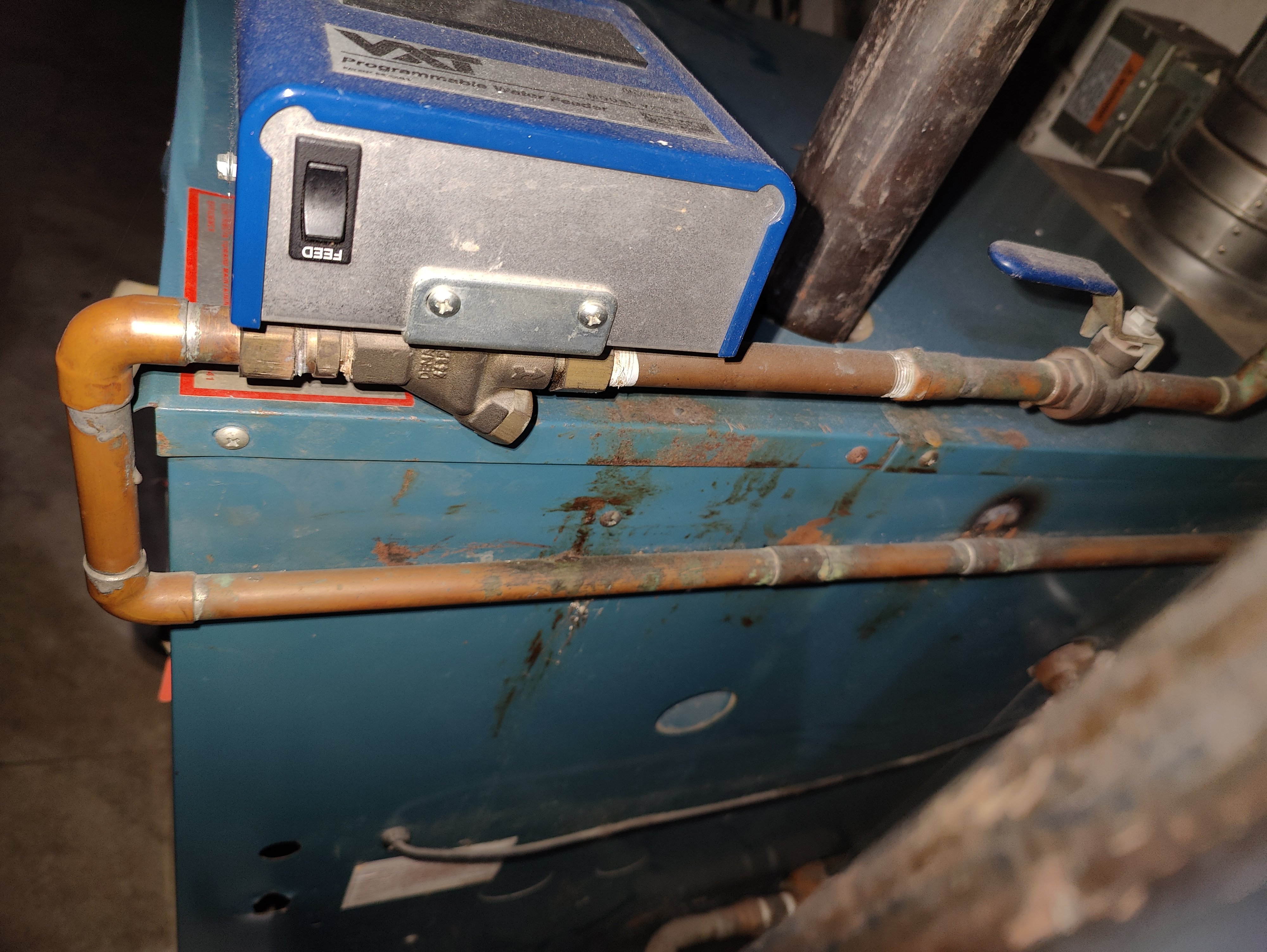

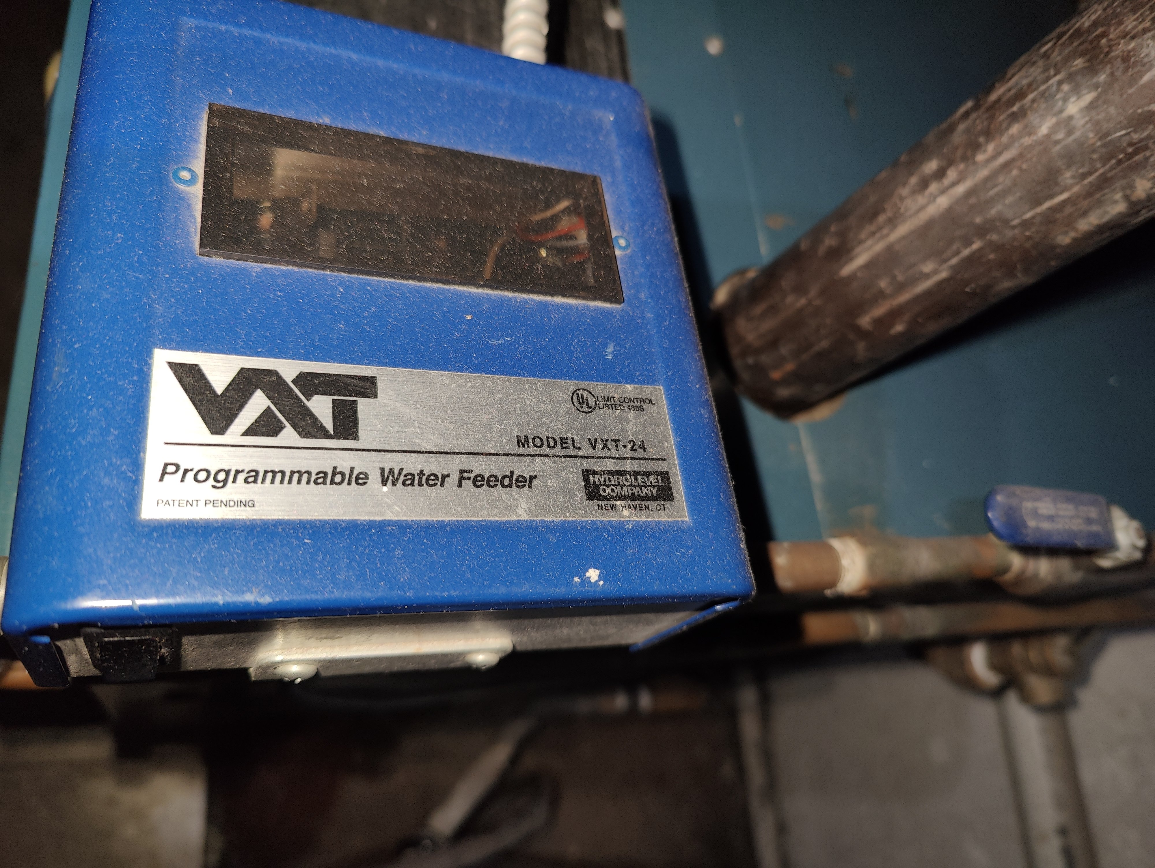

the "Programmable water feeder" only has a momentary FEED switch, how is it supposed to be programmed?

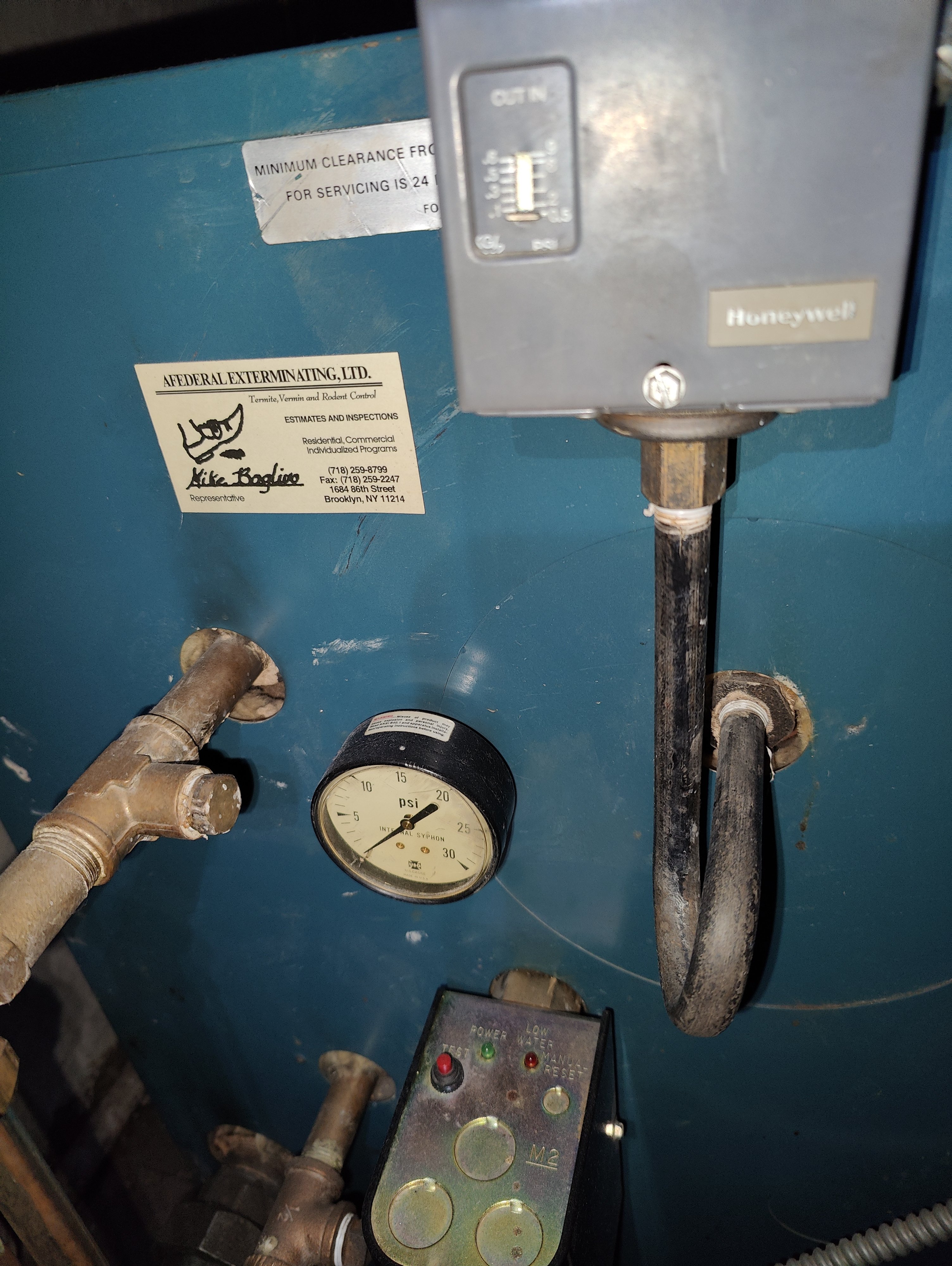

It's wired to the low water cut off. If the LWCO is functioning properly it will trigger the feed. I noticed in an earlier picture that the service switch if open/off?
I am only guessing at the reason that valve is there but some folks thought that adding cold water to a hot boiler would somehow damage the boiler
There is a notion that still persists today, that water in the water heater has already had some of its air driven out of suspension due to the heat, so that would be less corrosion triggered inside the boiler. I don't know if it's true or not, but it's rather common to pipe makeup water from the domestic hot water.
I think that it's because people are worried about thermal shock.
yes. I will turn it on this Friday when the gas service is scheduled to start.
under what conditions is the momentary Feed switch used?

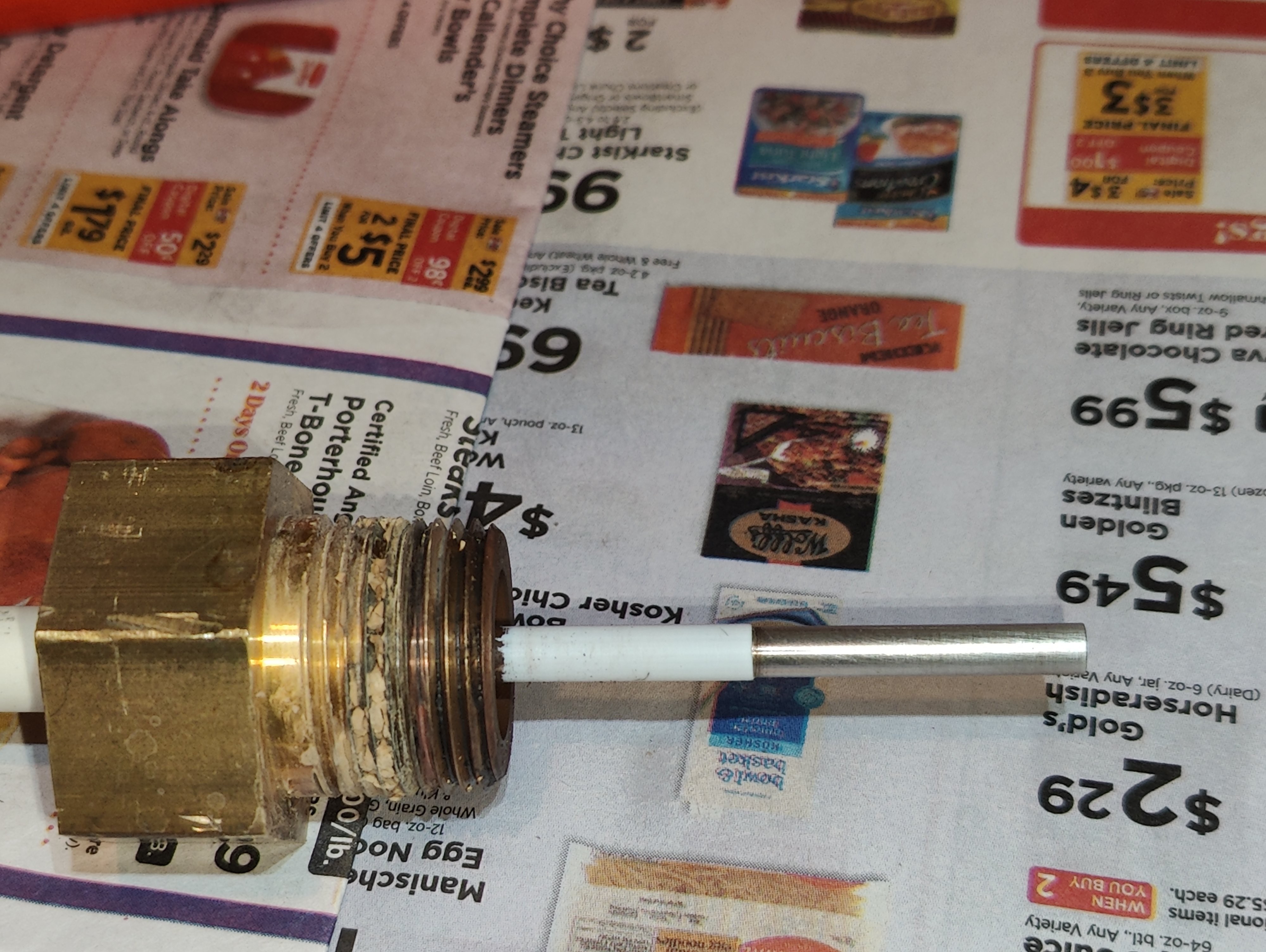

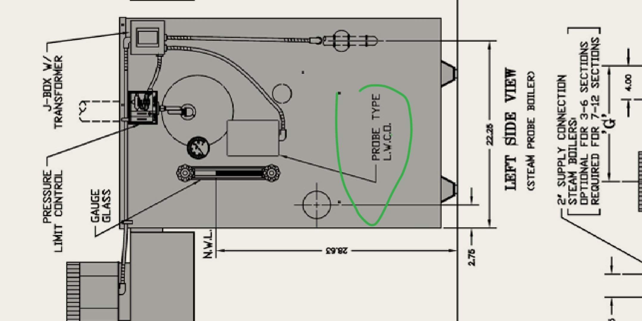

Haven't started. I was reading the manual in your post. It says the boiler has a probe type lwco device that should be inspected and maintained annually. Based on the plot, this seems to be the device under the psi gauge, correct?

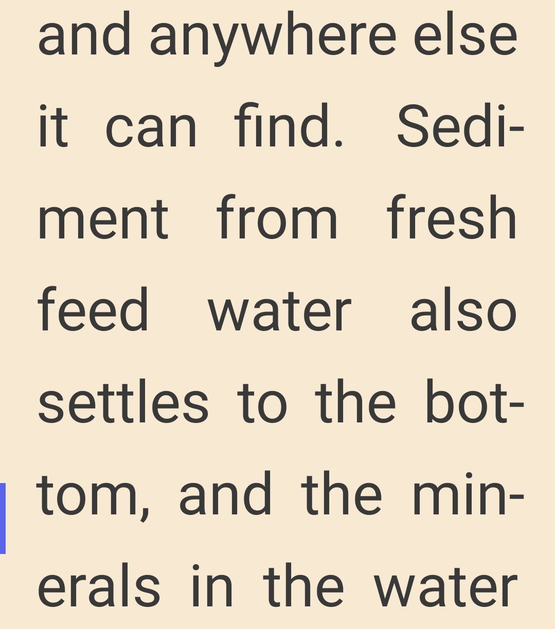

The books mentioned the accumulated sediment can lead to isolating the water from contacting the cast iron.

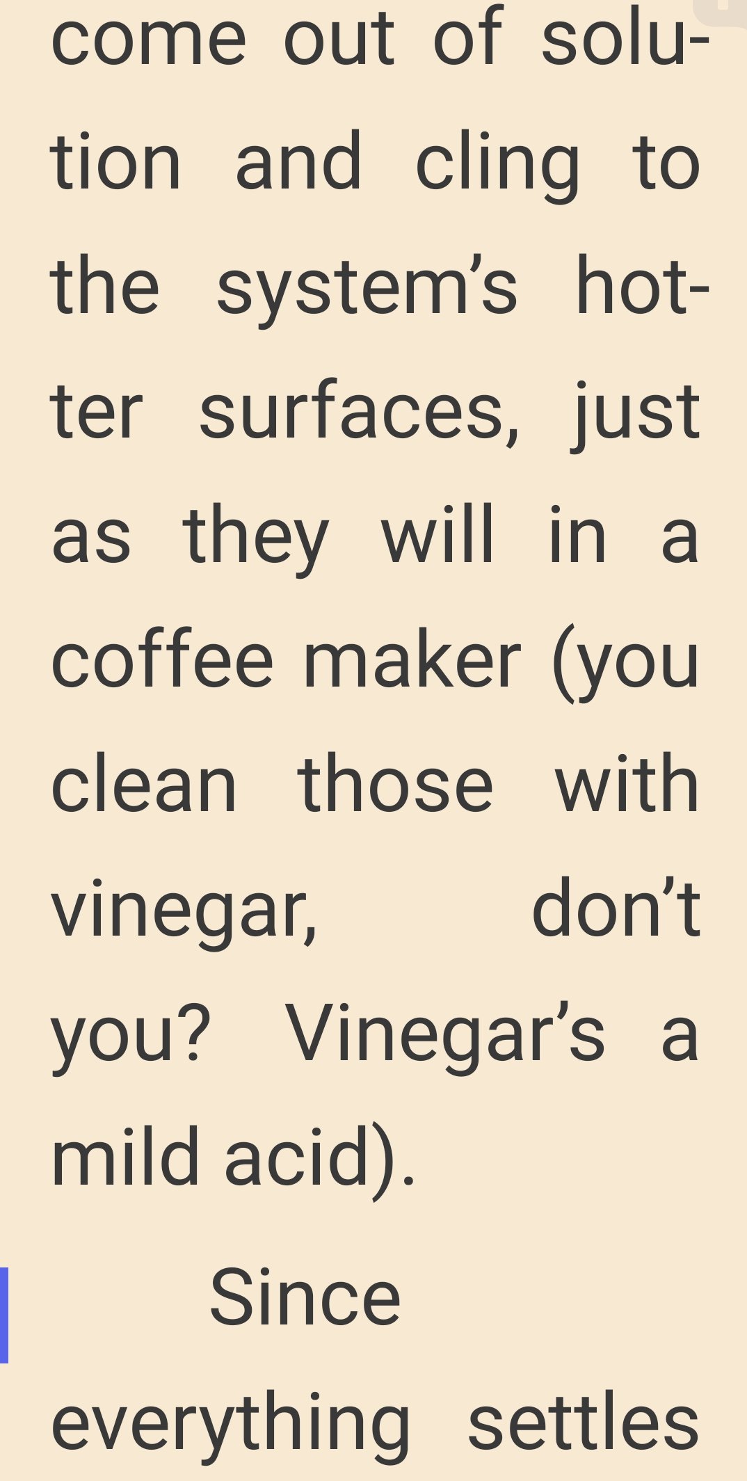

Is it possible to physically scrape the mineral deposit off of the cast iron?
It's not a business, it's more like a public service 😅 but thank you just the same!
The "mud" can definitely add up over time, perhaps to the point where operation or efficiency is affected. My original boiler in my house did have this sediment and I could never get it all cleaned out…I used 8-way boiler additive over time to remove a lot of it, but when I took it out of service it was clear there was still a lot of gunk in there.
However, I don't think it affected my boiler very much. I wouldn't put any acid into any boiler as a matter of principle. It might help clean it, but it also might cause removal of iron that would be worse than just leaving it a little dirty.
If you asked me, I would add a little 8-way to free up some of the scale/sedimented rust and to increase the pH a little in order to slow future rust creation. When you do that, it makes the water look more muddy (since the mud is brought into solution), and you may have to do several cycles of draining, filling, adding a little 8-way until the water starts to stay clear).
When the water is clear with some 8-way in it, that's when you will have minimal new rust creation, but it's a process to get there.

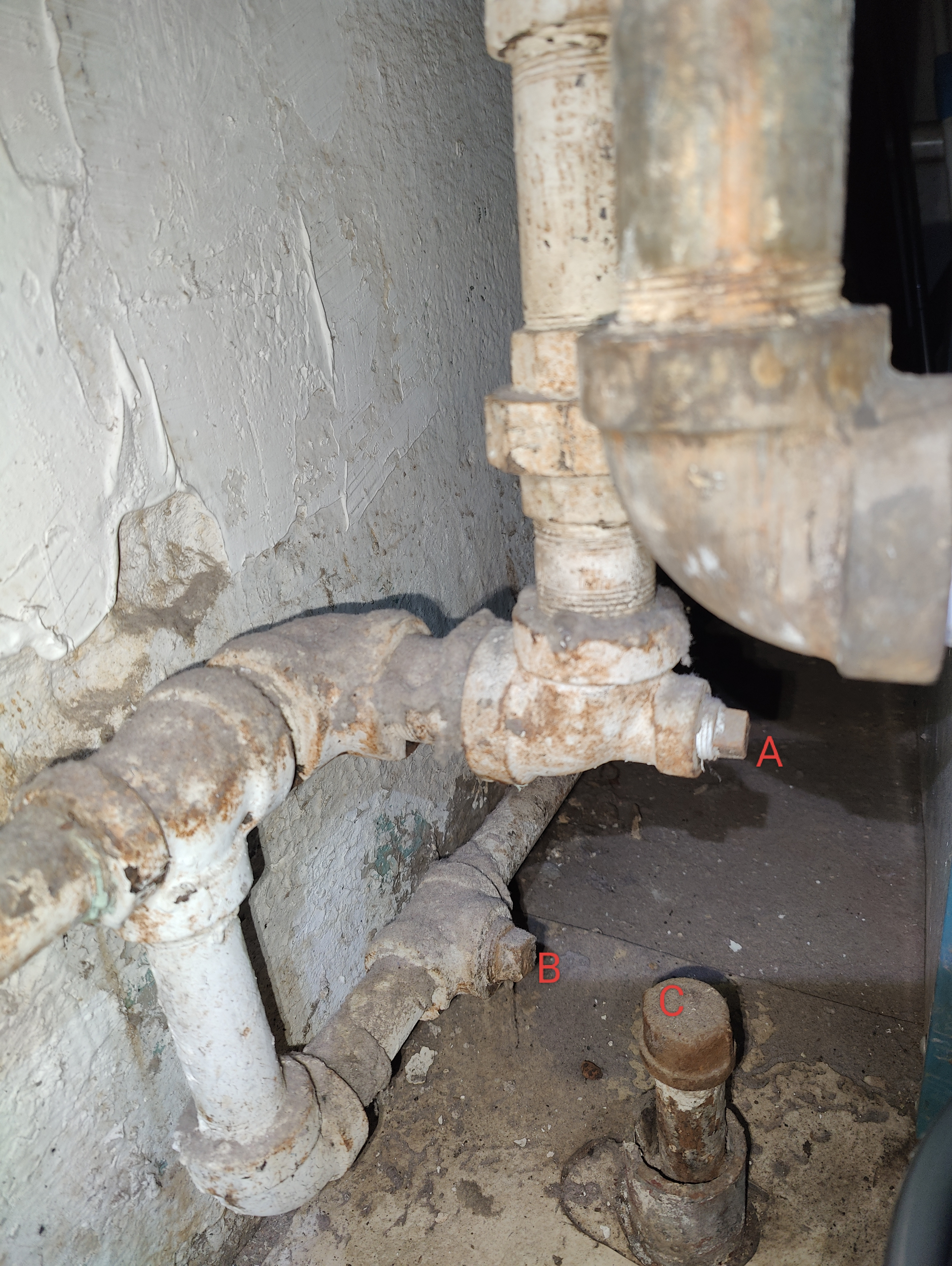

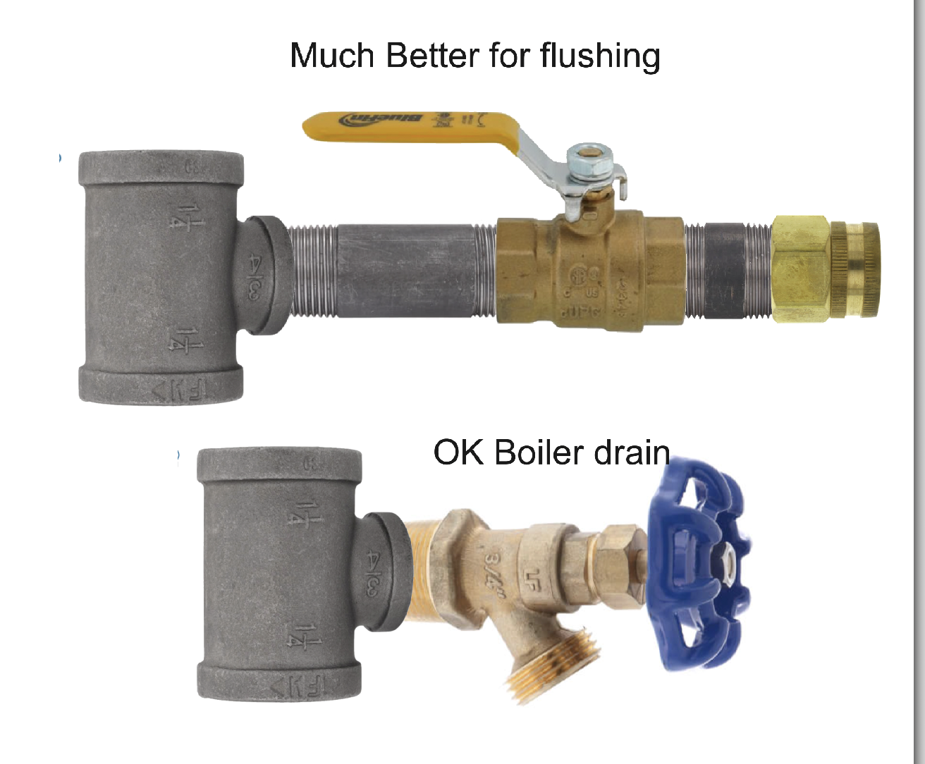

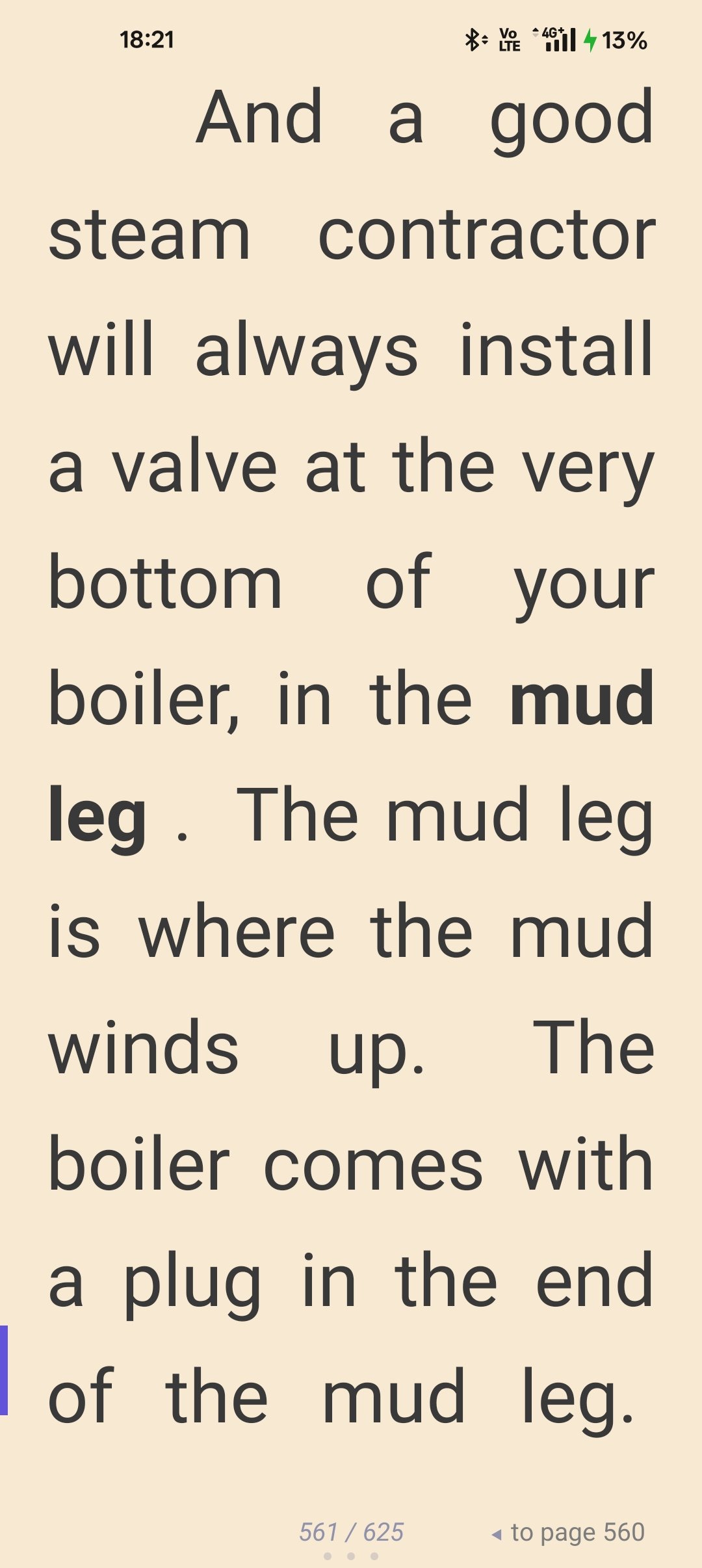

Is the valve where I drained in my quoted post the same as the "valve at the bottom of the mud leg" mentioned in the book?
What does a mud leg look like?

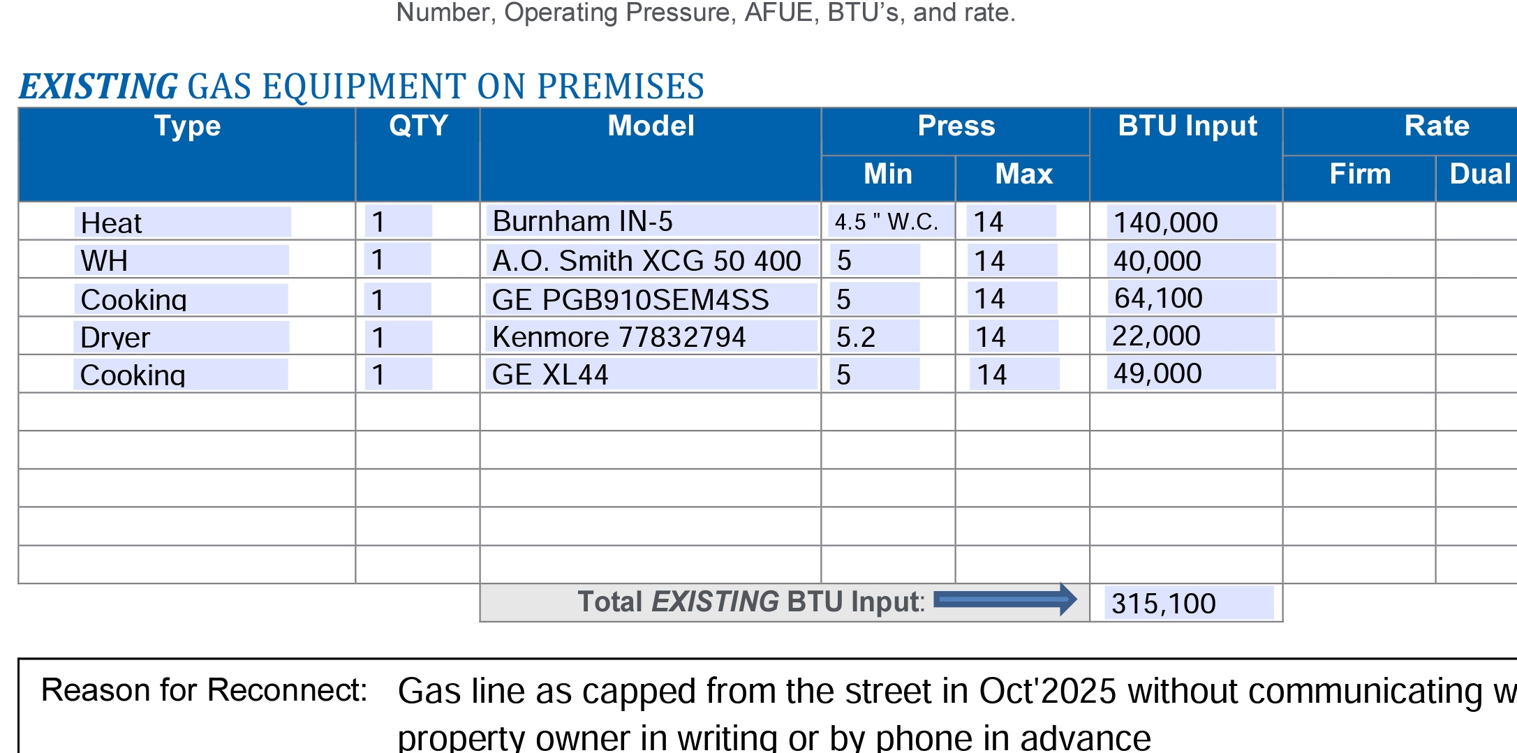

The gas technician came yesterday but was not able to turn on the gas. He told me the inlet pipe needs repair service and the company will submit a working permit to the city. so it will be weeks to wait.

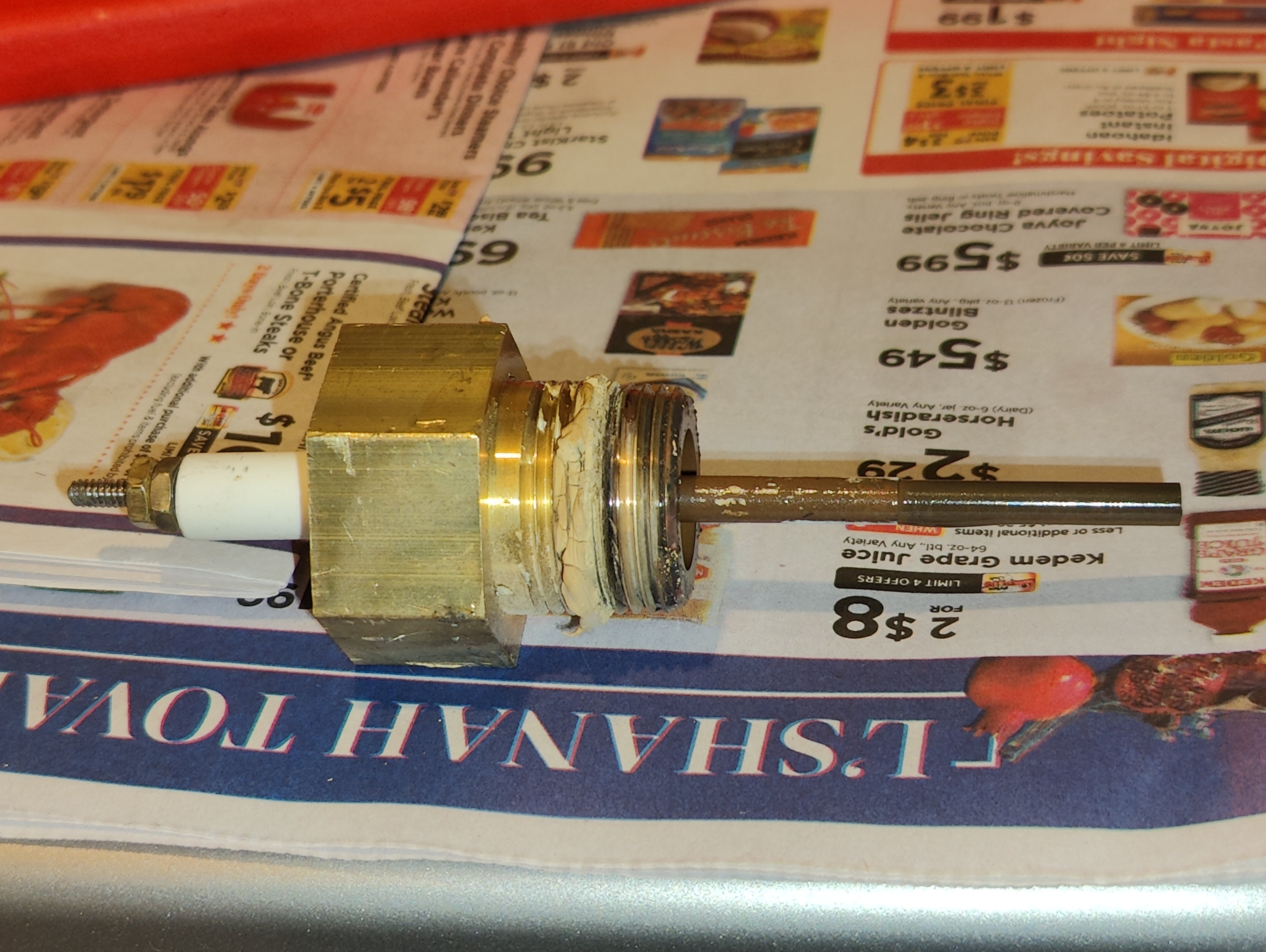

One question from the manual. I know a little about run and bull but didn't fully understand some language. What does bridging b/t the probe and tee mean?

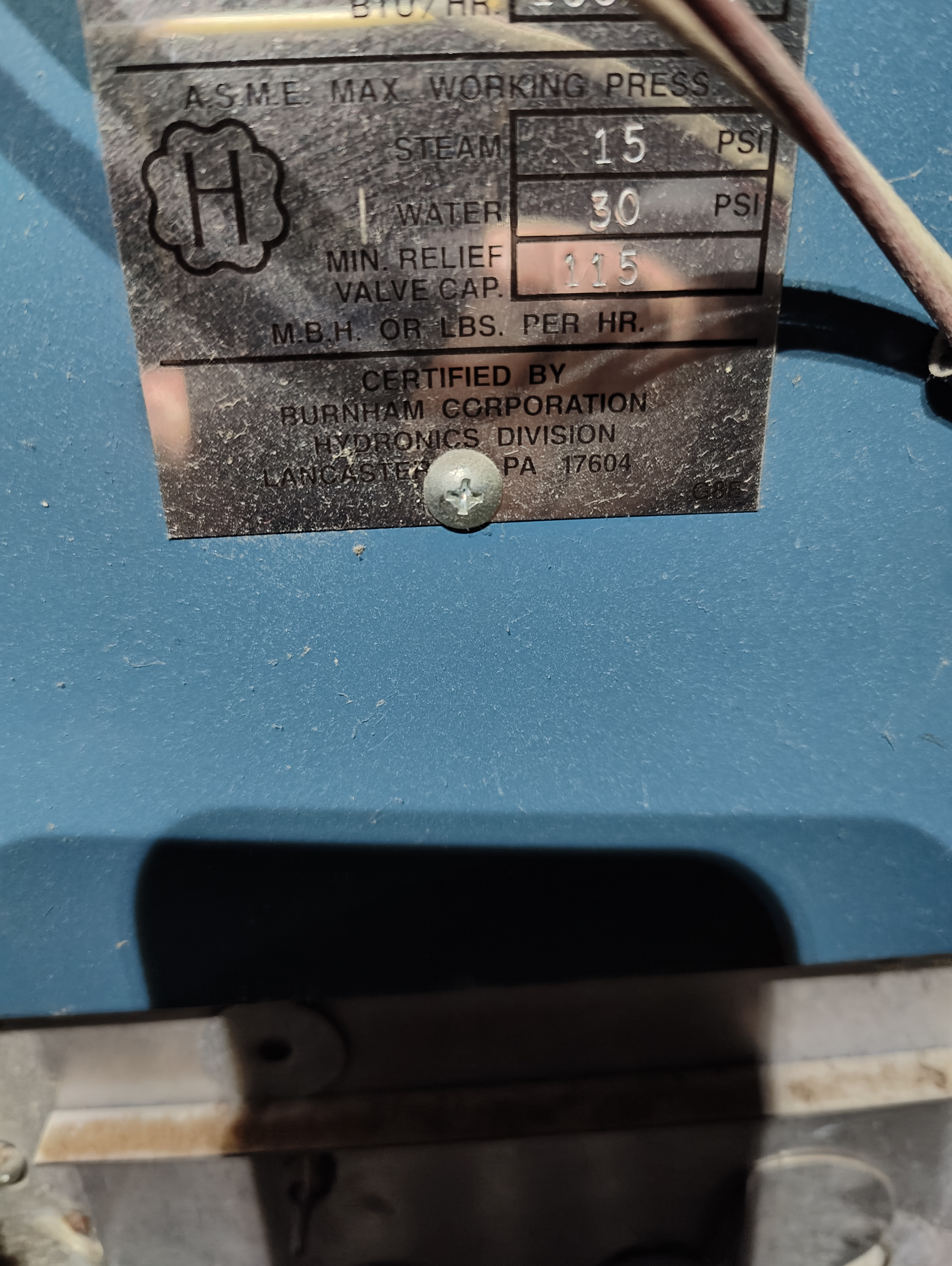

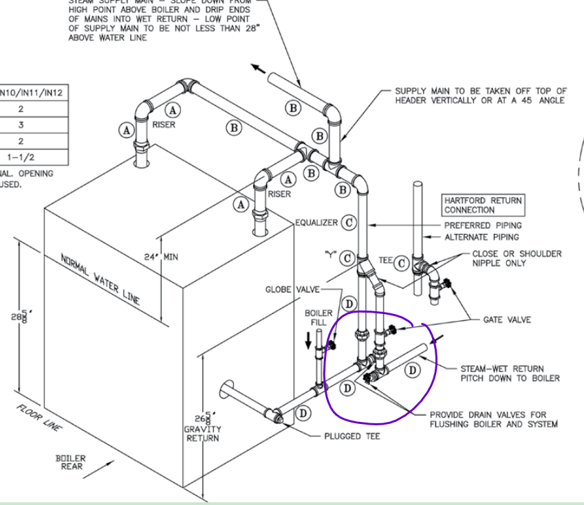

the manual says the min safe water level is the uppermost top of the boiler, that is illustrated in dashed line in the plot. does this say the min safe level is also the max water level of the boiler, because the boiler is "full of water" at this level? I thought the lwco should be brought in at the same dashed level, but its position in the plot is way higher
my boiler does not have a "lowest permissible water level plate" on the jacket left side panel. what level in the gauge glass should the water be filled up to?
So that plot is a water boiler, that why the shut off valve is above the lwco.
what level in the gauge glass on my steam boiler should the water be filled up to?

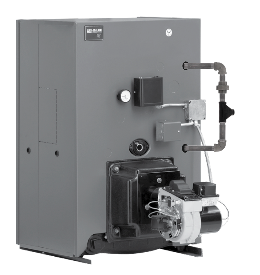

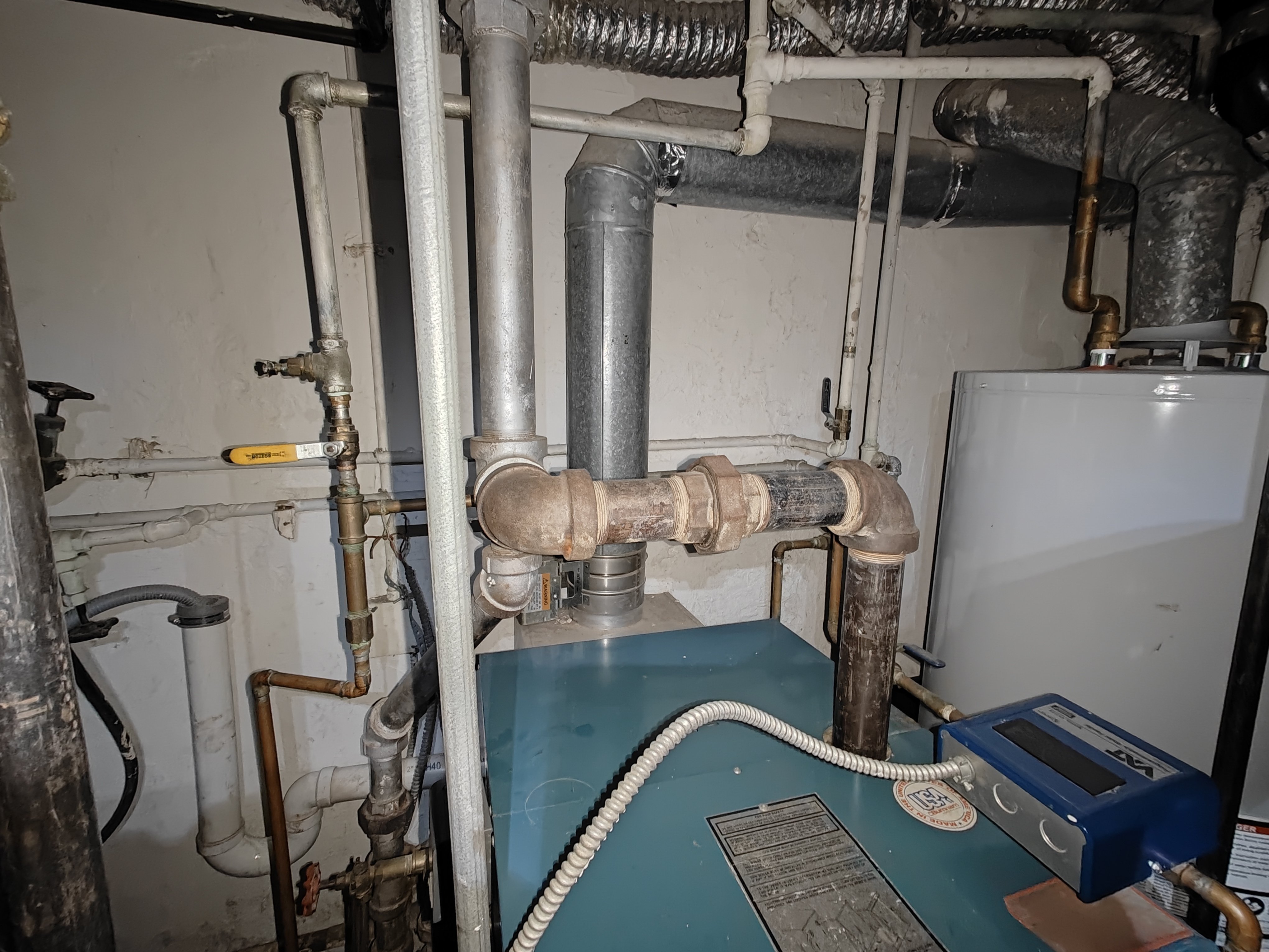

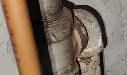

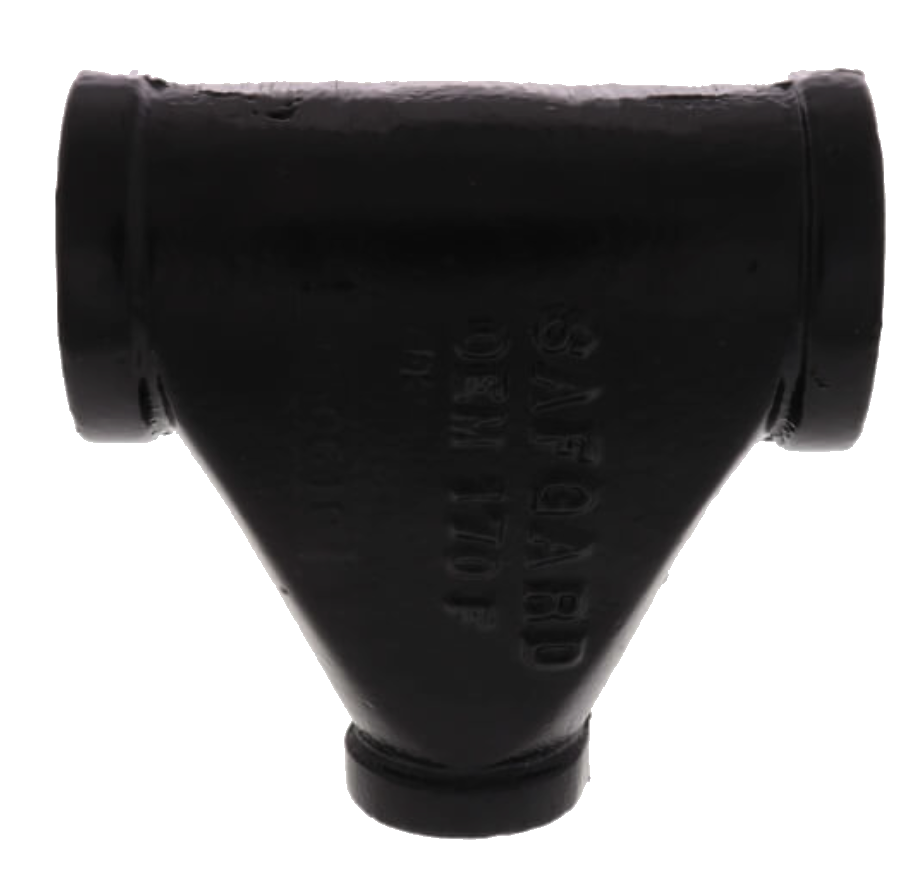

the shape of the T is interesting, it's the first time I'm seeing this.
when I see the U shaped piping joined with elbows without swivel parts, I always think they are hubbed.
are this triangle T and the two street elbows joined with lead oakum (hubbed)?
