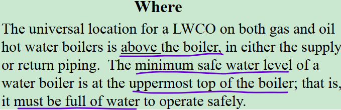

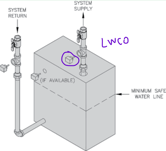

    the manual says the min safe water level is the uppermost top of the boiler, that is illustrated in dashed line in the plot. does this say the min safe level is also the max water level of the boiler, because the boiler is "full of water" at this level? I thought the lwco should be brought in at the same dashed level, but its position in the plot is way higher
    my boiler does not have a "lowest permissible water level plate" on the jacket left side panel. what level in the gauge glass should the water be filled up to?

    You are mixing up a water boiler, with a steam boiler.

    So that plot is a water boiler, that why the shut off valve is above the lwco.
    what level in the gauge glass on my steam boiler should the water be filled up to?

    YOU HAVE A STEAM BOILER!!!!
    The information you are referring to is instructions for a water boiler.  A water boiler has water filled all the way up to the top radiator on the top floor of the building, and that water at the top is supposed to be under some pressure in order to purge all the air out of the system way up there.   If you have lots of time on your hands you can learn more about water boilers. Knowledge you will never use where you are now.  That knowledge will be helpful if you move to another home with a water boiler.  In your situation I would not spend extra time learning about someone else's heating system.  I would concentrate on your STEAM system.

    On this commercial boiler you may be required to have as many as 3 LWCO depending on the application. The highest one to operate the water feed and a back up to stop the burner if the first one fails. The third one may be manual reset in the event that the first two fail for some reason. Other codes require only 2 LWCO. An operating LWCO with auto reset and a second one that is manual reset in the event that the operator LWCO fails.
    If for some reason your boiler does not have the proper tapping you can place a side arm on other tappings to install a LWCO outside the boiler as shown in the illustration where I added pipes to C1 and C2 openings. Then place the LWCO Tee fitting at the proper level for your application.
    That special Tee is what the instructions were referring to when a normal Tee may form a bridge.
