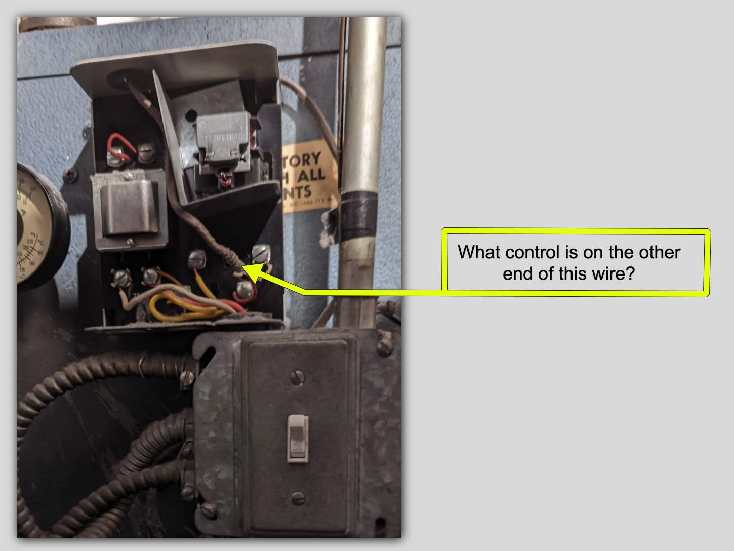

I'm in NY in a house that was built in 1954. I've been in this house for almost 30 years and I have never updated any part of the heating system which is gas, hot water, radiators. I have 2 zones, the basement and the rest of the house. The basement has a regular low voltage 24v line thermostat. The upstairs thermostat is 120v. This limits me with the type of thermostat I can use there. Can anyone explain why this thermostat is line voltage? Every place I look for an answer, it says line voltage is used in electric baseboard heating. I have no electric baseboard heating, only regular hot water radiators. I really want to install a smart thermostat but can't figure out how do do this. Can someone please give me some guidance? Thanks in advance for any assistance.

    It depends on the controls located at the heater. Can you look at the heater and take some photos of the controls from far enough back so we can see how they might be connected. The brand name and model number of the heater or the wiring diagram that is connected to h the heater may also help

    What kind of wire runs in to the thermostat? Looking at the controls it looks like it at least started out as low energy. Not really clear why t-t is jumpered on one of the relays.

    As @mattmia2 stated the Red jumper on the upper aquastat seems odd. Which aquastat is for which zone ?

    I just looked at your 2 different circulator relays. they look like R845A relays that are using the 5 and 6 contact terminals to operate the burner circuit. I don't see any limit or aquastat controls in those photos. Can you post a picture of the other end of the wire from the 5 and 6 on the R845A controls?
    As far as using a 24 VAC thermostat for your main floor zone, this is where you would connect the thermostat. Remove this Red jumper wire and place the two wires from your thermostat on T T terminals. Then it will be wired just like the basement zone.
    The line voltage to terminal 1 on this R845A may need to be connected directly to power. the original wiring may go thru the thermostat before attaching to the 1 terminal. You will need to verify this.
