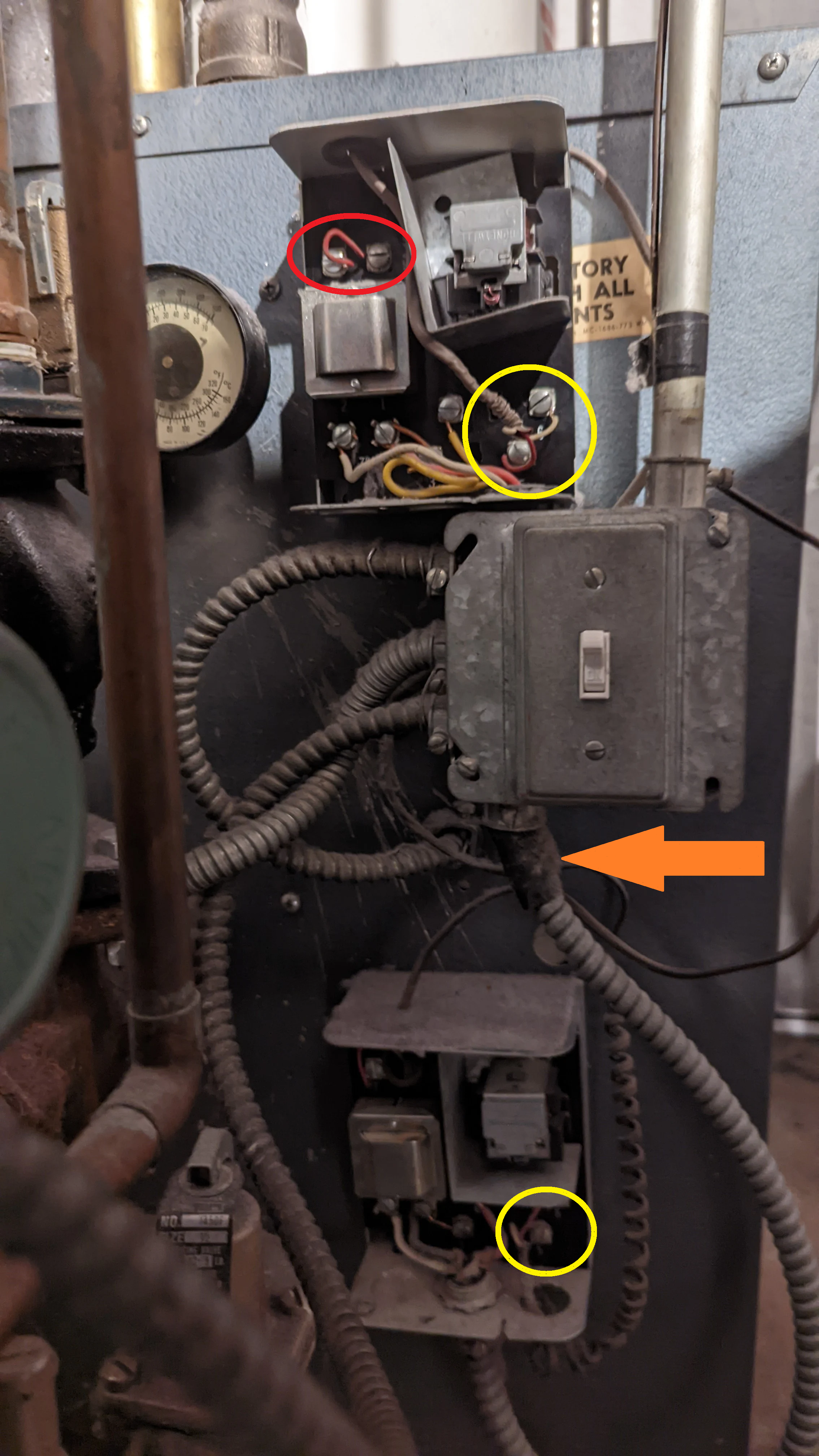

I'm in NY in a house that was built in 1954. I've been in this house for almost 30 years and I have never updated any part of the heating system which is gas, hot water, radiators. I have 2 zones, the basement and the rest of the house. The basement has a regular low voltage 24v line thermostat. The upstairs thermostat is 120v. This limits me with the type of thermostat I can use there. Can anyone explain why this thermostat is line voltage? Every place I look for an answer, it says line voltage is used in electric baseboard heating. I have no electric baseboard heating, only regular hot water radiators. I really want to install a smart thermostat but can't figure out how do do this. Can someone please give me some guidance? Thanks in advance for any assistance.

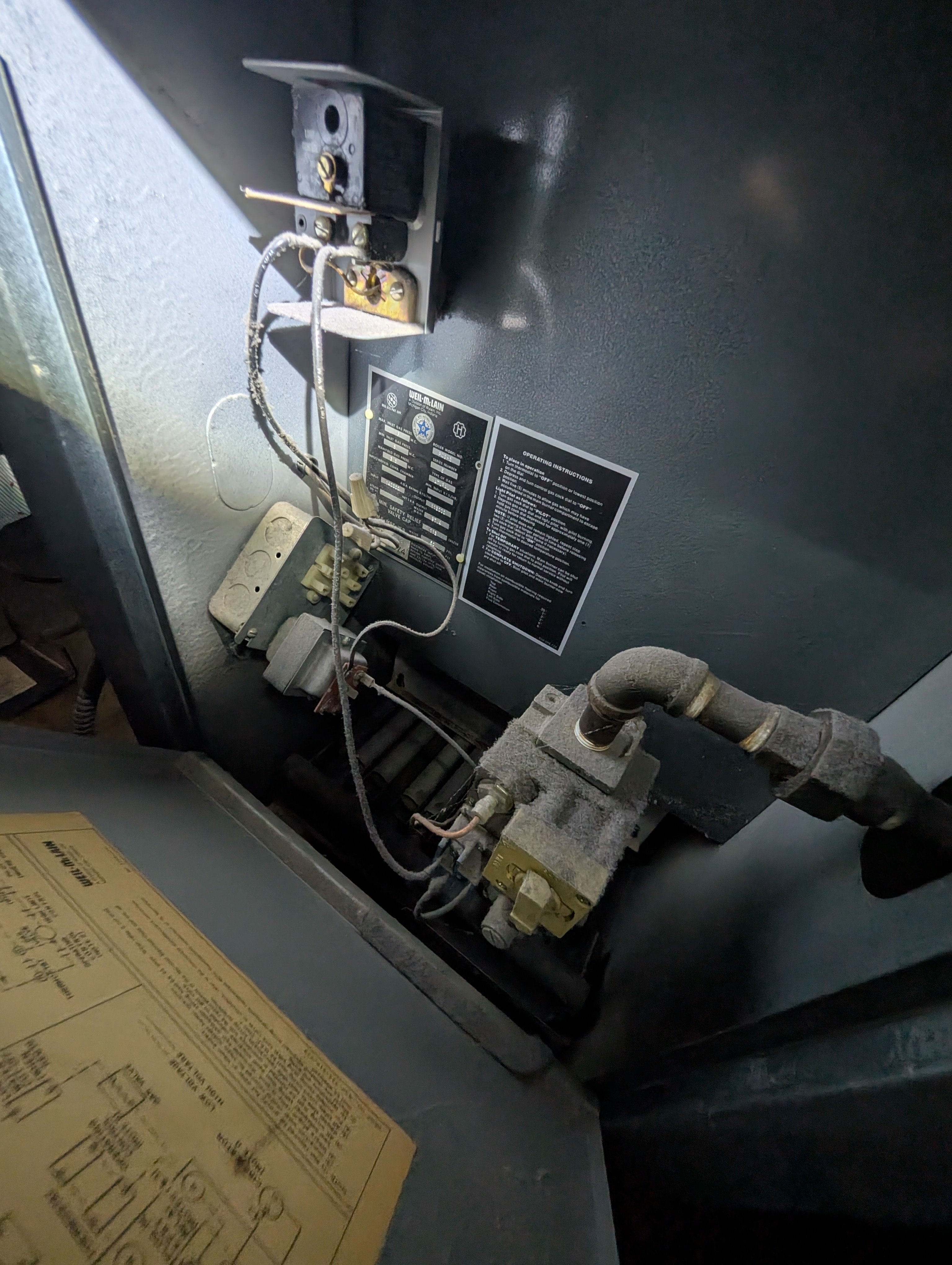

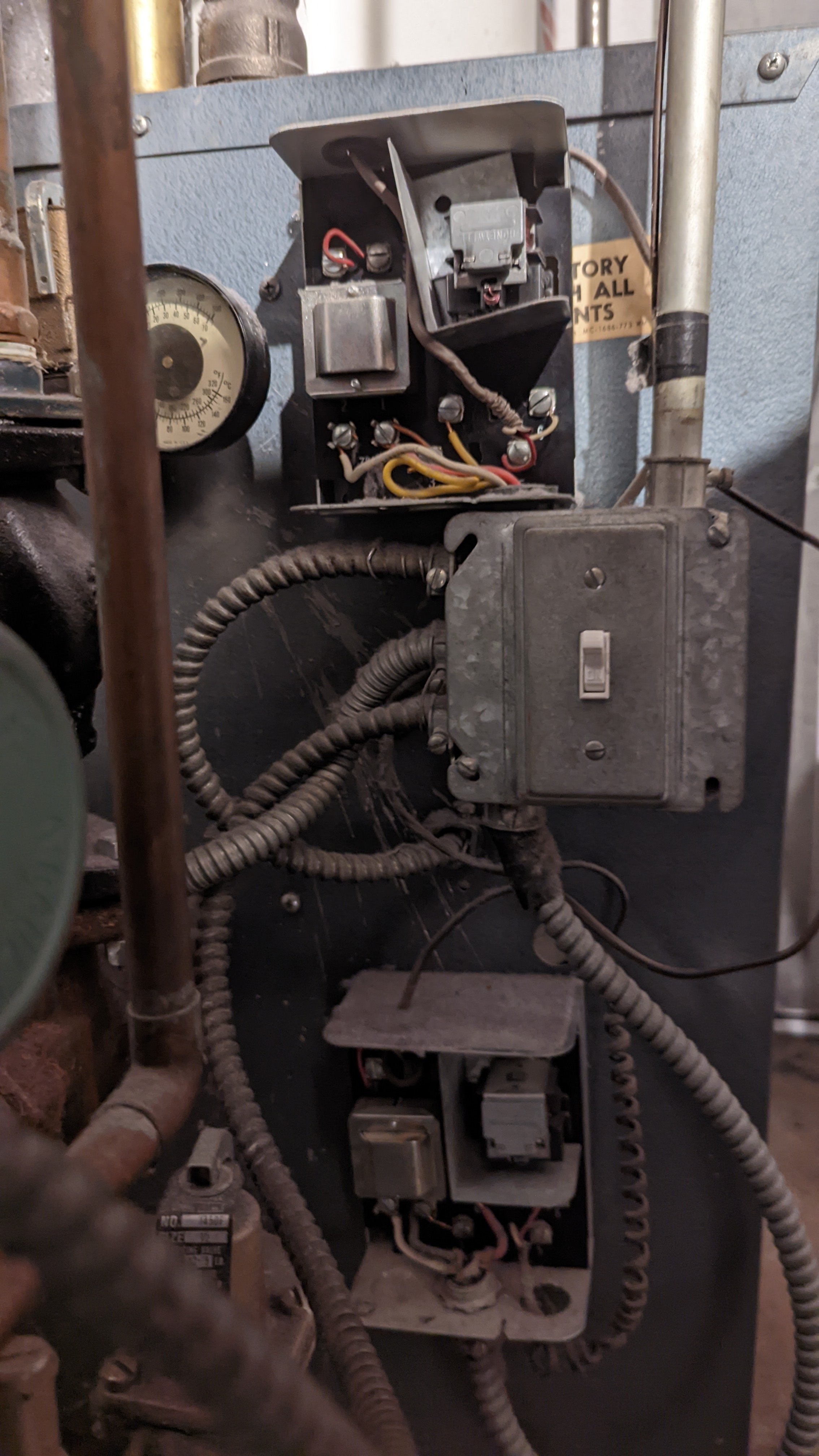

    It depends on the controls located at the heater. Can you look at the heater and take some photos of the controls from far enough back so we can see how they might be connected. The brand name and model number of the heater or the wiring diagram that is connected to h the heater may also help

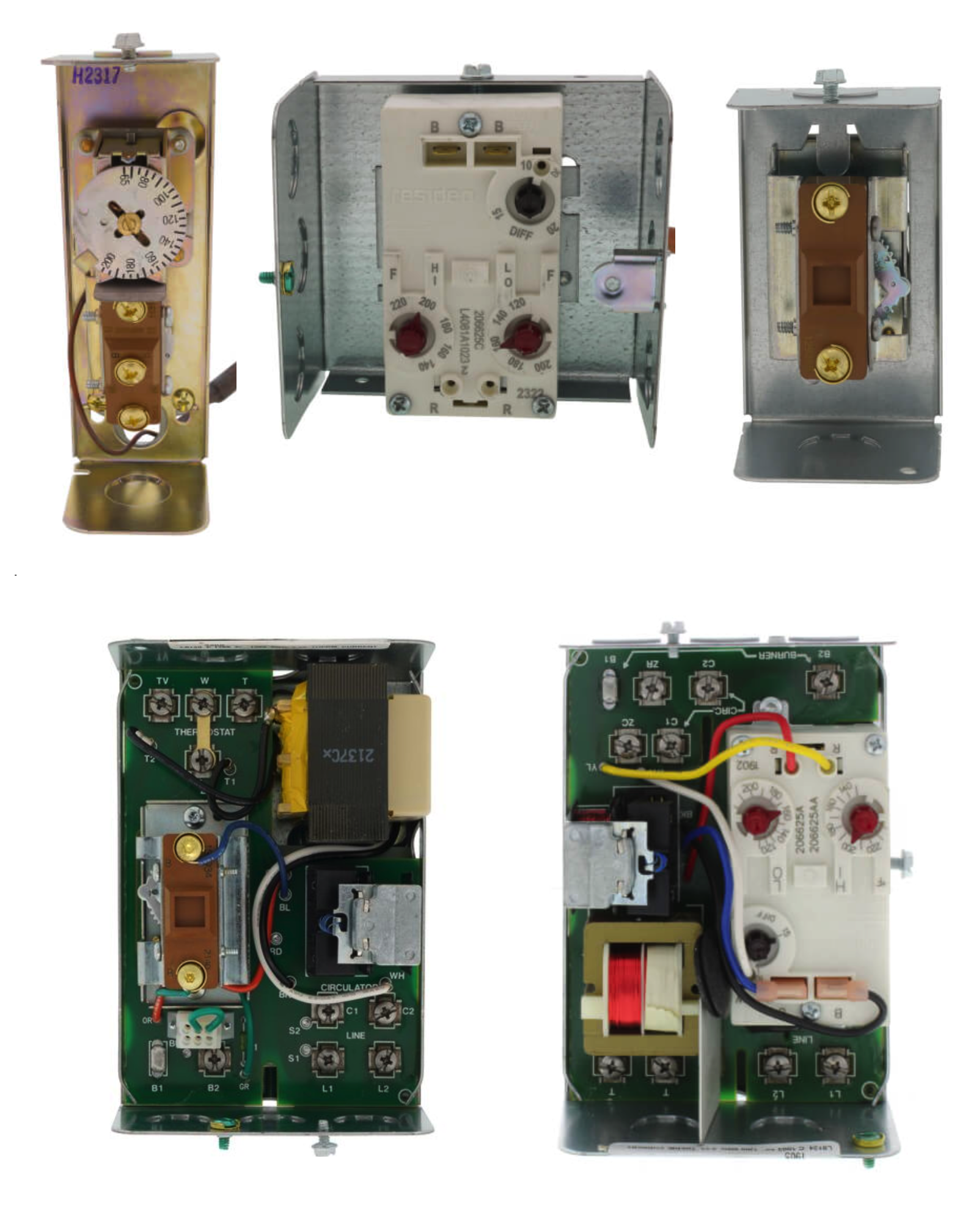

    There are some nice line voltage thermostats available from the companies that do electric radiant systems. Here are some Sun Touch

    What kind of wire runs in to the thermostat? Looking at the controls it looks like it at least started out as low energy. Not really clear why t-t is jumpered on one of the relays.

    As @mattmia2 stated the Red jumper on the upper aquastat seems odd. Which aquastat is for which zone ?

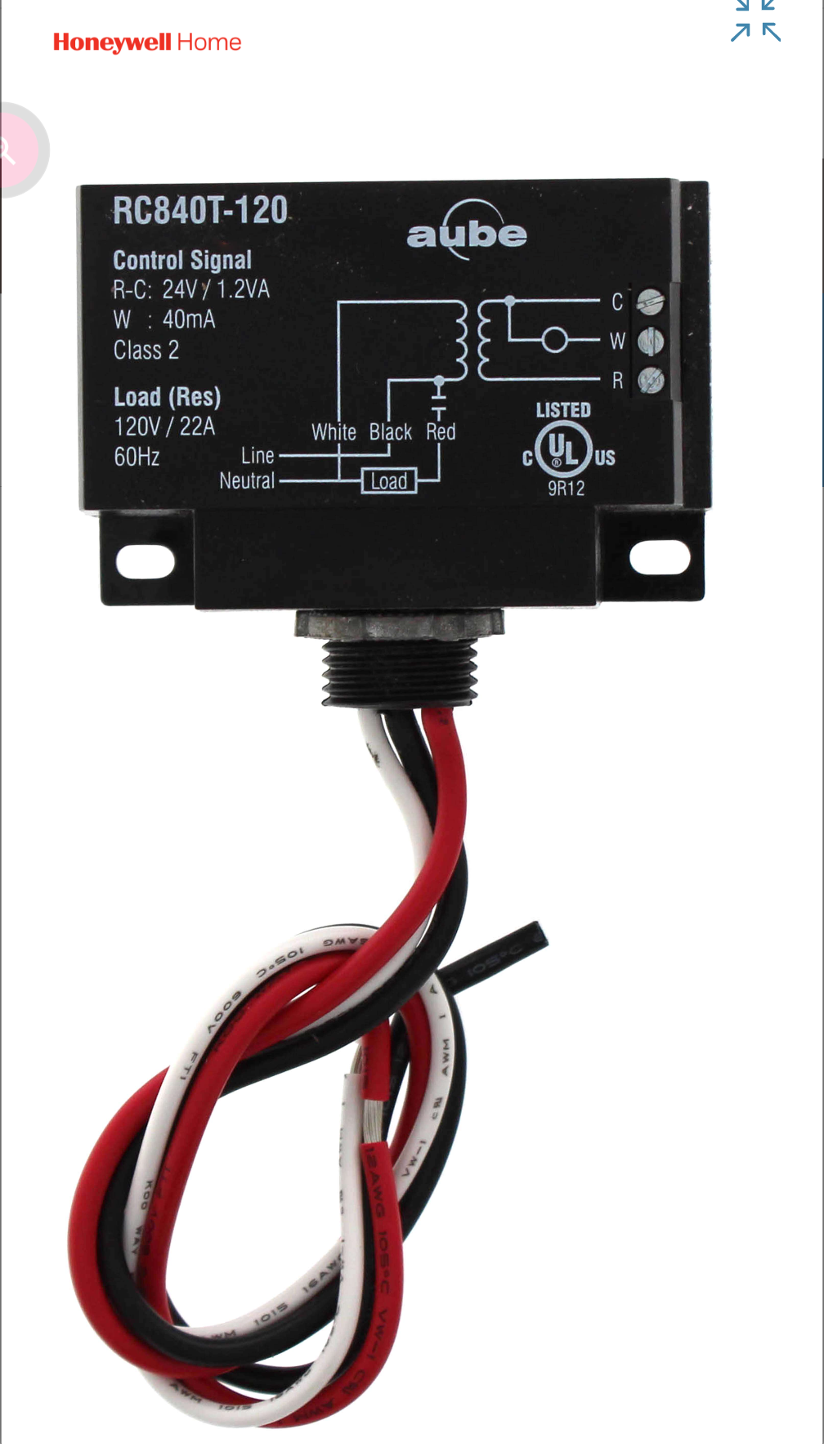

  • Does anyone know anything about this Aube RC840T-120 relay I got? Like I said, my original plan was to put the line voltage into this relay at the thermostat, then wire the thermostat from the relay. I was gonna attach the relay to a junction box in the wall. It looks like it's get the c wire from the relay too. I'm not sure if that's how it would work, I assume some kind of wizardry happens inside the relay that creates the c wire out to power the Nest. I didn't do this because I don't know if doing this would fry some part of my heating system.

  • Regarding that RC840T-120 relay, you need to add a 24 VAC transformer to operate it with the Nest thermostat.
  • It's not "creating" the c wire power from the line voltage itself? It looks like it's tapped off on the output. I was obviously looking for the easy way out and saw what I wanted to see when I bought this. Guess I was wrong.
    That relay looks like it would work. And it would but I doubt the transformer inside it has enough power to charge a Nest. It would be the perfect application if it was. Maybe someday they will make a Nest version

  • Yeah I was wondering why the 24v transformer I connected to my basement nest is the size of my fist and why this relay is so much smaller. Like I said I thought there was some kind of magic happening inside it. If I connect it and am getting 24v from both the c and the r, and the w and the r, then that should work though, right? I think the nest just needs the 24v to work. Or are you saying it wouldn't consistently provide needed power?

    that control device only can supply 1.2 va so it couldn't power a thermostat and you would need hot, neutral, and load in that box to use it.
  • Ok so I just googled to understand what you're talking about and now I get it. Says smart thermostats that use Wi-Fi typically need at least 2va and sometimes 4va. But says the 1.2va is good to work a regular low voltage thermostat. So if I do connect this relay, I could at least have more options available to me as far as getting a better non smart but still programmable low voltage thermostat. Thanks for pointing this out.

    Not a big enough transformer in that little black box, and where do you get Neutral for 120VAC?

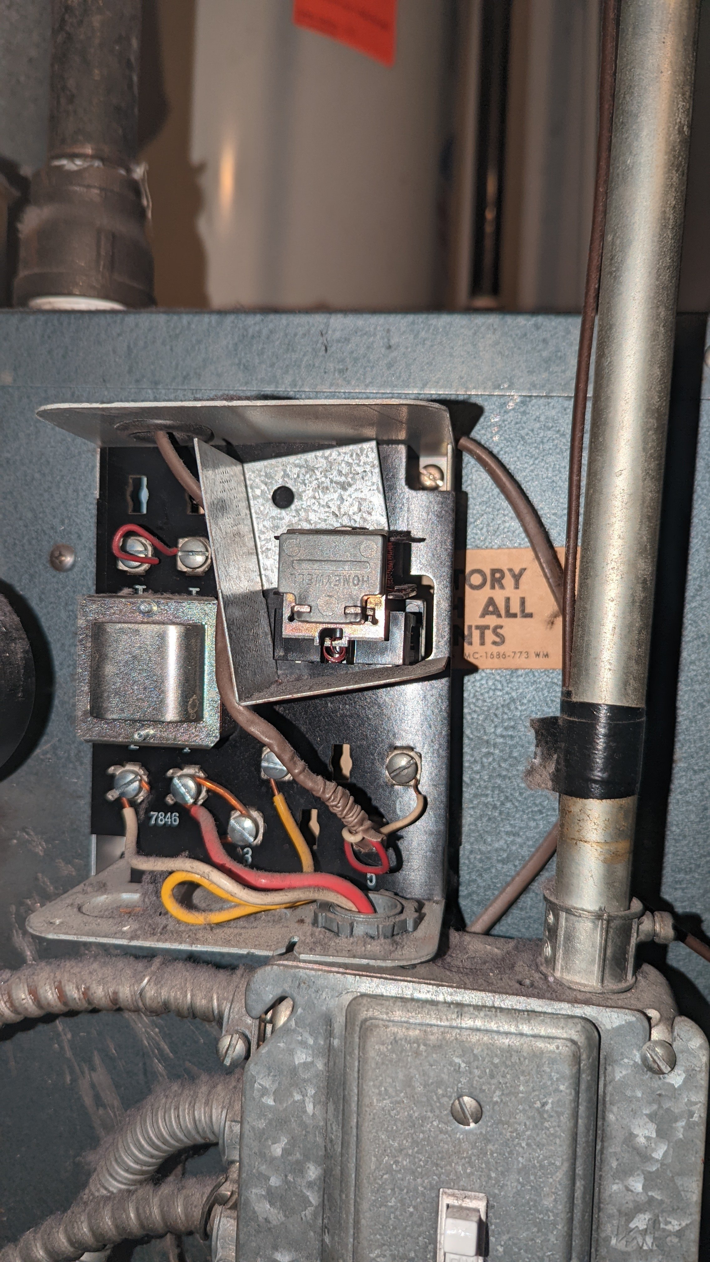

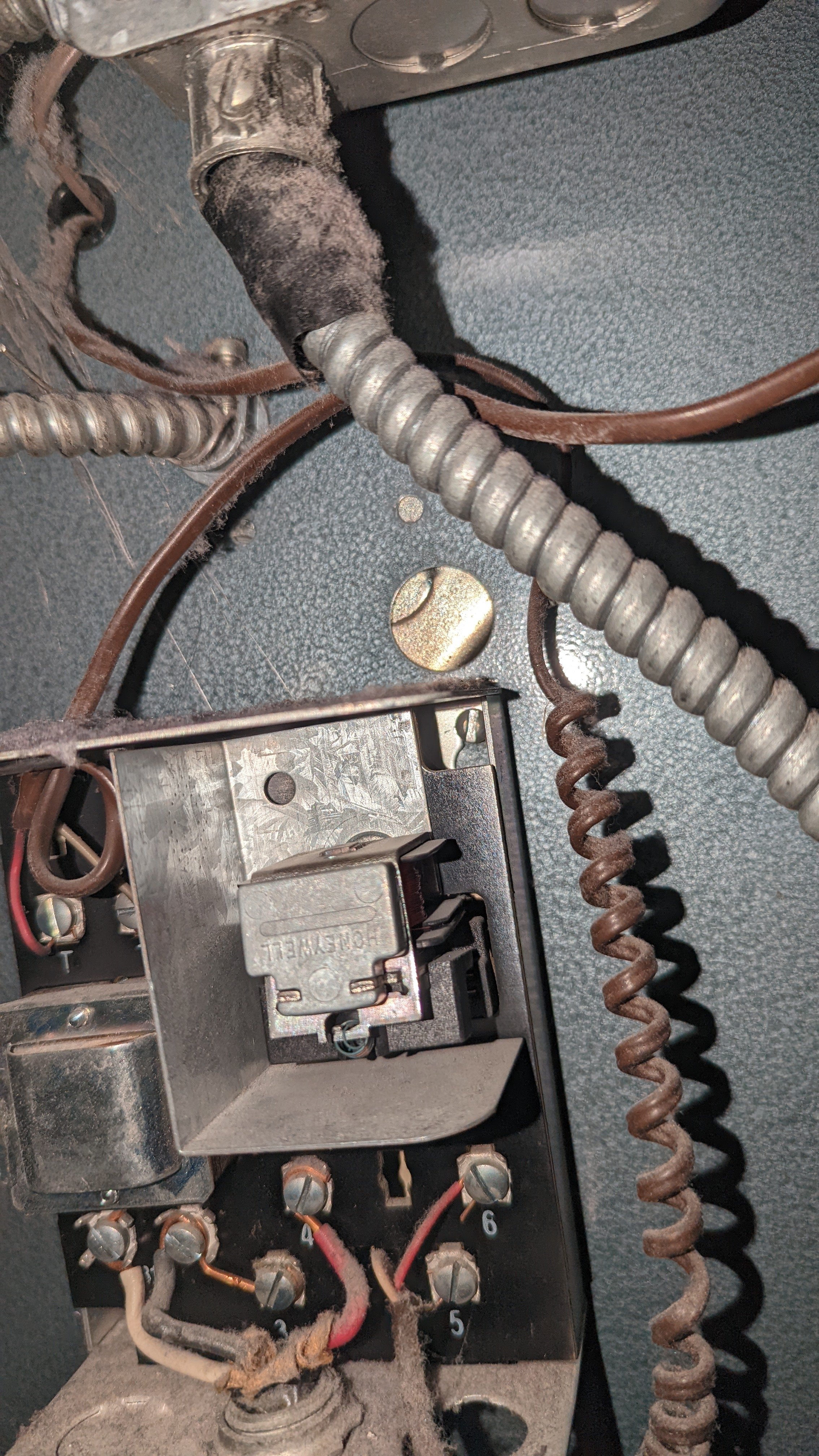

    I just looked at your 2 different circulator relays. they look like R845A relays that are using the 5 and 6 contact terminals to operate the burner circuit. I don't see any limit or aquastat controls in those photos. Can you post a picture of the other end of the wire from the 5 and 6 on the R845A controls?

    As far as using a 24 VAC thermostat for your main floor zone, this is where you would connect the thermostat. Remove this Red jumper wire and place the two wires from your thermostat on T T terminals. Then it will be wired just like the basement zone.
    The line voltage to terminal 1 on this R845A may need to be connected directly to power. the original wiring may go thru the thermostat before attaching to the 1 terminal. You will need to verify this.
