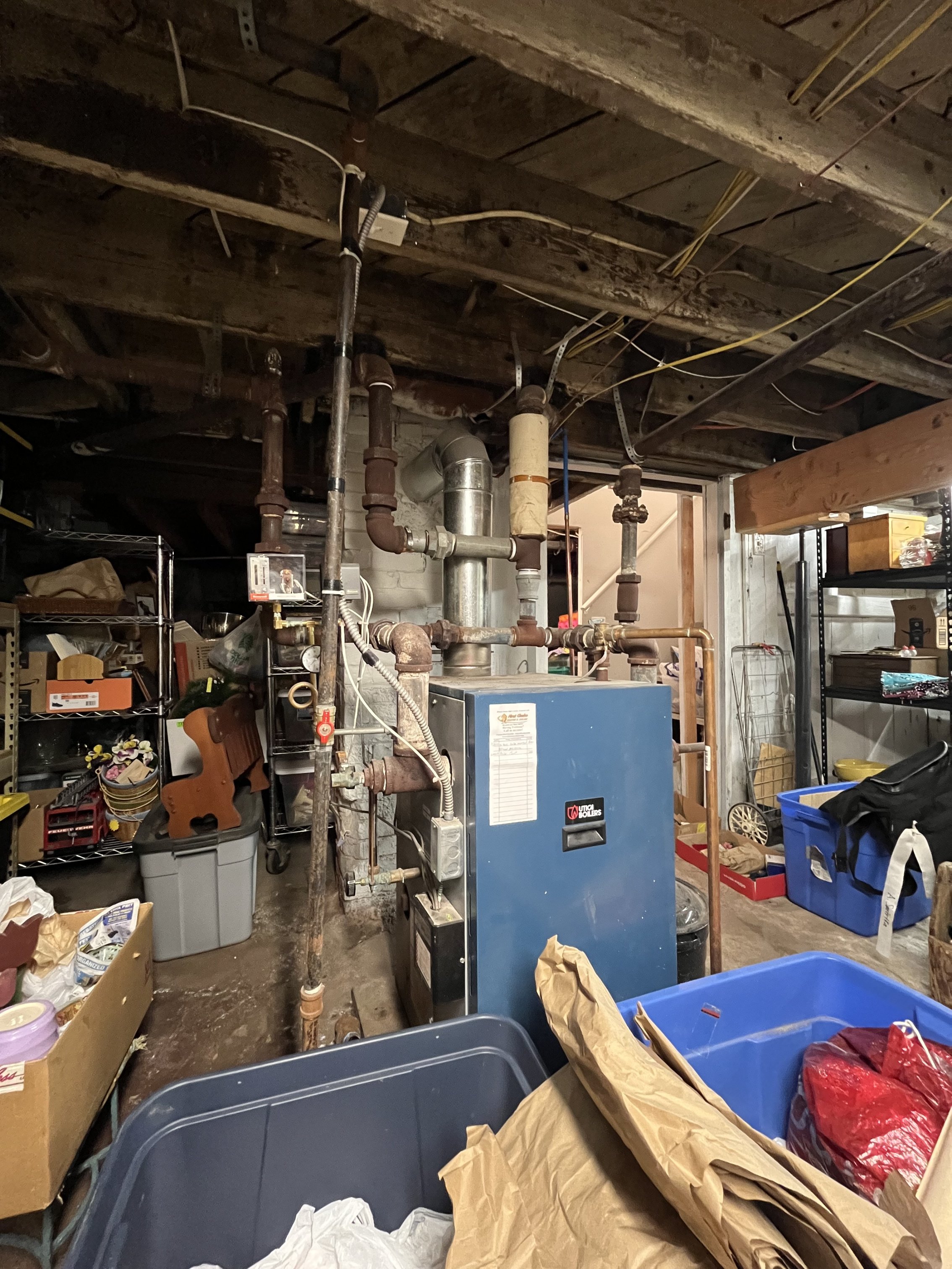

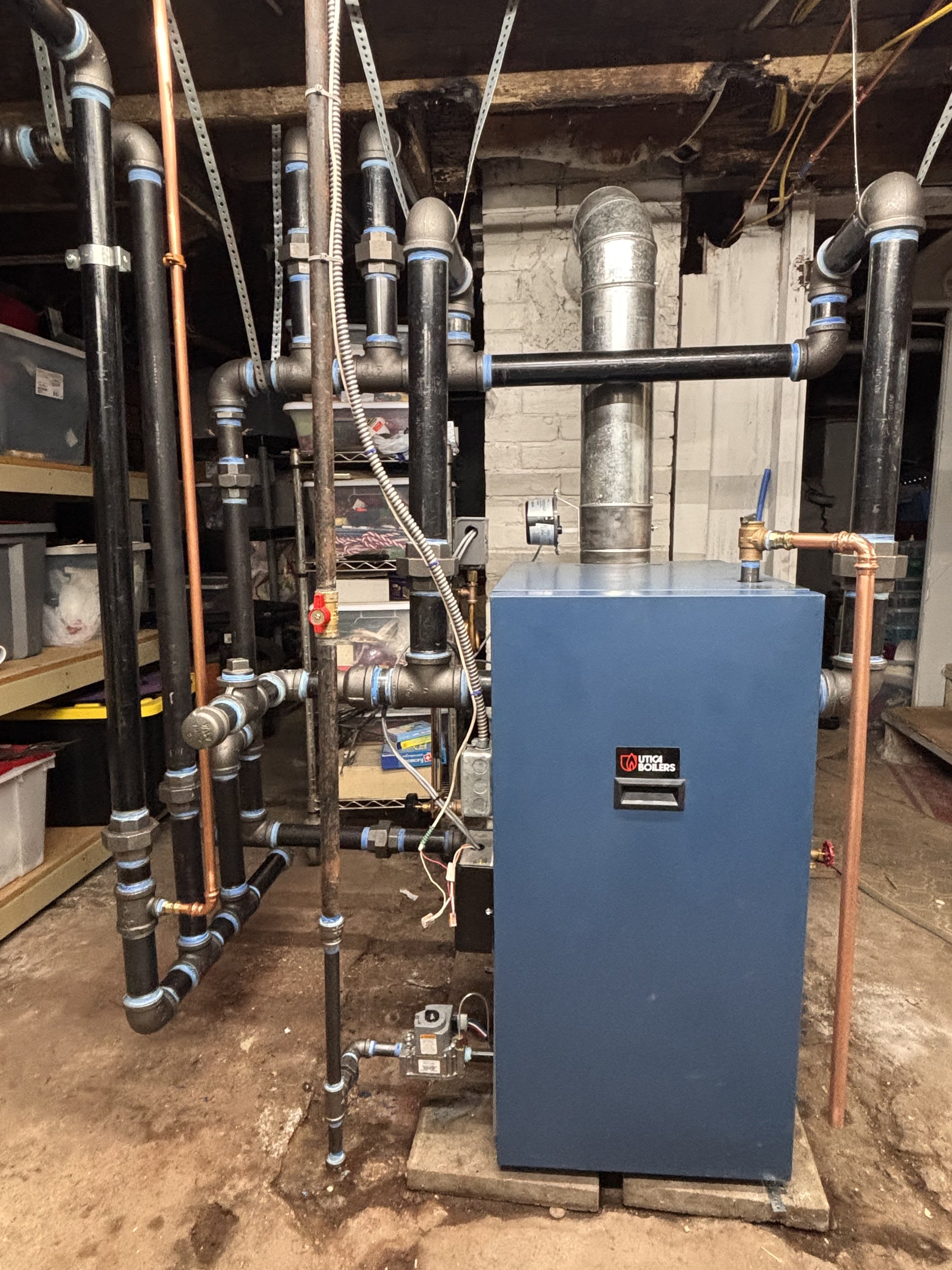

    make up is there. Image below. Yes, more skimming for sure. It’s bouncing all over the place. I want to get it up and check for leaks (none yet) then I’ll let it cool a bit and skim some more tonight and tomorrow. And then maybe again here and there through the week. My assumption is the oils in the pipes from cutting will be coming back to the boiler eventually.
    109A_5 Member Posts: 4,291
    " Not seeing a makeup water valve, usually it is kind of close to the boiler. "
    Still not seeing the Valve.
    ethicalpaul Member Posts: 8,958
    I looked up the Utica skimming instructions, and they don't mention adding some washing soda or TSP substitute like some manufacturers do. I found it cuts the oil and makes skimming far easier and shorter process.
    Run some of that detergent in the boiler for a short while and then skim. Nice install! I am also a little curious where the makeup water valve is 😅

    the valve to make up water is located above and behind the boiler on the wall. Where it was when I bought the house. I intend to relocate it to the copper pipe on the return leg when I drain it down next. Is that what you were looking for or am I misunderstanding. Picture is grainy but it is there.

    If the original valve is in good condition I probably would have just added a second valve near the boiler when installing the new pipe.
    mattmia2 Member Posts: 17,760
    i would keep both valves either way, give you more options when the one near the boiler fails.

    With respect to the valve I am going to keep the original and add a second near the boiler. Keeping it will allow me to add the second without draining down the system. The second valve will make service at the boiler that much easier. Having to monitor while operating the valve where it is located is a pain.
    I am going to keep on skimming. I did not add TSP or another detergent as I wanted to stick with the manufacturers instructions. If this does not get noticeably better over the next week or so I will deviate.
    The haze went away finally after a few hours.

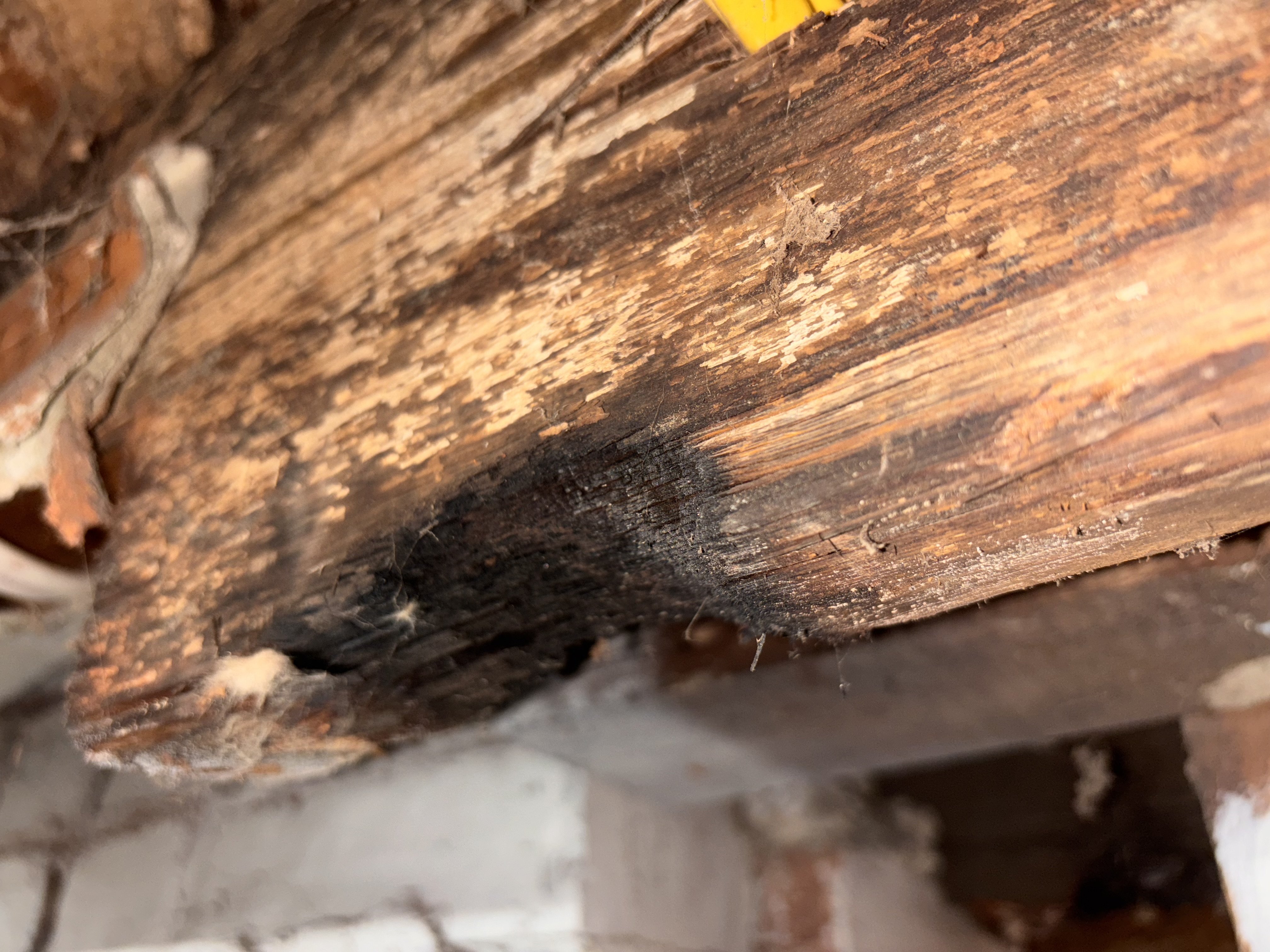

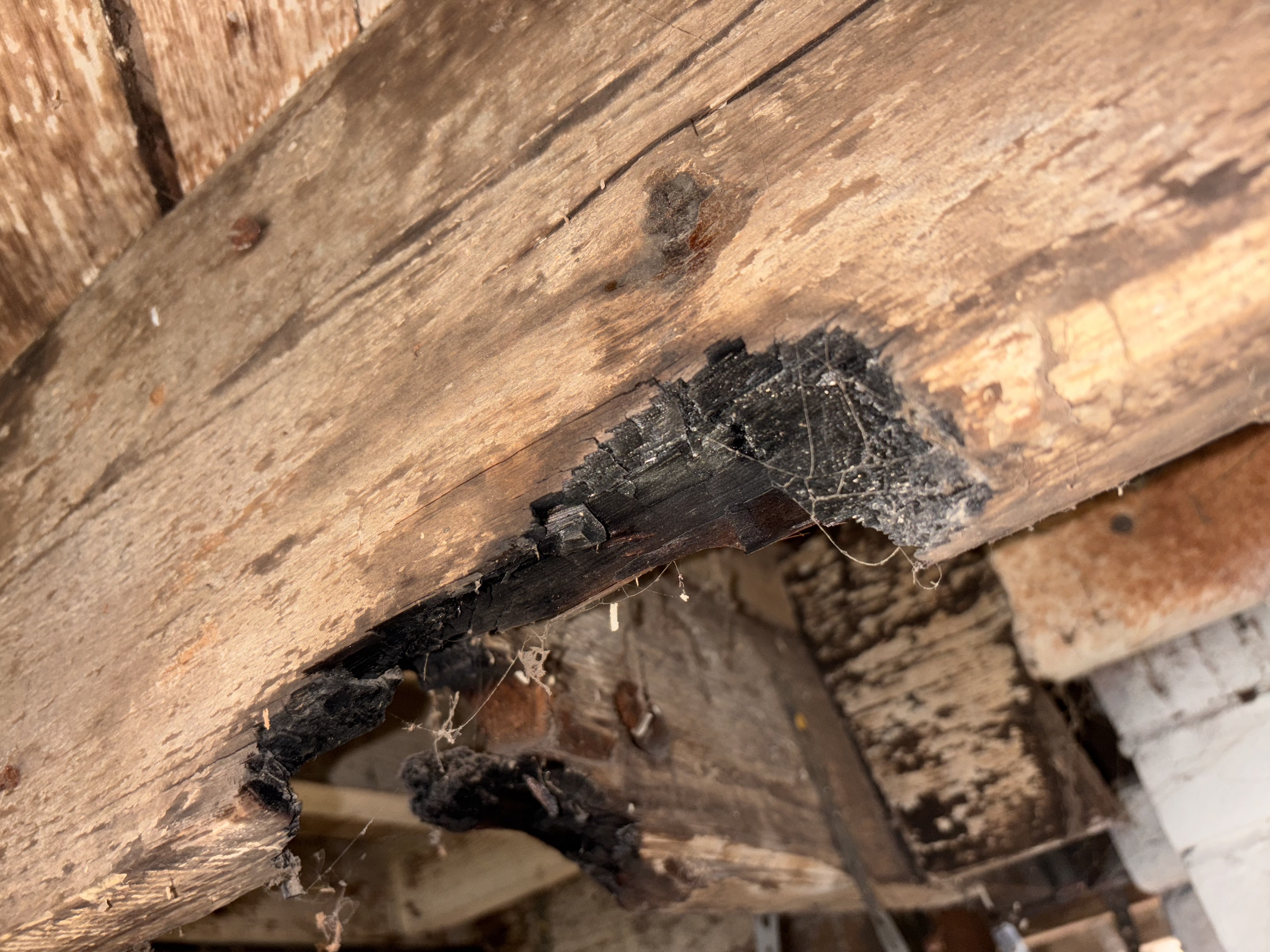

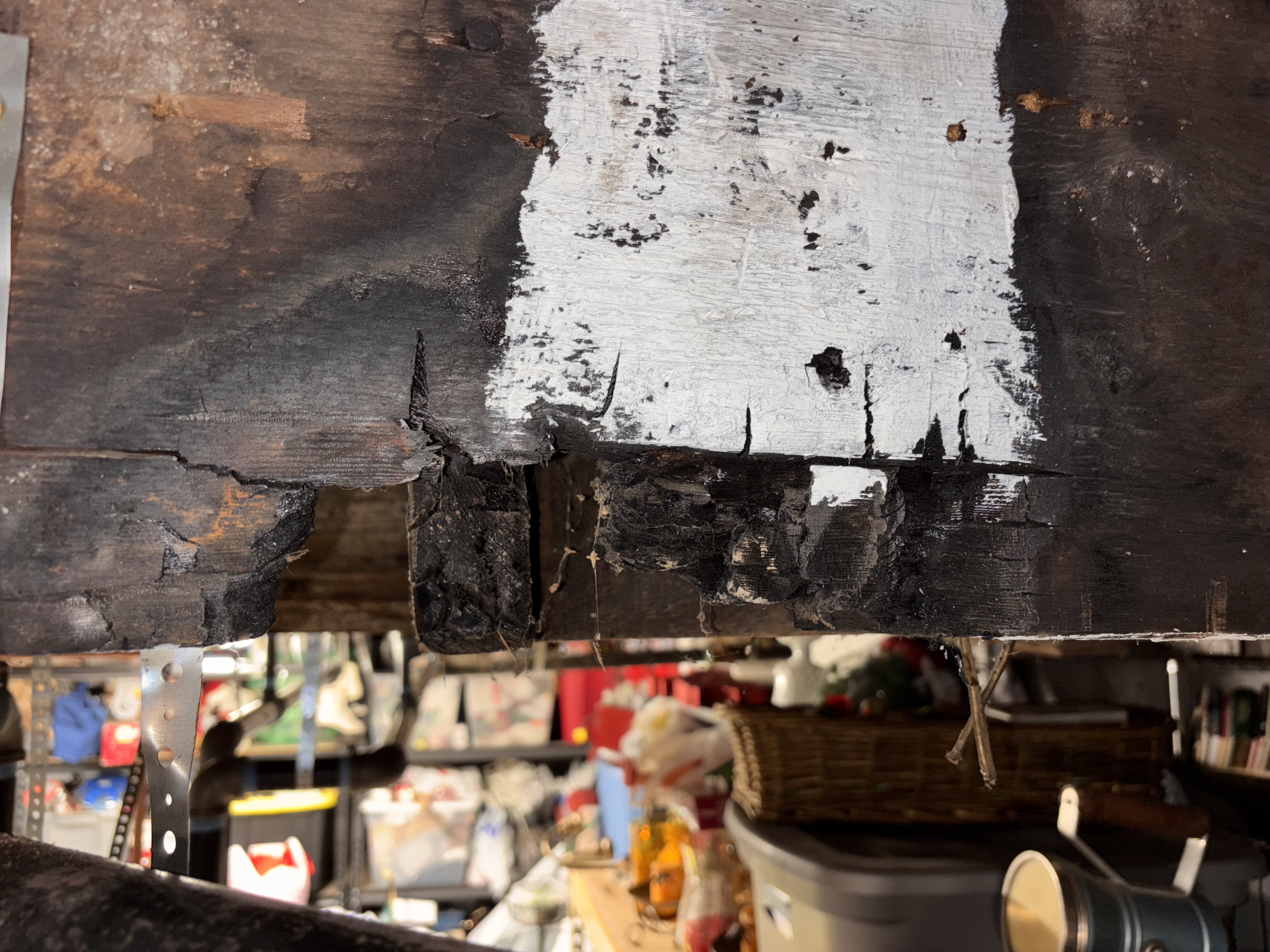

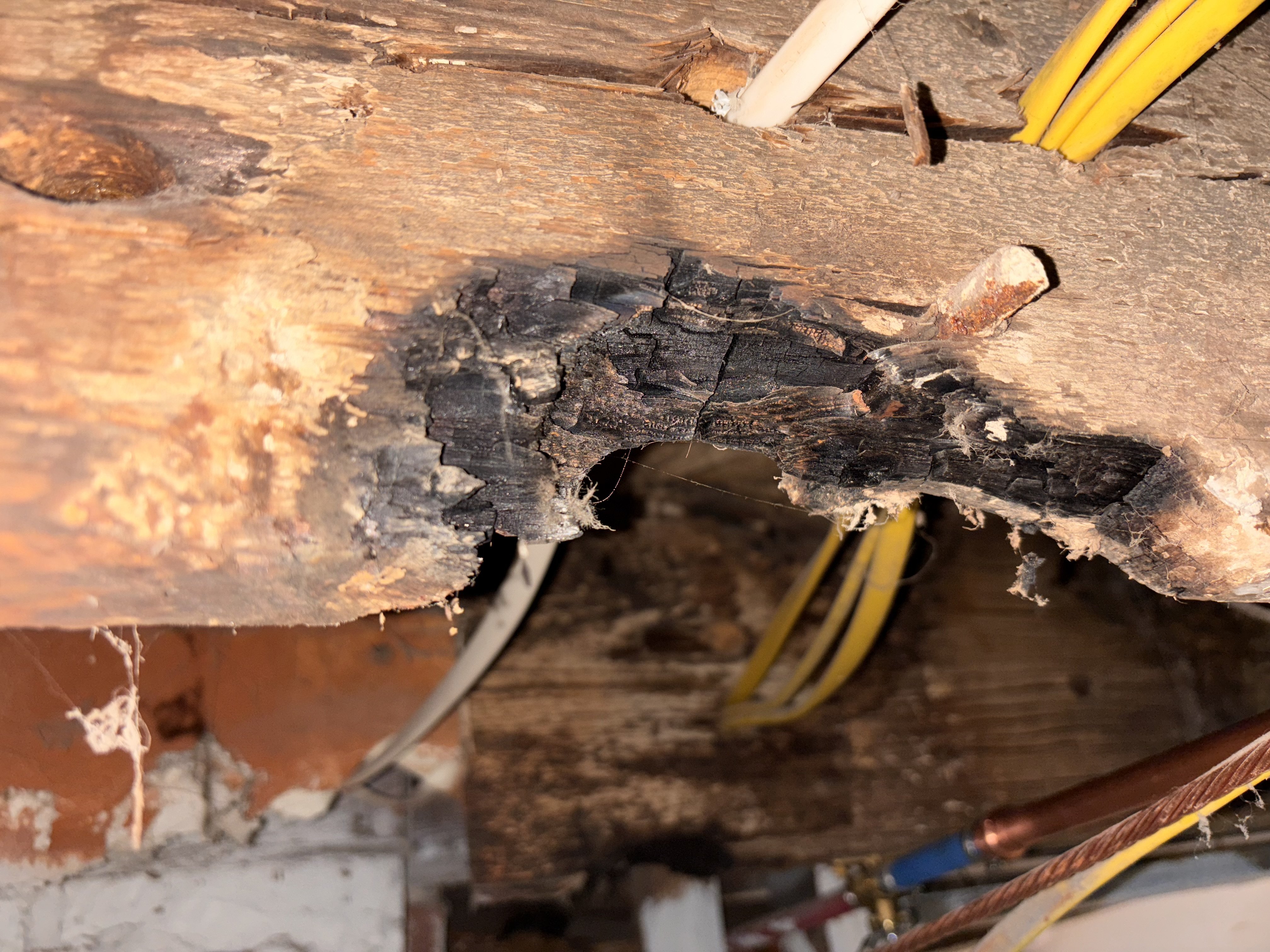

    Following up on the charred wood part of the conversation I took better photos last night and they are inline below. There is one board that looks like it may have been cut (third image) for pipe clearance. All of them are in fact charred. Two are near the previous pipe joints (1st and 3rd photo) which might be explained by irresponsible use of a torch when trying to remove pipes in the past. The other two were not near joints, unless there were joints there originally and they were removed for some reason.
    The house is old, 1890, and the joists in the basement are pretty dry. I do not think that would have made it any easier, or even possible, for the pipes themselves to create the char, just a statement on the condition of the wood.
    I tend to move into homes that need some (a lot) of work and this house is no exception. Sometime the reasons behind how the house ended up where it is is lost to history. This is likely the case here. My intention is to repair and maintain this house for as long as I stay here. I will do my best to not burn any structural members in the process…

    As far as charred wood goes, I'm sticking with my dry fired boiler theory. Enjoy your new boiler.

    Here's a thought about the charred wood. I wonder if someone used a cutting torch on it to get needed clearance for piping, same as if it was a steel beam?

    there may have been plaster or transite sheet on the ceiling above an old boiler and gaps in that around the steam pipes and there was a fire from the boiler or something near the boiler or something unrelated and the covering protected most of the wood. the white finish of some sort on some of the floor is likely shellac that was used to seal in the smell from the fire. depending on when it happened there may be permits with the city for the repair.
    Jamie Hall Member Posts: 27,648
    Whatever did that charring… somebody was either there, or fortuitously saw it very quickly. 15 minutes and that would have been a full fledged fire.

    I have seen charred ceiling joists in attics.
    First I thought wire joints arching but then realized it was from wire joint soldering with a blow torch. Knob and tube wiring was (supposed to be) installed with soldered joints.
    normally with a soldering iron heated with a blowtorch, not heated directly with the torch.
