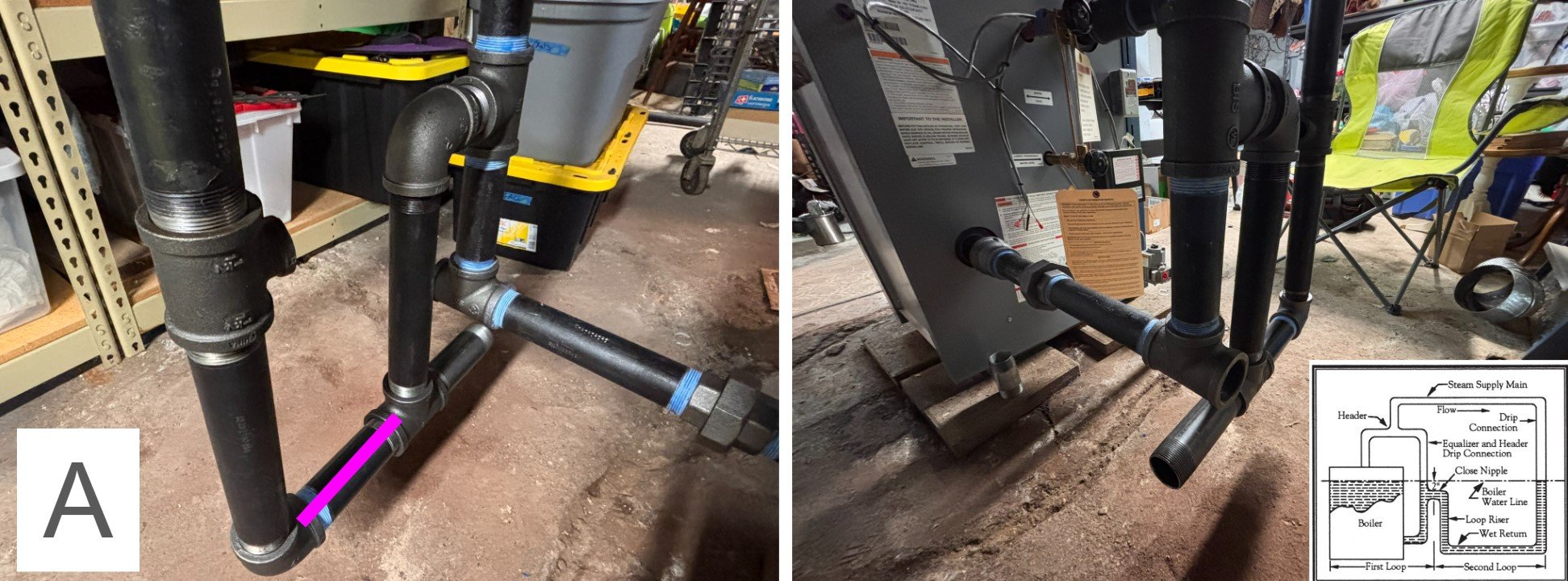

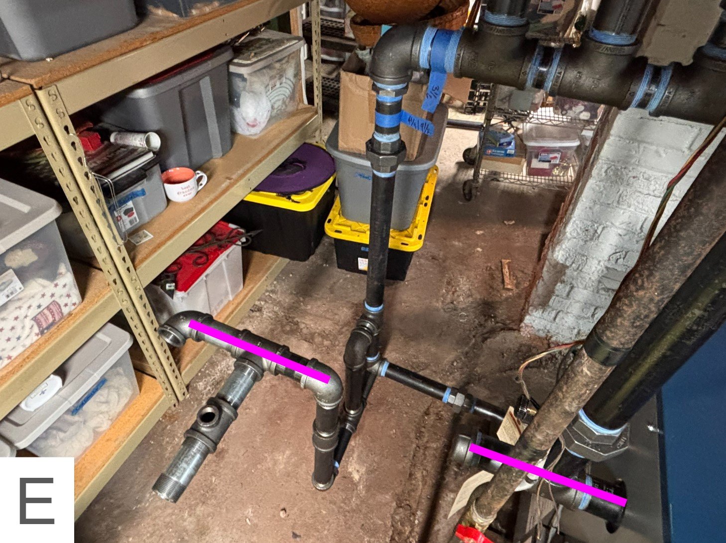

Does the Hartford loop bottom pipe have a minimum length (MAGENTA line in photo A)?

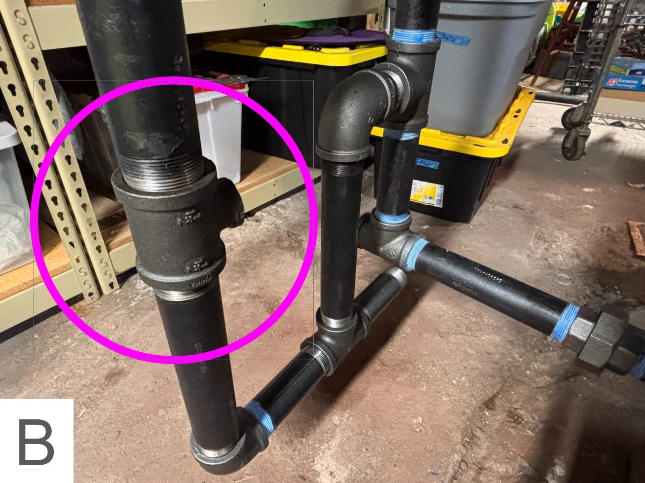

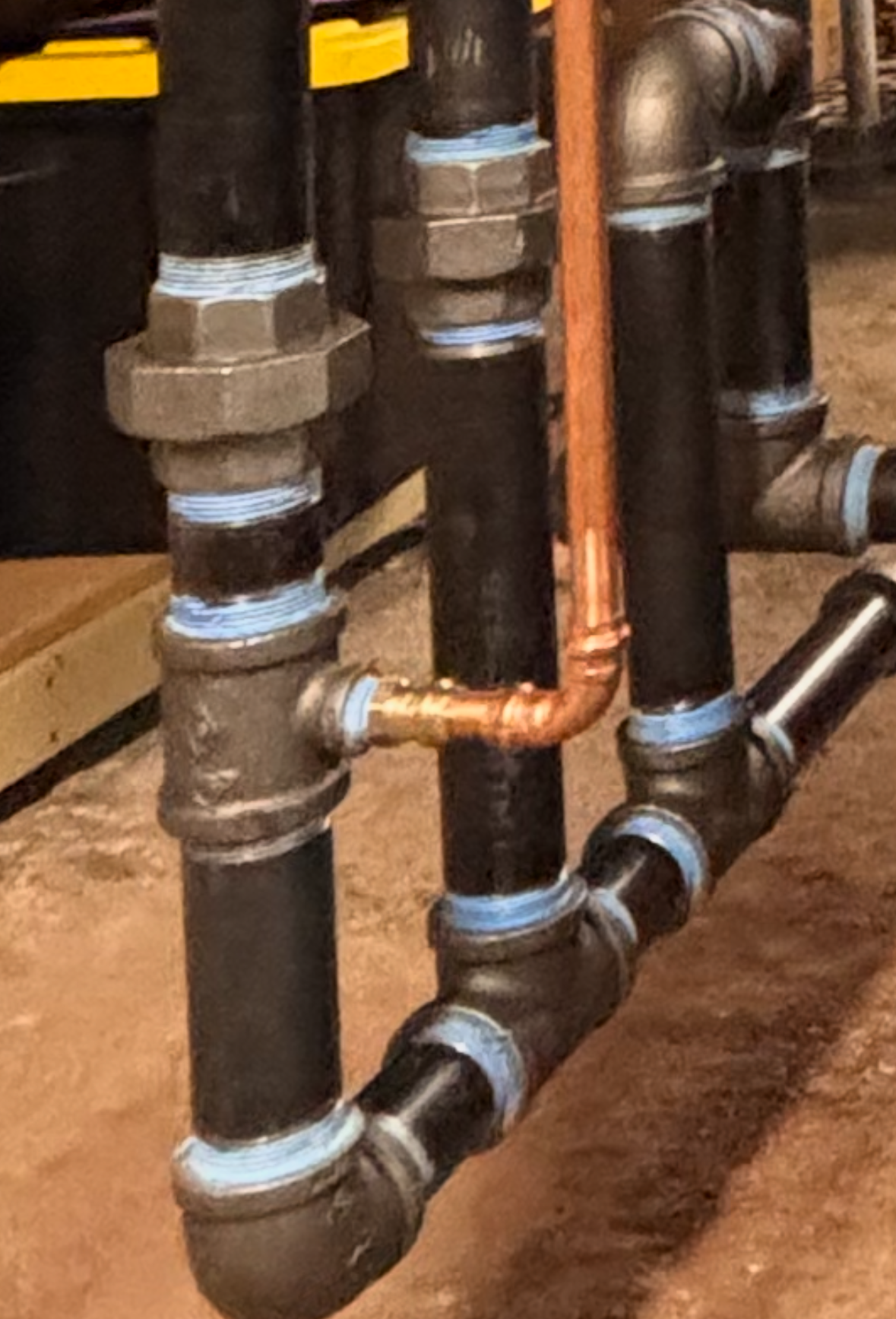

Should the TEE for the water feeder be below or above the water line? Photo B
I am planning on using a 1 ½” to ¾” TEE for the water feeder. I am going to place it on the return pipe prior to the Hartford loop.
Side question: should I supply from the domestic hot water side for the feeder? It seems like the water in the pipe would get cold waiting for a call from the feeder.

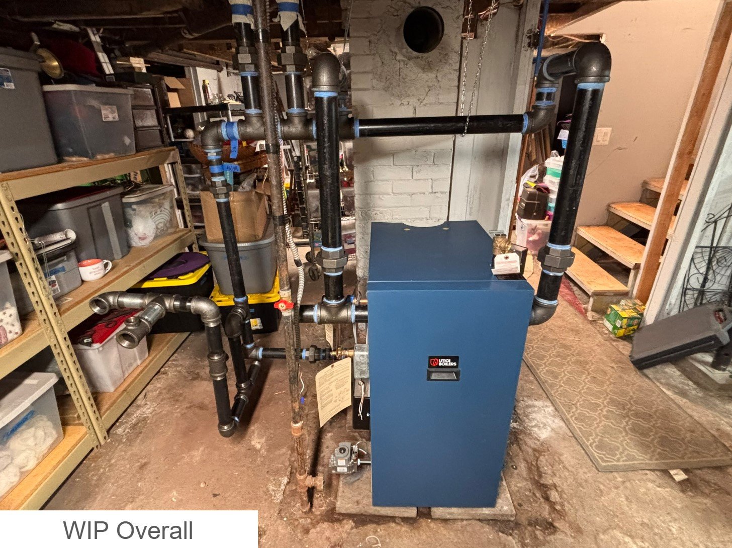

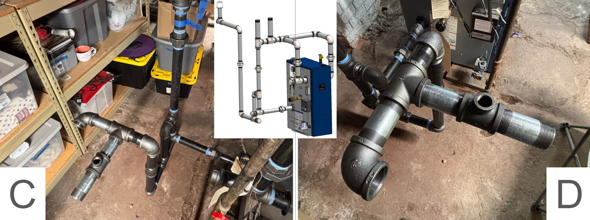

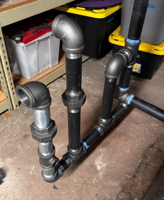

The photos C and D are of my mock up for the return lines. There are two, one coming back from the north and one from the south.
My plan would be to combine both return lines (both 1 ½”) at the ceiling and drop them down to the Hartford Loop. Would there be any issues combining both of the returns to one at that point in the system?
The 1 ½” to ¾” nipple mocked up on the one return will be for the main vent. Each would have one.

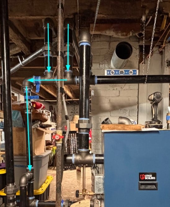

One other thing to note with my setup is that I flipped the Hartford loop from the back to the front (photo E). This was due to my mains leaving from the back and the returns coming in from the front.
I can’t see any obvious concern with this approach other than the left side of the boiler getting a bit crowded. Am I missing anything in that thought other than ease of access?

    mattmia2 Member Posts: 17,570
    the dry returns must drop below the water line before they connect together. if they connect together above the water line, steam from the main that fills first can flow to the main that isn't yet filled through the return and close the vent on that main, preventing it from fully venting and making it slow to heat.

    109A_5 Member Posts: 4,228
    " My plan would be to combine both return lines (both 1 ½”) at the ceiling and drop them down to the Hartford Loop. Would there be any issues combining both of the returns to one at that point in the system? "
    NO !! If this is a 'One Pipe' system the returns should be connected way below the water line at the wet return level. You need steam isolation at the end of the returns.
    Youtube, the "Silent Steam Team" videos, many example installs. Looks like you are trying to build it like the manual shows, Good !!!
    Is this a 'Close' nipple ?
    It looks pretty good. The over head returns may be combined together but they have to connect to each other below the bottom gauge glass tapping or lower is better. Same for the water MU below the water line into any return pipe.

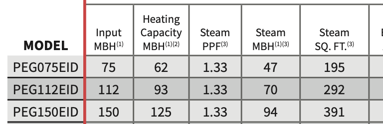

    The boiler model is PEG150EID. It is rated for 391 sq ft and I currently have @ 315 . I believe there was a radiator in the bathroom that was removed by a previous owner.

    I am glad I asked the question about where to combine the returns. I did not even consider that potential fight between the two sides. I have revised my direction, image below.

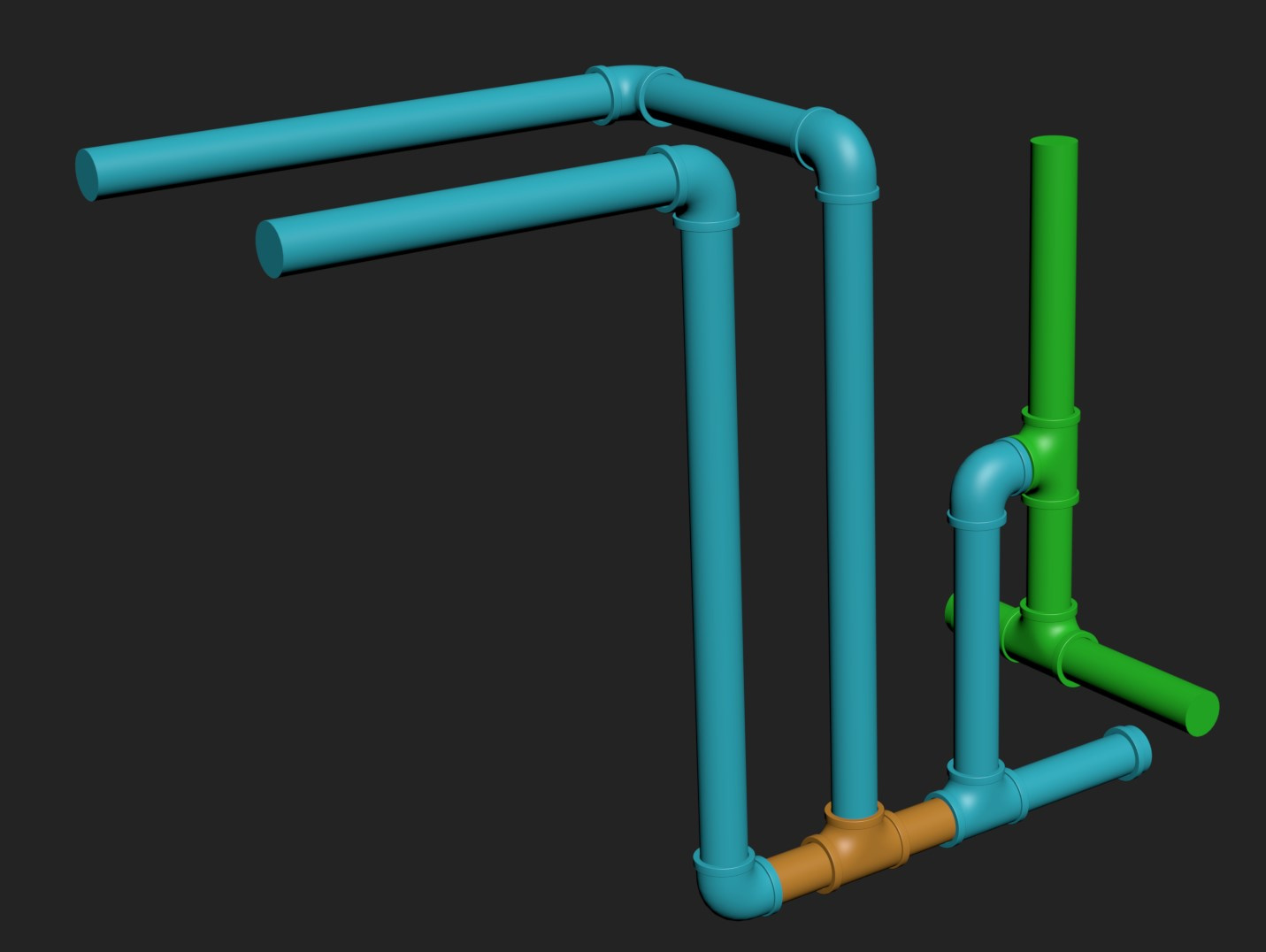

    The one question that no one had an input on was the length of the bottom pipe on the Hartford Loop (ORANGE in the image). Is there a min/max?  If I were to revise the returns as shown in the image above are there dimensions for that pipe that I need to be mindful of?
    I guess a subsequent question would be the size of the pipe. Would there be any concern from a volume perspective combining the 2 - 1 1/2" dry returns together into a single 1 1/2 wet return?

    ethicalpaul Member Posts: 8,933
    It doesn't matter.
    It doesn't matter. Just not from softened water.
    Someone probably already said this, but combine them under the waterline.
    But it's a pity you oversized your boiler. Why didn't you pick the 112?

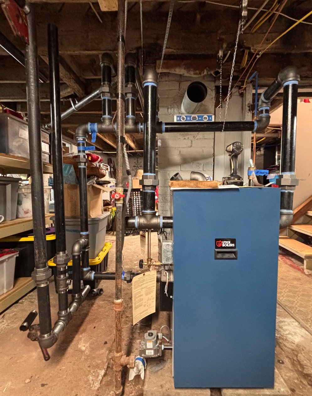

    Mocked up the return loop. Photo below. This feels pretty straight forward based on the feedback. Still with parts I have laying around, I will use the close nipple when I build it.
    David
    Looks good. I assume you are going to put a valve on that pipe that's pointing toward the black plastic bin for very occasional flushing of the very short wet return?
    @SMRTK
    Length of the orange nipple does not matter. Anything goes below the water line. As far as combining the 2 1 1/2 returns into 1 that is fine as well.
    The overhead returns carry steam and water, so they are larger when you drop below the water line they are wet returns and the smaller pipe is fine.
    Should work well Congrats.
    Steamhead Member Posts: 18,735
    Those pipe sizes are fine for that model boiler.
    And as others have said, do not combine the returns until they drop below the boiler's waterline. This will keep steam from going into one return and coming up through the other one, which can cause banging and unbalance.

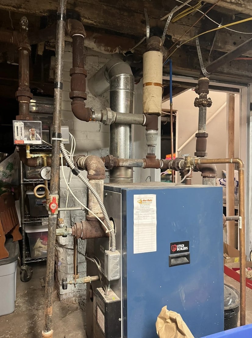

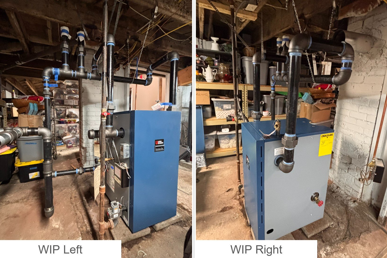

    What was there before is what I am trying to avoid (image below)

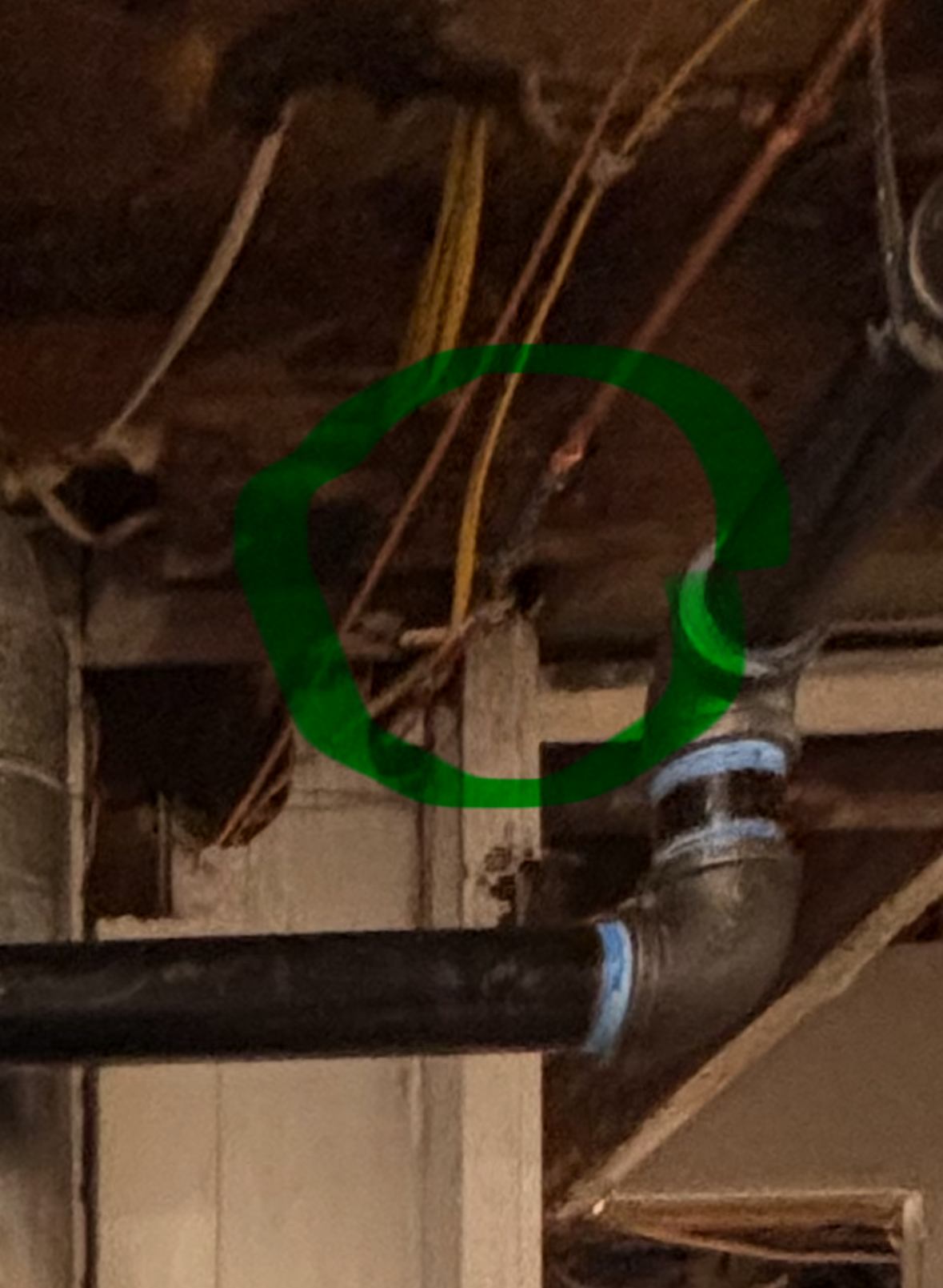

    My concern is where the supply lines start at the ceiling. As mattmia2 said at the end of his comment, I can't get the mains high enough with the clearance I have. I can probably get the slope back to the boiler, however, I may be touching wood at that point. Everything on the supply piping likely needs to be redone, for now though I need heat. The NBP should help considerably compared to years past, I imagine my returns will just be "slow". As I have been checking for slope they are all just a little bit sloped with one I check being level. The house has settled over the years (built in1890) so I will go back and readjust. That will make my clearance issues at the boiler worse not better most likely.
    What is a drip and do I have counter flow at my boiler? Sorry, still learning.

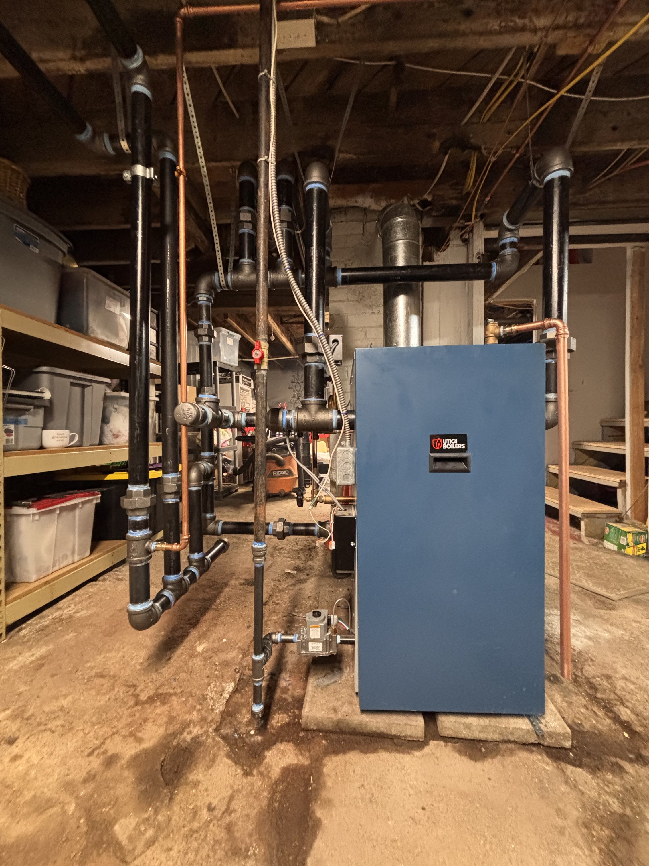

    Latest photo of the new return mock up at the bottom

    A drip is a return teed off the bottom of the main to drop the condensate out of the main and down in to a wet return. It drops down below the water line and individually connects to a wet return. It allows condensate to drain out of a low spot in a main when it can't be sloped to the return.
    Can you drop the return ends of the mains down a bit to get the needed slope?

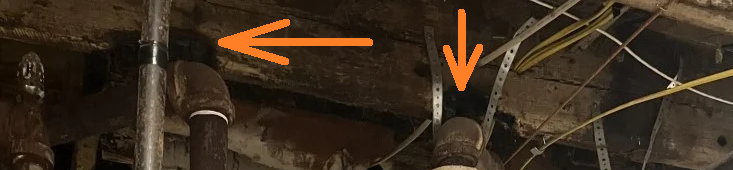

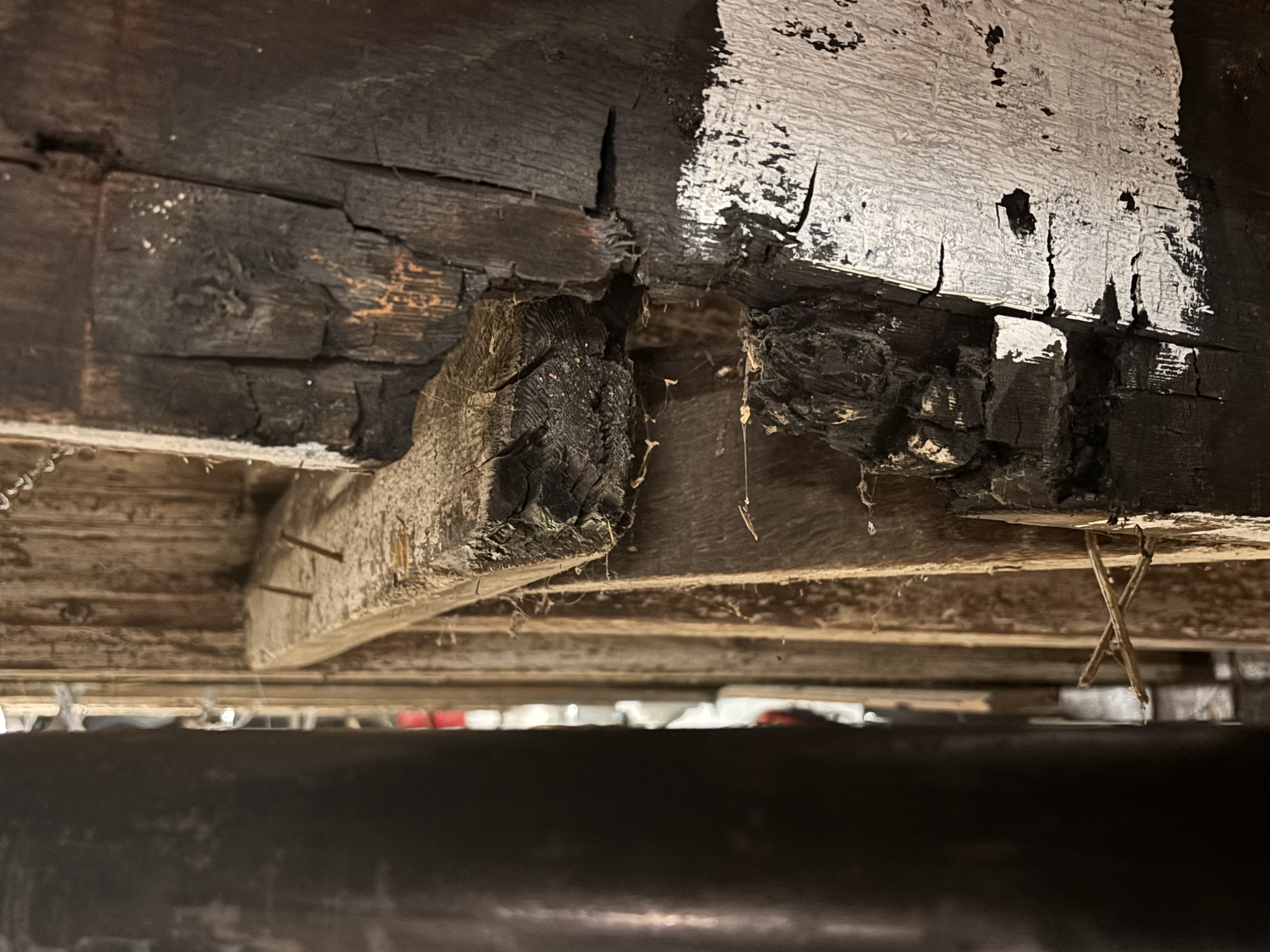

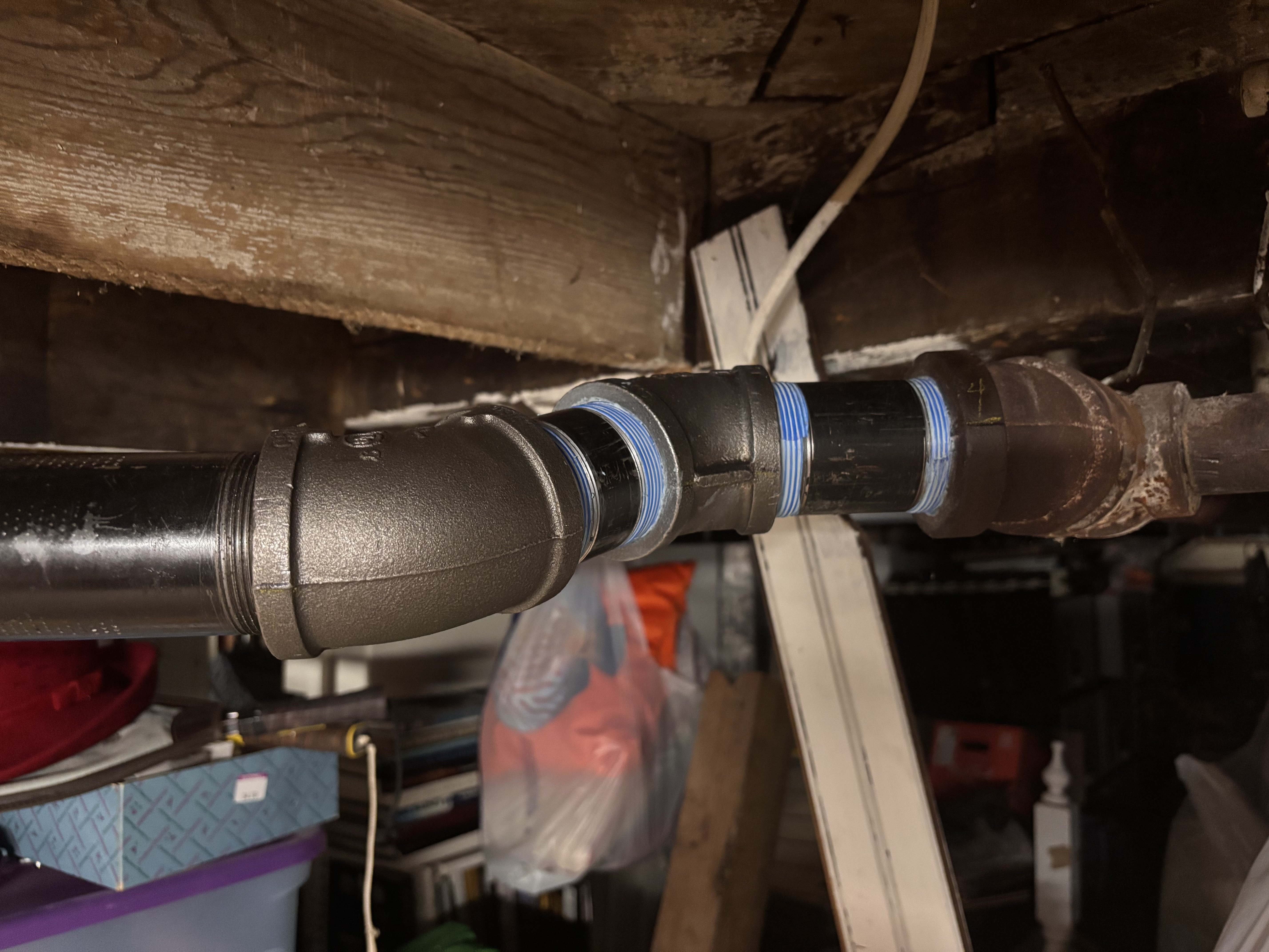

    The clearance issue was a bigger deal than I originally thought due to the existing supply position, house settling, bent pipes or whatever may have caused it. I’ll need to repipe in the future. Either way, I had to drop the one main about 2” or it would have gone through the floor by the time it hit the risers (slight exaggeration) Photo below. The run from the riser to that offset is roughly 5.5’.
    The second picture is charred floor joists. There are others nearby where there were joints which I wrote off as someone being careless with a torch while encouraging pipe removal. That one was in the middle of the pipe. These shouldn’t get hot enough to burn wood. Right? .
    this particular pipe has been a pain Almost there though, hopefully
    steam is only ~212f, nowhere near hot enough to burn wood. the pipe just needs enough clearance to move without making noise.
    i can't tell for certain in those pictures but it looks more like rot than char
    Grallert
    edited October 2025
    That joist dilapidation does seem strange. Kind of makes me wonder if there was a dry fire event that was caught in time.
    If it is in fact rot there probably was a steam leak there. Two steam leaks ?

    Thinking through how it was before, even if the NBP was wrong, that pipe made it over in one piece with no crazy offset like the one I just built. I bet they put it in, braced it from below and then had a couple of guys hang on it. That’s the only way it would have made it without the offset. I’ll need to look at the pipe in the morning to check that theory. If that is the case it still would have been counter flow. Then again not much was right with that piping. At least not for the newer boiler. Someone showed me (Ed I believe) what boiler might have originally been there. The piping made more sense with the older boiler.
    The spot I photographed is in fact char. Picture doesn’t show it correctly. The temperature would not be hot enough as noted. I’m a good bit away now so I’m not worried. Once I know I have no leaks I’ll insulate as well.

    I have steam pipes so close to wood I can't tell if they are touching or not, no dilapidation like that. I'm sticking with a dry fire event that was caught in time.
    edited October 2025

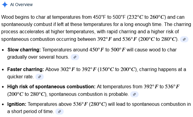

    Torching without protecting the nearby combustibles is severely reckless. Isn't AI great, Faster charring happens at a lower temperature ??!!??

  • SMRTK
    SMRTK Member Posts: 49
    I am up and running and have heat! Unfortunately I also have a hazy house that I believe is the burn off from the new piping…hopefully that’s it and it goes away
    My heaters running and I have the windows open and fans running like it’s June.

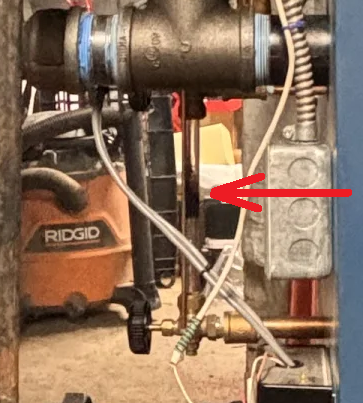

    Question on the pressure gauge. It’s been running for a bit now and I am not seeing the gauge move at all. Should it?
    no, not if the boiler is the correct size.
    edited October 2025
    If it is a 30 PSI gauge that may be a good thing. If your boiler is properly matched to the radiation the pressure should be very low. My slightly undesized boiler heats the house just fine at no more than 2 inches of water column (or 0.07 PSIG). I added some low pressure Dwyer Magnehelic Gages to see the actual boiler pressure.
    Not seeing a makeup water valve, usually it is kind of close to the boiler.
    Looks like some skimming is needed.
