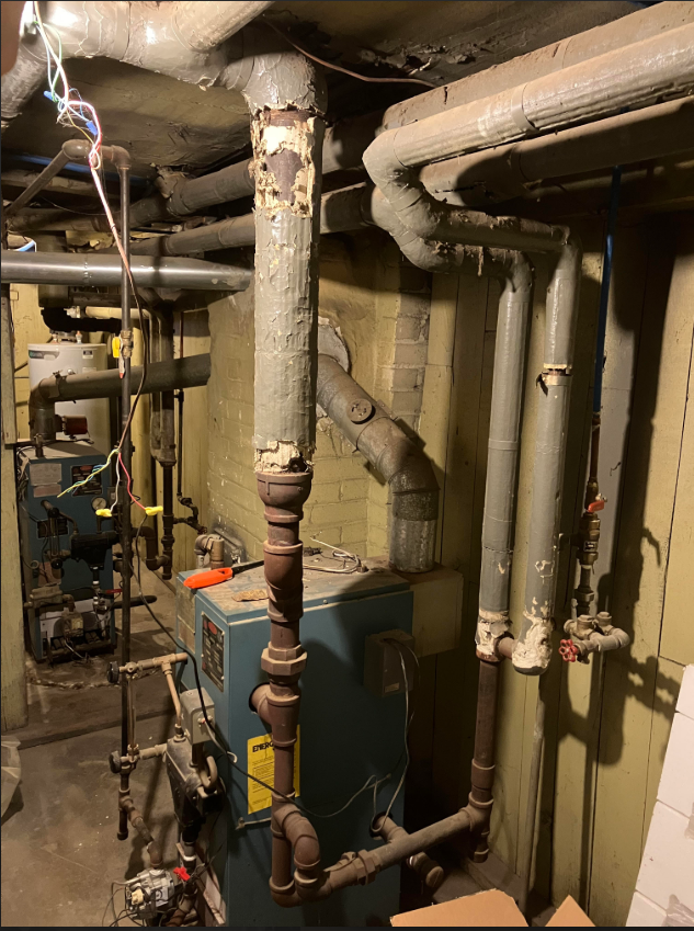

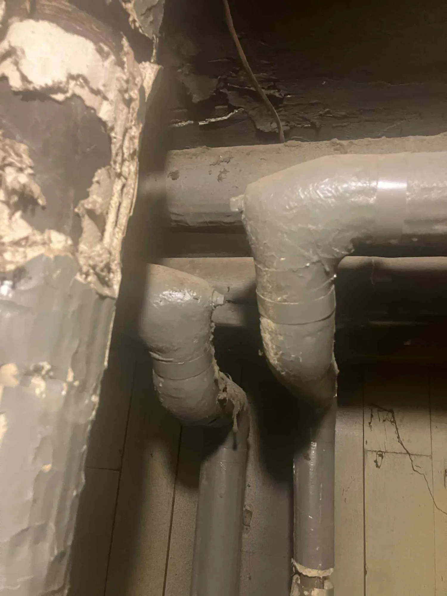

Hi,
I'm by no stretch a master at steam heat, but it's been pointed out to me on several occasions that the "main vents" in my steam system(s) have been plugged (I say systems because I have a duplex with separate boilers).
Long story short, I am wondering if A) it's a good idea to replace the plugs with new main vents (something like this) and B) what are the proper fittings and vents that I need in order to properly install main vents again. In one of my units it appears that there is only one plug, in the other it appears that there are two spots that have been plugged. Should any and all plugs receive a new vent?
Please see the images below:
Unit A:
Unit B:

    mattmia2 Member Posts: 17,565
    if it is a 1 pipe system and there are no vents on the dry return somewhere then it needs vents where those plugs are but the parts of the asbestos that are falling apart need to be dealt with first.

    109A_5 Member Posts: 4,228
    If there are no other main vents in your system, you would most likely benefit from installing main vents. Have you inspected the actual far end of the mains for vents. At the pipe transition from steam main to steam main extension, often called a dry return (typically the farthest point away from the boiler).
    If those (pictured) pipe plugs are removed and those tappings are used the main vent should be offset vertically then horizontally so to minimize any damage from water hammer. Main vents usually have 1/2 or 3/4 inch pipe threads.
    If there is more than one main from a single boiler, each main should be vented to best balance the venting of the steam mains.
    Gorton #1 and Gorton #2 and Barnes & Jones Big Mouth BJ-2BM / BJ-3BM are popular main vents.

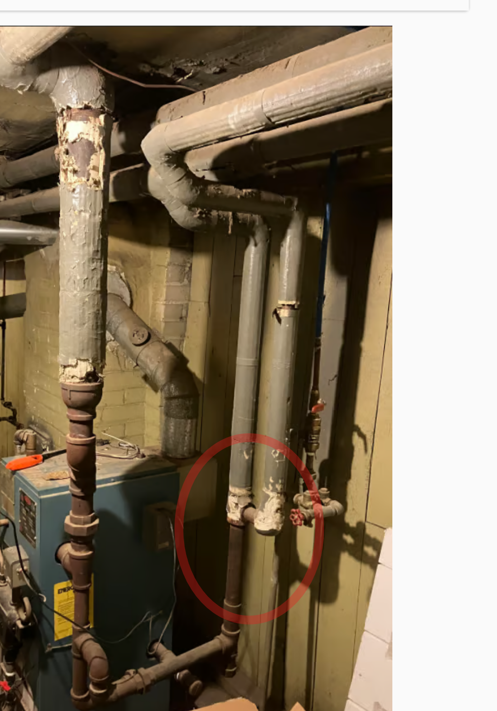

    Ignore the beautiful electrical work going on connecting my thermostat and boiler. Could you help me understand which is my "main"? Thanks.

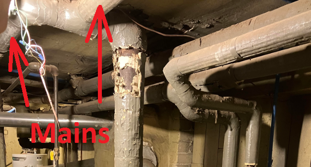

    Jamie Hall Member Posts: 27,600
    The "main". Start with the pipe coming straight up from the T on the side of the boiler in the first picture. That's the beginning of your main, and it remains a main all around the basement until you get to the very last radiator takeoff. It may split, in which case you now have two mains…
    And it needs to be vented, which can be done anywhere after the last radiator takeoff and before it drops to the boiler.
    Now it looks as though you have at least two drops — they're also in that first picture — and it looks as though one of them may have a pipe from a near floor level pipe, which probably picks up a drop somewhere else in the basement. Problem. Those to drops join above the water line, and that may give some problems. Have to see more to know.
    Problem number two: the insulation on those pipes has asbestos…

    This would have been ok on the original boiler with a water line that was above this point, it is not ok with this boiler where it is now above the water line as @Jamie Hall said.
    I thought i was looking at a mirror for a moment until I relaized there were 2 boilers.

    If it means anything, as @mattmia2 noted, there are two boilers (house is a duplex), and the boiler in subject supplies heat to the 2nd floor of the house and nothing on the first floor, just for what it is worth.
    Also, it sounds like you are saying that neither of these plugs are part of the line that would be considered the main.
    The issue that you are both signaling, I presume has been there for a long, long time. I had to have a thermopile replaced on this boiler last winter, and the HVAC co. laughed when they realized how old my boiler(s) are (1970 - 1975 or so). I guess the point is… not knowing how much time I have left on these boilers, is it even worth doing anything at this stage on either the drop issue you are talking about, or adding vents to my main?
    I plan to just wrap the insulation where there is asbestos, I don't see a reason to do anything else.

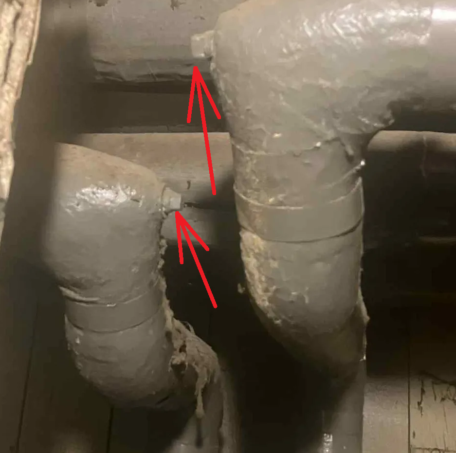

    Those are probably dry returns/main extensions and those plugs are probably where the main vents were. Without main vents you will have the problem that having the returns connect above the water line causes all the time, namely that the air can't get out of one (or in this case both) of the mains.
    That asbestos looks like it would come loose if you tried to wrap it in something.
    eddymoney
    Unless there are presently vents at the far end of the mains, the vents could be added here.

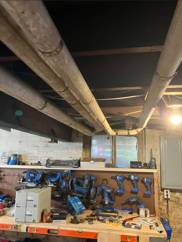

    eddymoney Member Posts: 21
    Thanks everyone for the help, learning a lot here.
    To answer this question:
    • The line that goes off to the right the right (from perspective of @109A_5's photo) measures about 183" or 15' 3" before it returns
    • The line that goes to the left measures 321" or 26' 9" before it returns
    • It's hard to tell because of the insulation, but I believe the mains are 2" in diameter. The return pipes are smaller, probably 1.5".
    Let me know if this makes sense. One challenge that I am foreseeing is that there is limited space to work above these pipes if I am installing vents here, particularly with the pipe on the left (in picture below) as the main for the other boiler runs right above it.
    you can use some 45's to offset it and bring it up straight next to an obstruction. the bigger issue seems to be that it appears to be embedded in asbestos lagging.

    Any advice on removing these small plugs? They are square and appear to be less than a 1/2" in diameter (I haven't actually measured yet). I briefly put a crescent wrench to one, but it felt a little bit delicate. They do not appear to be imbedded in the lagging, for what it's worth.
    4 point or 8 (double square) point socket of the appropriate size and a breaker bar. Heat from a torch on the threads may help. If the square part breaks off you are in for more work.
    eddymoney
    those are just cast to an approximate size, they aren't an exact size or frequently even the same size one set of faces to the other.
    Some have a taper to the square also. A file may help fit it to a socket if needed. I think a firm grip of a socket is better than a adjustable wrench or a pipe wrench. I'm sure @eddymoney could measure it first instead of just buying any random socket. A 12 point may work too but the contact area may be less.
    the problem is that if it is hollow it might shear off and you'll have to make 2 cuts almost to the threads with a hacksaw or thin reciprocating saw blade then knock out the piece with a chisel. a pipe wrench or big crescent wrench will get it out if it is going to come out.
    eddymoney
    To me a shear is more likely to start with less points of contact. I'd heat it first, maybe a few heat cycles, don't burn the house down. I prefer finesse to bull in a china shop almost every time. With restricted access I don't like to make myself more grief than needed to get the job done.

    Okay friends - a couple updates:
    I successfully removed the plugs. They happened to be 3/8" diameter squares, so what I ended up doing was taking a 3/8" socket drive bit adapter, placing the female socket side on the plug, and then using a crescent wrench on the male side (with a small piece of 1.25" cast iron pipe for leverage) to remove the plugs and it worked really well. I did add some heat which I think made a difference.
    Here's my installs - I think they turned out well, and they were actually pretty fun to do (not as messy / involved as other house projects). I probably could have used a few less pieces but the store I went to didn't have every single side reducer / bushing / etc. I didn't remove any ceiling for smaller vent (I could have to add a taller riser), but I did for the larger Gorton. I needed to move that one out of the way of the main above it, hence the direction - I'm not sure why I used a 45 degree fitting for the first turn, other than that I was thinking it would vent more easily with 45 degree fittings vs. 90 degree fittings (could be wrong and it doesn't matter). I am little concerned that the small street 90's that I had to use for the initial fitting will wear down over time but I could always add some support with like a string to the joists to vent trees / etc.
    I'm not sure how to assess how well they work, although I will say I have not heard any whistling from my radiator vents anymore (something that was pretty common before).
