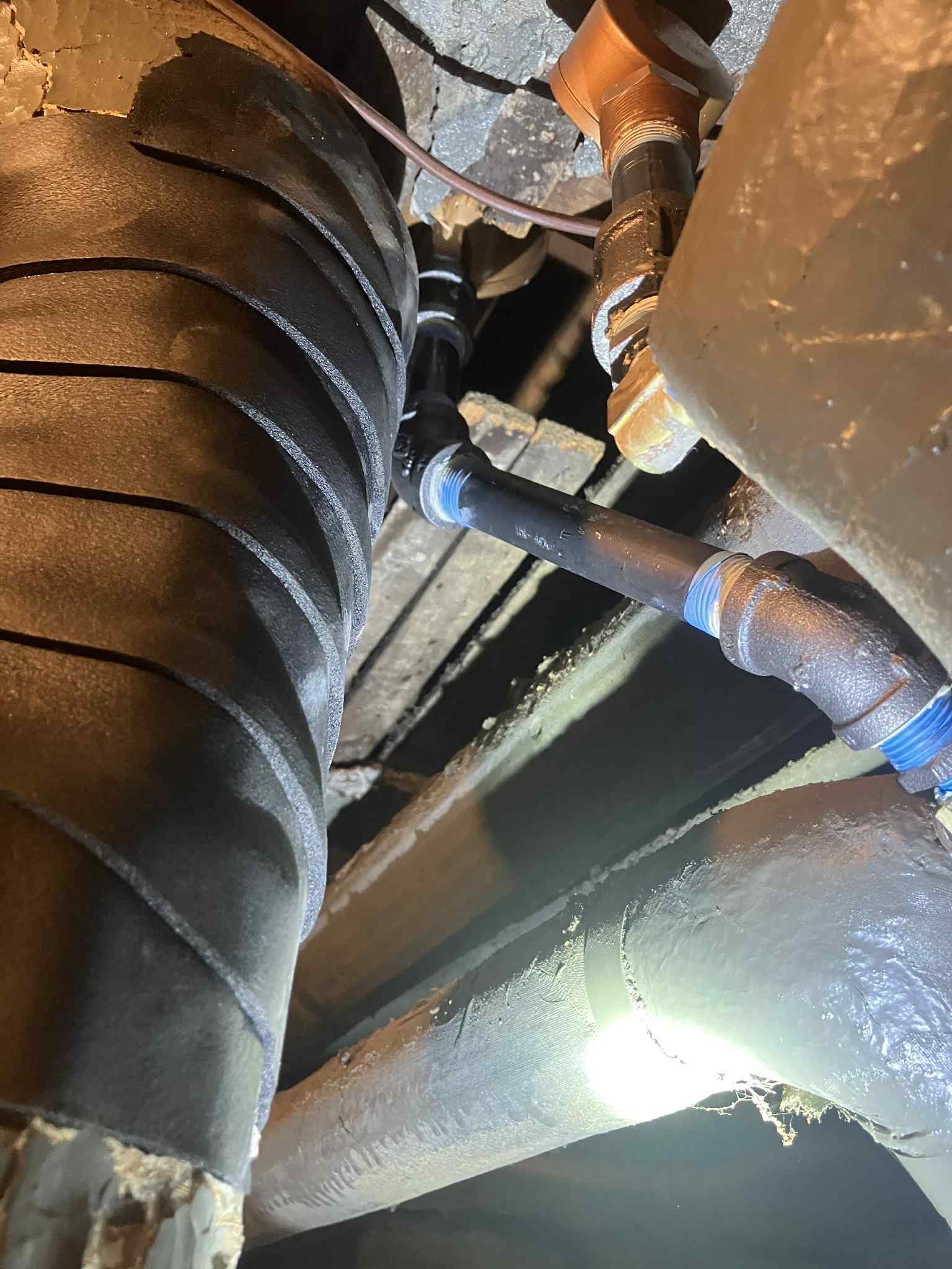

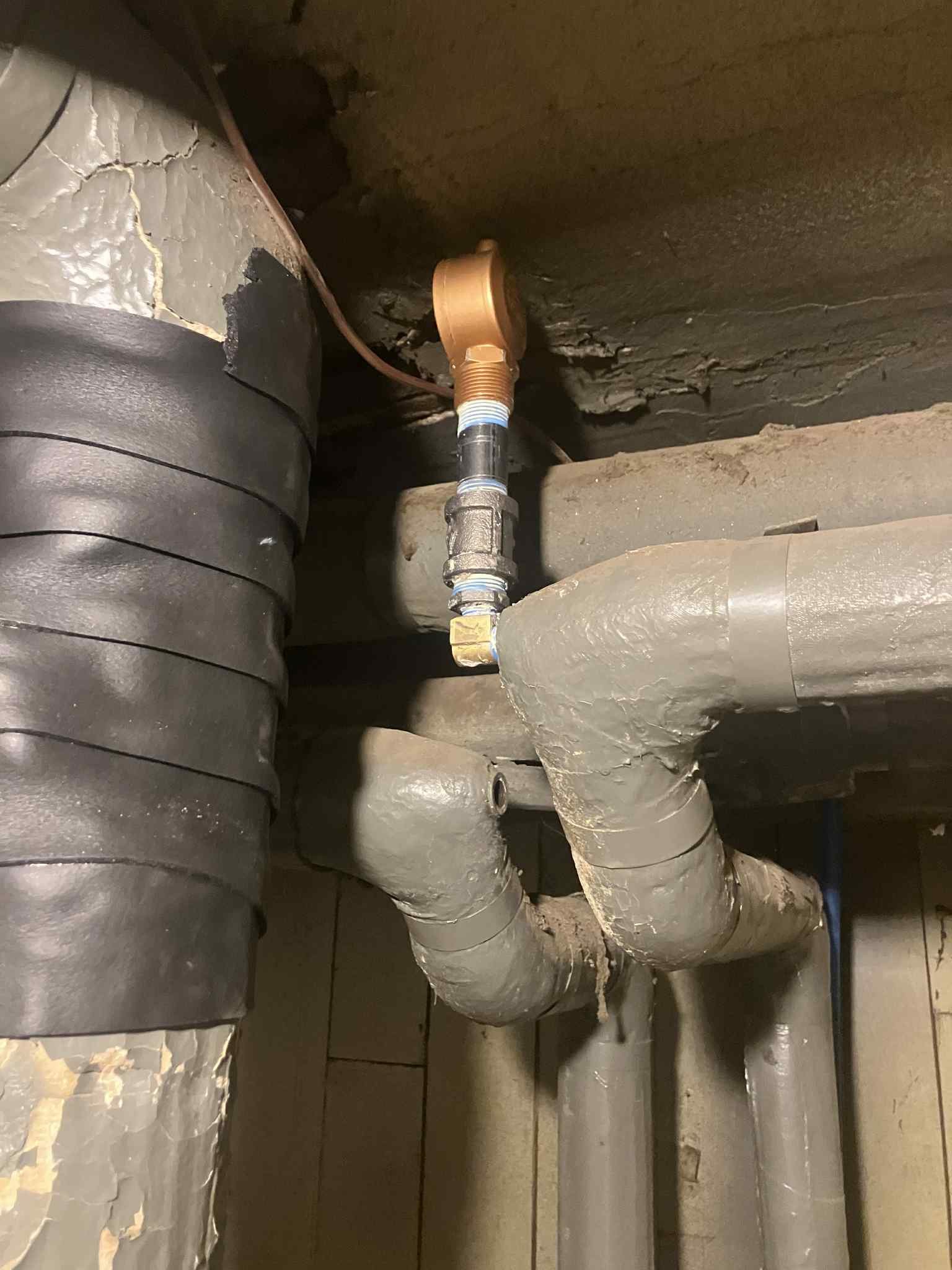

    Okay friends - a couple updates:
    I successfully removed the plugs. They happened to be 3/8" diameter squares, so what I ended up doing was taking a 3/8" socket drive bit adapter, placing the female socket side on the plug, and then using a crescent wrench on the male side (with a small piece of 1.25" cast iron pipe for leverage) to remove the plugs and it worked really well. I did add some heat which I think made a difference.
    Here's my installs - I think they turned out well, and they were actually pretty fun to do (not as messy / involved as other house projects). I probably could have used a few less pieces but the store I went to didn't have every single side reducer / bushing / etc. I didn't remove any ceiling for smaller vent (I could have to add a taller riser), but I did for the larger Gorton. I needed to move that one out of the way of the main above it, hence the direction - I'm not sure why I used a 45 degree fitting for the first turn, other than that I was thinking it would vent more easily with 45 degree fittings vs. 90 degree fittings (could be wrong and it doesn't matter). I am little concerned that the small street 90's that I had to use for the initial fitting will wear down over time but I could always add some support with like a string to the joists to vent trees / etc.
    I'm not sure how to assess how well they work, although I will say I have not heard any whistling from my radiator vents anymore (something that was pretty common before).
    vent #1:
    vent #2:
    let me know how they look - I need to do this exercise again for my other unit, so any feedback will help me with that install.

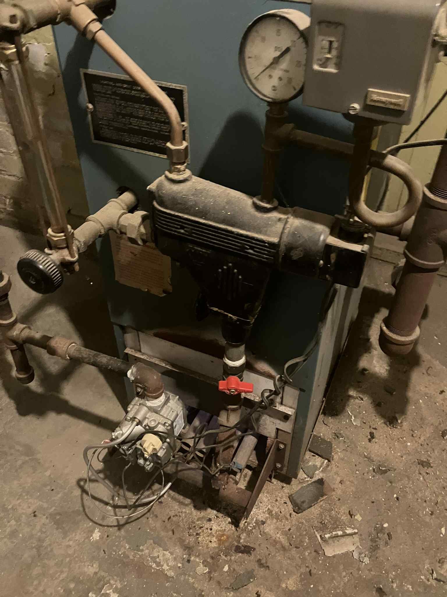

    now, for a totally separate topic that seems to be completely unrelated to my main vent installs. I woke up last night mid-morning feeling pretty cold air, and assumed my boiler ran out of water or something (I don't have automatic feeders). It was indeed off, but I had no idea why. I've heard that the "float mechanism" (that turns your boiler off when the water is low) can sometime get stuck, so I lightly tapped this oblong shaped black thing with a hammer and the boiler fired right up - great news so I went back to bed. I woke up again three hours later and once again felt cold air, so I checked the boiler, tapped the black thing again and it once again fired up. This happened once again before I left for church a few hours later.
    I could be wrong, but it seems like the float mechanism is getting stuck for some reason. Does anyone have any thoughts on why this might be happening? My boilers are pretty old (probably the understatement of the year), but it seems kind of random / odd. I last flushed my boiler when I first turned the heat on about a month ago.
    That float thing can and does get stuck. How often do you blow the float chamber down? That red valve underneath it? You should be blowing that down with a little pressure on the boiler about once a week — open the valve in short full bursts until you get bursts which are more of less clear
    the machined brass street ell is probably a little more restrictive than a cast one but that can hold 100x the weight that you have there. the offset with 45's is a great way to do it.
    are you blowing down the lwco regularly? the water level shouldn't be falling enough to turn off the lwco.
  • @mattmia2 yes, I agree that the brass street 90's seemed restrictive - the store I was at didn't have any cast iron fittings that small (could have used galvanized but I wanted to avoid that).
    Thanks guys - to be honest I'm not sure what either of you are referring to (seems like you're talking about the same thing. To answer your question though, no, I've never done that since buying the house a couple years ago. Boiler tech may have when he looked at them shortly after I bought the house. I welcome any guidance you guys have.
    Another question - what should the PSI reading look like when the system is running? I'm not really sure that it is reading anything currently as it always seems set at 0.
    109A_5 Posts: 4,759
    edited November 2025
    Unless the water level was low recently I would not suspect the Low Water Cut Off (LWCO). If the float was compromised and sinking the LWCO may not recover from tapping on it.
    I suspect the Pressuretrol is set too low for reliable operation. So tapping on the LWCO is actually vibrating the Pressuretrol. Turn the Cut in setting a 1/2 turn to 1 turn up.
  • Seems logical - technically, the system would have had a lot more "unnatural" pressure previously because there were no vents - is that a reasonable way to look at things? Anyways, I'll adjust and report back.
    109A_5 Posts: 4,759
    A Volt meter would help determine what is shutting down the system.
    The McDonnell & Miller #67 LWCO should be exercised often (Red valve below it) to keep the float moving freely.

    Blowing down the 67 does flush out the LWCO, it is not the same as flushing out the whole boiler by the boiler's drain valve.
    Yes repair the drain piping for the 67's blow down valve and put a pail under it. With your 67 drain so close to the burners I would recommend a metal bucket.
